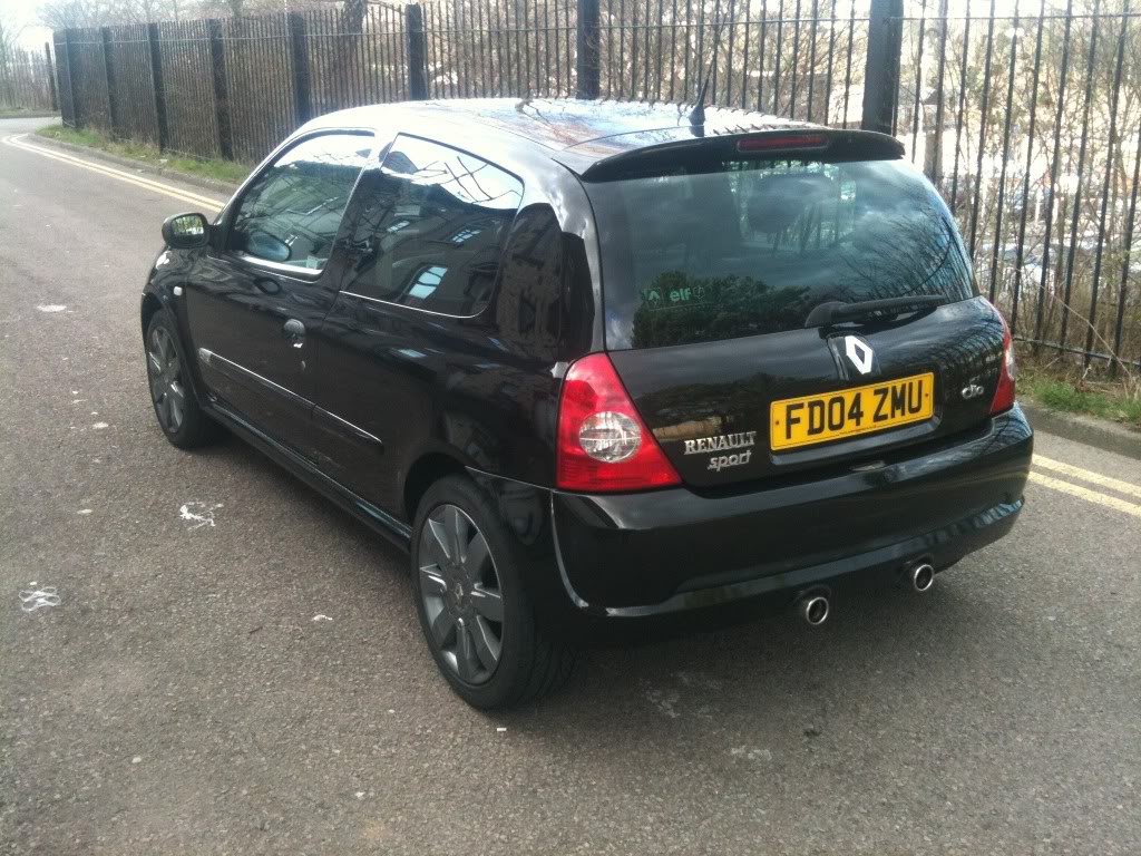

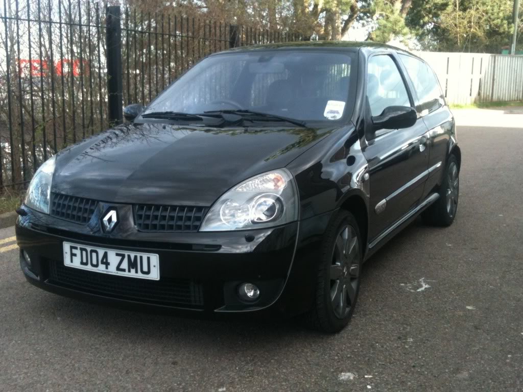

This is the story so far when i came back i was still using it for 2 months untill i bought a 306 dturbo as a work horse so the project began from a standard 182.
here is the car when i had it
