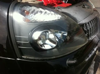

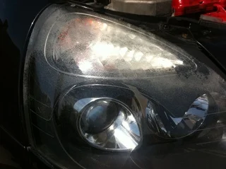

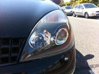

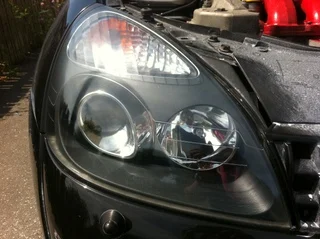

So i got bored yesterday and decided that the headlights on my car were totally ruining the front end (Aswell as the front bumper and bonnet but they can wait ;)) So i set out with some 1500 wet and dry and some 2500 wet and dry, also T-cut and some polish oh and some elbow grease! Took mayb an hour and a half each side but was totally worth it imo.. only got one before pic as i never thought about it :eek:
Before:
After:

Pardon my retardation but what actually was all that crud yourlight was coverd in in the first place?!

Its UV damage IIRC. Its on the outside of the lens.

No idea what polish it was i just found it in the garage lol.
Im sure there is a guide on here about how to do it, if not im doing my dads mates focus' headlights soon so i can write one up
goood work pal.. looks sweet... did u take um off when u did it ?...is it on the inside or outside ??:approve:
Nope just left them on, alot easier and its on the outside.

Epic result!! :cool: Did you wet sand them with the wet and dry?
I did mate yeah

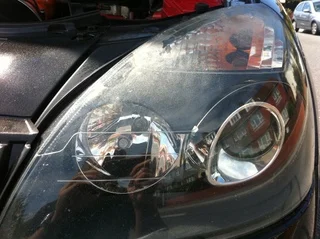

hello there mate i gave it a go by hand looks lots better but no where near a good as yours dont no how you did it ? took me like 3h but the right light was realy bad and the top is still a little bad.
how did you get the light so clear? i used wet n dry 800 , 1500 , 2000 , 2500 as my ones was real bad then used scratch x.
p.s sorry to jack you post :)
