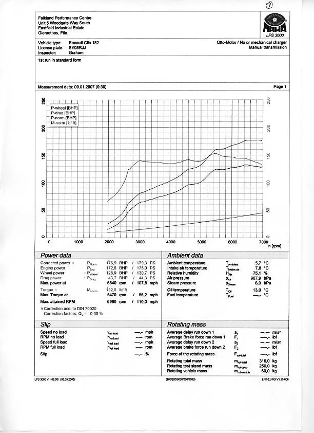

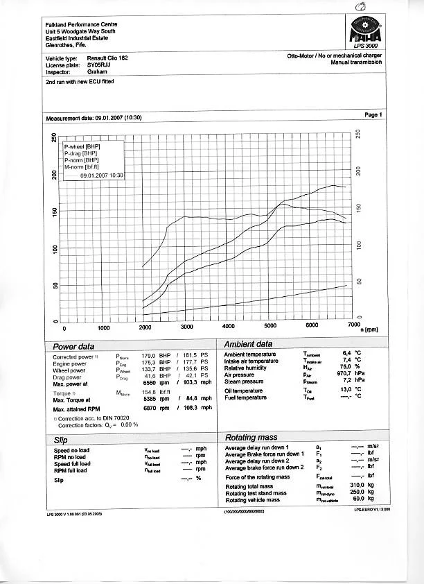

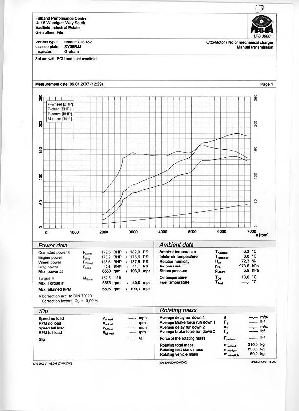

My before and after tuning graphs
Car  cup 182 mit stripes
Here they are

Tells you on the graph fred.
You gained about 2bhp and 5lbs torque from a remap and manifold matching.
I'd be demanding a refund :S
looks that way :(
But if your going to look at things and be overly cirtical, there are several points to look at.
-more drag is calculated progressively along the runs, almost matching the 'gains'.
-Where the remap adds a few bhp peak torque, the manifold adds correspondinly as much peak torque.
-Point of peak power and torque drops with each mod, indicating an increase in efficiency.
All over though were looking at such small percentile changes that it is disappointing, especially for me so as Jim is possibly the most critical person you could have as a customer, however it looks as if his car is down on power on a whole and it just didnt respond well to the mods.
Unlucky that it happened.....and it happened to Jim :(
