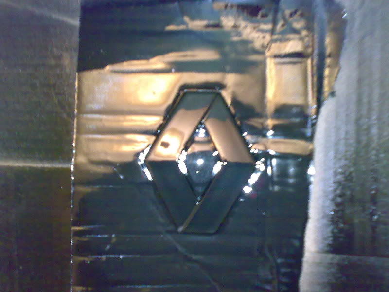

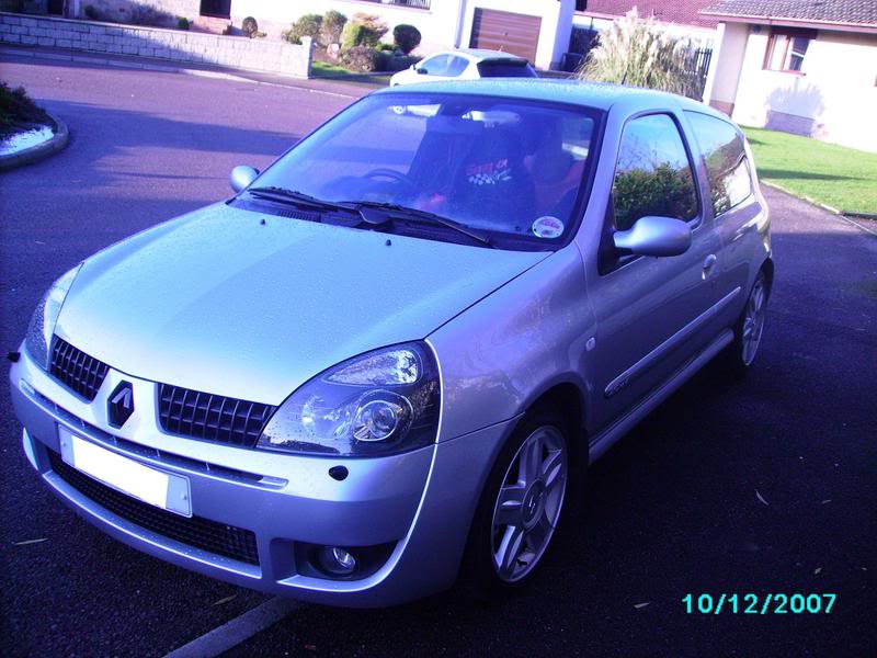

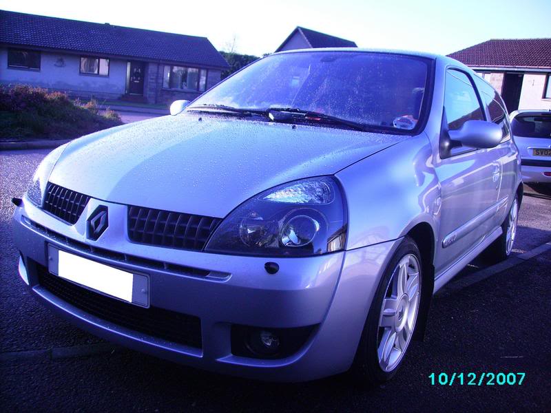

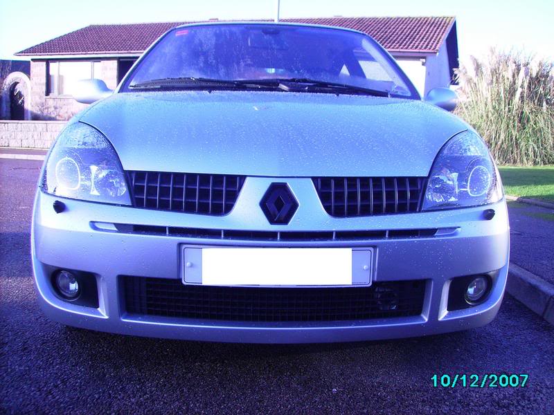

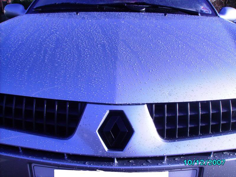

I had a go at painting and laquering my front Renault Badge.
And thought i'd post a few pics up. ;)
Sorry some of them aint the best, the sun was blazing on lef of car :(
Looks like a good job, though I have to admit whenever I see a car with a black renault diamond it just looks like the silver ones dropped off :eek:
  UR R26R.5, VW Golf R
The colour in the first pic looks tip top. Iceburg Silver looking more like a very light off shade of blue. FTW! :)

very nice , waht process did you do matey i will be doing mine in white soon.
I used plastic primer 2 or 3 times, then rubbbed down a few times then on with matt black paint rubbed down a few times with wet and dry then onto final coat of matt black.
I was gonna leave it matt black but decided to laquer it 5 times for a bit of shine, rubbing down with wet and dry in between then on with the final coat ;)
