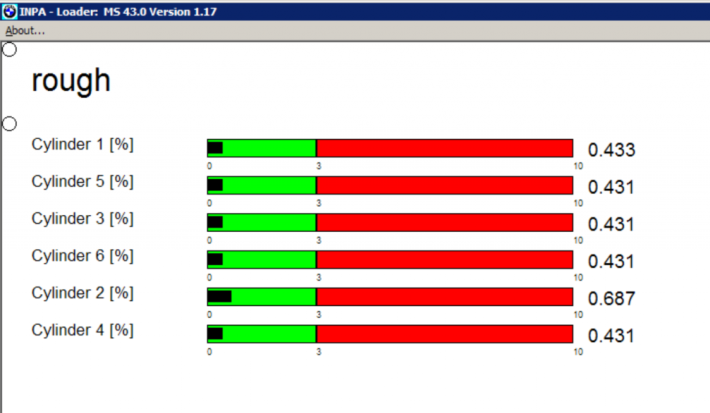

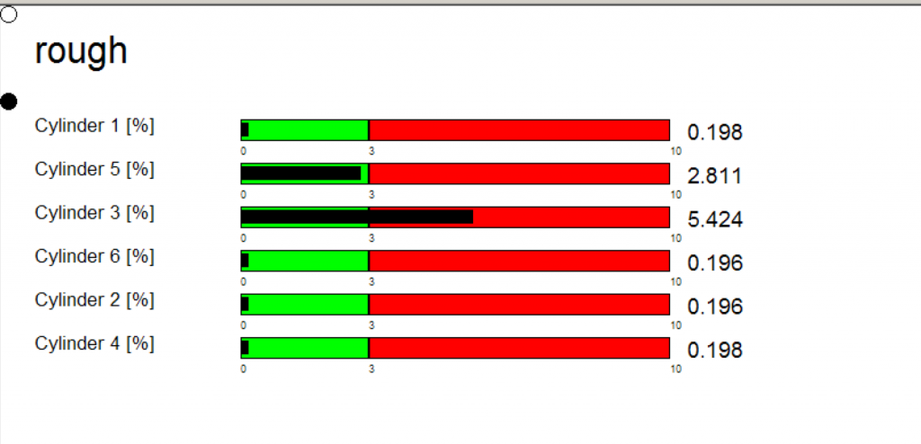

Finally got INPA working tonight, none of the codes were showing an obvious cause, but the "rough" test showed cylinder 3 wasn't running all that well. Most likely it will need an ignition coil, Bosch ones are £21 from ECP so not too bad.

Not since its last Inspection 2 I doubt. Its been serviced at BMW all its life. I had the plugs out tonight for a look and they all looked fine. I swapped the plug from cylinder 3 into cylinder 1 and vice versa, and swapped the coilpack from cyl 3 into cyl 2 and vice versa. Hopefully this will allow me to pin point if its a plug or coilpack at fault.
As its intermittent though, it's going to be hard to spot!
I read the values just after swapping and they were fine.
Cyl 2 is slightly abnormal to the rest if anything. That has the coilpack from cyl 3 on it... Will see how it goes.
Once again, thanks to @f0xy for helping me out with INPA.
Anything in the green is generally fine, even if they are going up and down. When somethings really f*cked it will go to a high number constantly, not intermittently

Going from your possible cam sensor fault earlier, that would cause hesitation, but it wouldn't cause it to keep cutting out, as the engine would just basically stop using the VANOS properly. On the E36s you can tell when the cam sensor is playing up as the injectors start batch firing (rather than sequential), but thats an old style injector, and they are loud. The smaller more efficient E46 injectors are quiet and you wouldn't hear them like that.
  DC2 TypeR / E36 328i
Inlet cam sensor replaced yesterday, car feels much better through the gears!
So that explains the initial performance issues, now I just need to find out where this intermittent niggle is coming from..
