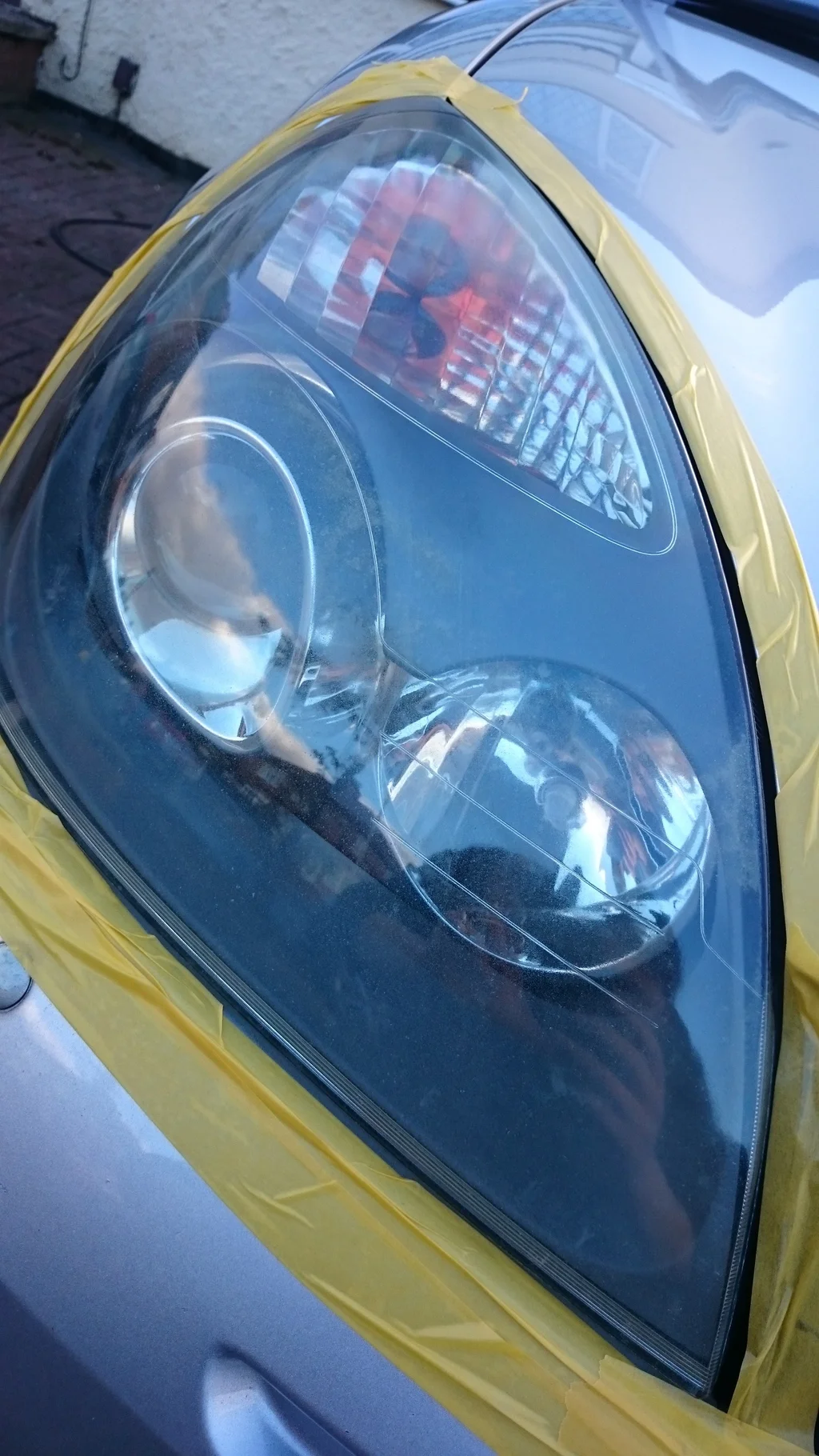

I've replaced the door speakers, ordered some proper headlamp washer blanks and I attempted to polish the headlamps as they have gone cloudy. They look marginally better but need much more work. I've also replaced the indicators at the front for silvertech ones.
