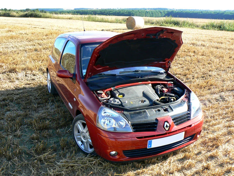

My Clio dCi 80 from France, RS Spirit :)
Car  Clio 2.3 dCi 80
Hi guys !!
First i'm a real frech from France, so my language could be "strange" or bad, please apologize if you don't understand :o
So, I'm Emanuel i've got 20 and i'm in love with my clio.
I'm studying automotive at school :)
This my second clio, cause i've crashed the first, but i bought exactelly the same, i'm crazy says my friends ;)

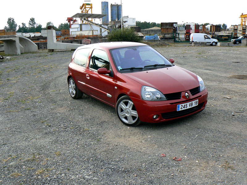

I'm gonna present the "second".
Clio dCi 80 09/2004 Sport Dynamique with Automatic AC and that's all.
All the modifications .. in french (sorry :o)
Modifs faites:
Eclairage
-Ampoules Silvervision Avant + Arriere (Silvervision blinker bulbs)
-Veilleuses Philips BlueVision
- H1/H7 Bosch +90
Exterieur
- Essuies-Glace Valeo Silencio (Flat blade weapers)
- Plaques Blanches en tole Renault
- Antenne de Modus 2 (Modus 2 antenna)

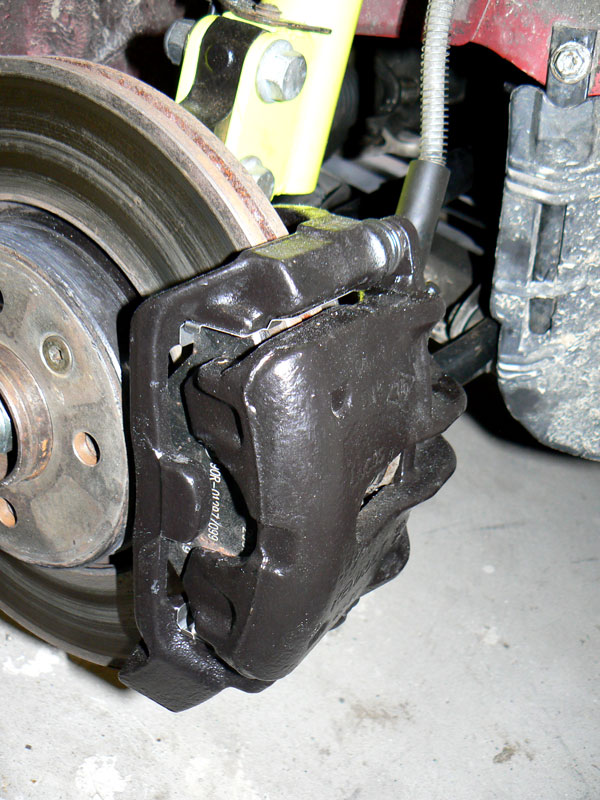

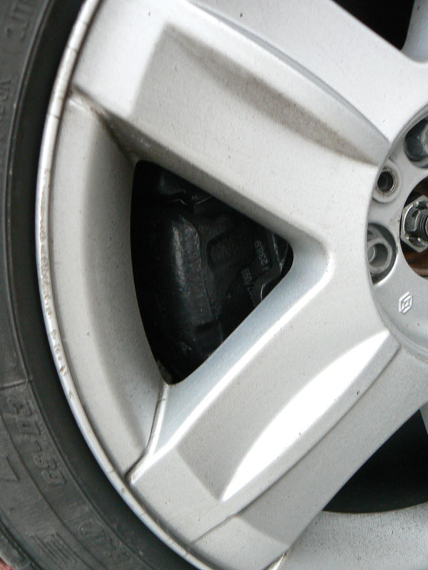

- Tambours + Etriers noir brillant (Brake calipers in black)
- AutoBra
- Autocollant Forum-clio
- Gicleurs de C3
- Monogrammes 2.4
- Joint capot Twingo 1
Chassis

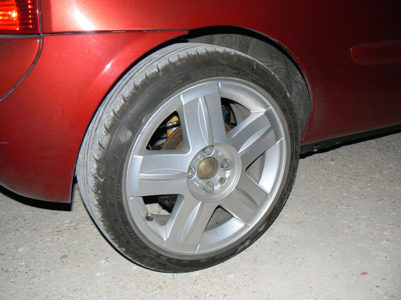

- Aliums 16' de RS (Alium RS wheels)
- Elargisseurs 16mm Bratex + goujons et ecrous (spacers 16mm)

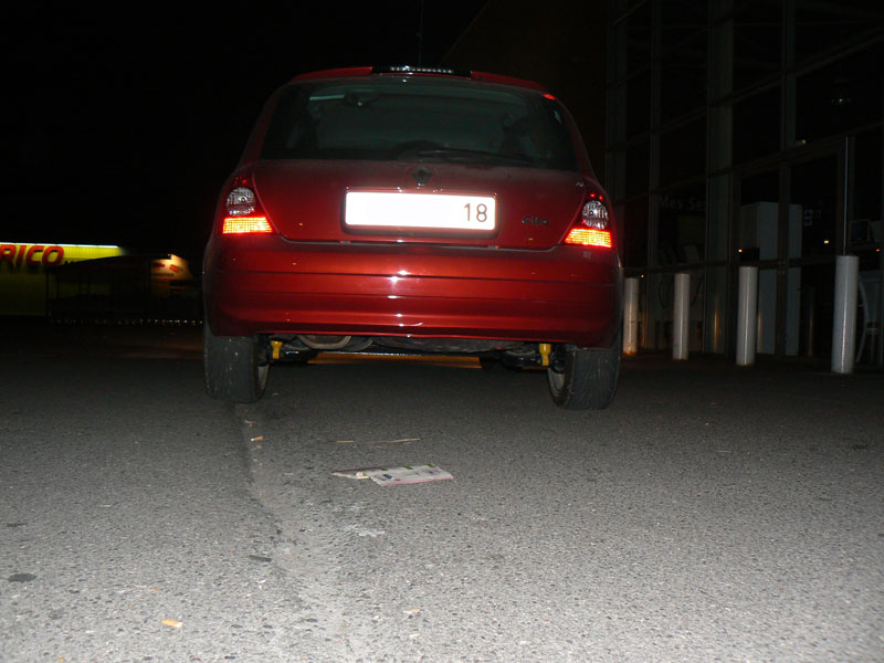

- 4 Bilstein B8 et Ressorts Eibach -30 :rs: (Dumpers B8 Bilstein and Eibach Springs)
- BAR AV et AR OMP (Anti-roll bar OMP front and rear)
- Disques Zimmermann GRN + DS2500 (Zimmermann Brake disk and ferodo ds2500 brake pads)
Moteur
- Suppression EGR (Deleting the ERG)
Interieur
-Autoradio Pioneer DEH-5000UB + Module commandes au volant + Integration du port USB sous la clim
- Tapis de sol Renault Sport
- Rajout du Rheostat de Compteur
- 2ème Eclairage de Coffre
- Plafonnier Full Bluevision (W5W)
- Lustrage Baguettes Sport Dynamique
- Remplacement de l'allume cigare par un +12v de Picasso
- Console + Platine Nacrée RS 2.2

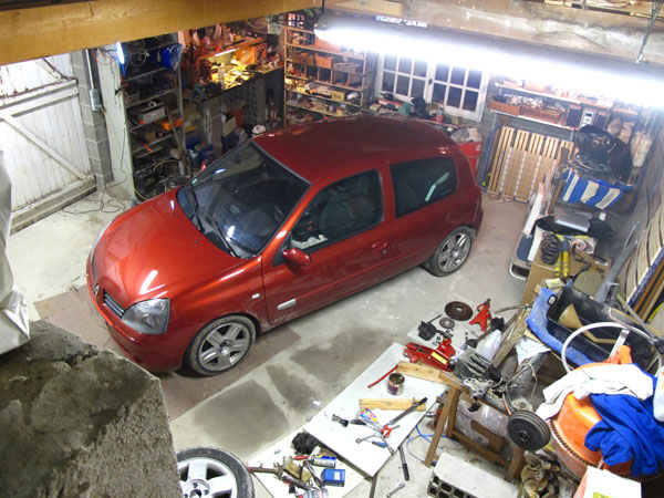

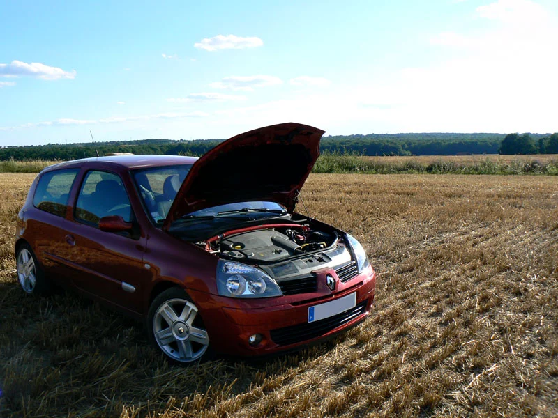

And a few pictures, cause i've got about 10GB and i can't post all :rasp:
The last one :D

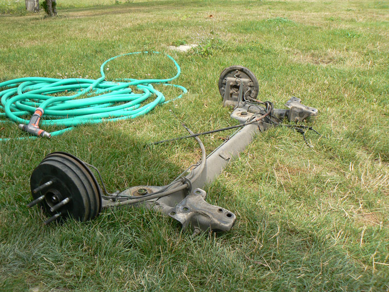

In the few day's i'm gonna mount a Rear wheel axle unit with brack disk from a Clio RS1 :)
A picture taken this day, after 7 months everything is like new.
Yesterday i posted in "clio discussion" i think my post is made to be here, cause i'm gonna post some pictures during the evolution.
Hope you understand me :)

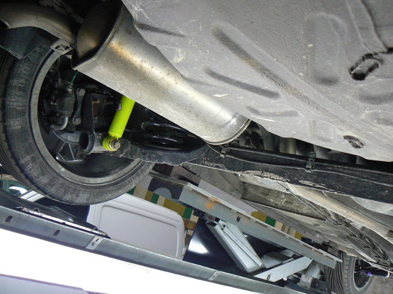

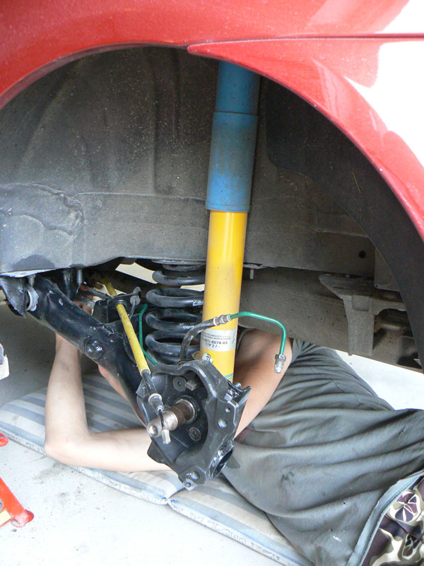

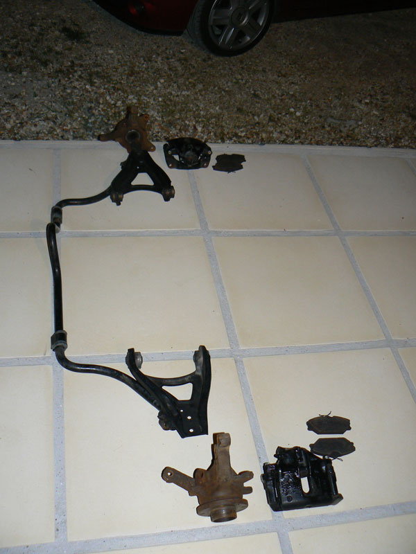

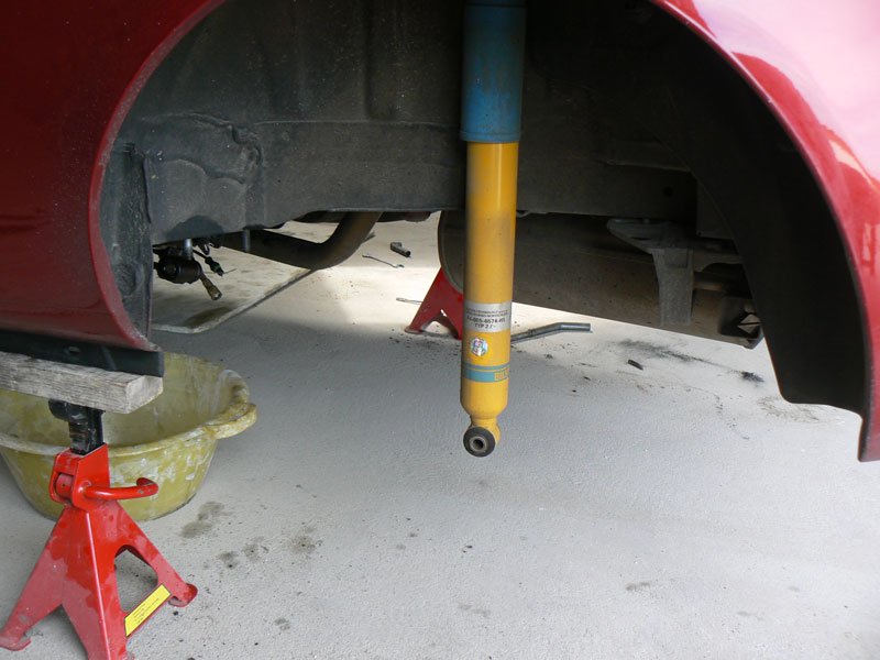

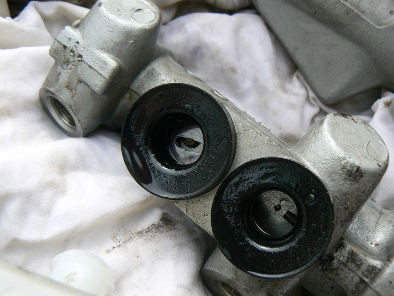

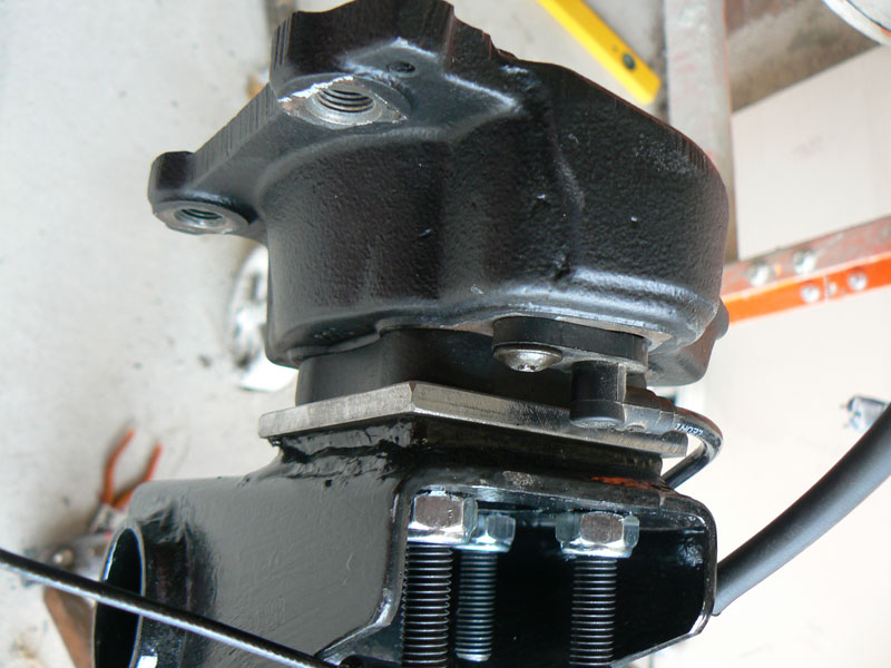

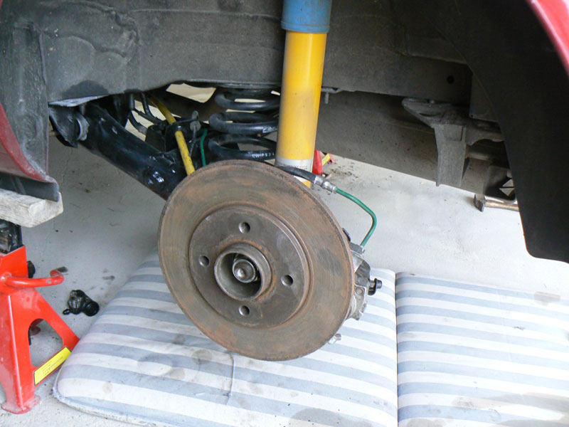

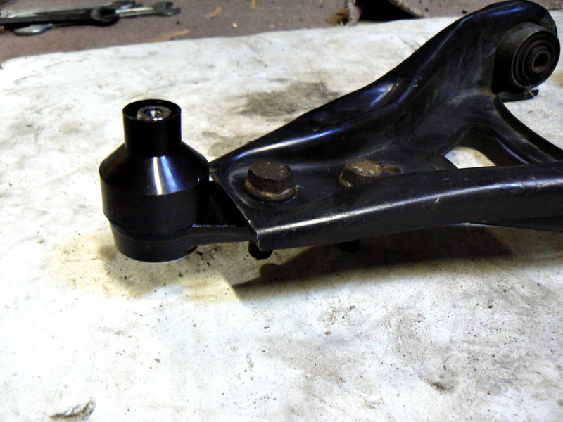

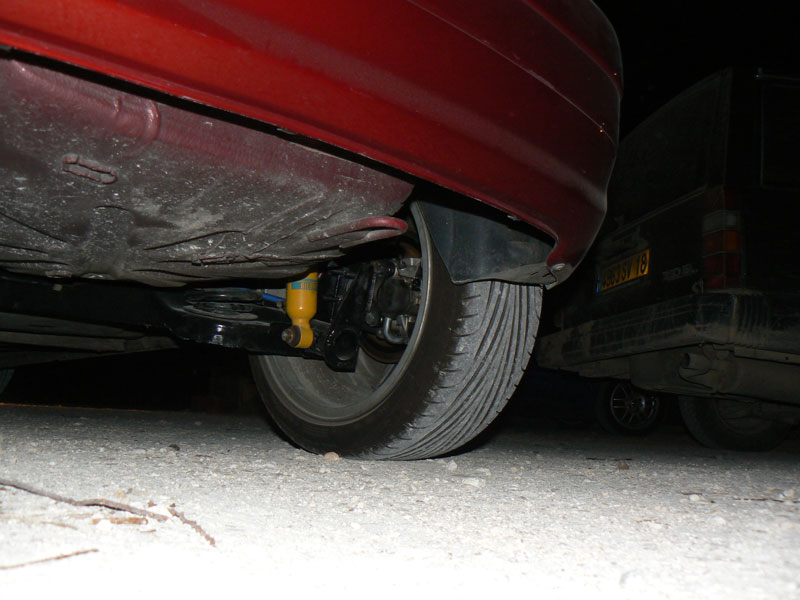

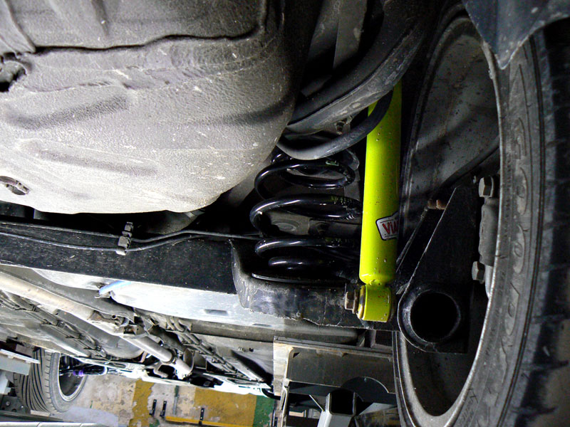

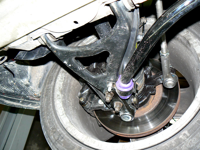

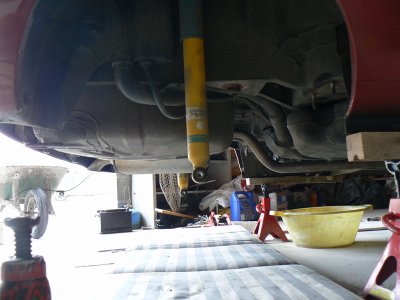

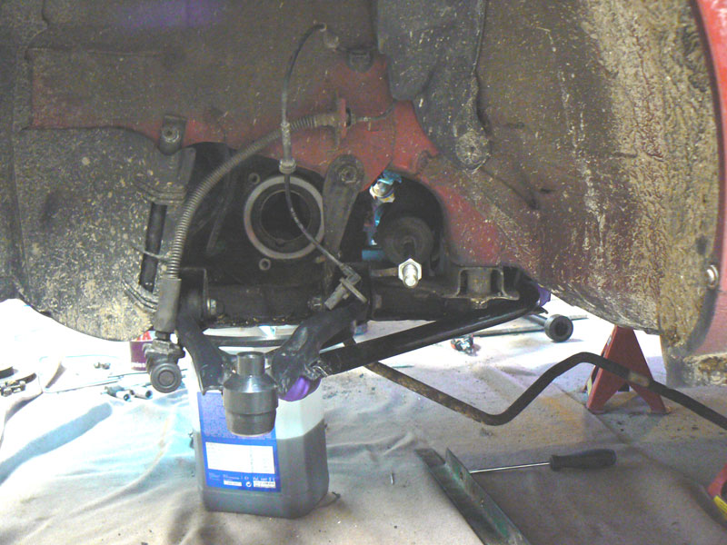

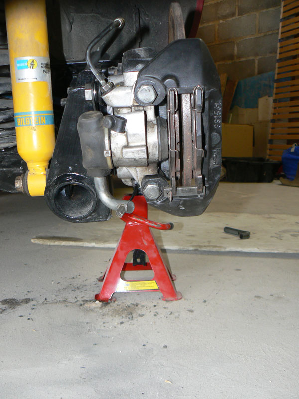

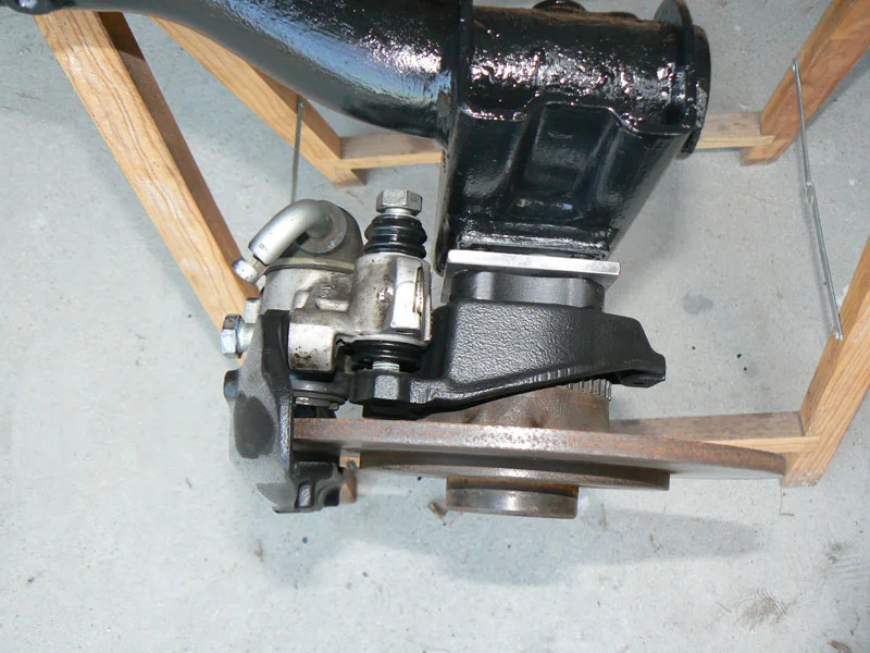

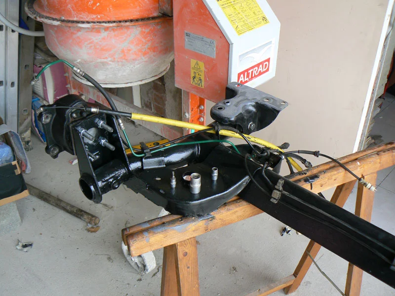

Hi guys,

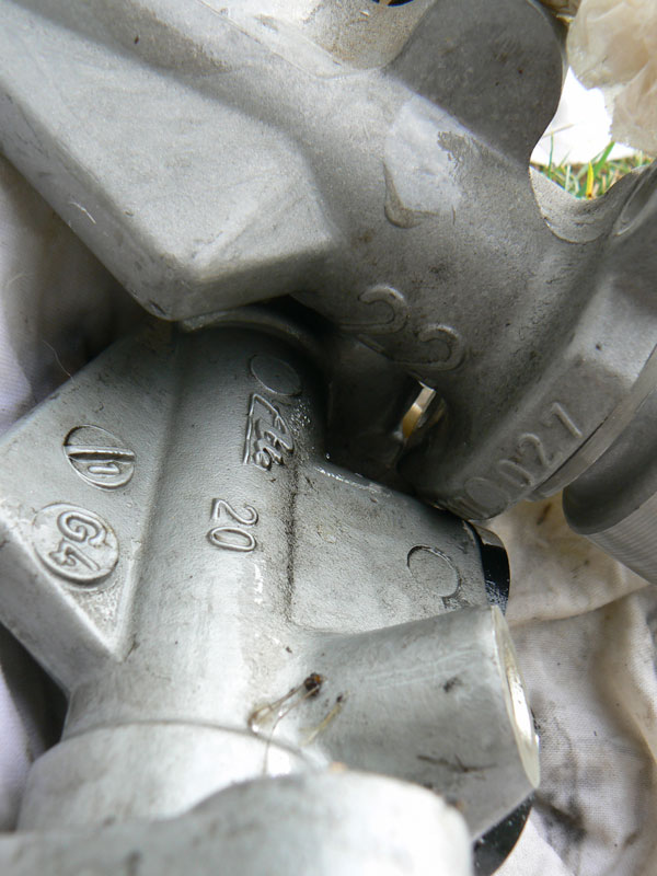

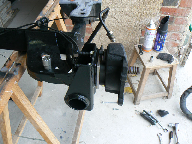

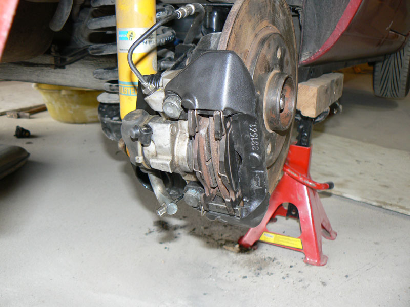

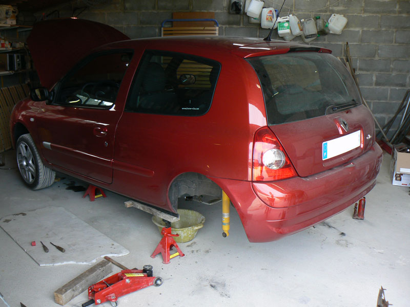

That good's i mounted the rear axle wheel with, brake disks :)
For the ABS i used dCi's 100 Abs Sensor and a 44 notch ABS sensor ring :)

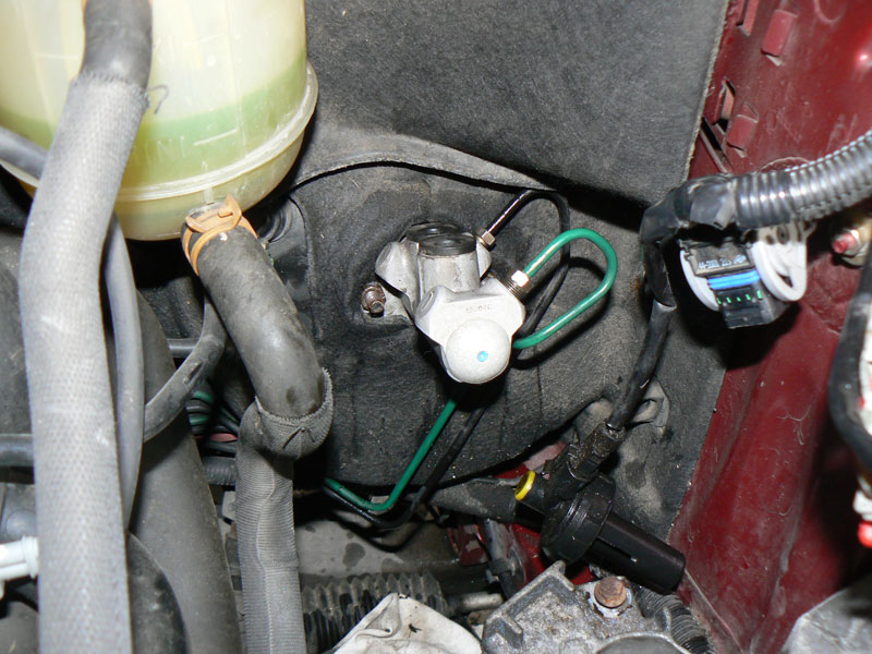

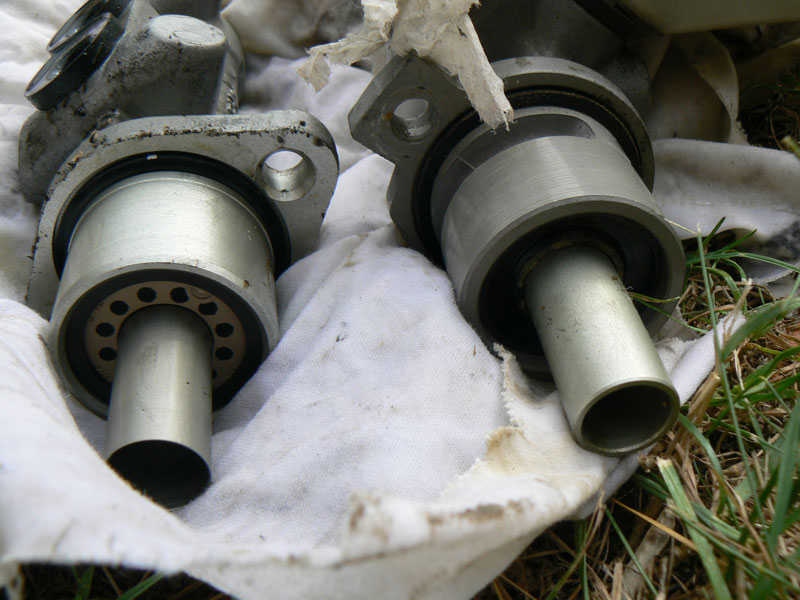

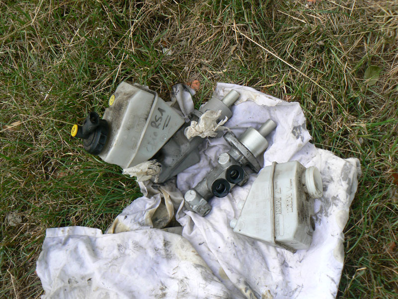

I changed the master cylinder, by a RS one in 22mm (only 20mm for dCi)
Some pictures ;)
Thanks ;)

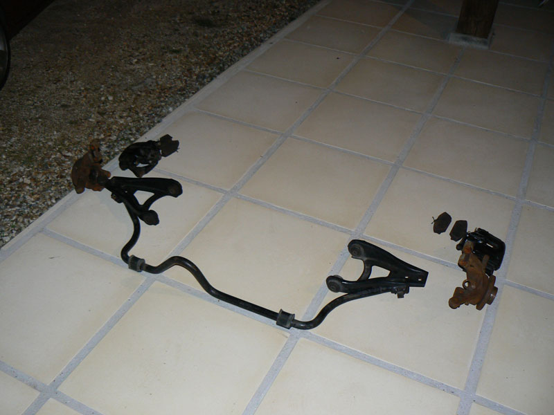

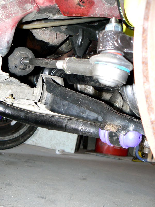

Now i'm look for a front RS2 axle wheel :)
Hope the roll center is gonna disapear :)
Very smart that. Youll have to keep us updated.
Sam!
looking lovely,
you will need subframe, hubs, strut's, wishbones, antiroll bar and driveshafts,
i used the driveshafts out of a ph1 rs172 as the driverside doesnt fasten to the back of the block, good luck.
@Bonxy :
Thanks, i'll keep you updated don't worry ;)
@ Hutchie :
Yep i need all the front wheel drive :)
But what do you call driveshaft? my technical english is a .. empty :lol:

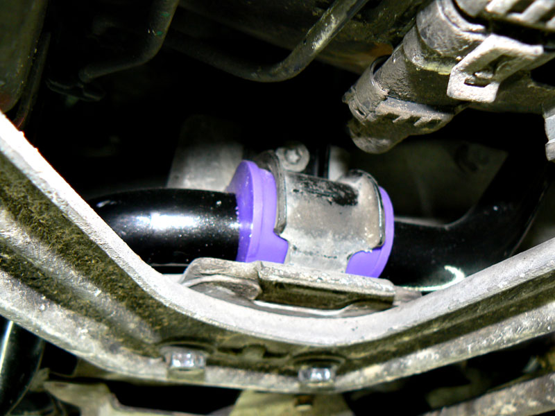

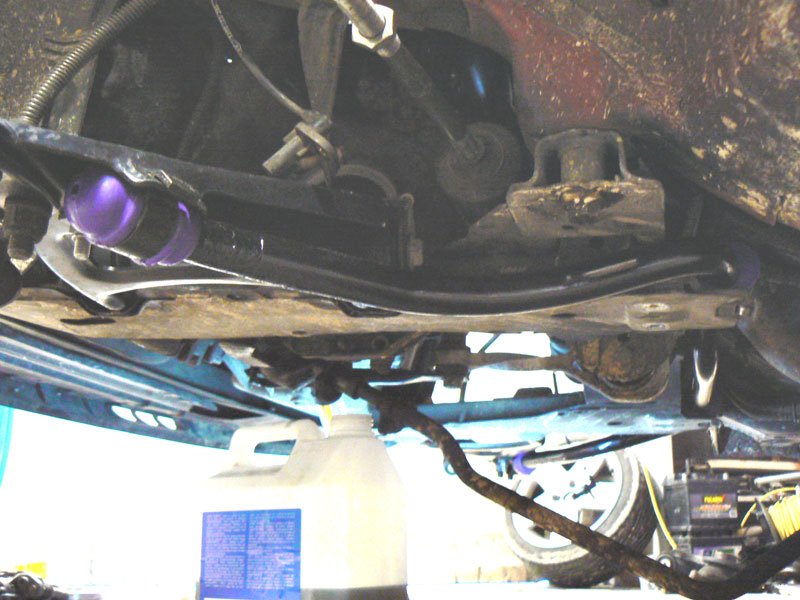

In due course i hope get a full RS2 front wheel drive with powerflex bushes fonr the anti-roll bar :)

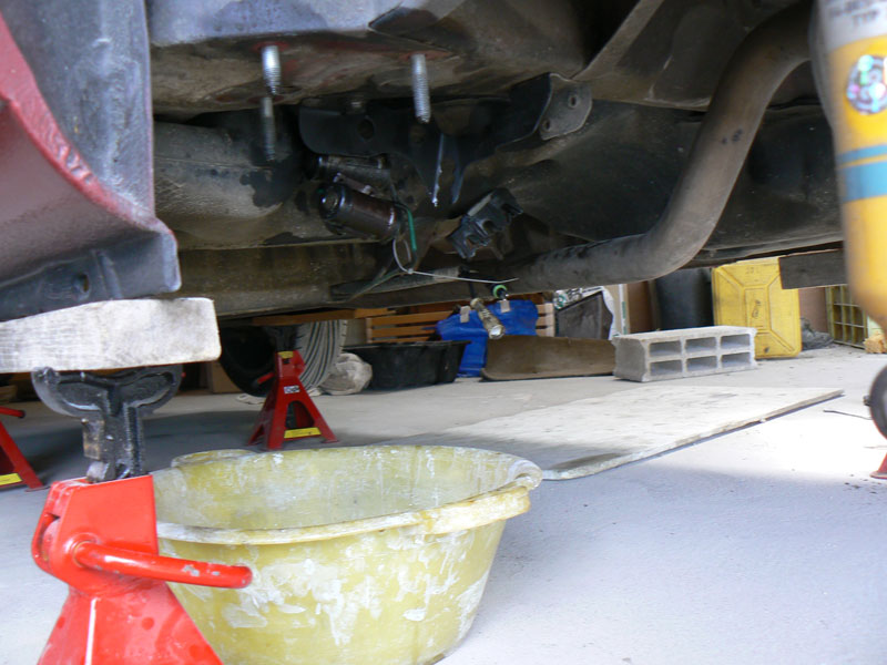

Some little pictures :)

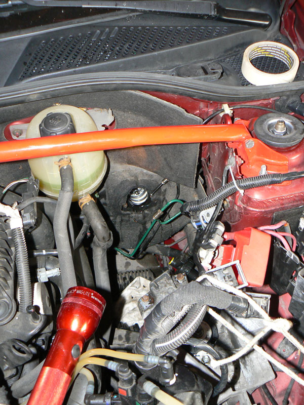

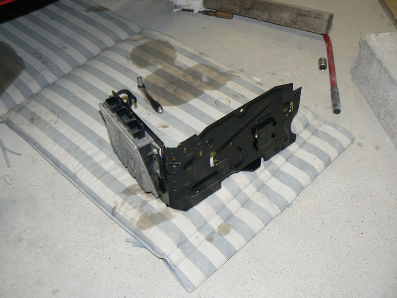

During the last year Septembre 2009 to Septembre 2010 i cancelled my ERG System like this and everything is good :)
I known my turbo is oily but is only oil fumes ;)

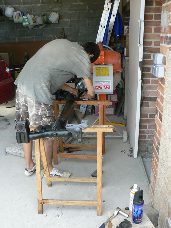

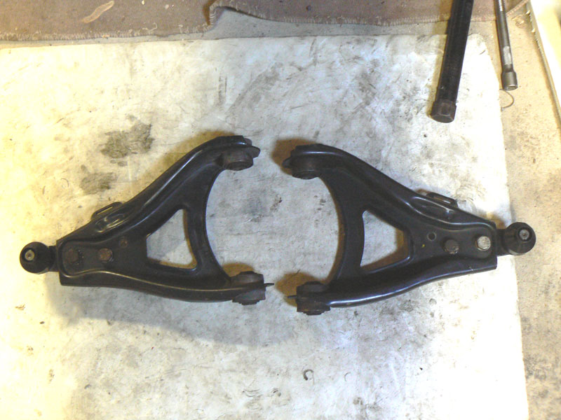

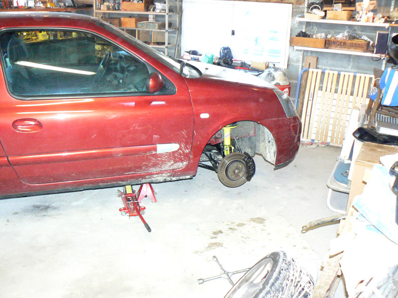

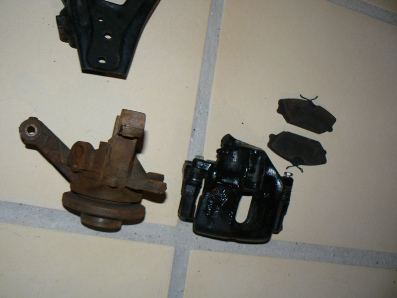

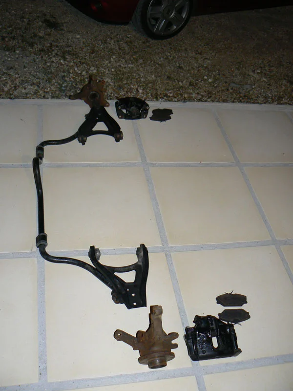

So, some news, the car had now 150 000kms and the clutch was changed 2 weeks ago cause he was really broken :(
I received a lot of new parts to mount, and some part for the Front wheel axle Clio RS2 !!!
The pictures :)
Hope i will be ok on January ;)
See you soon :)

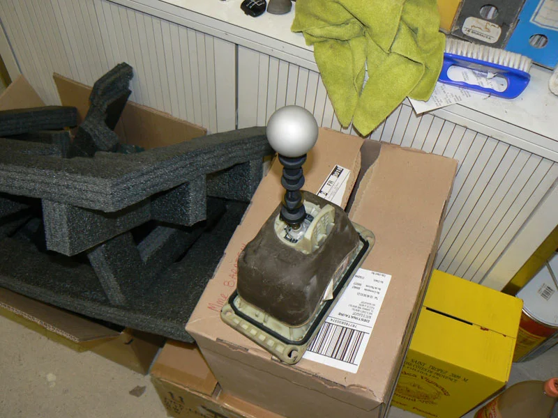

Hi,

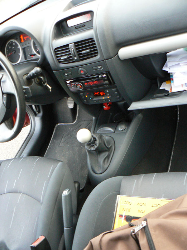

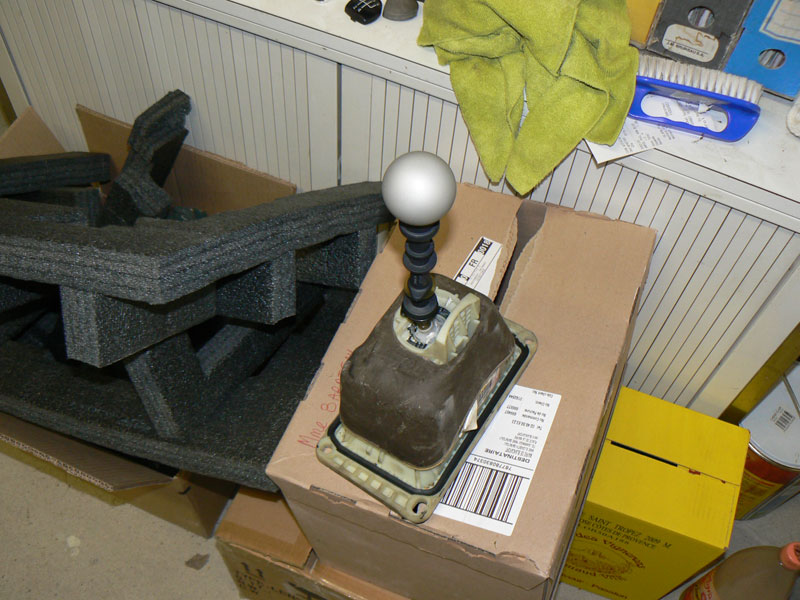

The new shift knob is on the Clio.
A Zamac ball like Spyder and RS1, it's cold in Winter and Hot on Summer.
I think it look reaaly nice on the Sport Dynamique harmony.

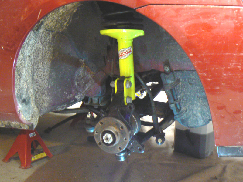

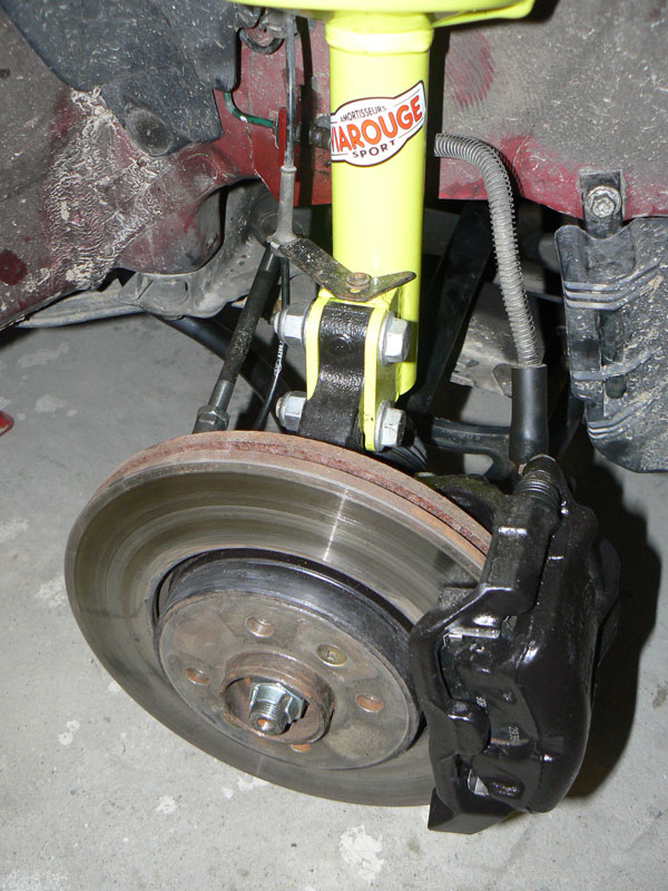

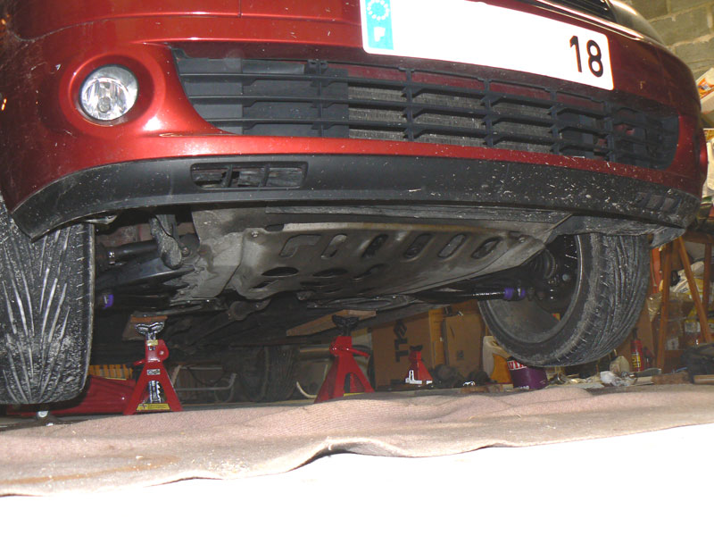

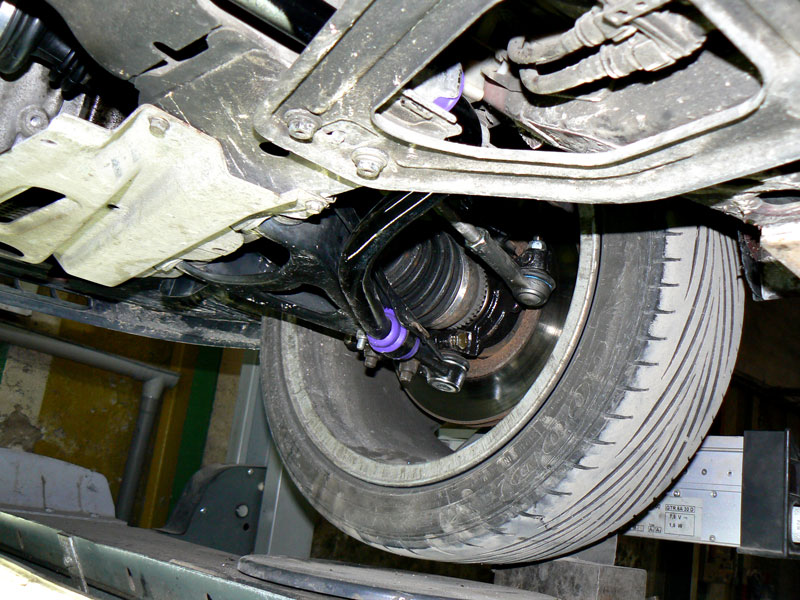

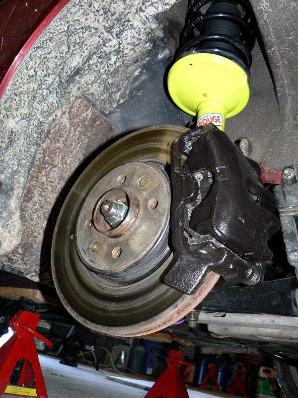

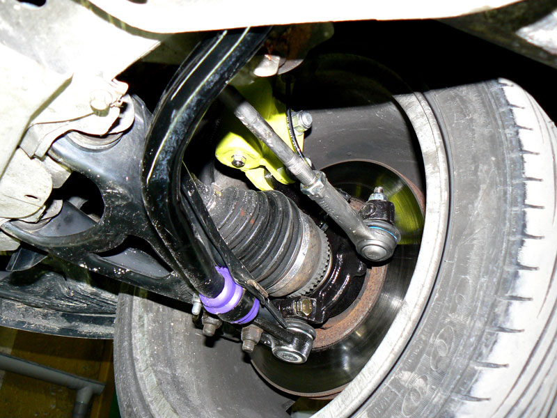

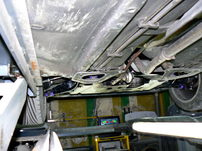

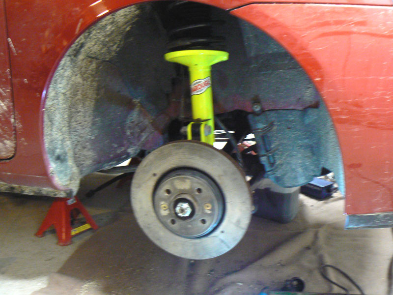

Some news, the front RS drive will monted for christmas, i received the new dampers and it start to look something.
The driveshaft should arrive at home in few day and tomorrow i will received the kneecap, the 6 one, suspension and direction.
Hello everybody !
Fisrt i hope you passed a merrychristmas and a happy new year day ;)

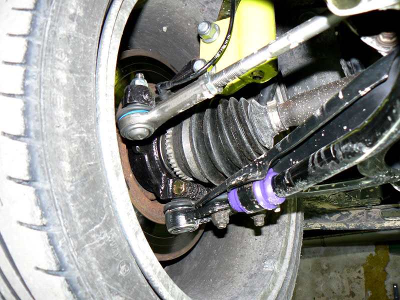

So, on the 25 December i mount all the front wheel drive from a RS2 with the Viarouge Sport absorbers and Eibach -20 springs.
The pictures :)
[flash=640,480]http://www.youtube.com/v/PqahQk8acTI[/flash]
And go to ski :)
The Clio hold the Road perfectly, it's huge :love:

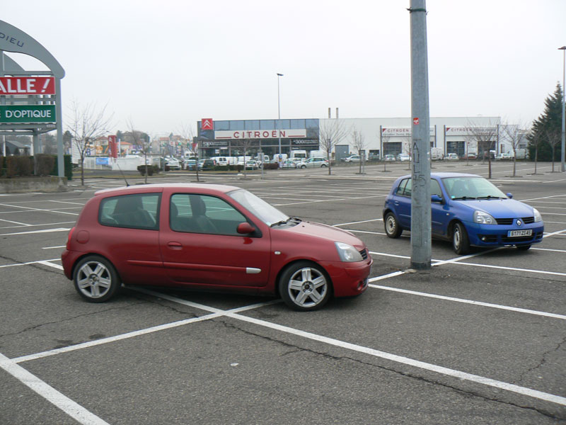

And 2 pictures of the Clio, the town is Nevers, that's where i studies, and it's Near the Nevers - Magny cours circuit, where the Formula 1 grand prix is ;)
And other pictures, in Clermont-Ferrand, another big city in France.
The other blue Clio is a member of the french forum forum-clio.com ;)

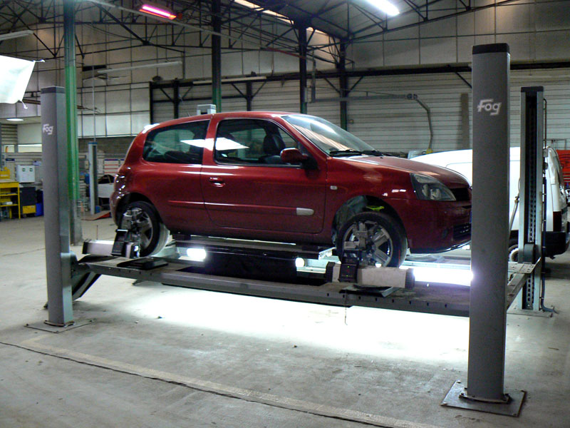

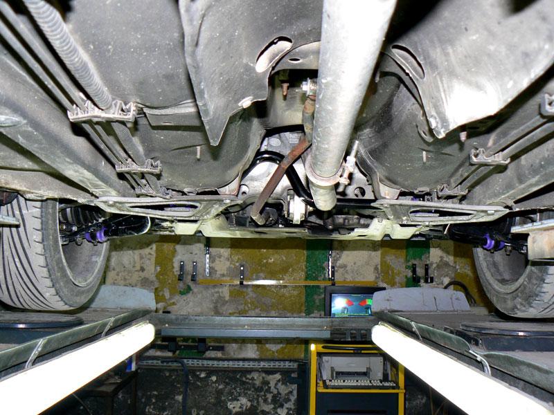

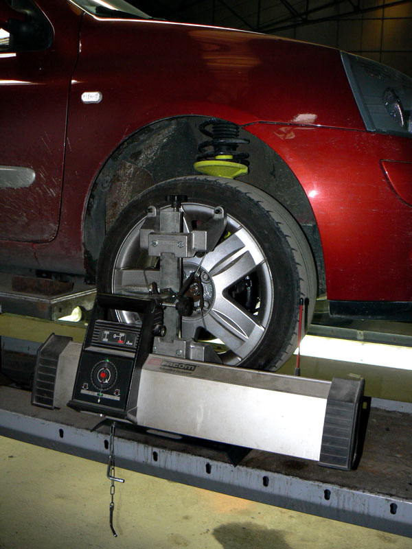

Today, i take some brakes and suspension measurements (hope you understand, cause i know that's not good).
Here are the results, hope you'll understand cause we don't have the same metric system.
Suspension:
FL : 87%
FF : 88%
RL : 61%
RR : 53%
Brakes:
FL : 250 daN
FR : 260 daN
RL : 153 daN
RR : 155 daN
The front is not perfect, but the brakes pads and disks have to run in.
After 20 000km, the Rear axle wheel is ok, brakes are perfects.

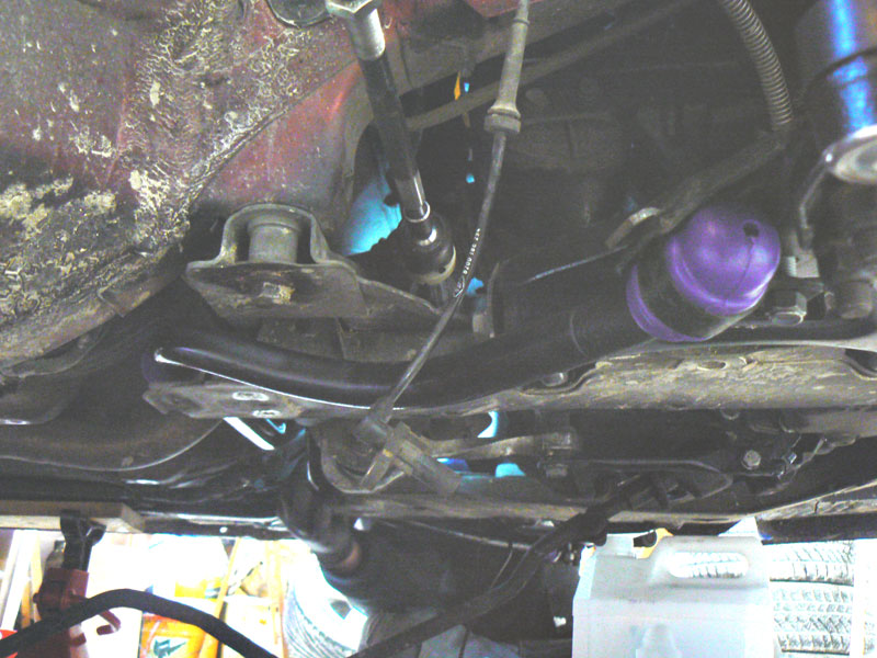

I made some pictures, and i mount an RS GMP (the third engine mount)
Hope you like it ;)
