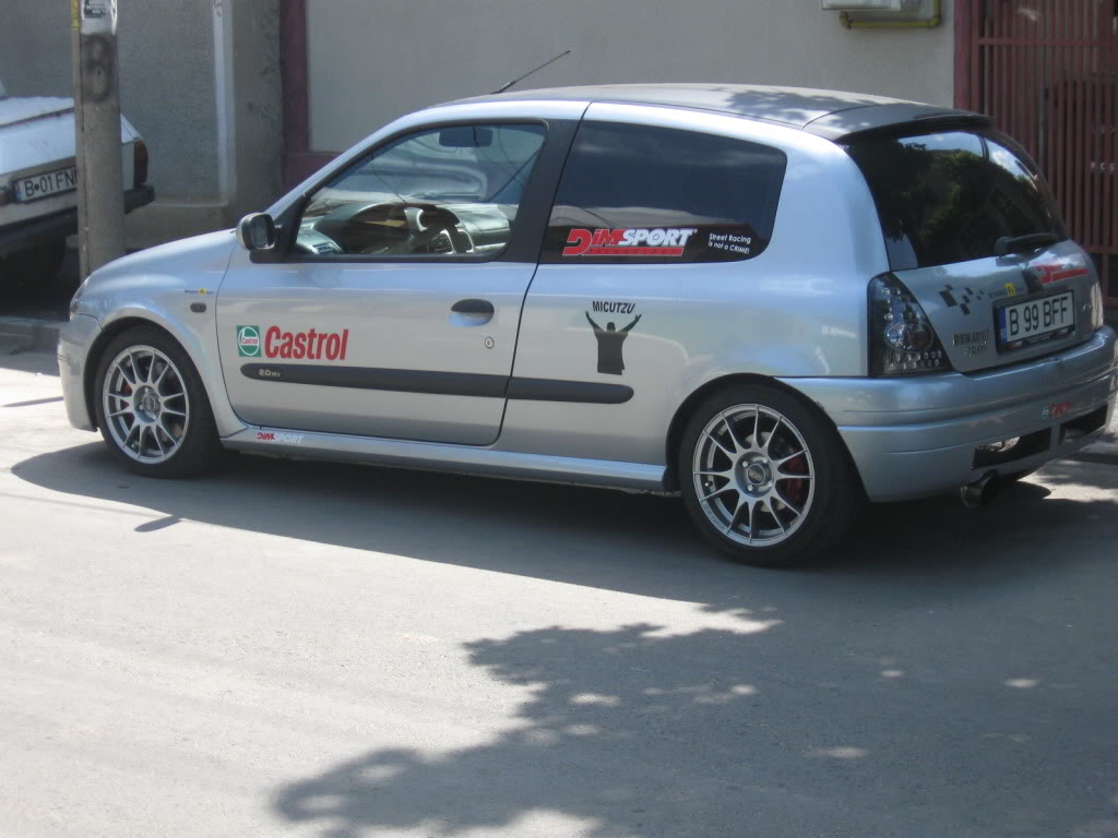

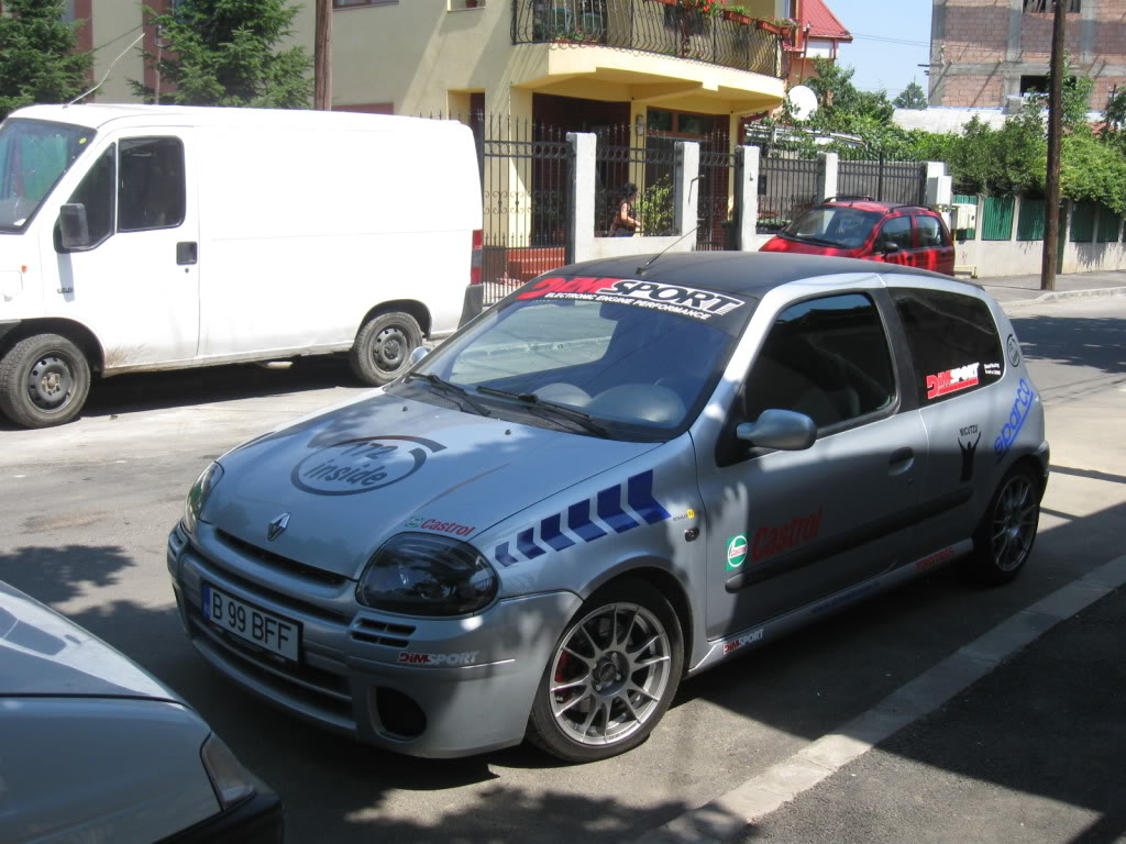

Hello everyone!
This is my 2000 Clio Sport, base hp 172, current hp somewhere around 200. Modifications include: cat cams 421' camshafts, inlet manifold, cold air intake, exhaust and some exterior modifications...
Next step is fitting a tubocharger to this engine.
Photos below:
Welcome to Clio Sport.
Nice, but not too keen on all the stickers.
Have you any rolling road results?
