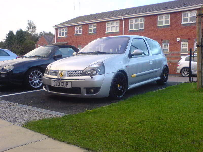

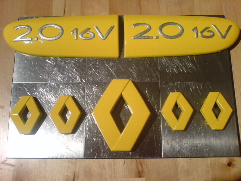

Just took my badges out of the heater - looking dappa :)
Will fit them tomorrow after work ;)

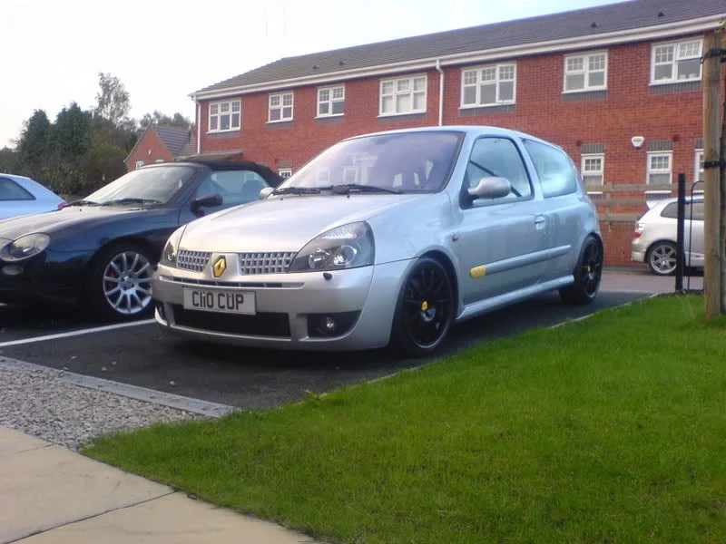

badges look much better and inkeeping with the dark wheels. :)

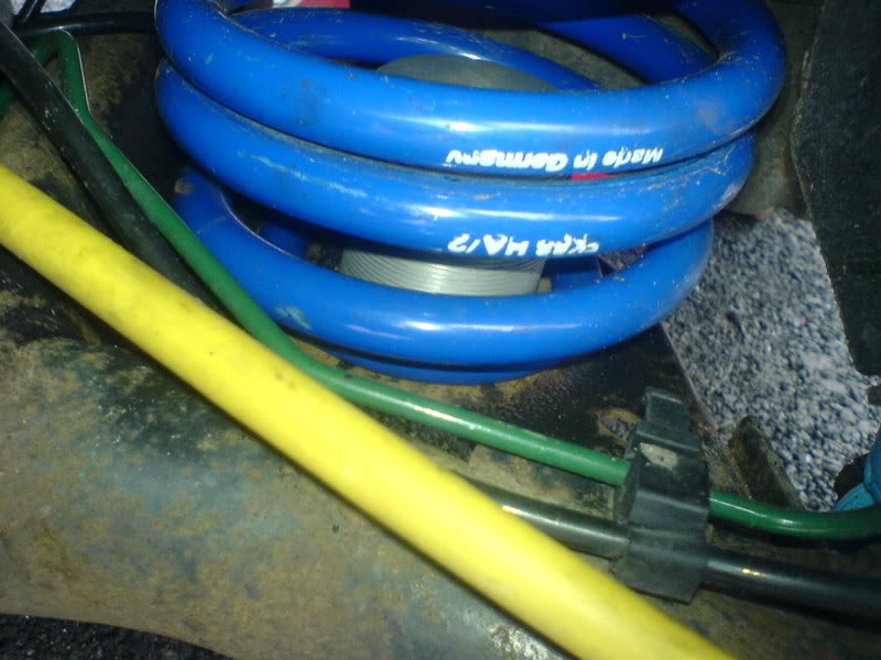

chris can i suggest that you put the lower platform back on as it locates the rear spring, your current setup is a bit dangerous (thats why i didn't take it off)
  CTR--VX220D
I still have the threaded chamber that is bolted in place - the springs are located over these - they cannot dislocate due the length of the chamber. Even when I jack it up the springs do not pop out excessively.
See:- [car jacked up when taking pic]
Thanks for your concern though Fred :)

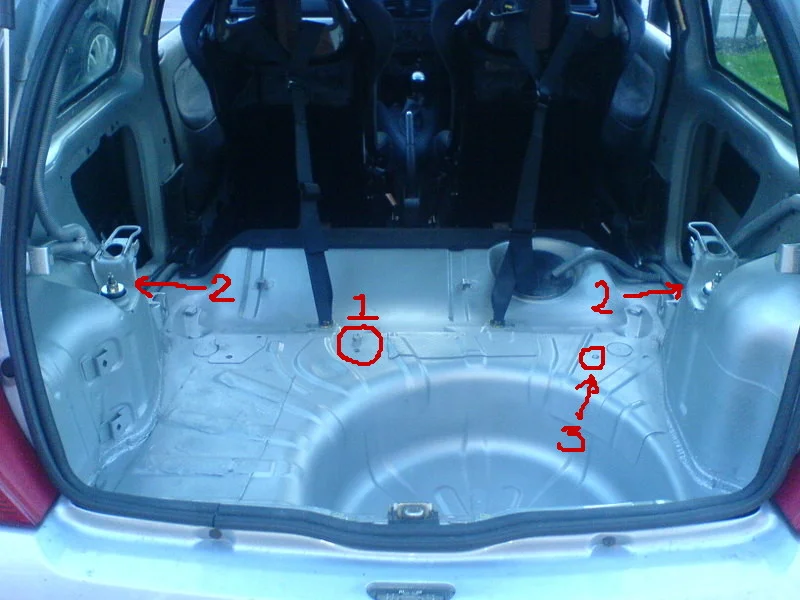

  Z4 Roadster
jeees, you ever go to work man???

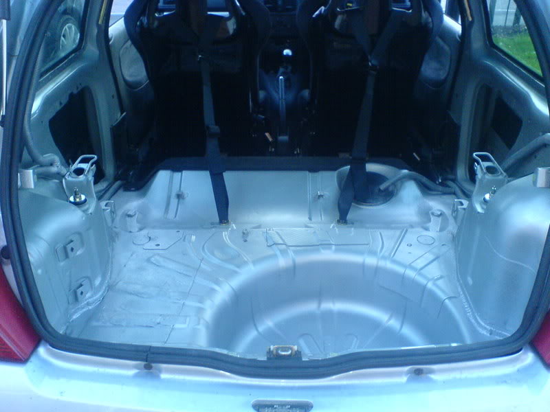

silver paint paint isn't exactly much of a clue / hint when you've got a silver car!! :rolleyes: :rasp:

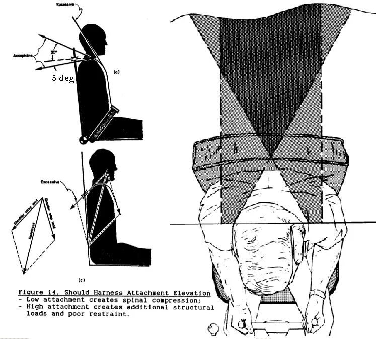

Chris you want those mounts putting higher up as per this picture otherwise you'll injour your back in a crash as it pulls you spine tight.
