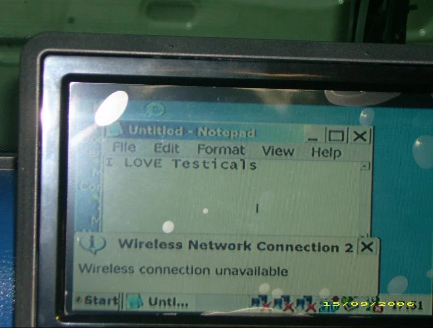

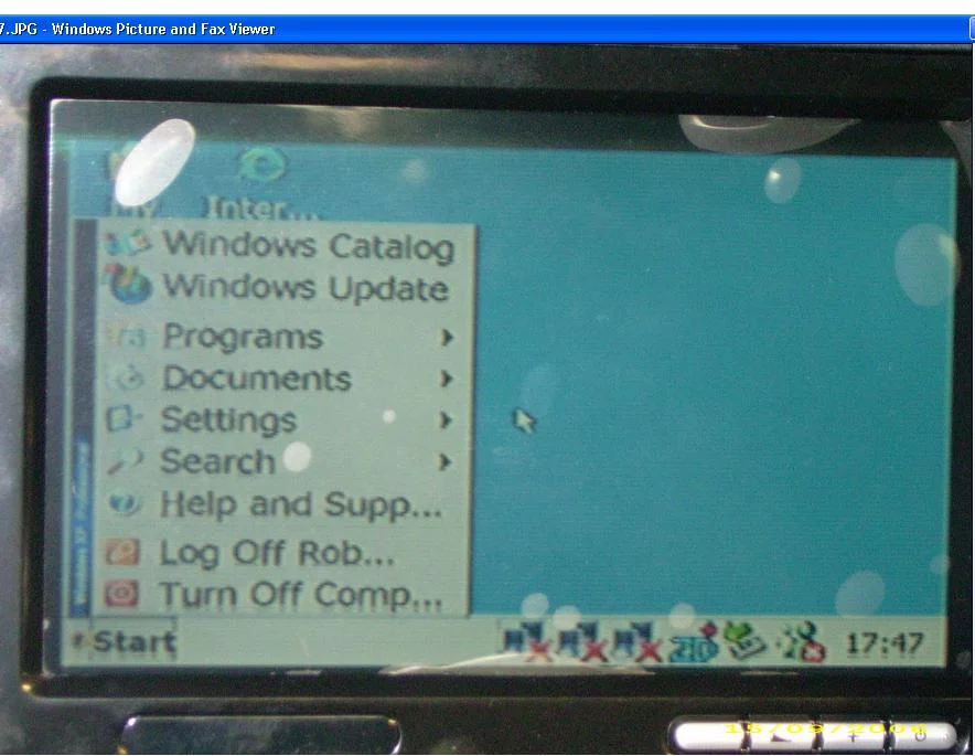

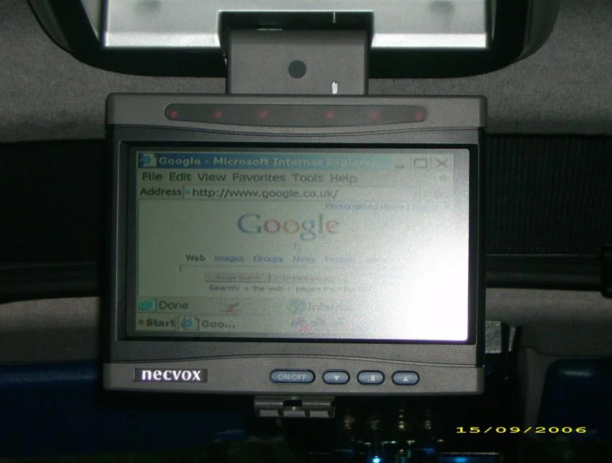

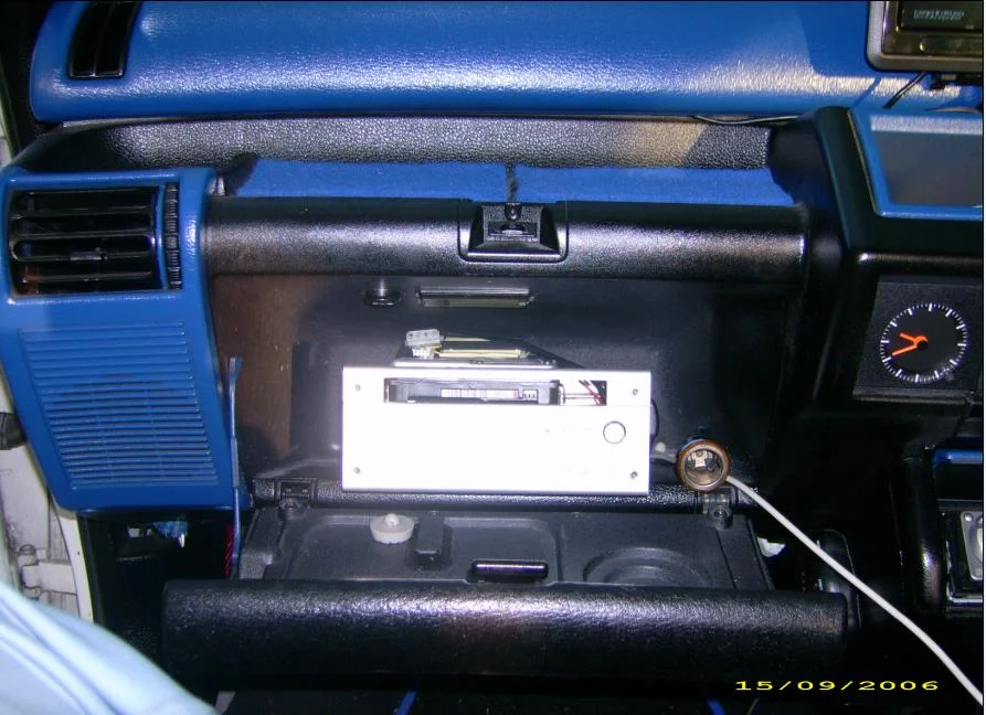

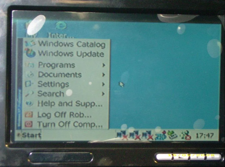

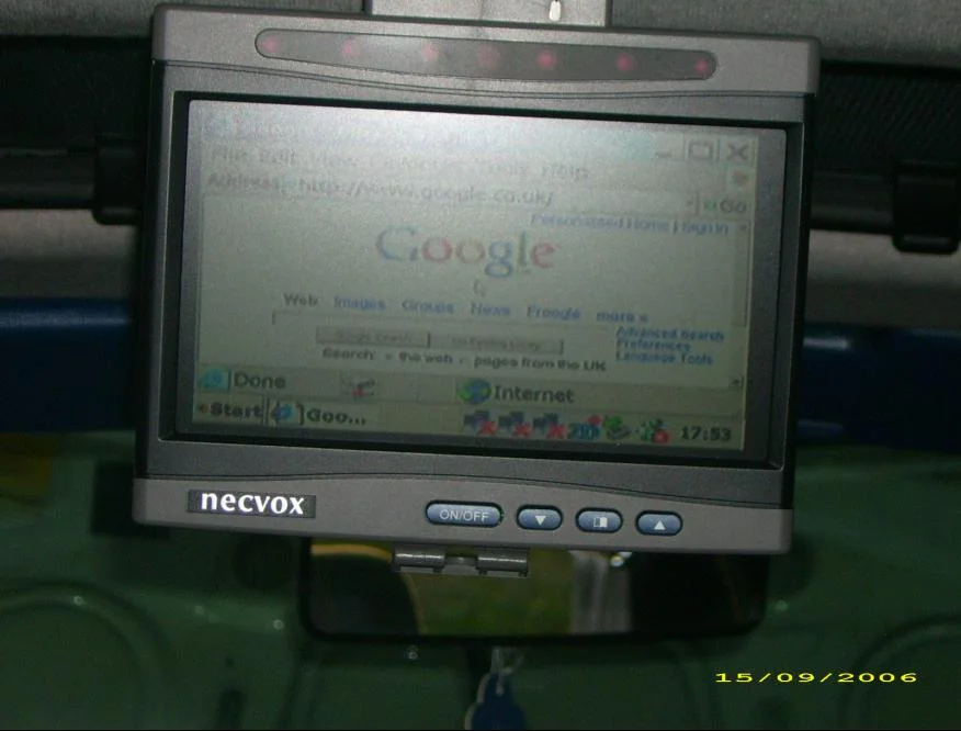

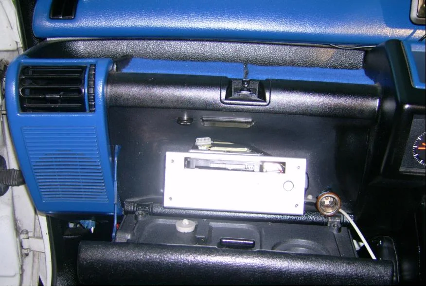

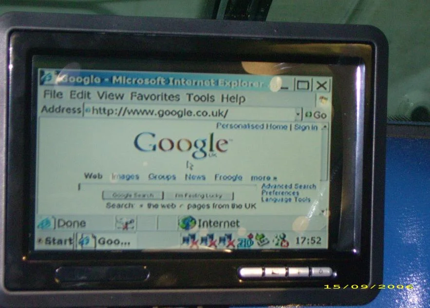

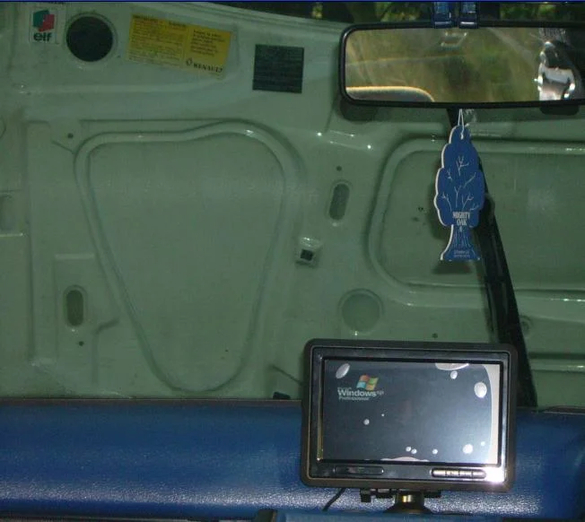

here is my baby :)
just gota tidy the Pc case up and plug in the wire less keyboard :)Comments welcome :)
:) all the power wires and stuff go out a lil hole drilled in back of glove box;)

this is a car pc ;) ITX . M10000 ATX power 12 V mother board:) just made it my self mother board is 4inch :) by 5inchs
got the same as a £600 ready made car pc but only cost me £120 to make

Power'd right from my 2nd battery :)
takes standard 12V input Type Jackplug ( 2 wires, live , Ground )
