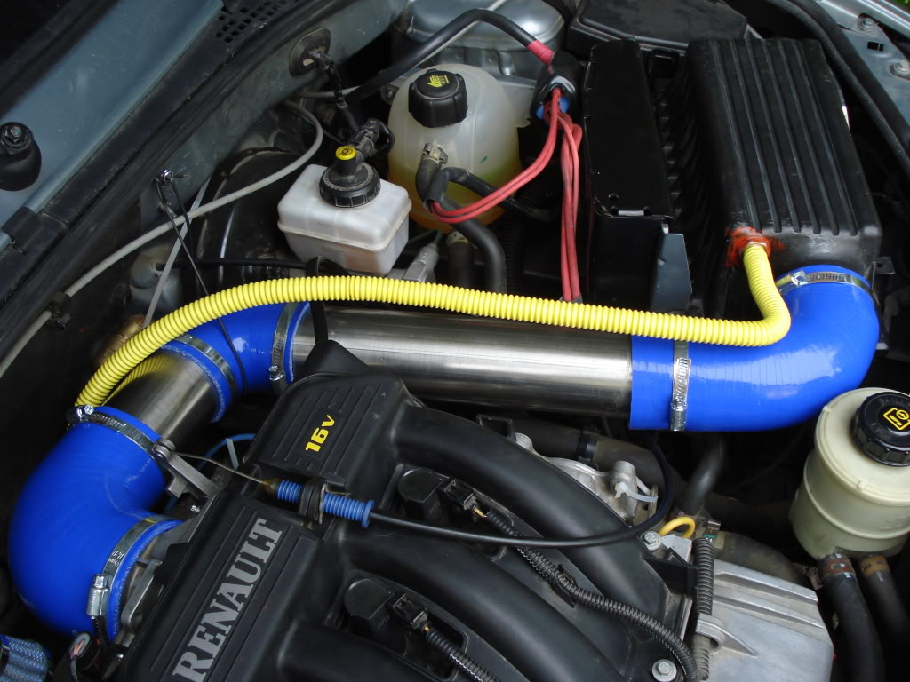

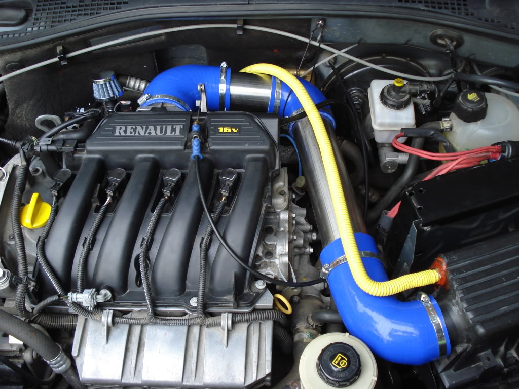

the airfilter box is from a Citroen Xantia 2.0 HDI, i also used S-Hose 90 degree reductions , and 70mmx1.5mm stainless steel pipe

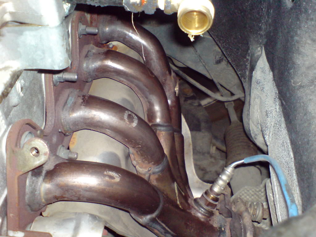

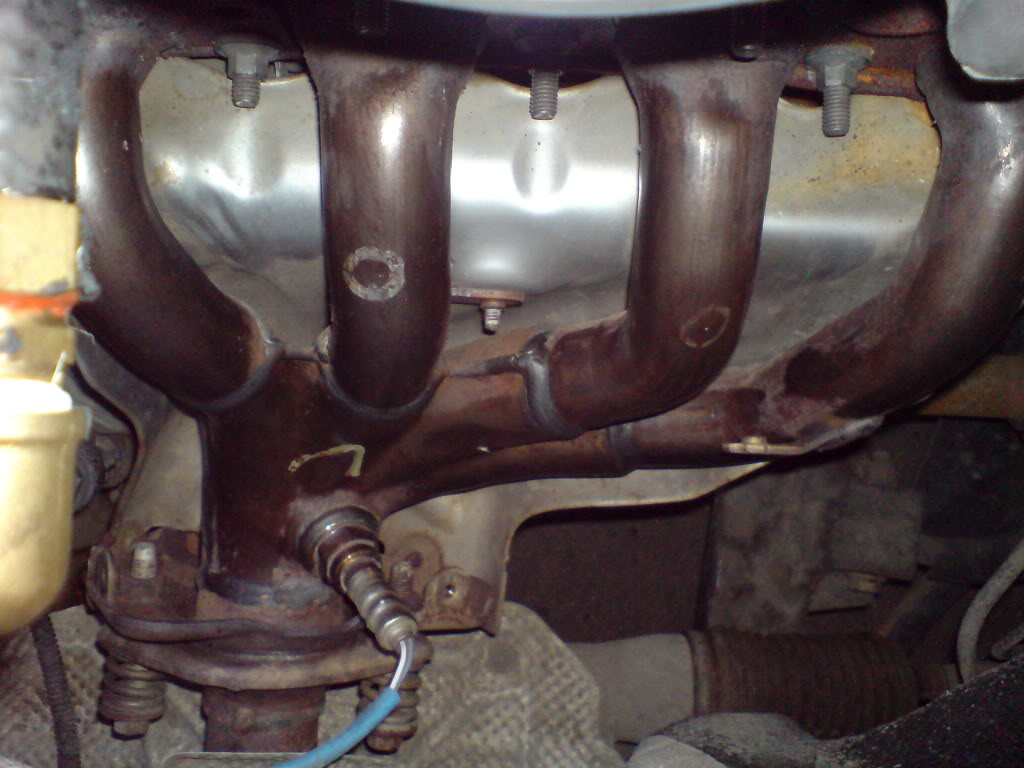

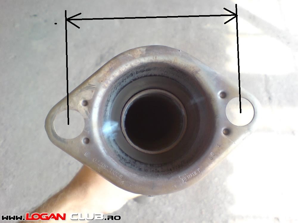

  Logan 1.6 16v K4M

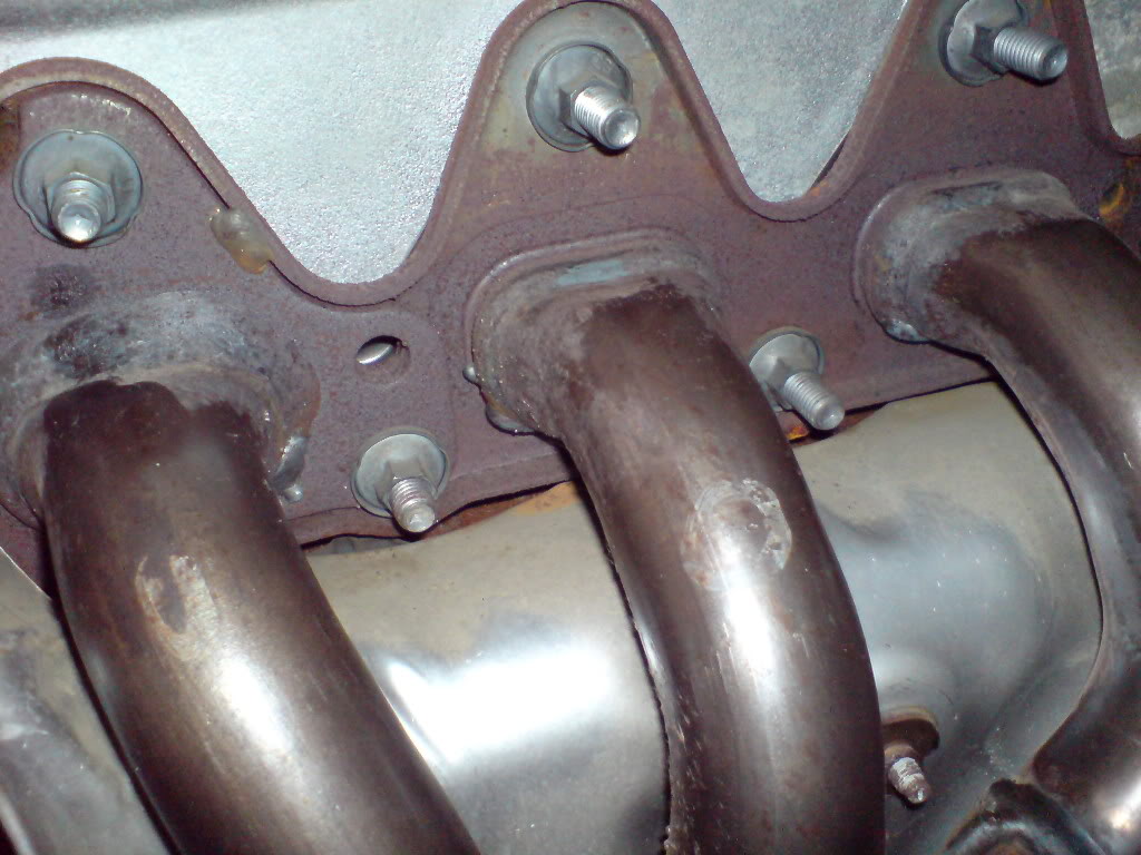

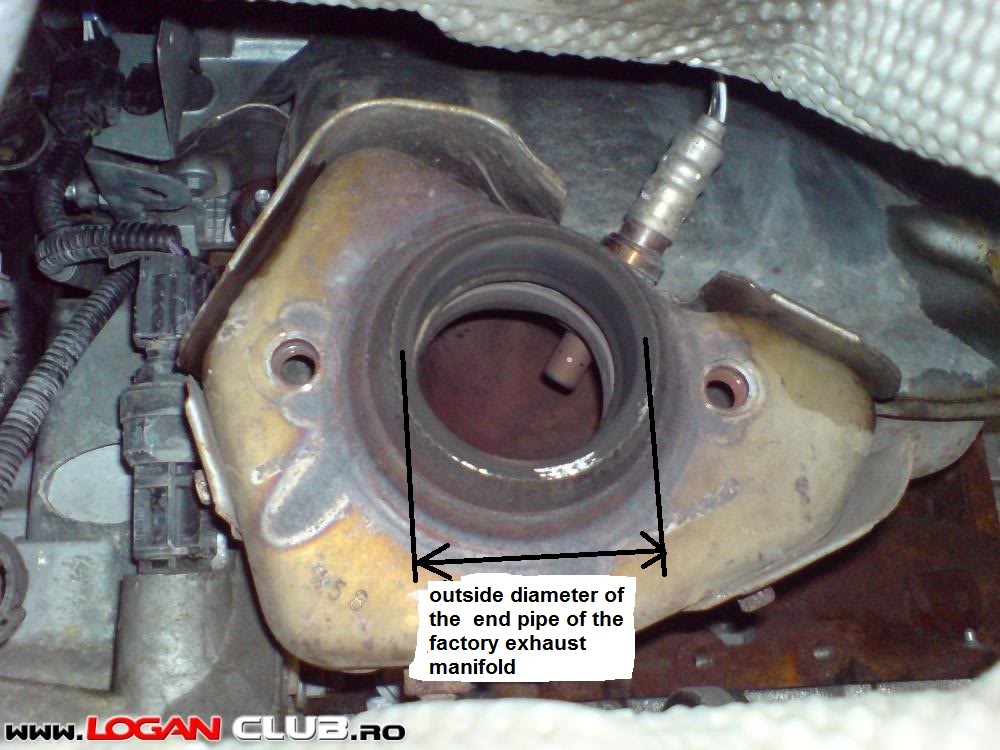

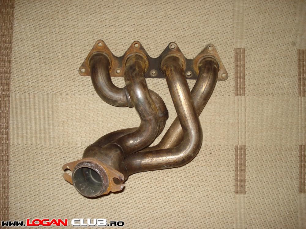

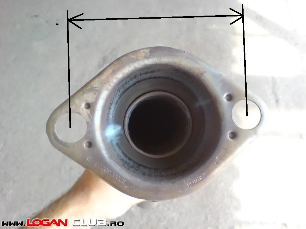

hello, can enyone help me ? i need some dimensions of the stock exhaust manifold. the engine is a K4M 690. the exhaust manifold is the one shown in the pictures above.
1. i need the outside diameter of the pipe that ends tha manifold.
2 the distance between the wholes of the conic flange. thanks
