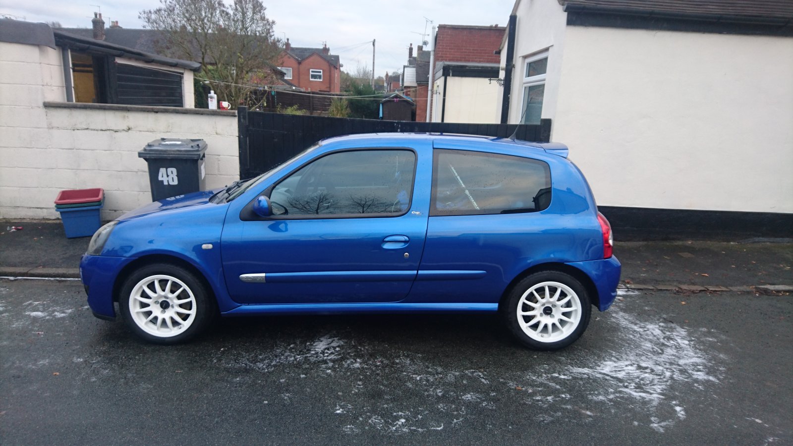

My fast road / track 172 cup
Car  172 cup

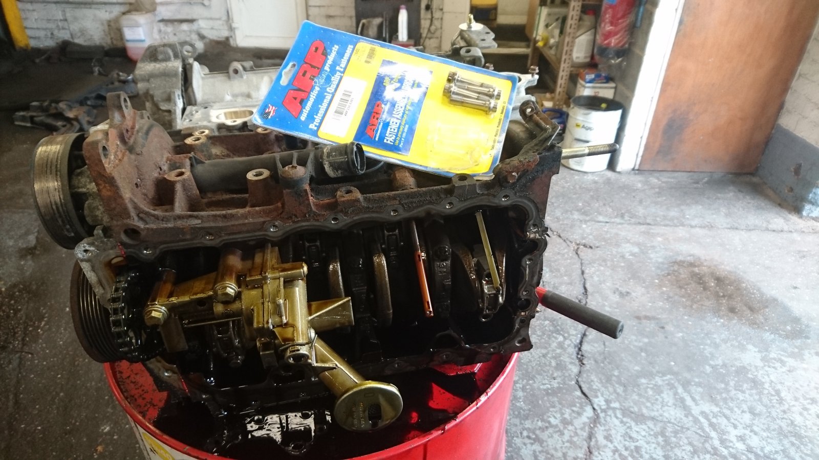

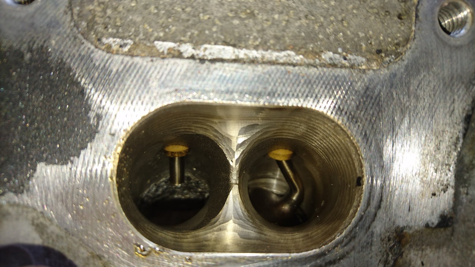

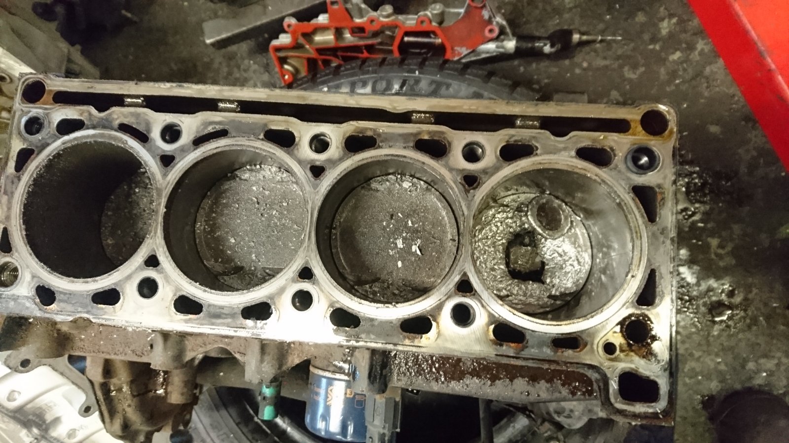

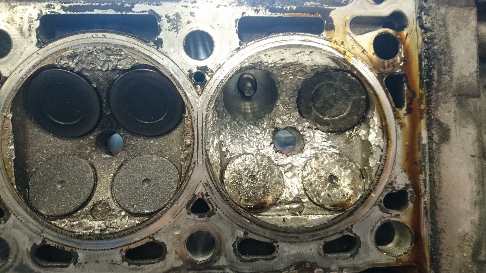

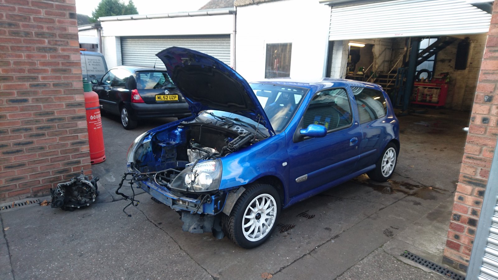

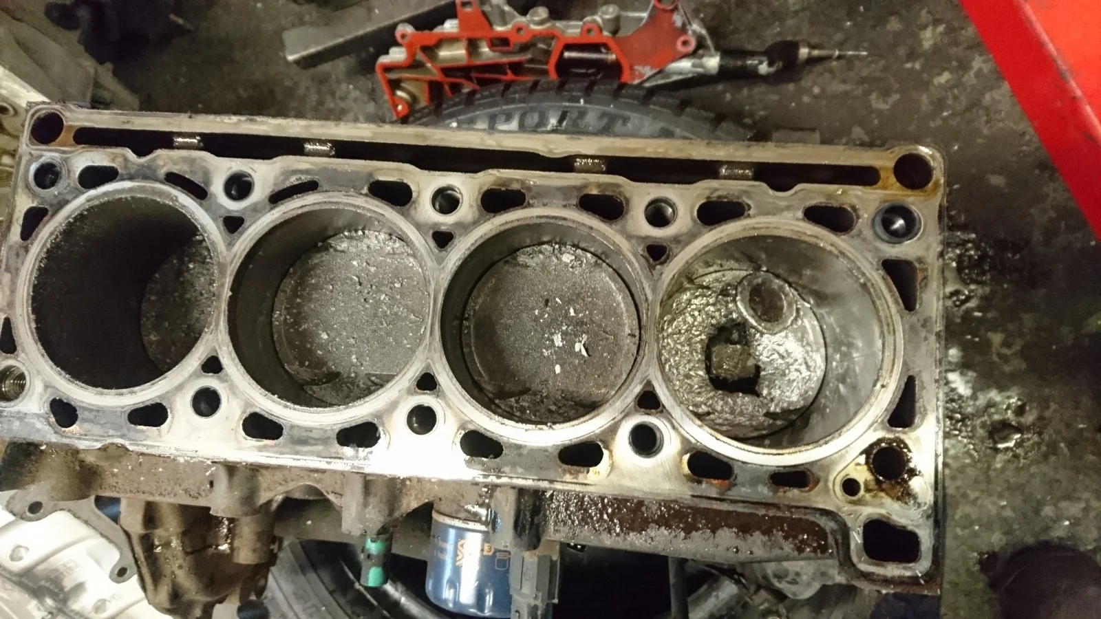

Well I bought it in September of a friend who had spent the previous 3 months building the car to a very high standard with no expense spared but unfortunatly for him dropped a valve on his first trackday in September at oulton park destroying a piston in the process and filling every cylinder with chunks of alloy result dead motor So it ended up at work where I had a quick look and found the aftermath of the dropped valve and the resulting engine replacement required this is where I step in . He made the decision to sell it at this point and cut his losses which sent the small and very simple cogs in my head into motion , there it sat in the yard for about a week max taunting me so all day everyday !! So I bit the bullet and added it to my fleet obviously the wife was over the moon at this and very understanding at least that's how I remember it

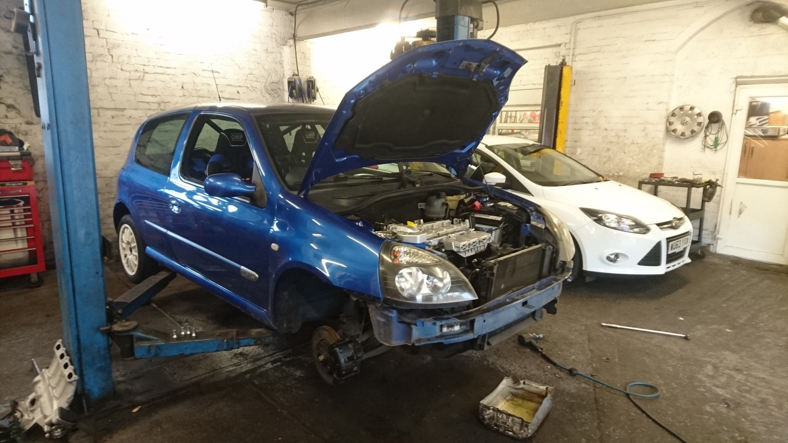

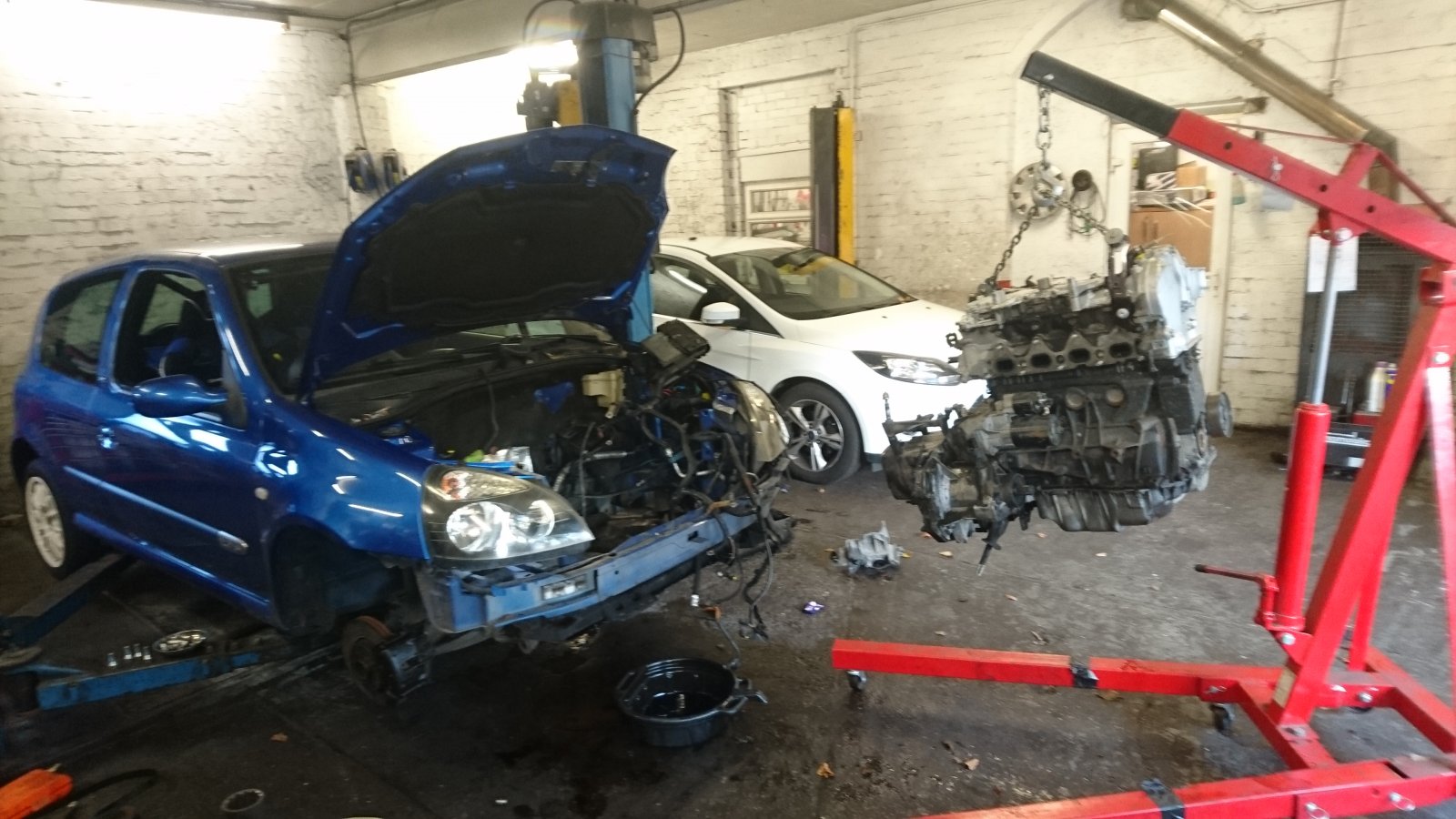

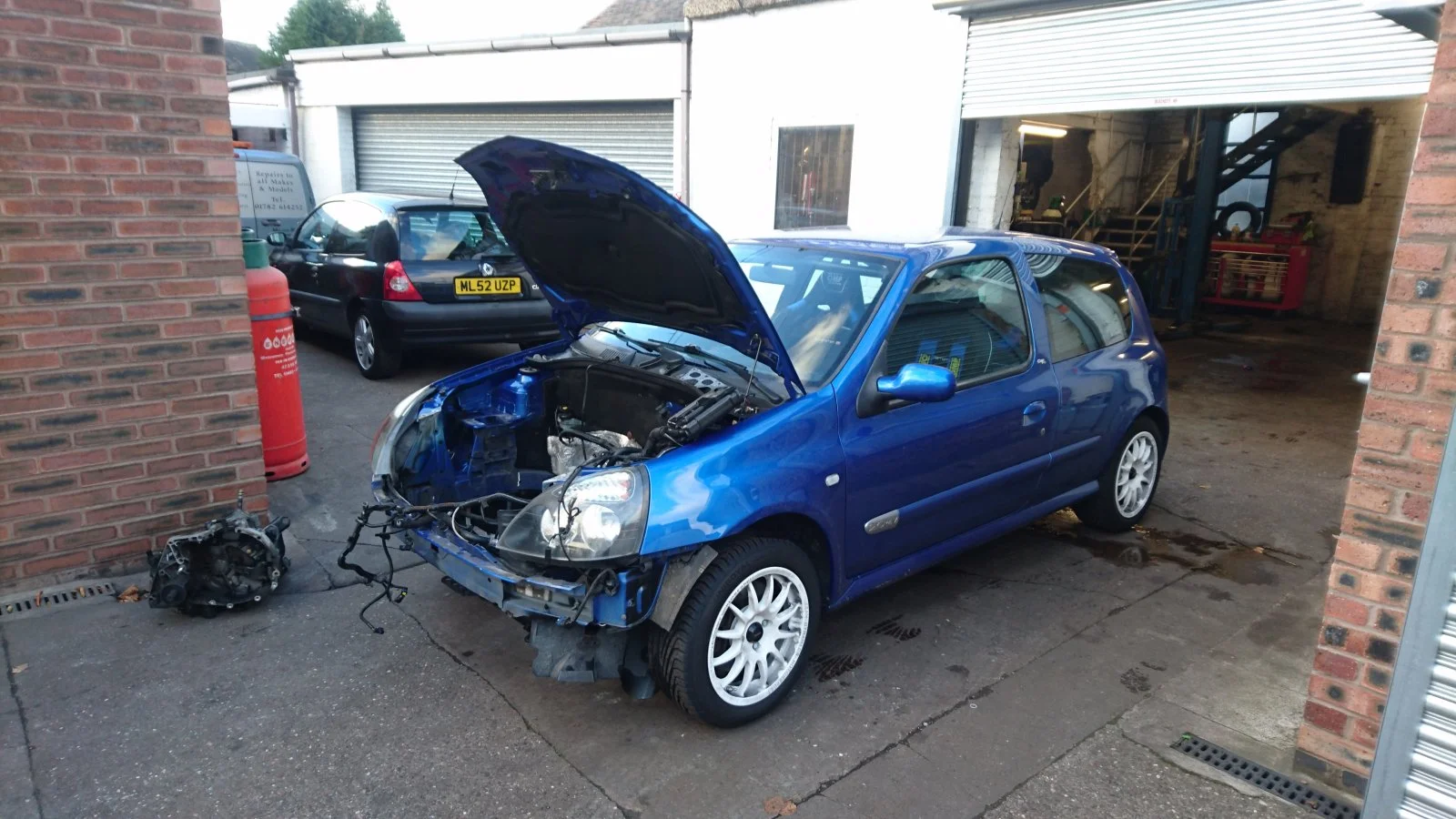

So out came the old engine took about 2 1/2 hours with out even trying to be quick ( at work on a ramp with all the right equipment mind ) was quite surprised how nice they are to take out .
few pics keep this a bit interesting
So old engine out gave the engine bay subframe etc etc a good degreasing and wash down ready for the new engine.

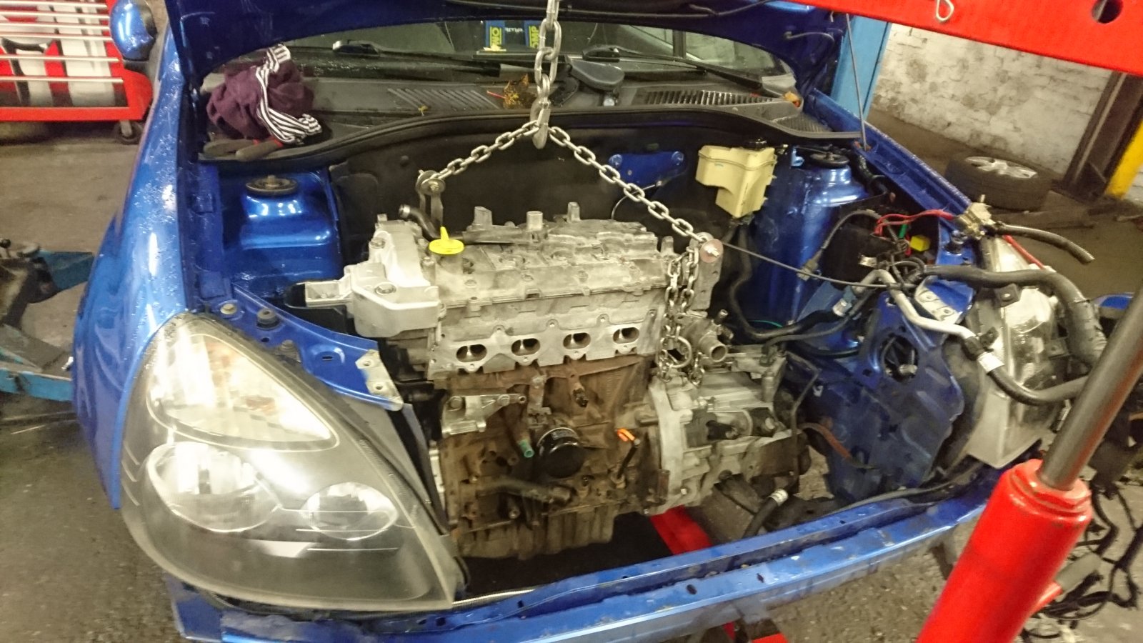

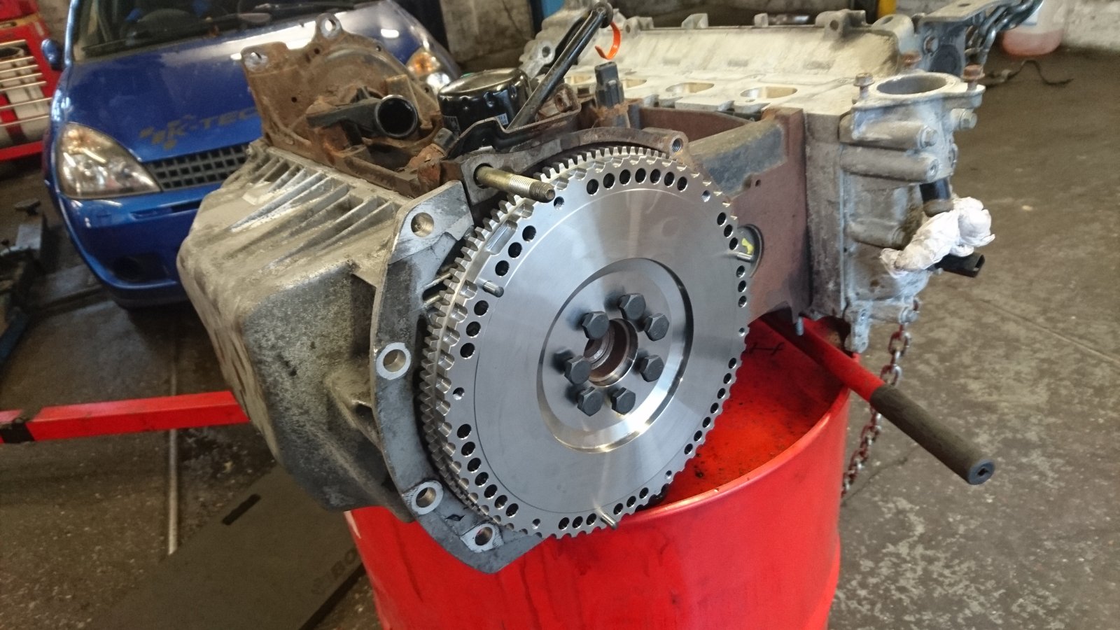

Step in mark (northloop) with the old engine out of his cup which was handily stored on a skateboard which made getting it to my car a breeze . So everything swapped over and sourced a set of arp rod bolts off eBay cheaper than anywhere else which were fitted checked the sheels while I was at it there like new result and a billet lightened flywheel off northloop as well seemed rude not to while it was out ha ha the nearly new clutch fitted start of the year and month old belt kit de phaser and pump swapped over put a new belt on anyway just incase and over the next few nights after work got it back in and running runs like a dream

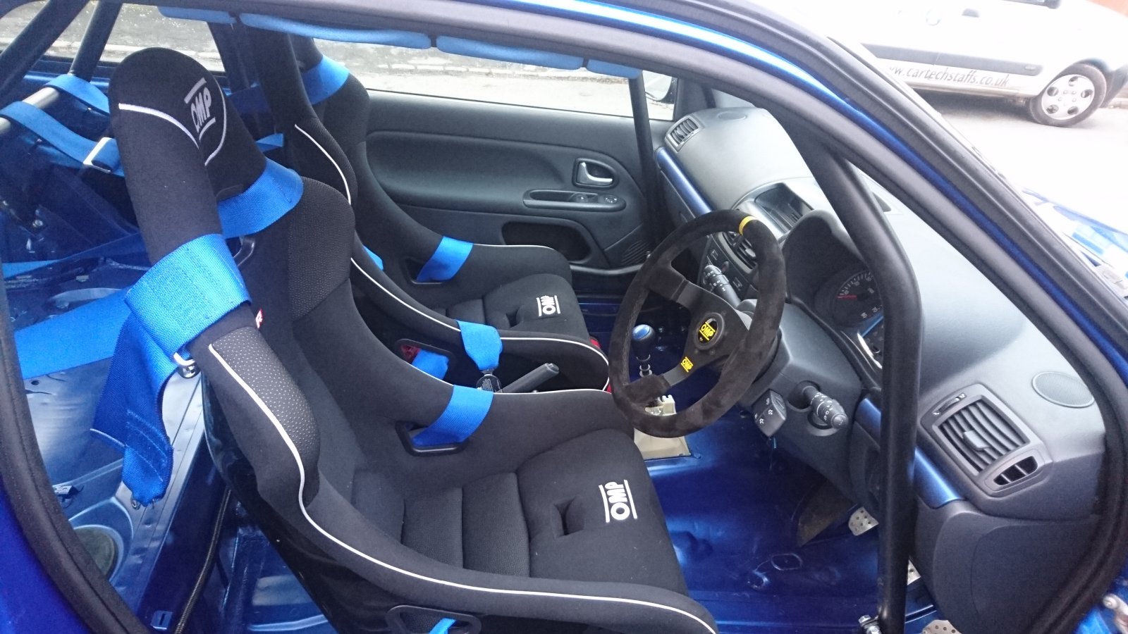

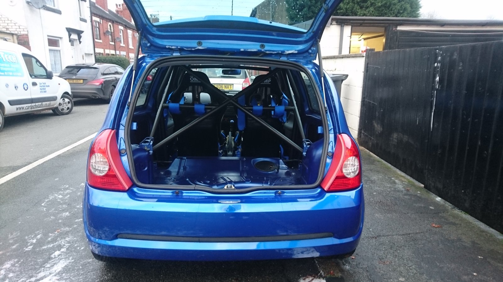

Full safety devises cage
Omp champ r seats
Omp harnesses

Hope they're pics of old engine and not new one [emoji85]

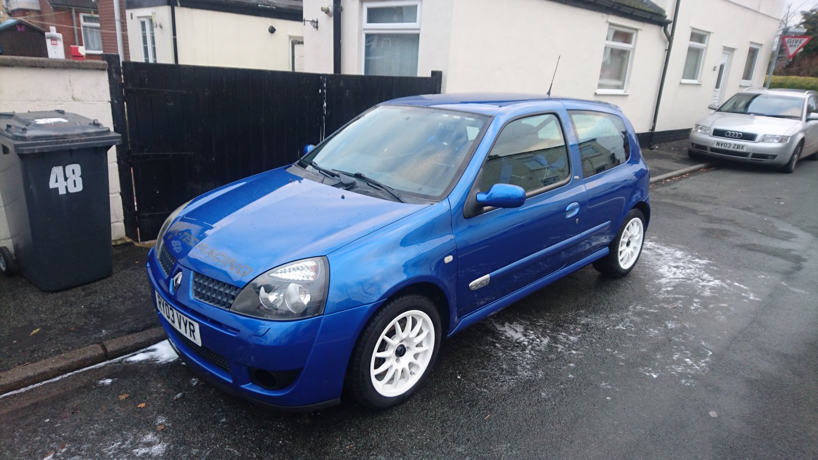

Though I bets make an effort to update this so Dropped it up the inlaws over Christmas as need the space at home for a mini I bought on Christmas Eve ha ha wife loves me had buy my sell something for Christmas didn't i . Anyway that should be on it's way to a new home tomorrow all being good so got the clio back from my overflow storage department (inlaws drive) last Thursday up work for an mot Friday been sat about for a bit so brakes had rusted over over so gave them a strip and rub up Saturday all worked good just a little noisey and a good wash whilst wheels were off bloody wheels take ages to clean properly ! And a good blast out was order of the day Sunday will hopefully have have a bit more time and money to spend on it soon .
Looking at getting some ad08r's for it soon and thinking about a change of seat it's got a set of omp champ r's awesome seat but struggling to get on with them for some reason so a change is on the cards anyone interested pm me looking at the corbeau club sports just want to sit a a one before I order them look a good seat for the money
Really nice cup mate. Just need some coilovers now to drop it off the stilts :tongueout: white wheels really suit it too
