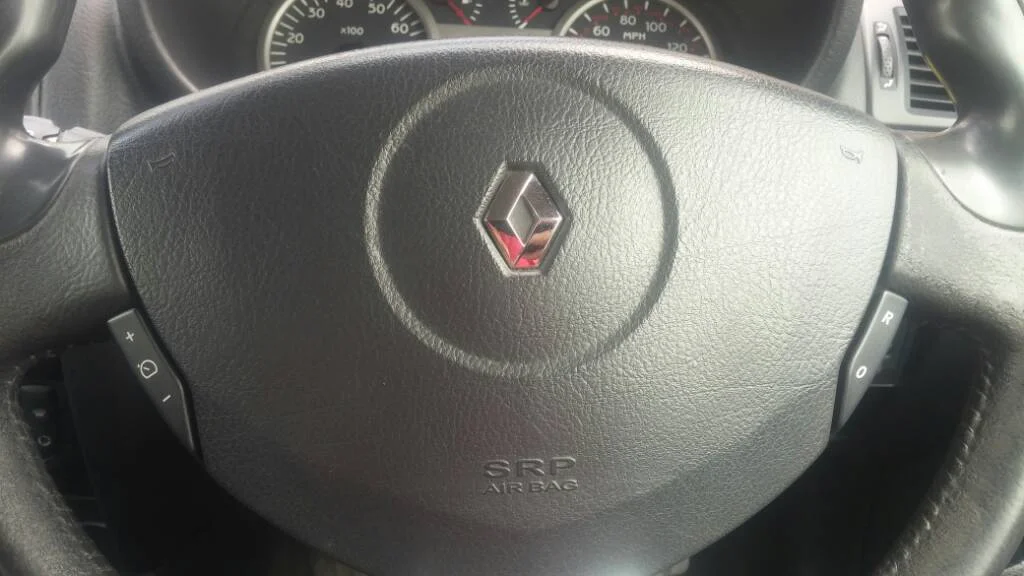

My first electrical gremlin.... it's a weird one!
The cruise control buttons. They have switched roles!
Buttons now work as follows:
R = only button that retains its normal function.
O = + speed up
- = + speed up
+ = O, turn off.
Does this in both CC speed limit mode.
None of the buttons reduce speed now, have 2 buttons that increase.
Very bizarre. [emoji5]
Anyone had this happen?

Dose indicating or using the rear fog whilst cruise is on also cause weridry? If so its the rear light cluster. If not. Magic
Actually I lied. This is my 2nd gremlin. ..... I had the flickering fog on dash when braking.
It was the rear clusters so adjusted the pins on them and that hasn't returned.
Not tried using indicators or fog while CC is on. Will try it tomorrow when driving.
Cheers
  1.6 Focus, 1.6 122S
ahh, if you have had the flickering fog it may be the same cluster.
I found that if I had cruise on, and indicated right (iirc) it canceled cruise.
