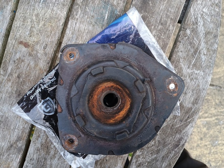

The Clio has had a 'clonking' noise from the RH front suspension since I got the car, and as the noise has got worse recently, I had a look underneath and saw the strut moving about at the top as I jacked up and lowered the hub/suspension arm. So, today fitted a new top mount and bearing. Much quieter now :)
Interesting, the worn top mount hole which is oval now, is worn on an axis from front left to rear right at an angle of about 45 degrees. Do they always wear on that axis ?
Have used the Clio over the weekend on the local country lanes and a 10 mile trip down the motorway. The general refinement and NVH is much improved, so much so, I will change the other (left) top mount as I can hear a small amount of noise coming from that side. The left side has no clonk or play like the side I've just replaced, but I think will benefit from replacement.
