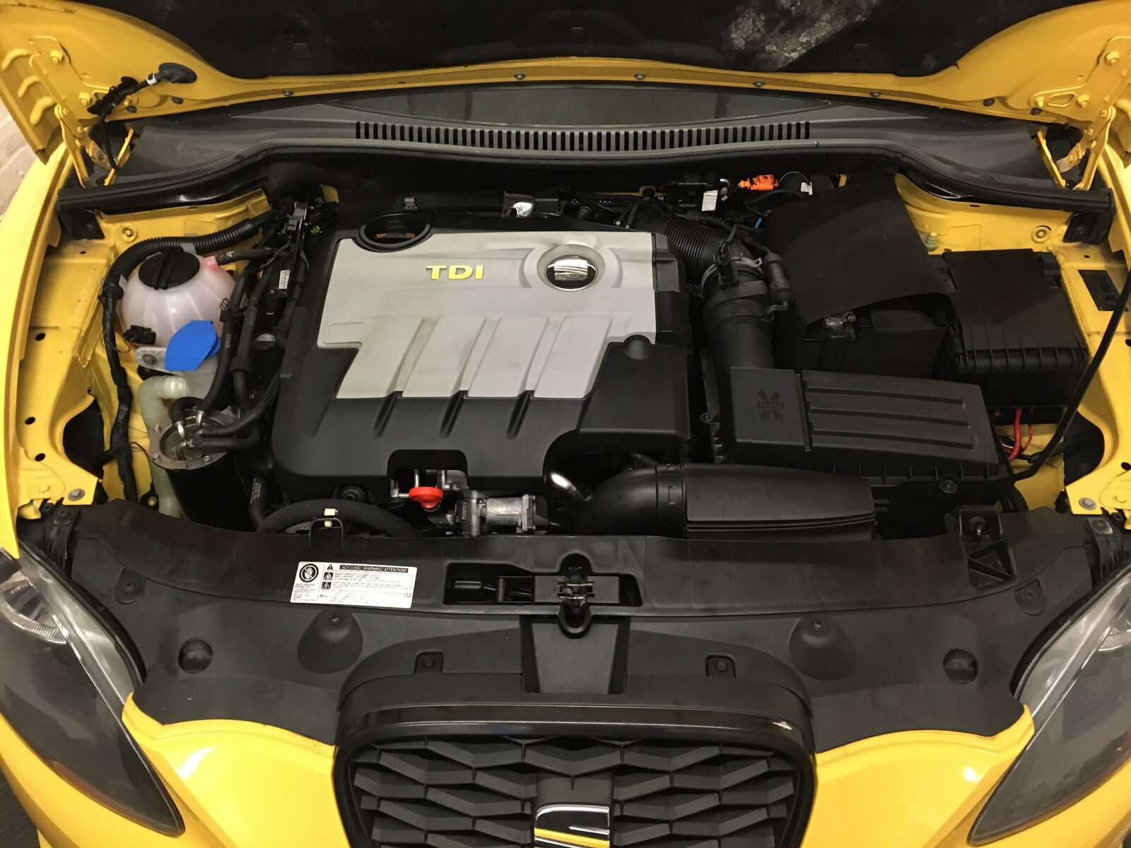

Not done anything with it yet, funnily enough. But in preparation for the suspension arriving I thought I'd put some mystery juice on the wiper nuts. It's amazing how clean the engine bay is, 10 years old and 110,000 miles.
Its clearly been cared for. Which makes the lack of service history really weird. Think I'll write to the last owner in the hope he's got it.
Also, the 18s are reps, think I'll get them sold on and put the 17s on once the plastidip is removed.
R3k1355
Thats been steam cleaned, both thoroughly and quite recently. Looks like they even dressed the plastics?
Ain't no engine bay thats done those miles looking like that naturally, especially a diesel one.

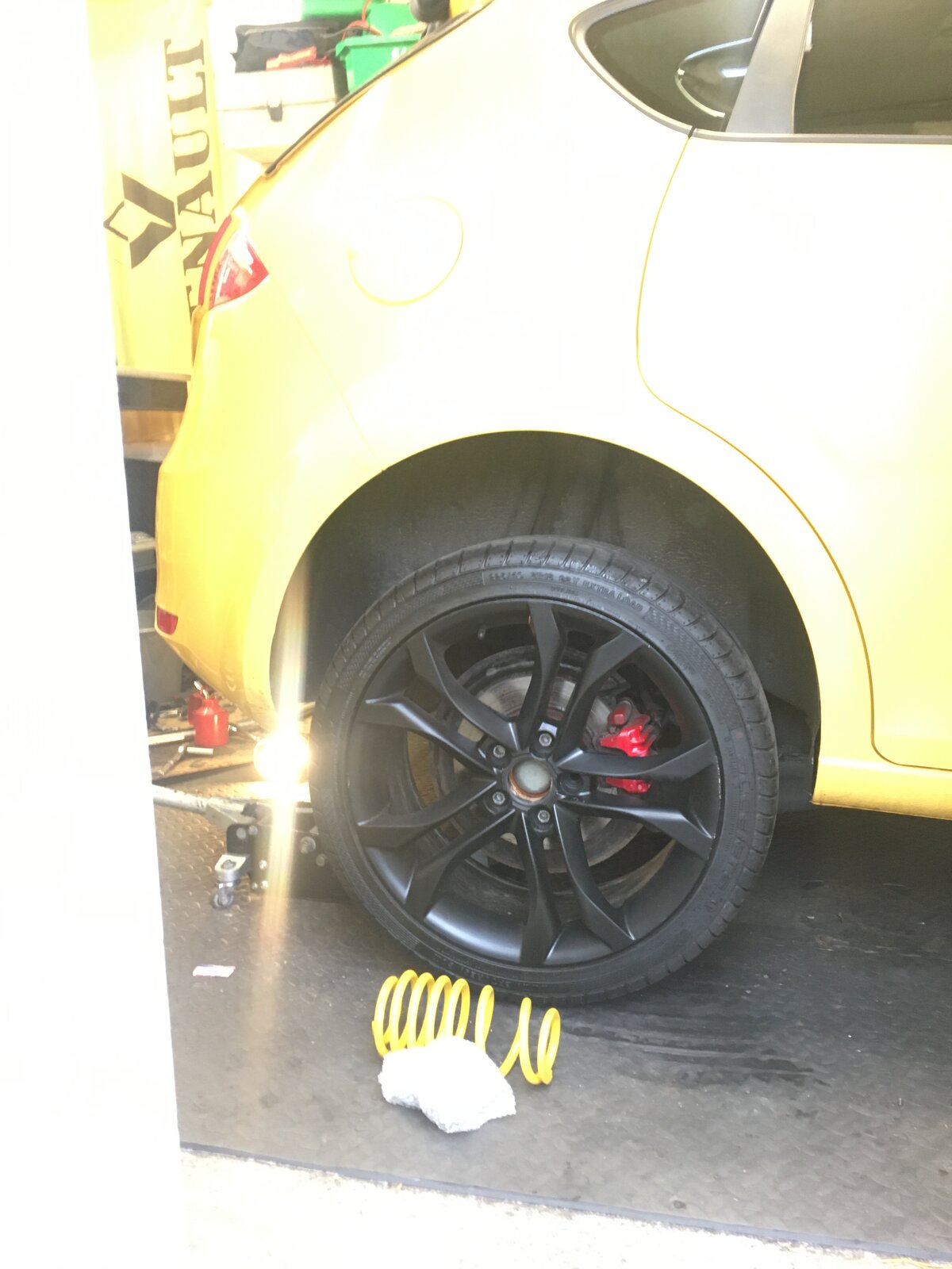

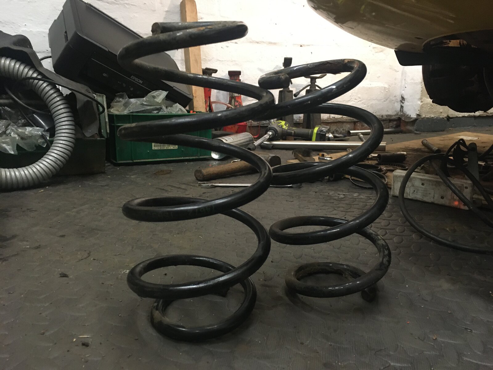

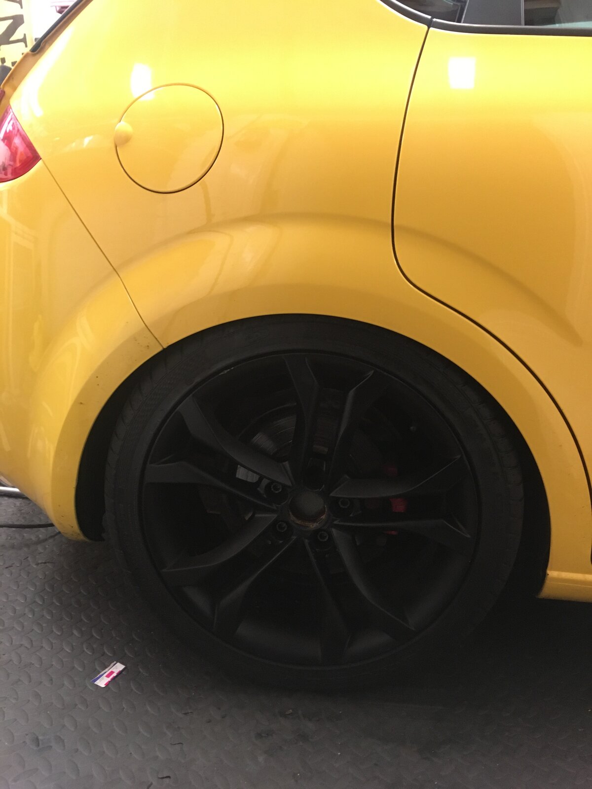

long story short, guessed what height to set the front to, left 40mm of thread, decided that was a bit much but I'd get the rear done and see what was what. Put the tears as low as they'll go with the adjusters still in (lots run without them)
Yeah, got aw the reverse take going on, it's dropped about 35-40mm at the front and 85mm at the back!
No pics of the full thing as I'd outstayed my playtime so came in.
Have a bonus one of the original suspension travel instead, tyre was still touching the ground

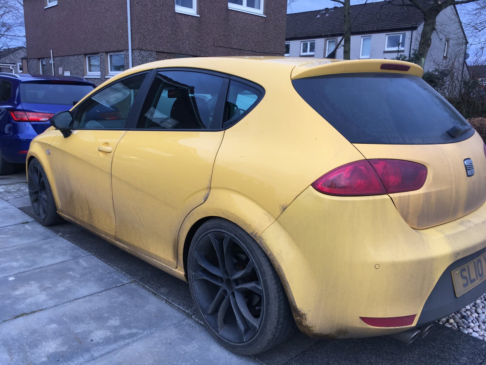

Managed to get a hour to adjust it all. The rear is a pain in the arse as the collars are deep within the arm so you have to dismantle it. At least I greased everything yesterday.
Brought the front down 15mm and the rear up 30mm. It's still a tiny bit of reverse rake if you measure wheel to arch, about 6mm or so but I reckon the front will settle that at least.
Pics still ain't great, dusk yo

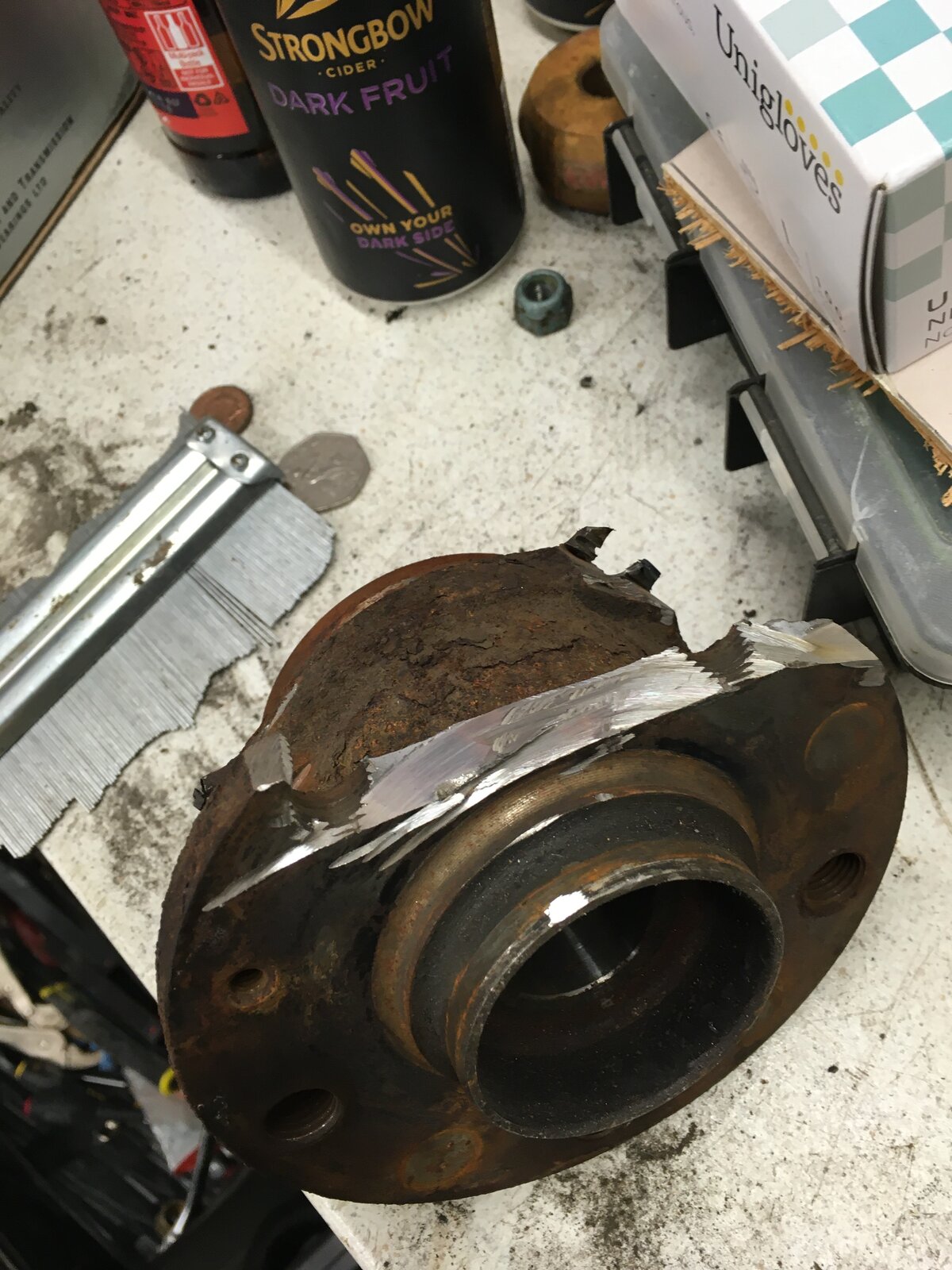

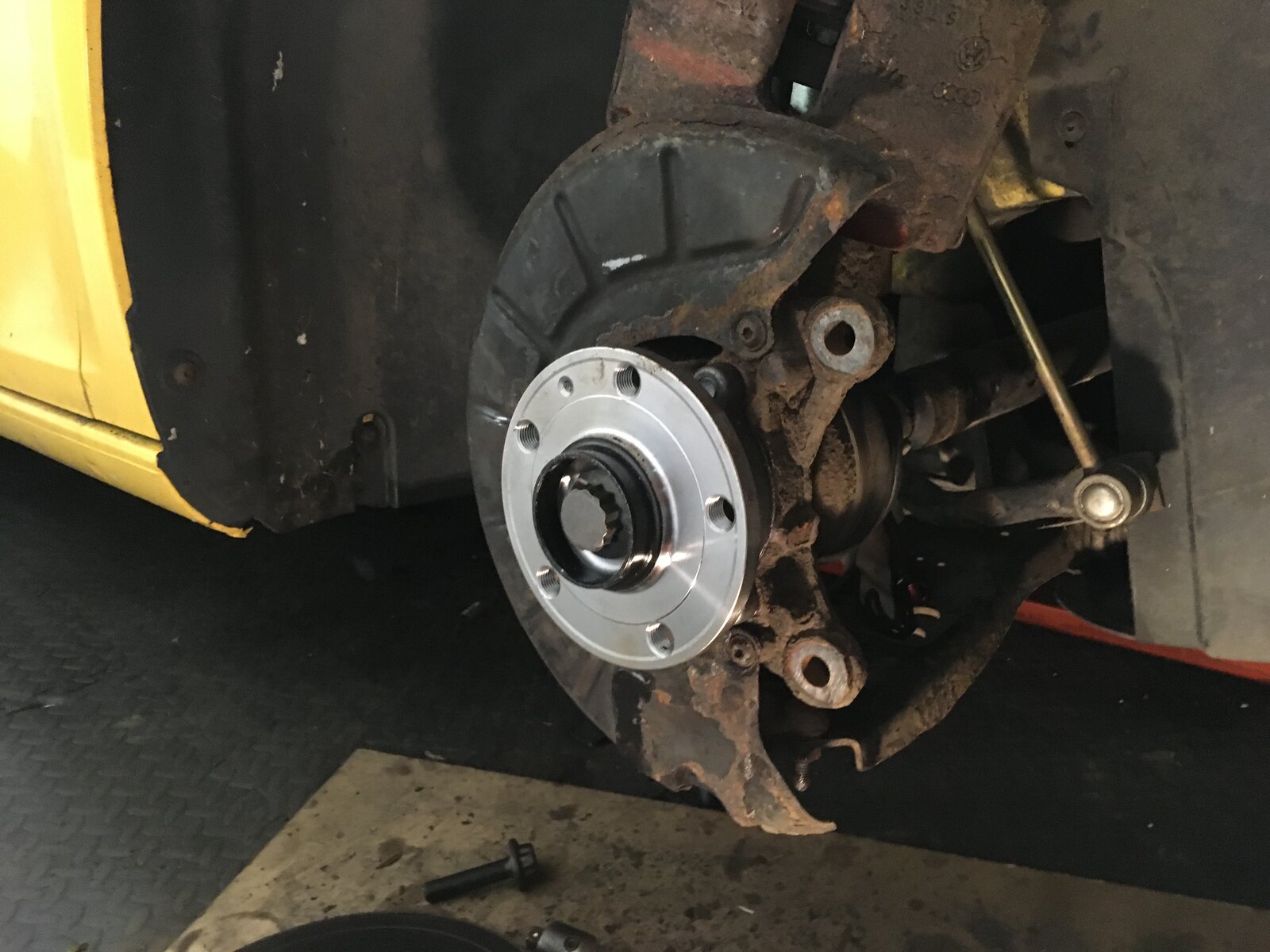

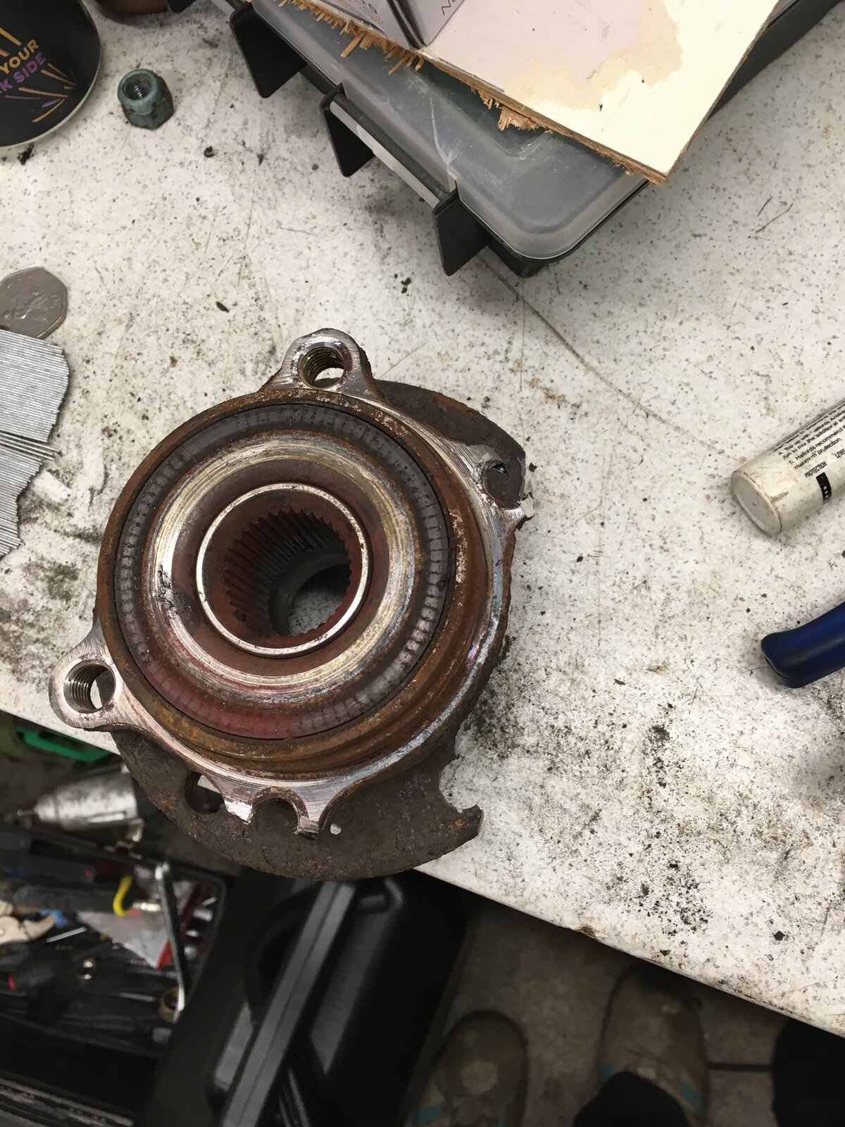

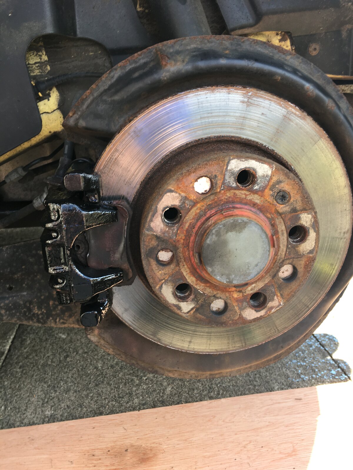

One thing I've noticed is a wheel bearing hum when turning left at higher speed. Given that as of next week it's going to be doing at least 500 miles a week I figured best to change it before it causes issues.
Unfortunately I hadn't charged any batteries for the ugga dugga so had to do it like a pauper. Resulting in 2 of the bolts rounding off and me taking no prisoners with the grinder!
Ground part of the flange off to get access
Then got into the back of the bolts and it came off fine. Did mean I was quite committed to changing it though 😂 at least it felt rough.
I started quite late at night so by the time I finished I couldn't be arsed taking it a drive but hopefully it's sorted.
Was £60 inc vat so happy at that considering it didn't need pressed or that.

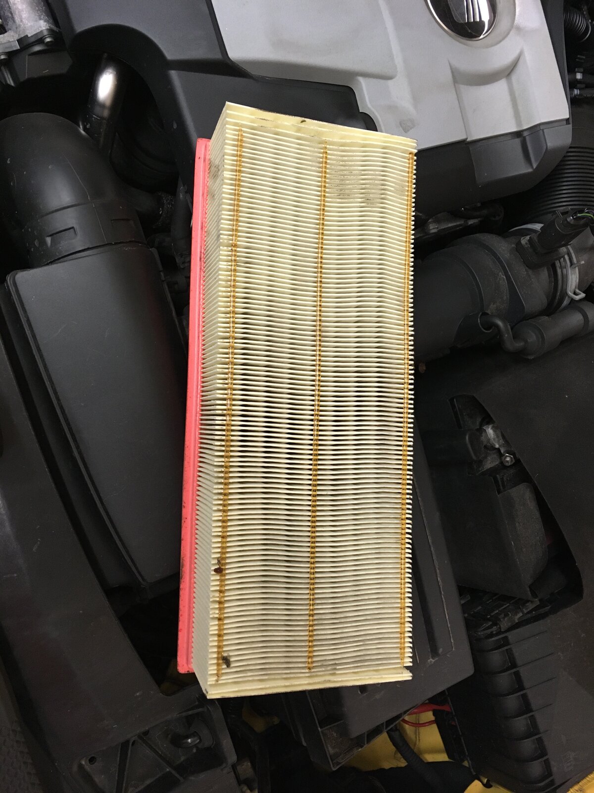

Also thought I should service it since I've no history. But when I saw this
I figured it had been done recently, the coolant is also nice and fresh so I reckon it's been fully done and I'll keep what I bought for a few thousand miles.

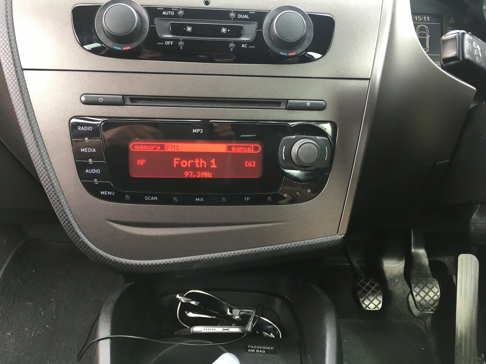

I'm also planning on getting the new stereo ASAP, the current one is utter dogshit and really doing my head in now.
So a digital and CarPlay one will be inbound.

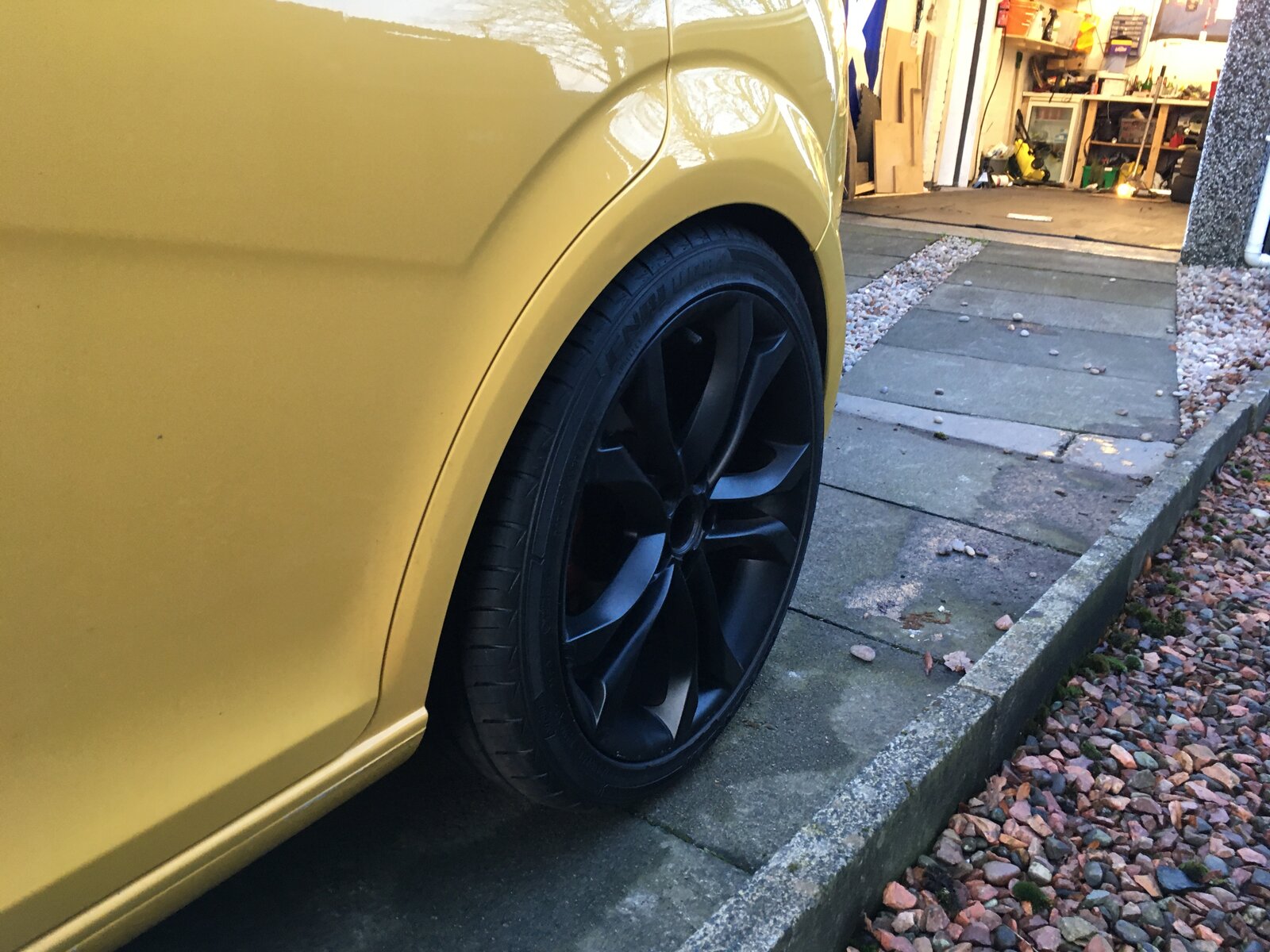

They've really grown on me since lowering it and taking the centre caps off. @Djw Dave reckons I should get some that fit the centre but don't cover the bolt holes so I'll measure them up and see what's what.

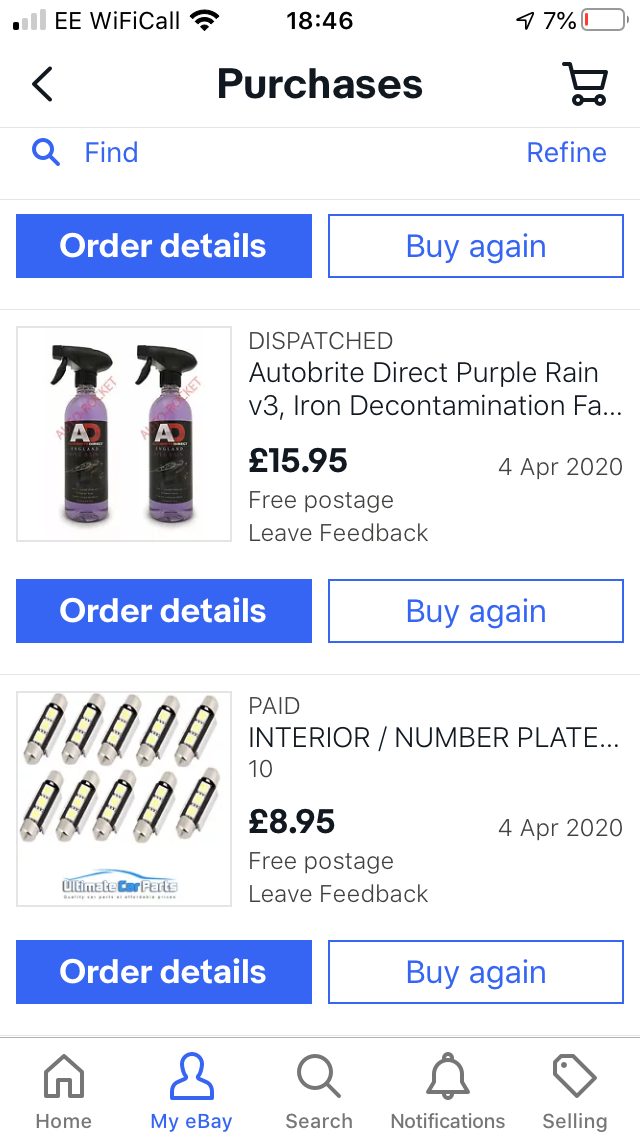

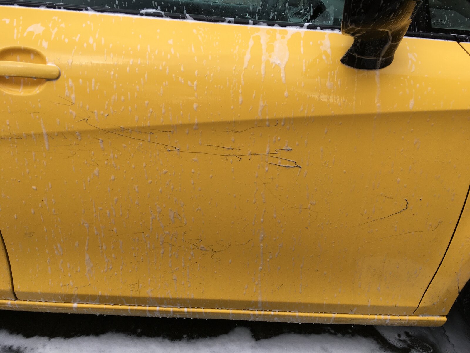

Had a wee bit of AG Magma left so thought I'd see just how bad the paint is.
Bad. Gonna need a bigger bottle!
But it passed the 10ft test at least. It needs a good decontamination and clay then I think there's a good finish underneath it.

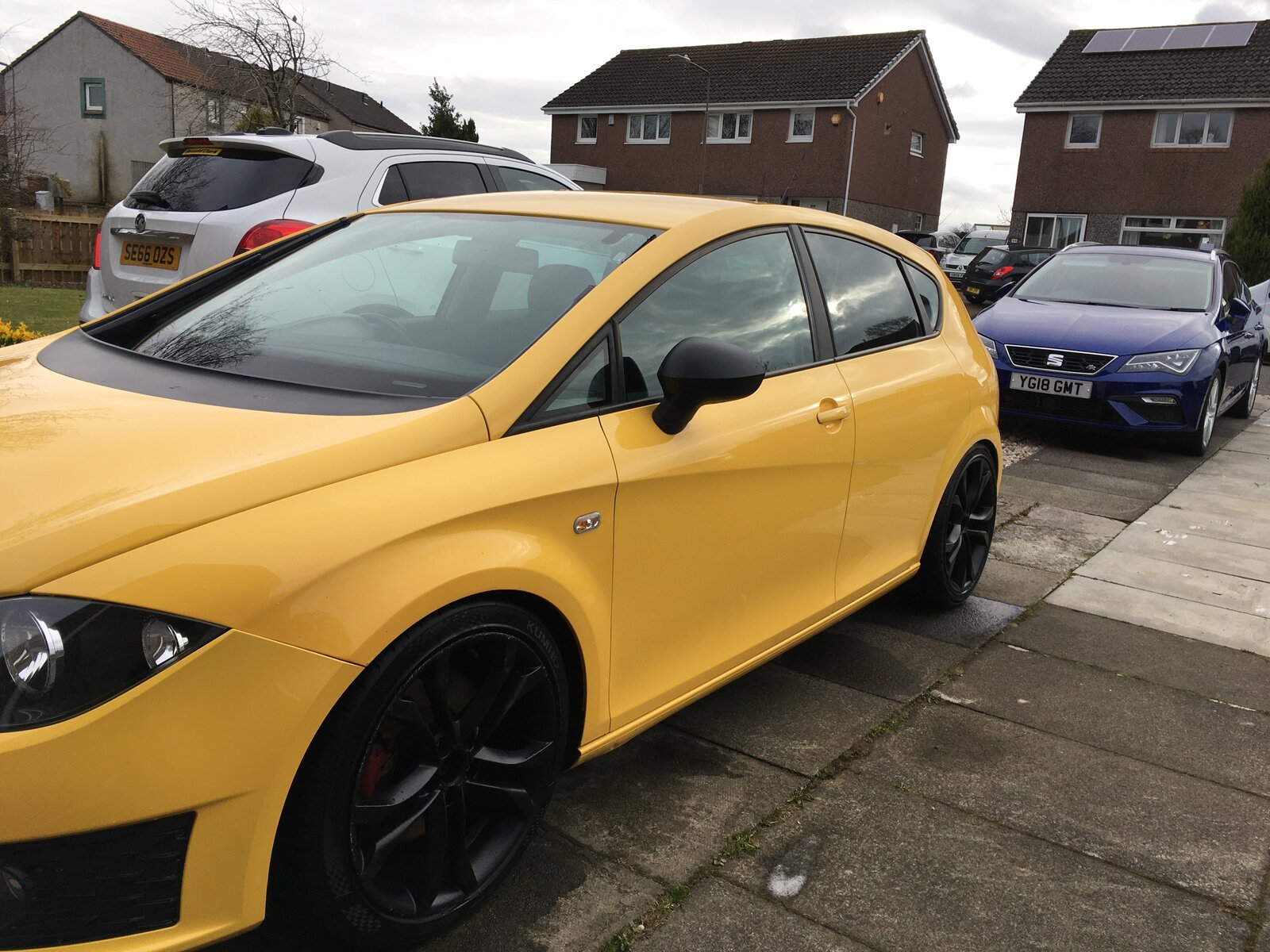

Another 2 weeks, another 1200+ miles.

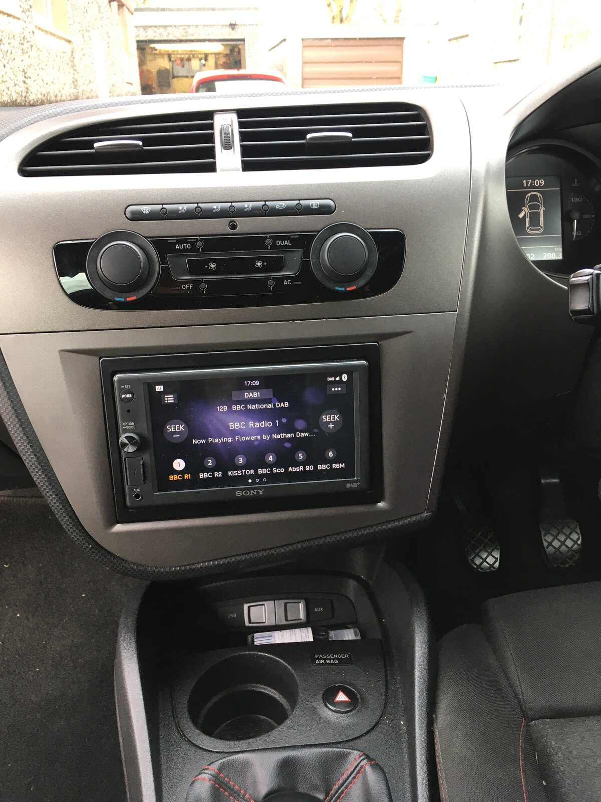

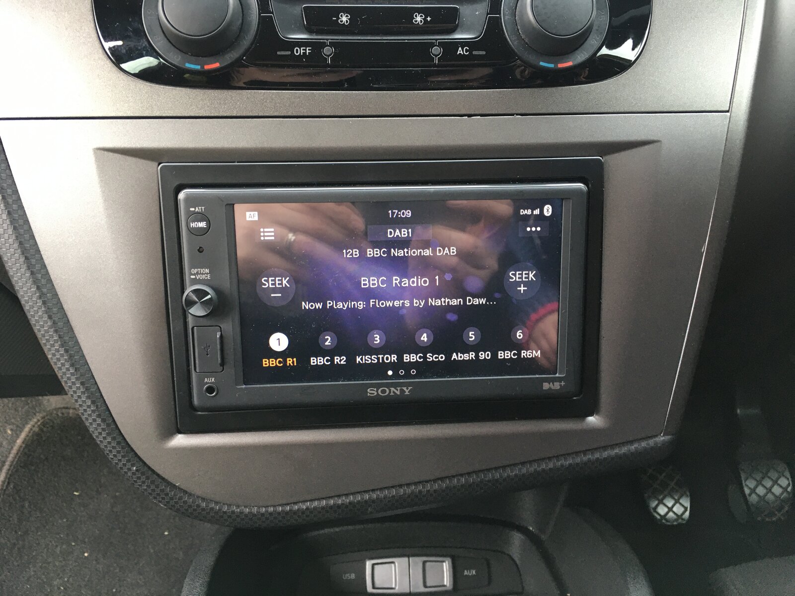

So time for a clean and whilst doing that the postie came with the bits for fitting the stereo. So I simply didn't go inside and thought I'd see how long I could get away with playing for.
Long enough it turns out.
Given that it was the cheapest Apple CarPlay and DAB named brand one I could get in pretty happy with it. The dash will never be exciting but I'll also not care

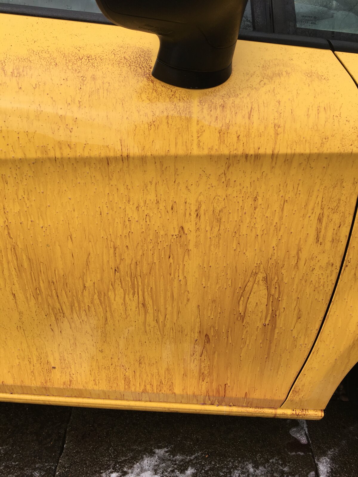

Some how ended up with this all over the driver side midweek, think it was tar
And the mandatory washed it pic.
