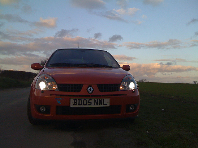

Sorry for the crap pics, only had my phone to hand. Just had the aux and cam belt done :)

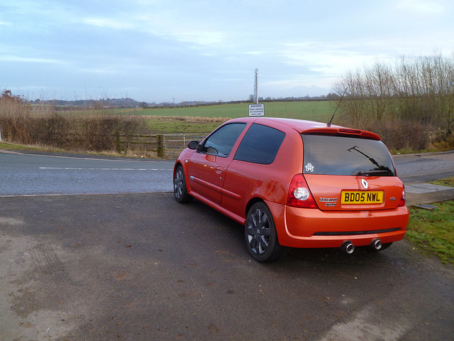

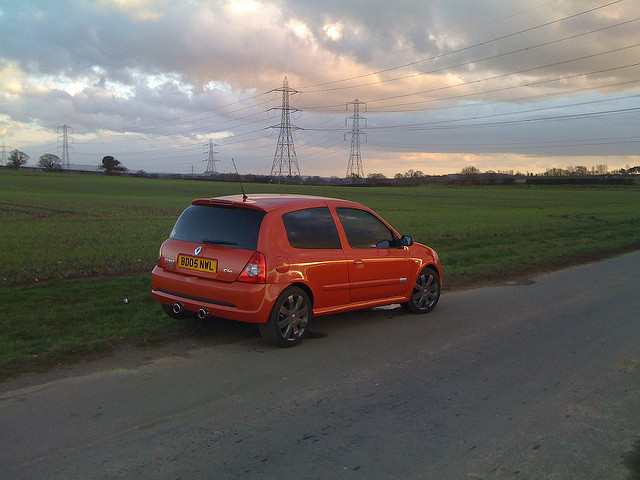

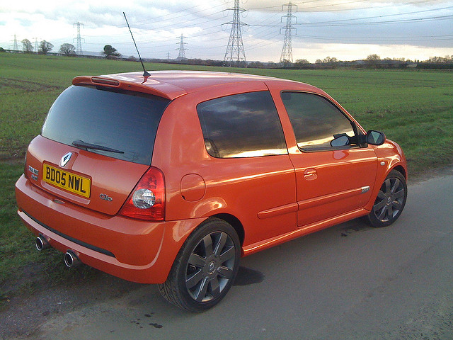

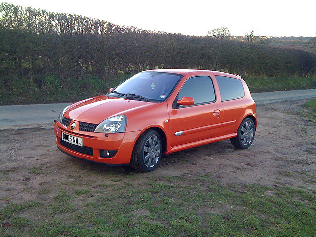

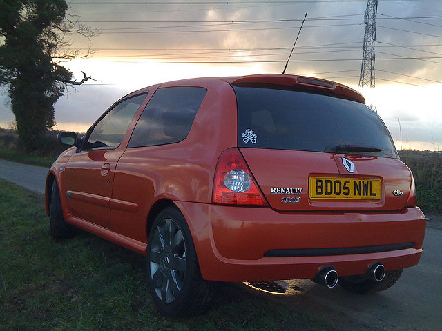

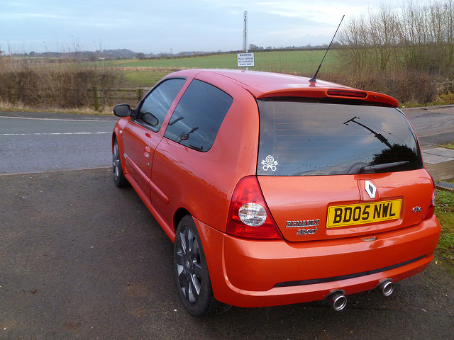

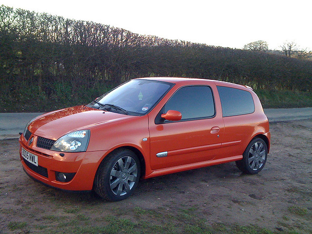

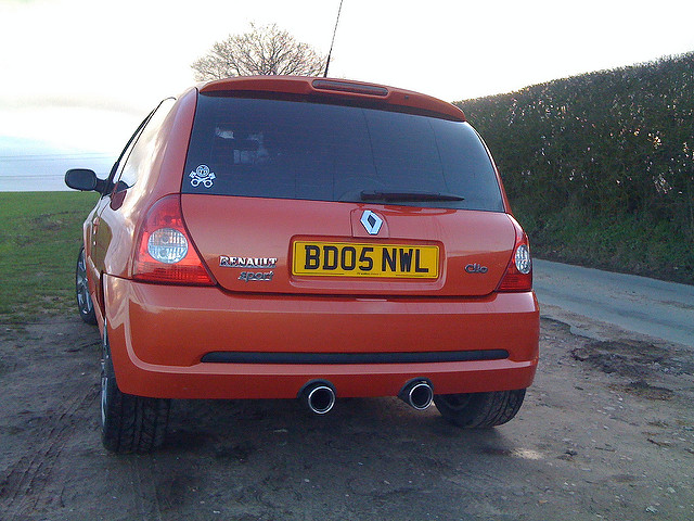

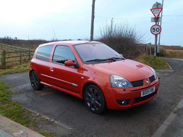

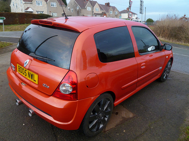

Decided to get some shots on my clio after fitting a scorpion cat back system and giving it a wash. I know its wonky, new mounts are on order as the weight of the new system has really shown up the crappy mounts! Next month I think i'll get some Eibach Sportlines so I can get the stance how I want it.

what have you done to your clio you modified it in any way mate?
  Inferno 182 & Saxo
apart from the cat back and K&N panel its standard. Im going to get it on some new suspension soon I reckon, but looks wise i'll leave it standard as thats what I prefer

good example ....... id personally ditch the tints :) but its upto you we make what we want of our cars

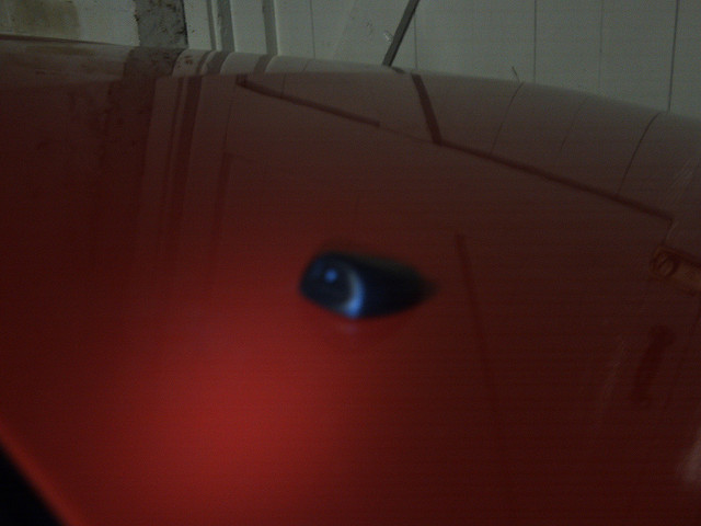

I'm going to keep the tints I'm not usually a fan of things like that but I think they accentuate the colour more. Ive just fitted new exhaust hangers, wipes and Citroën Xsara screen washers which incidentally do a much better job than the standard ones and take 2 seconds to fit.

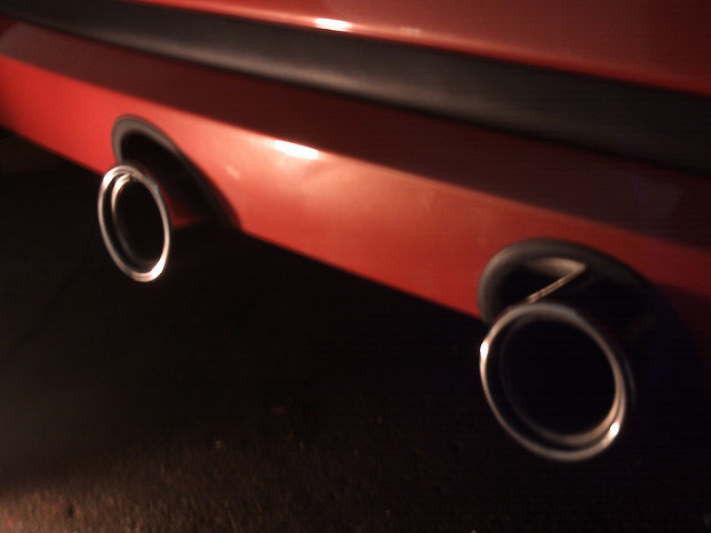

Pipes that aren't on the piss anymore

Old mounts vs New mounts? The new mounts look a bit "cheap" to say the least but they sorted the wonky pipes! Worth filling with silicone?

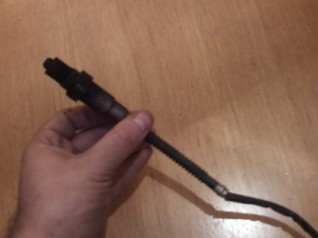

After reading a thread about lambda sensors on here and associated miles per gallon I took the plunge and bought a new one which I fitted tonight. Comes highly recommended as the car was only pulling 28mpg at best, and thats with me driving like there was an egg under throttle pedal! Fitting took about 20 mins with the aid of some plus gas to free up the old sensor from its hole in the cat. Quick spin in the car shows i'm now getting 35 - 40 mpg with the same sort of driving.

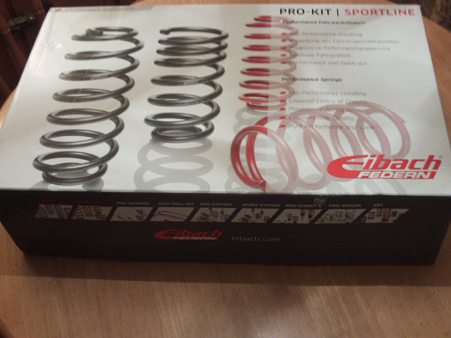

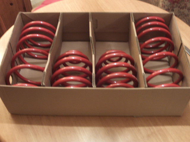

Also the Eibach sportlines turned up from Kam Racing today but I wont be fitting these for a couple of weeks as I'll. They do look the part though atleast!
Old manky lambda sensor
New Eibach Sportlines

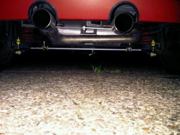

whiteline arm fitted to mine today
recommended upgrade credits to jamsport :cool:
and i know my right hanger is on its way out :p

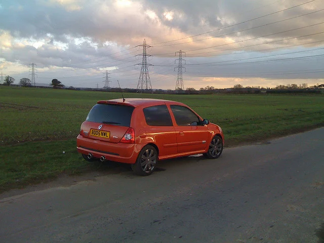

Lush car mate. Very nice to see another 182 on the forum.
Like someone said before, personally id remove the tints but thats your shout.
How loud is the exhaust ? Youll have to get some good pictures with the springs on as i was thinking of dropping mine a bit.

nice car, have you fitted those springs? doesnt look very low :S
i would remove tints and get wheels in high gloss black loose a bit of height and it would look the danglies
