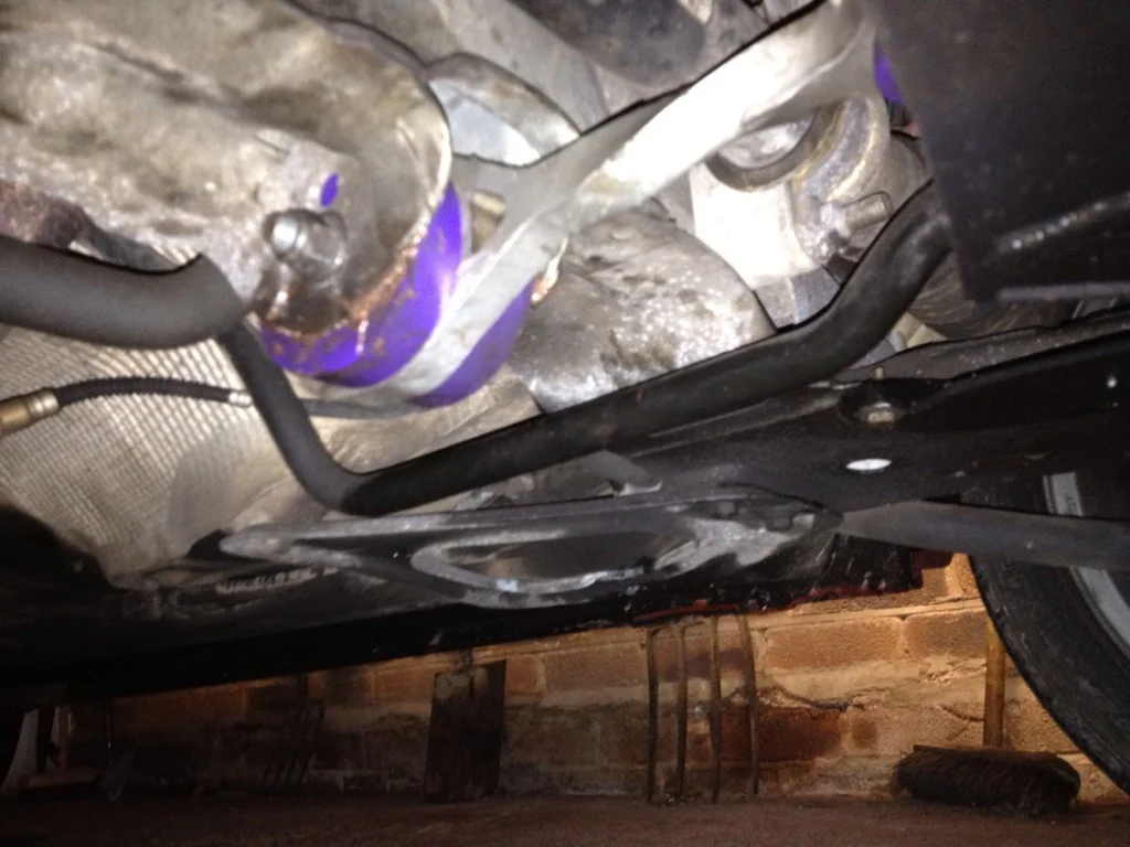

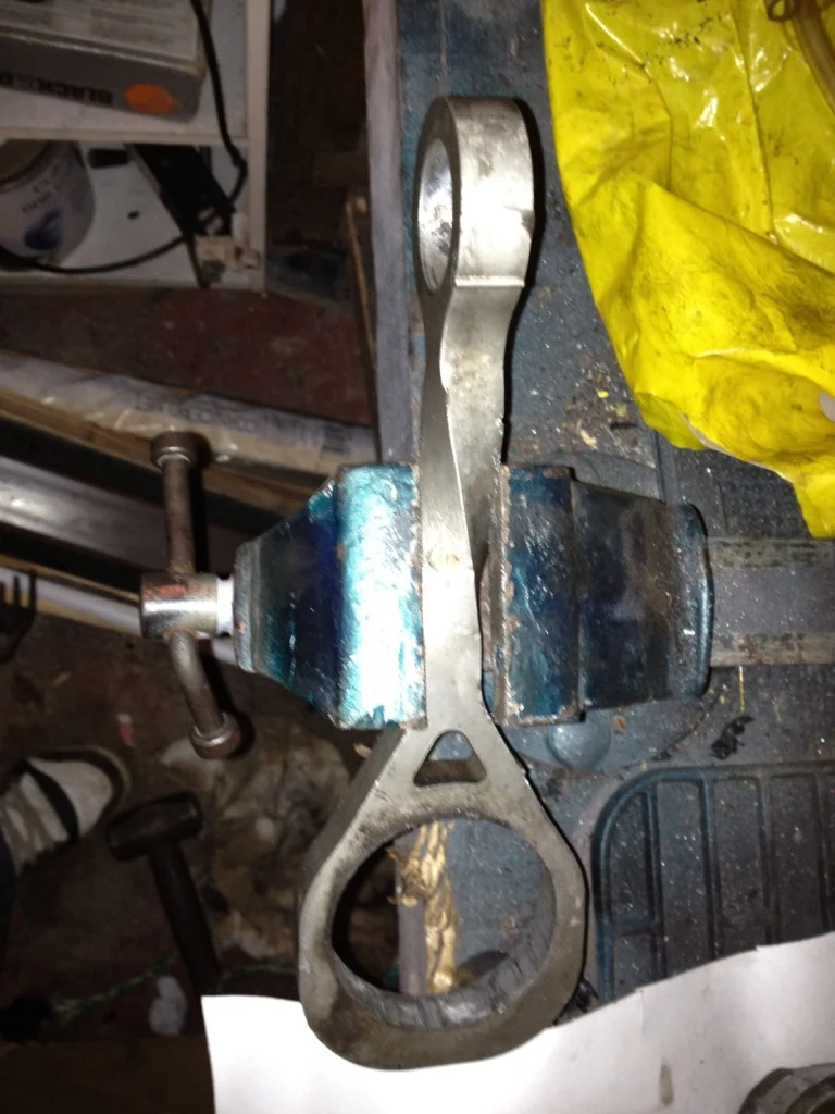

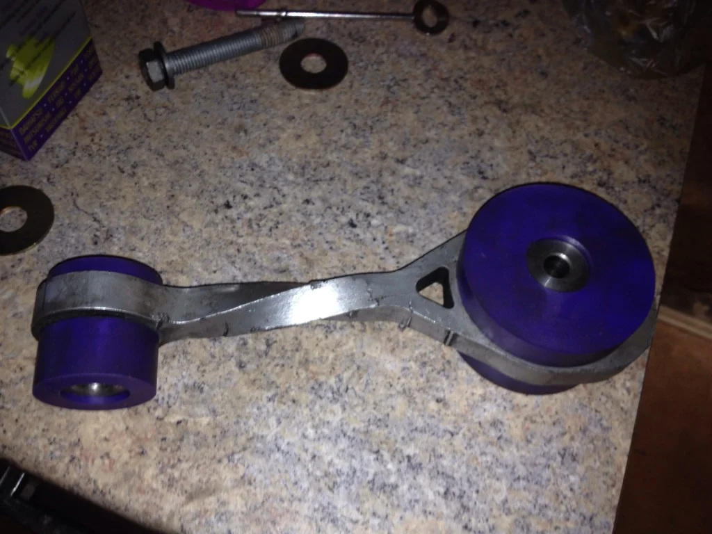

Got bored tonight and thought what can I do? saxo has no new parts to fit so I looked on top of the cupboard and noticed a powerflex lower bush I ordered ages ago for the Clio. Was easy to fit however had to engage the brain as my vice didnt open wide enough - stilsons, old sockets and once bent vice handle later and the bushes were out.
Fitted it to the car from starting in about 30 minutes and makes a real difference! Shift is much more precise, theres slight vibration on idle but nothing I'd call excessive after reading threads on here and obviously this will settle down in time. Also it appears to have cured a "knock" I had going from rolling backwards to a stop when applying the brakes.

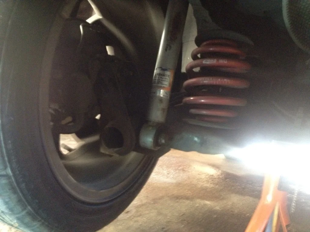

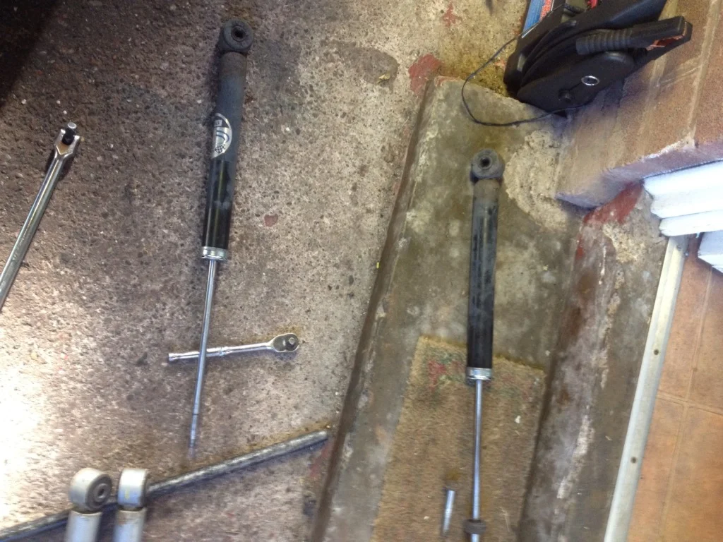

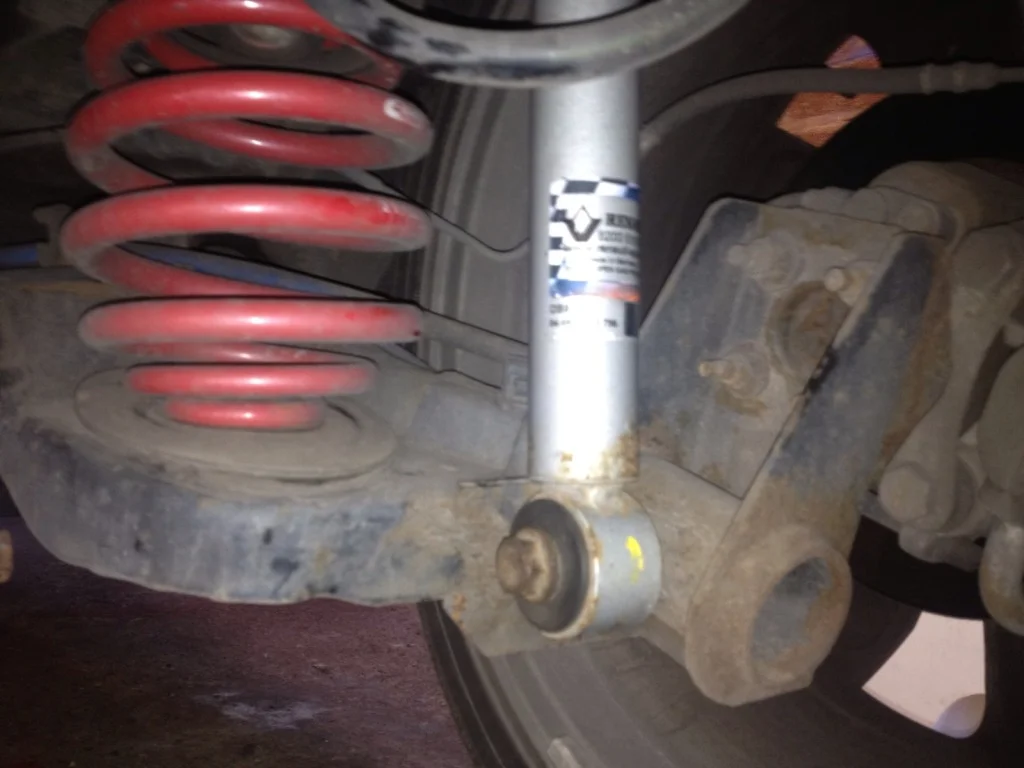

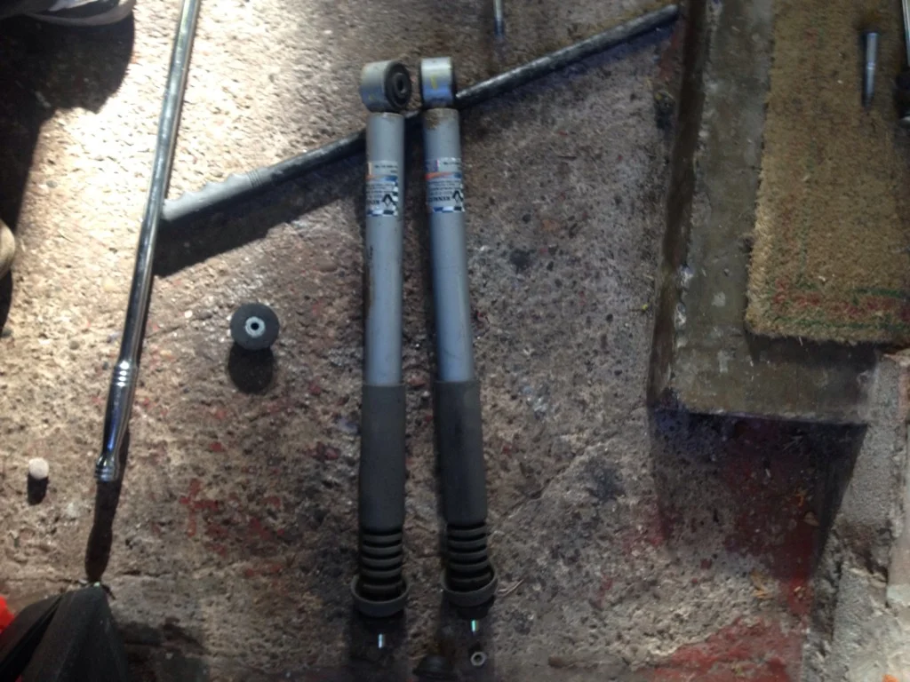

After powerflex bushing the saxo last friday, I came across another set of trophy dampers on fleabay, won them so off came the non-OEM cheapo dampers and on went the sachs gear. Really stiffened the rear of the car up, much more confidence inspiring when driving quickly I find plus they are a touch stiffer than cup spec dampers I believe.
Old dampers
Sachs rears assembled with dust covers
Fitted
  Inferno 182 & Saxo
Those cheapo damper were so easy to compress in comparison, should really have got them off sooner

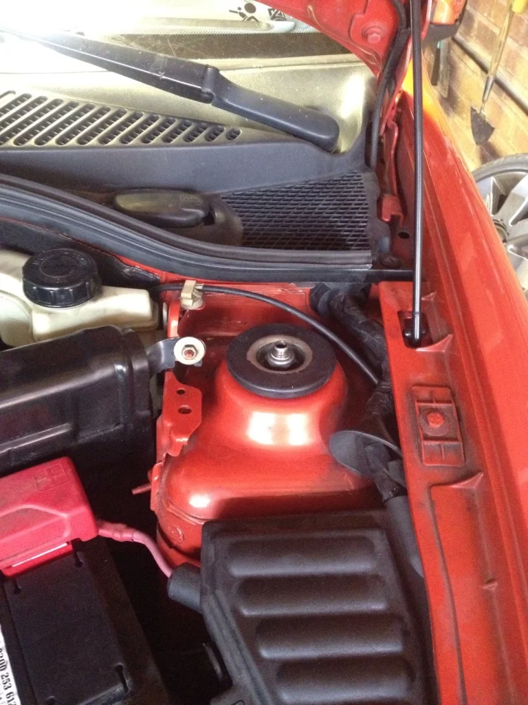

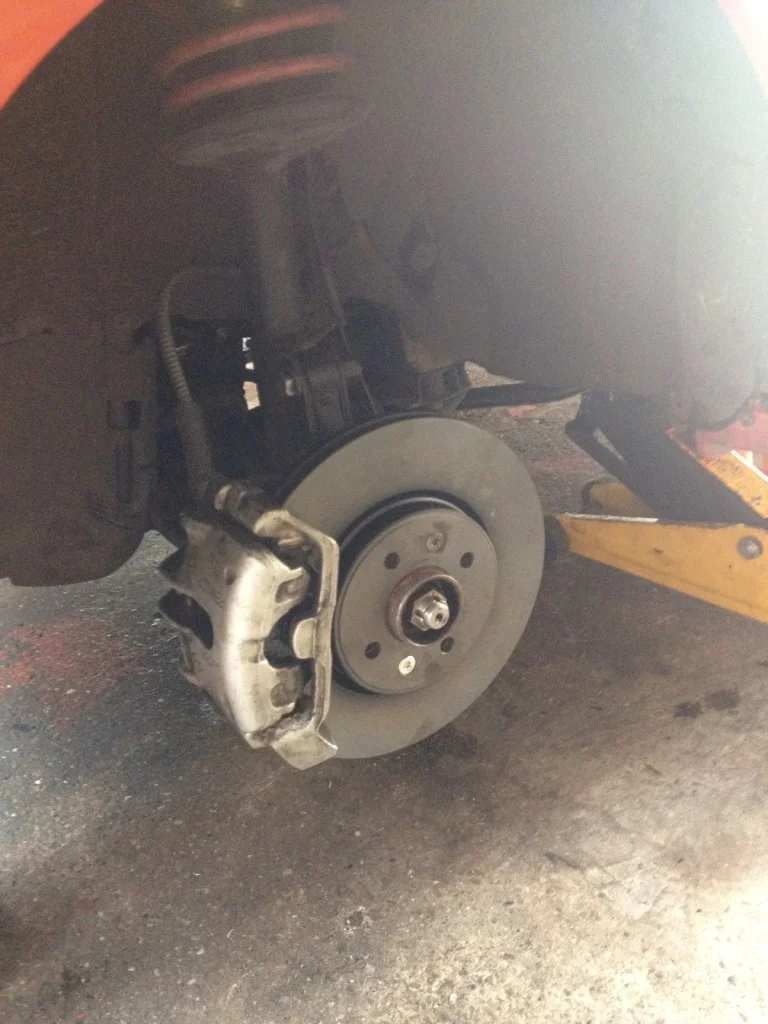

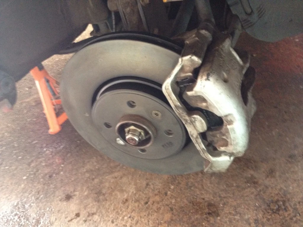

Unfortunately due to delays with brembo I havent been able to fit the discs I ordered as they havent arrived yet.
I've fitted a new revised design top mount, probably didnt need it as one of the brake disc securing screws fell out when I took the wheel off which was probably the cause of the "clack" when stopping in reverse but I thought I might as well renew the old stuff.

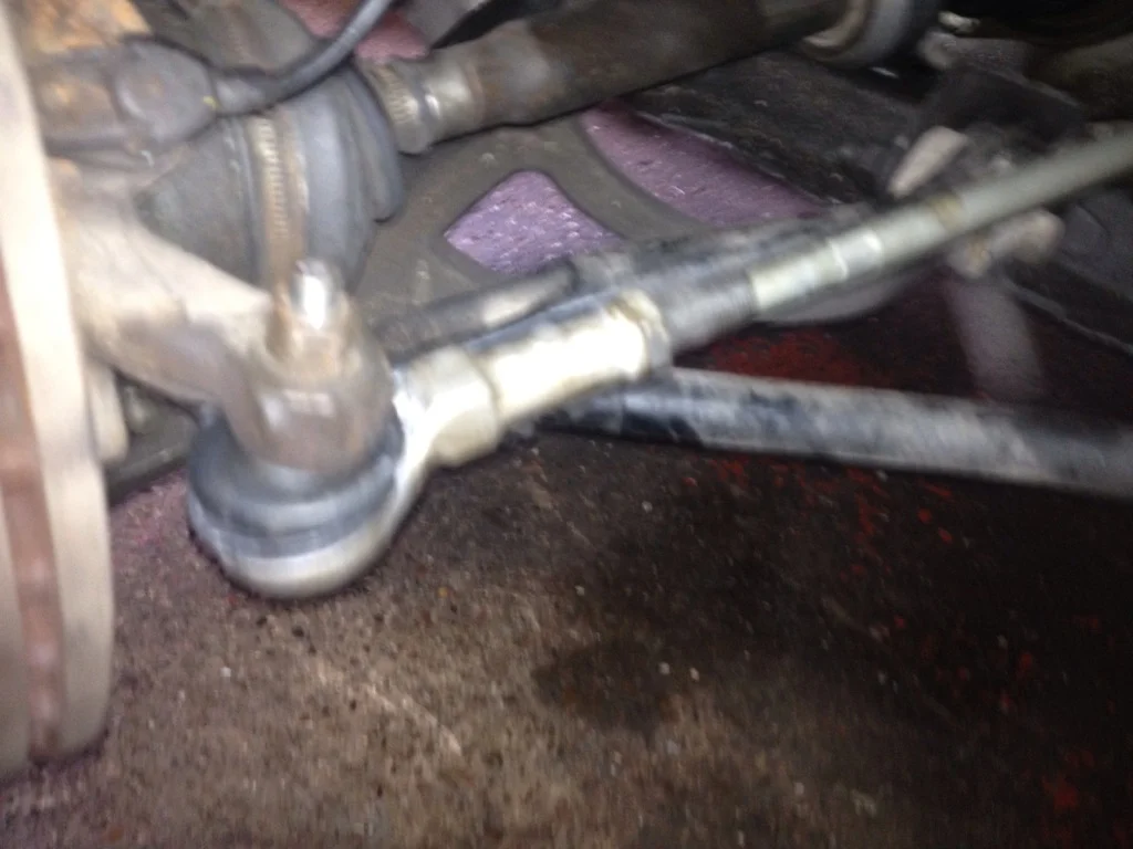

new track rod ends - old ones werent too bad but might as well do it, only one pic of this sorry about the quality

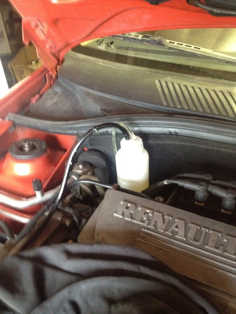

Bled up the brakes and replaced the old fluid with some Motul 5.1 fluid as used in my track saxo. The old stuff was well past it, probably original as it came out the colour of Real ale!
Easy enough to bleed up with one of these jobbies!
Hopefully I'll secure some brembos when people have them in stock then I'll be able to fit them along with new OEM pads.
  Inferno 182 & Saxo

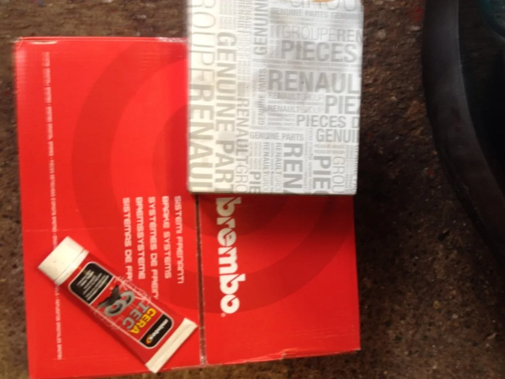

Brembos came today from G172 - gotta say thats top customer service as I only paid for them yesteday about 3pm. I've just been out bedding them in and the brakes feel really sharp now with nice bite as I've put in new OEM pads too as well as the new fluid from the other day . Also tried the Mintex Ceratec brake pad lube instead of copper grease as it supposedly better over time and with higher temperatures:
All fitted

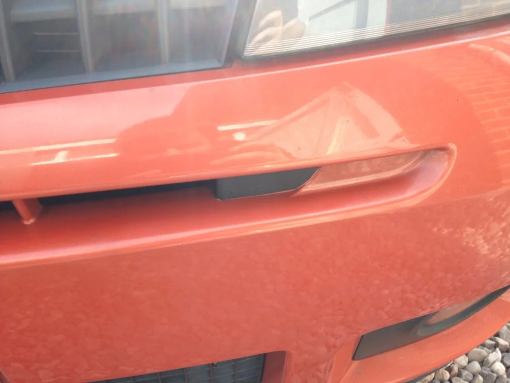

I also cut out some matt black vinyl for the bumper inserts as the originals were all cracked and falling off:

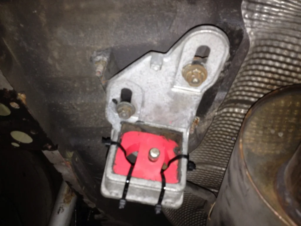

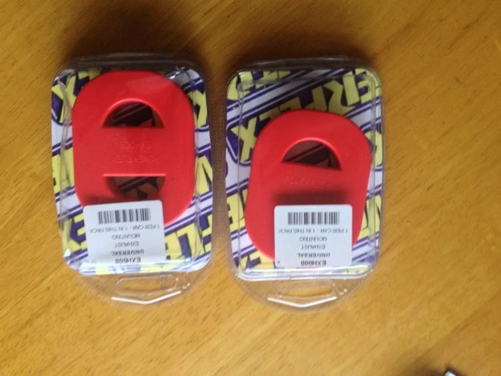

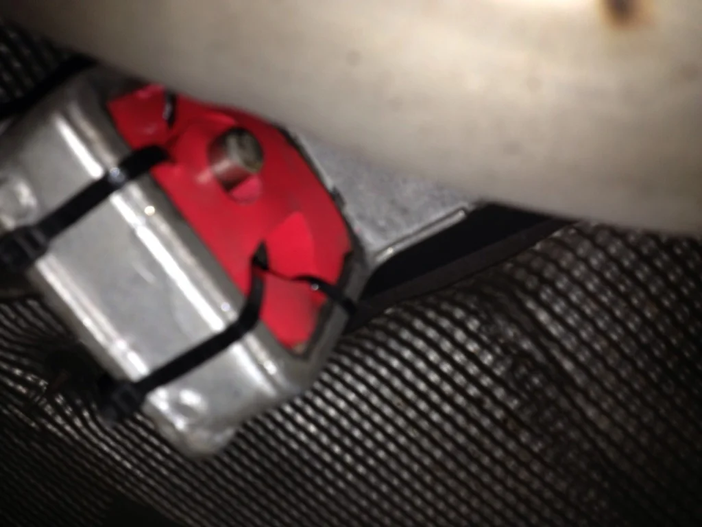

Bought some of these
Fitted them to the mounts after some fettling
Should hopefully make the exhaust look a little less like its drunk and last a bit longer - the standard ones had given up and the rubber spans had mostly snapped.

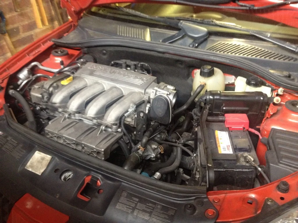

Also changed the front lambda sensor as I was only getting 25 mpg tops. Reset it and went for a quick blast and it seems to be hovering around the 33-35 mark now, just have to see how that goes.

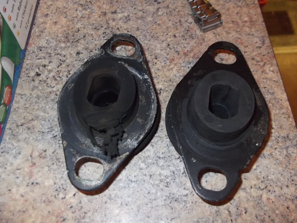

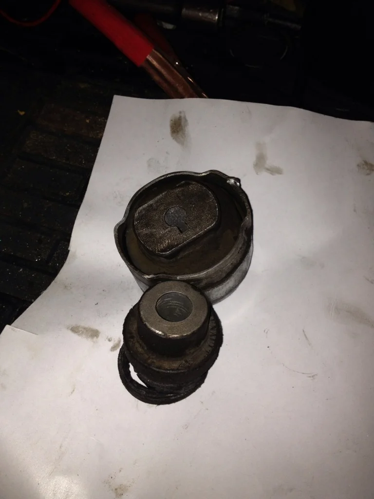

Old gearbox mount was shagged as can be seen here, so I changed it. Kept dropping the bloody bolts from the mount itself, can be a pig if they drop down onto the subframe! Should be captive nuts but anyway its done now.
Old shagged one on the left:
