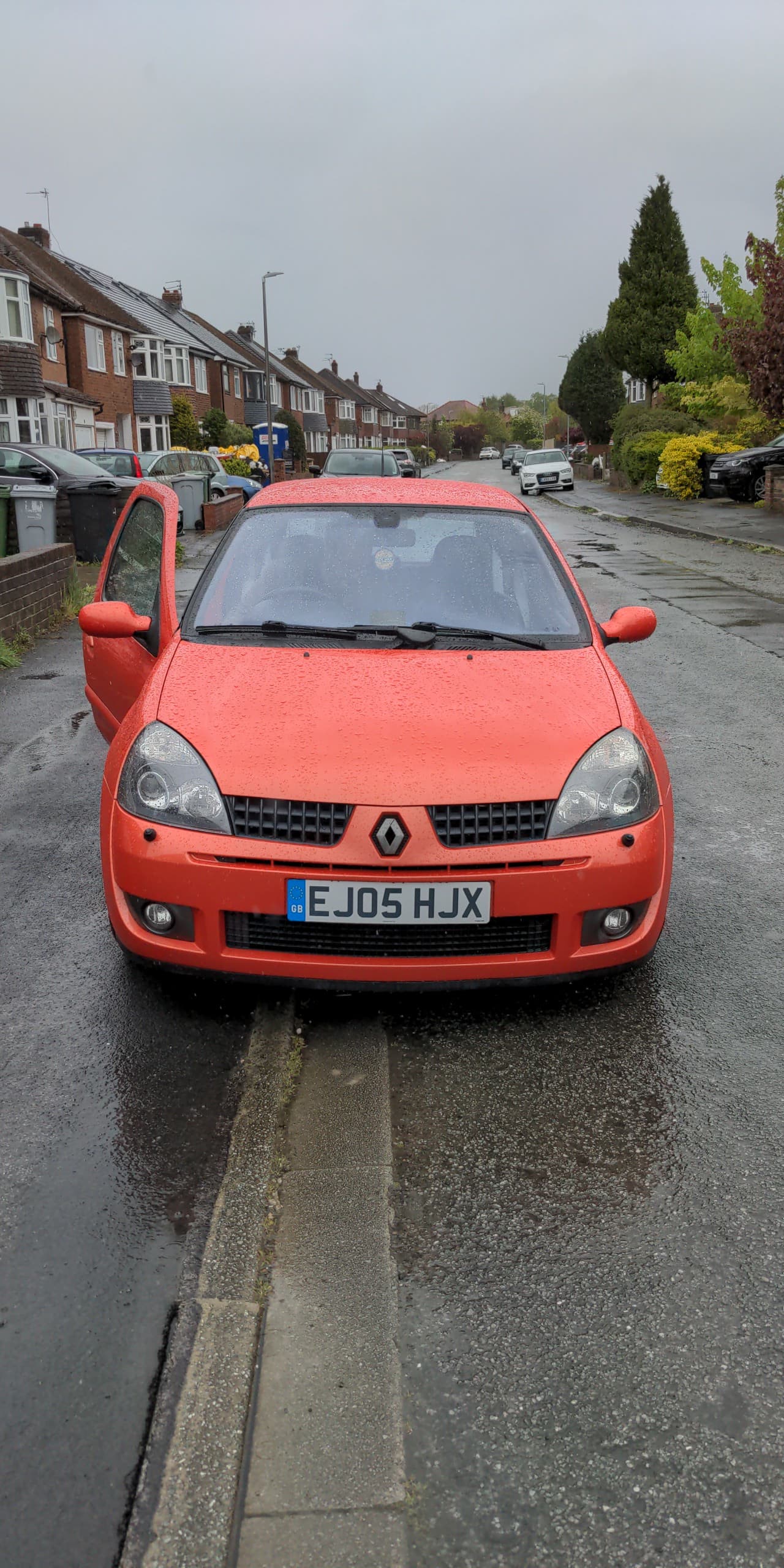

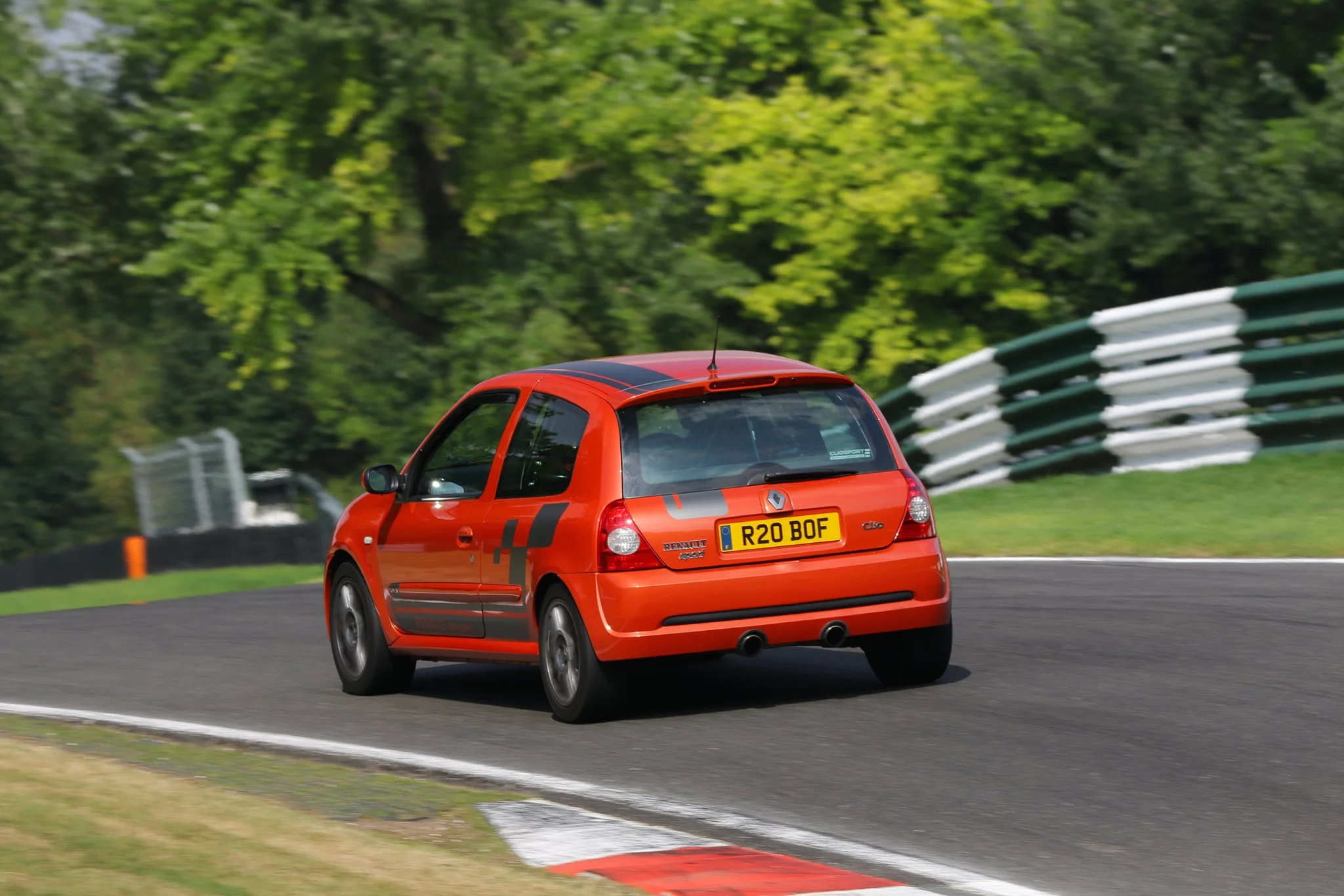

May 2021 I got round to buying a trackday toy.
120k ish miles Inferno 182 with both Cup packs, Scorpion 192 Exhaust, Purple dogbone mount, RS tuner Map 181bhp, Cup Turinis, braided brake lines. The Car was in great condition very orange and shiny. I also found lots of info on here regarding the car. EJ05HJX I paid £3900 which was probably a little over the odds, but I had looked at some shitters and this was close to home.
The plan was to keep it for B road blast and a few trackdays.

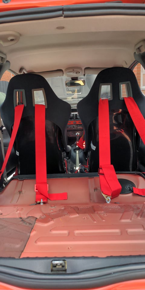

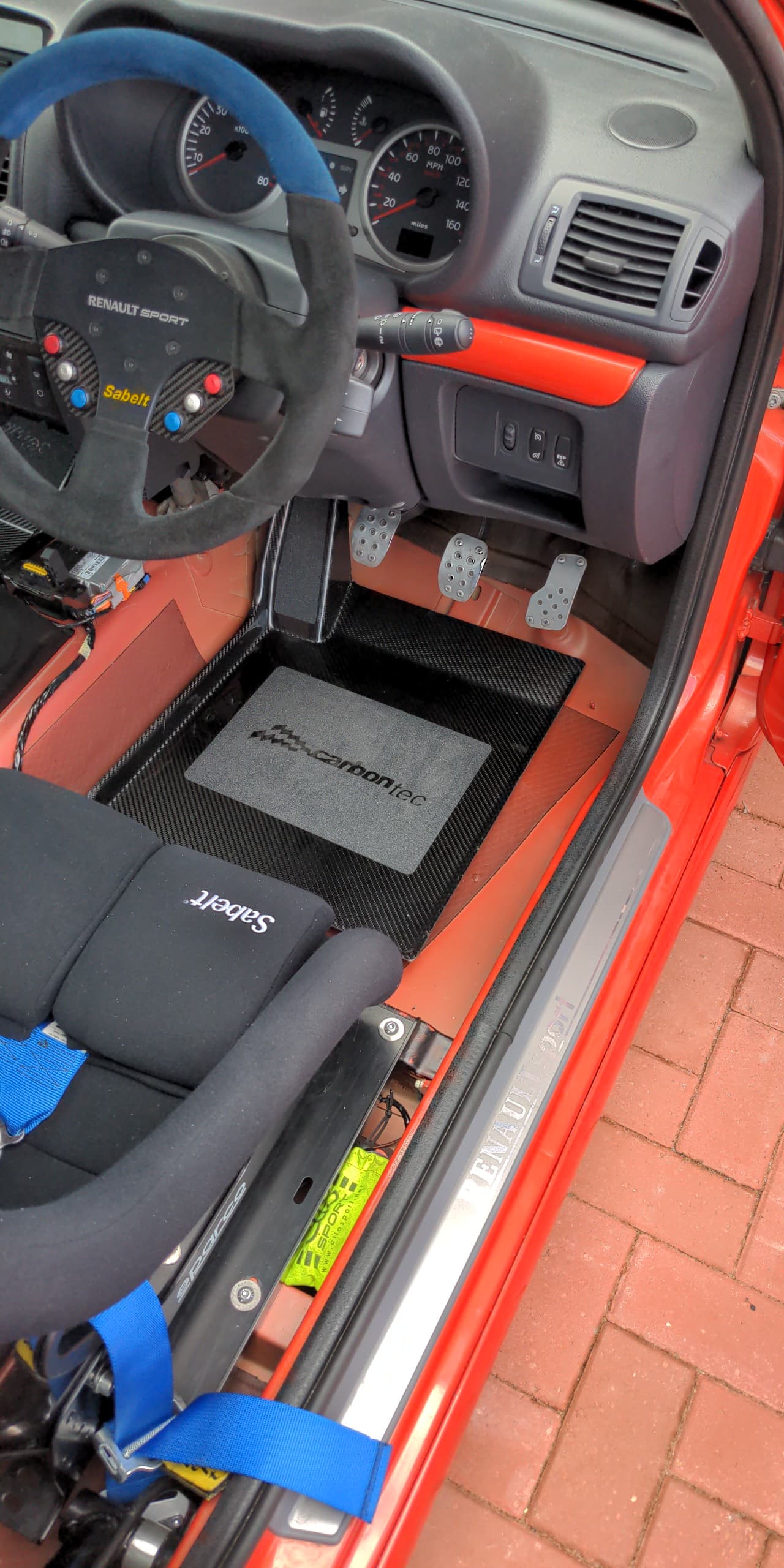

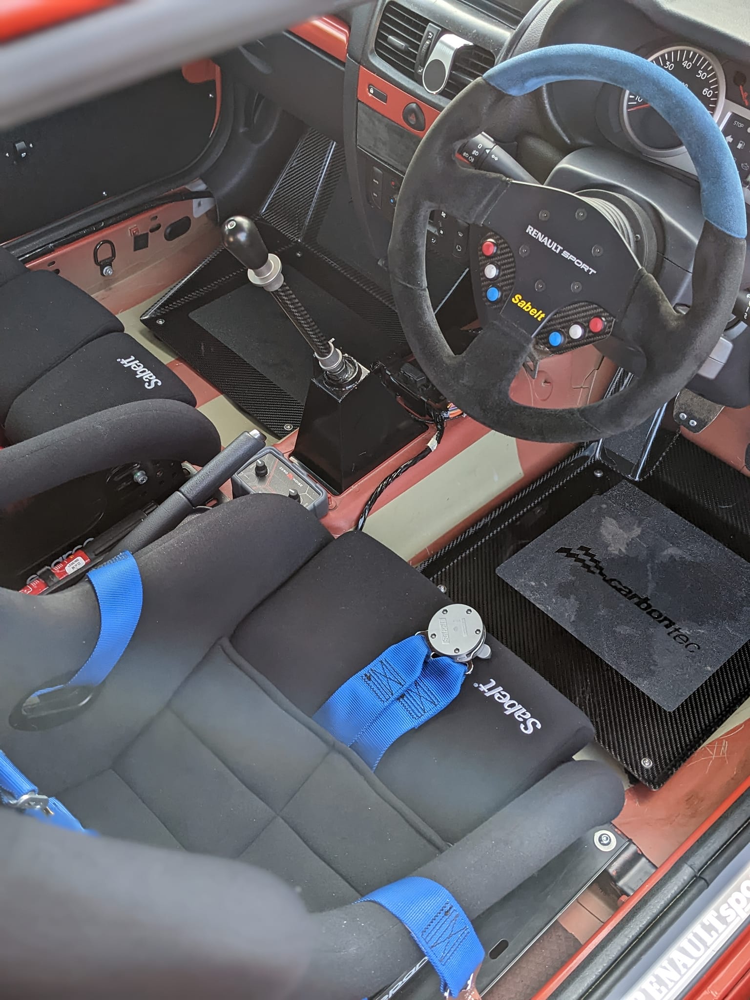

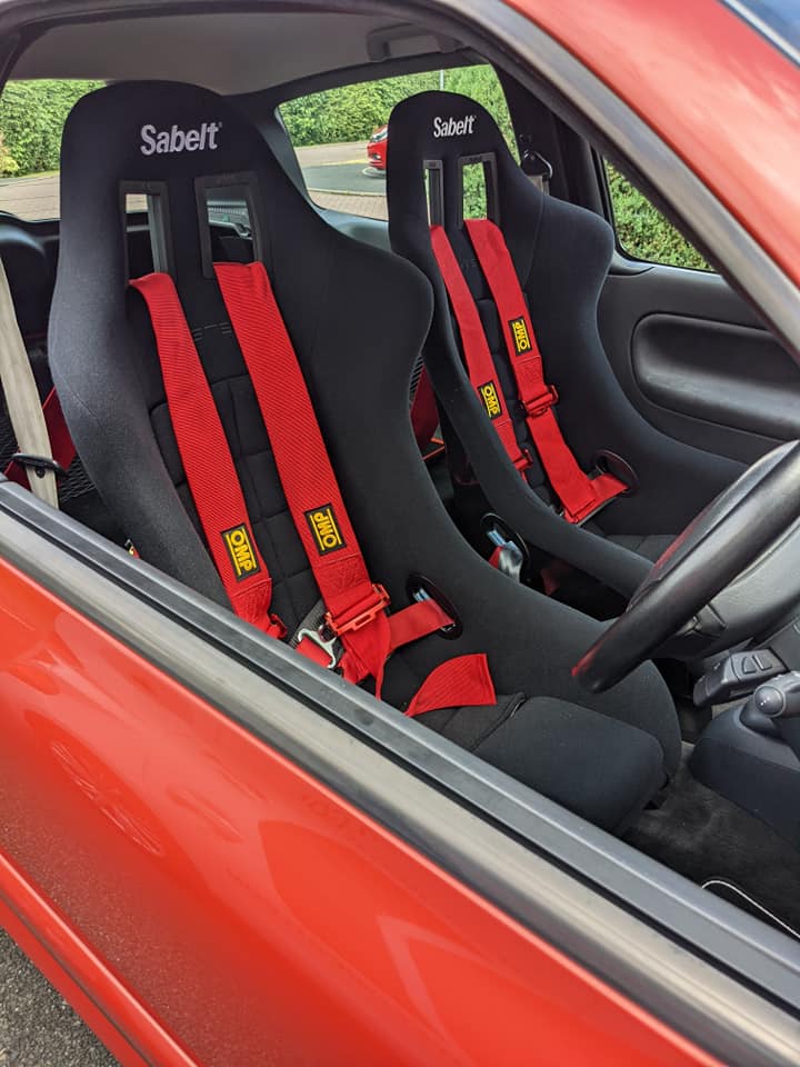

First Mod was a Numberplate, followed by a Trip to demon tweeks to try out seats. Went for the Sabelt GT3's as these were the best fit/comfortable.
Not having spannered much at all, I booked the car in with Demmon tweeks to have the seats and harness fitted.

Came to the conclusion that the seating possition was a bit off and swapped the Sparco beat bases for some Jon Foz ones, much better!
Passenger on the Foz base.

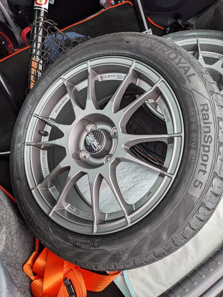

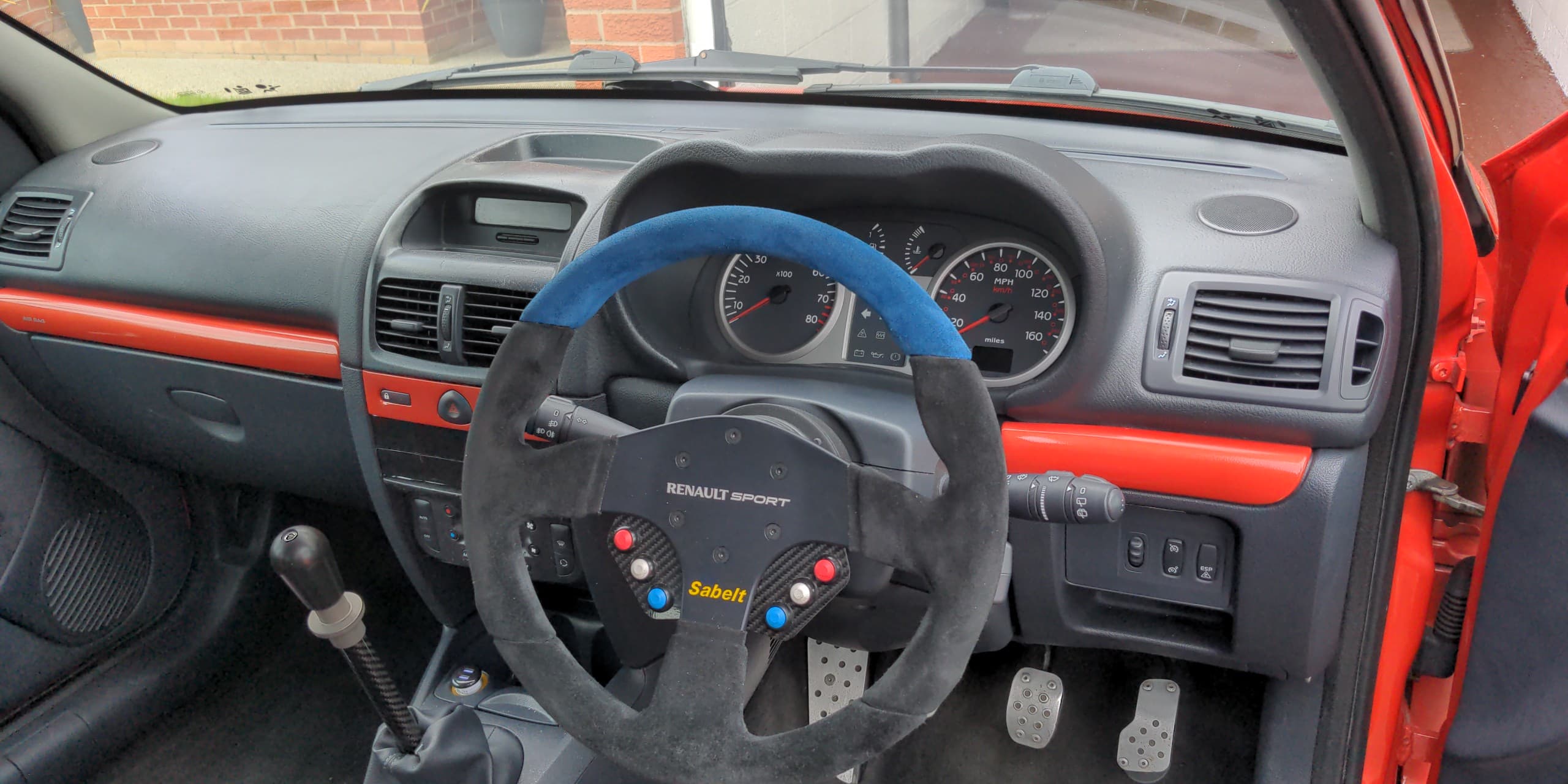

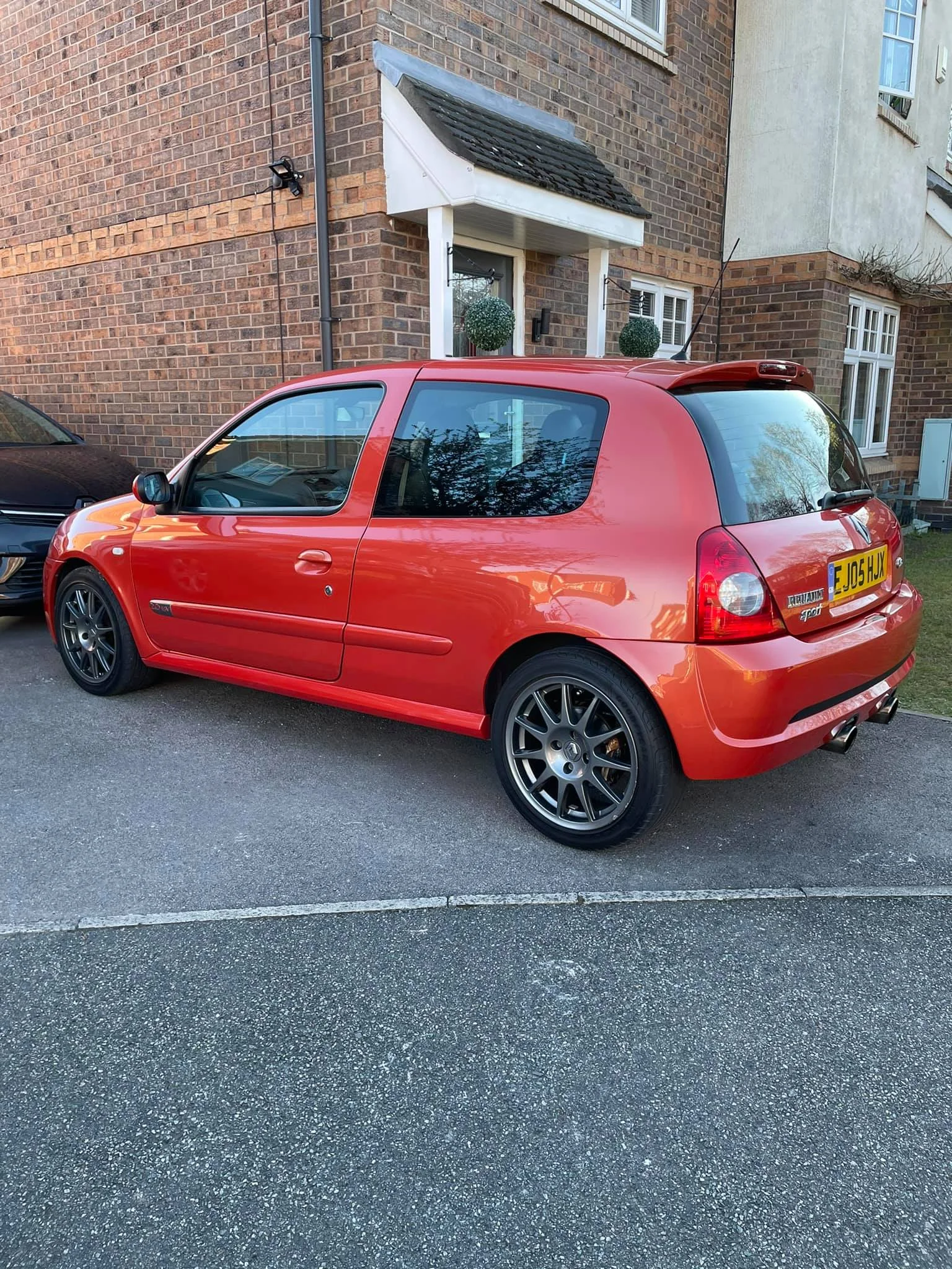

Next Mods were a Volantech Sabelt steering wheel,PMS shifter and a set of OZ Ulltraleggeras with a set of Rainsport 5's, did not feel great on a wet track with the NS2R's. Was very pleased with them, especially the PMS shifter and mine doesn't rattle much at all!

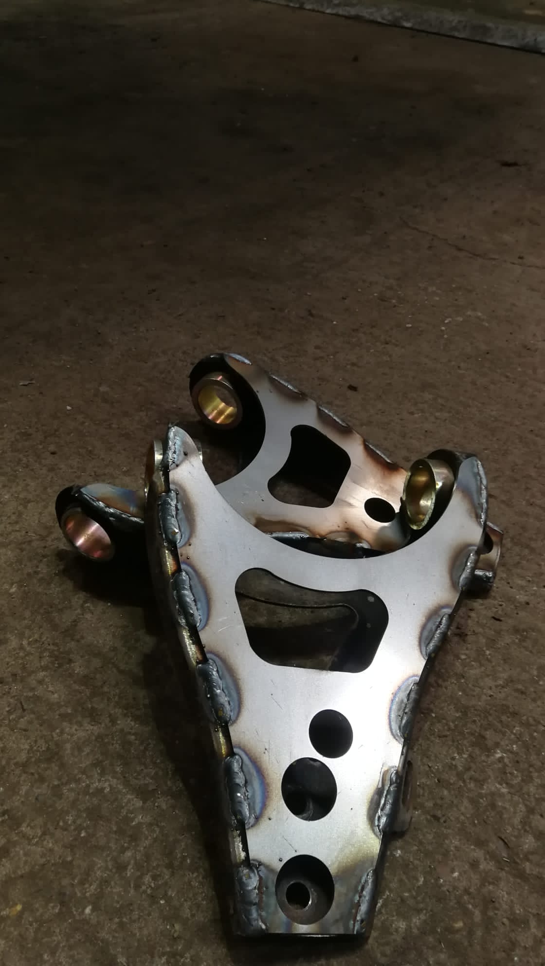

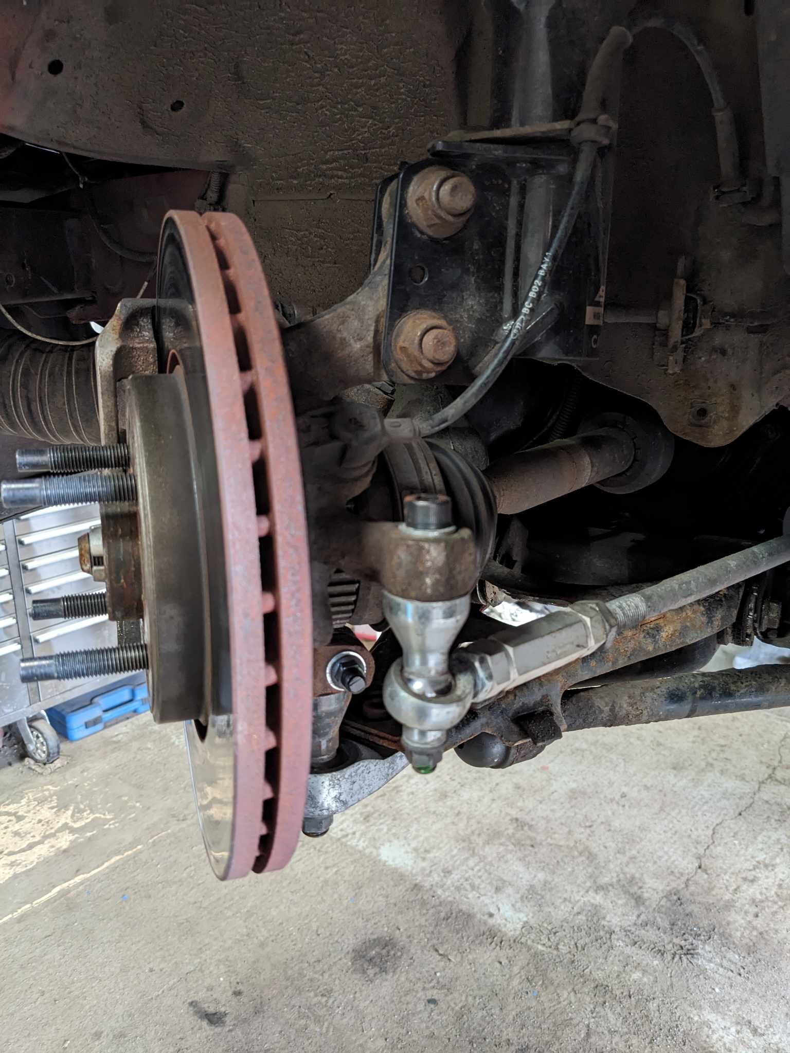

Might have guess my now once I start modding it's hard to stop. The BC coilovers were huge set up on track, had the car corner weighted and Geo.

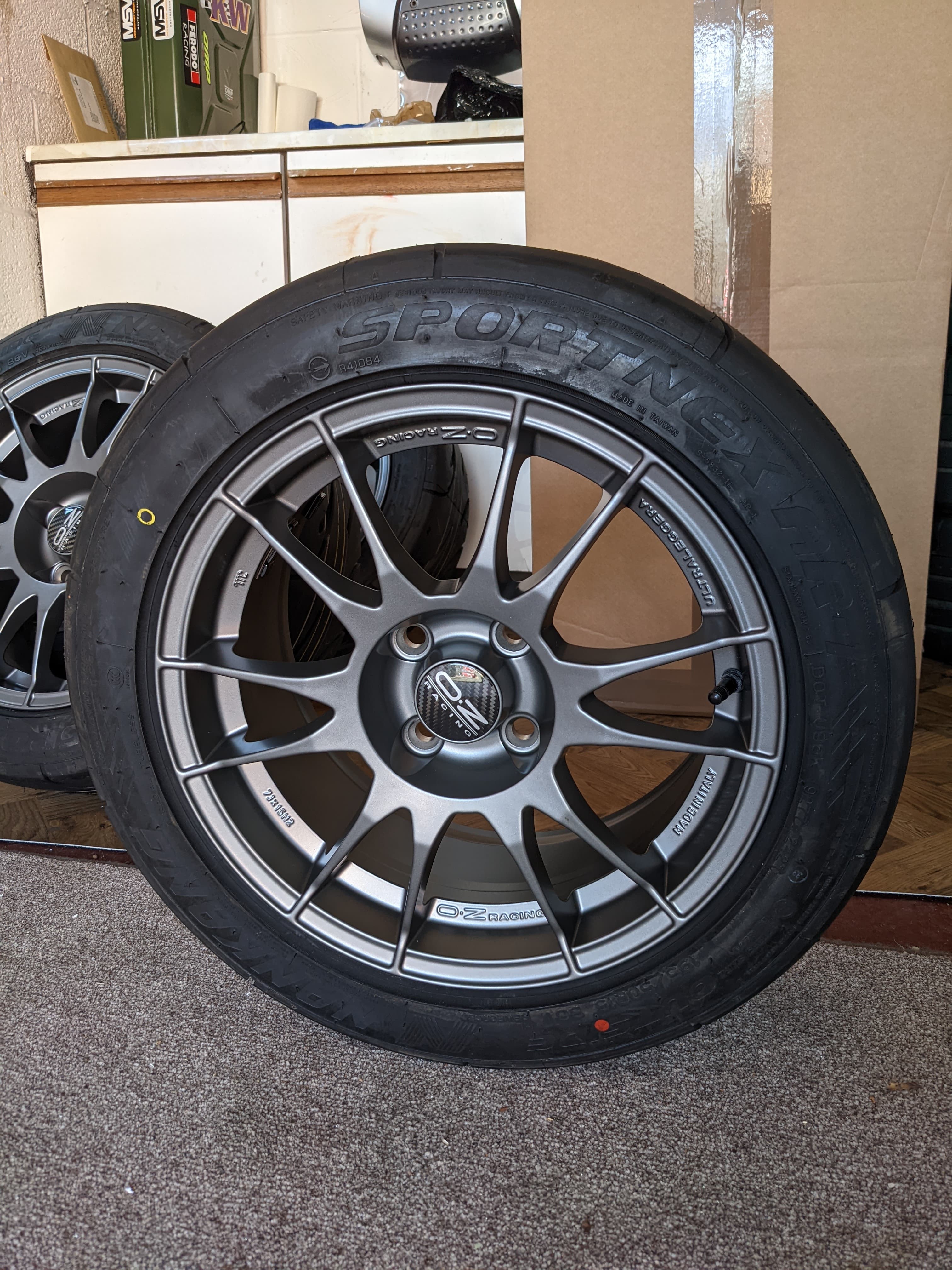

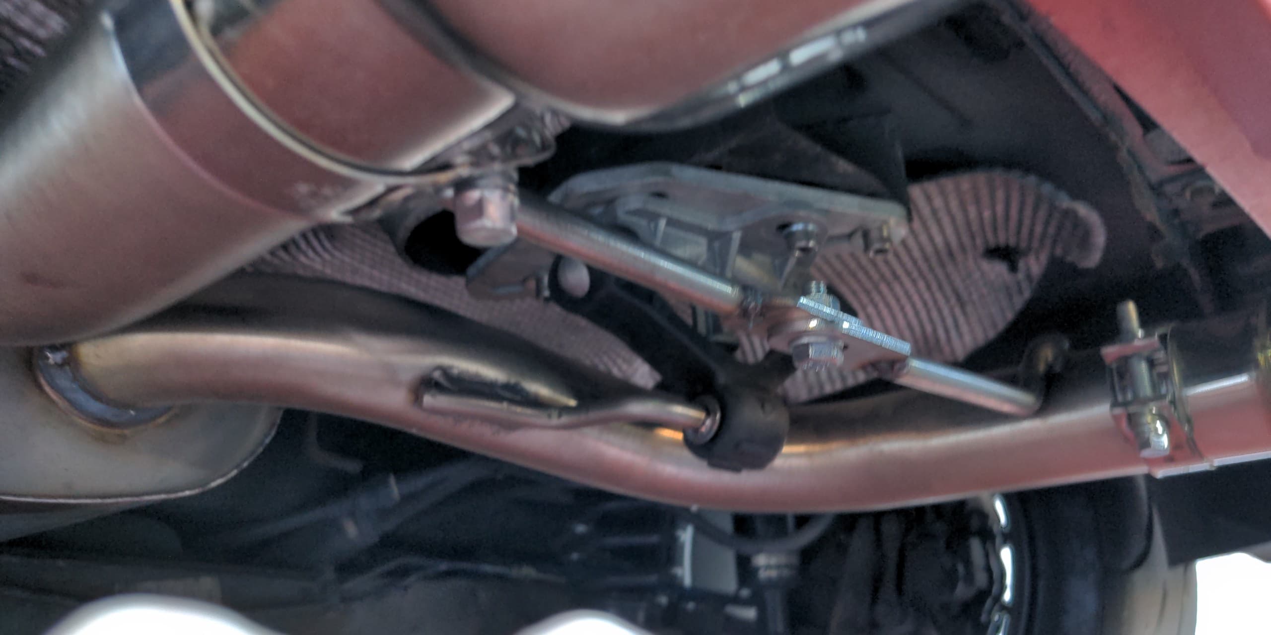

the Scorpion 192 kept sagging in the middle on track replaced it with a Pure motor sport system. Sold the Turinis and bought a second set of OZ's with some AR-1's

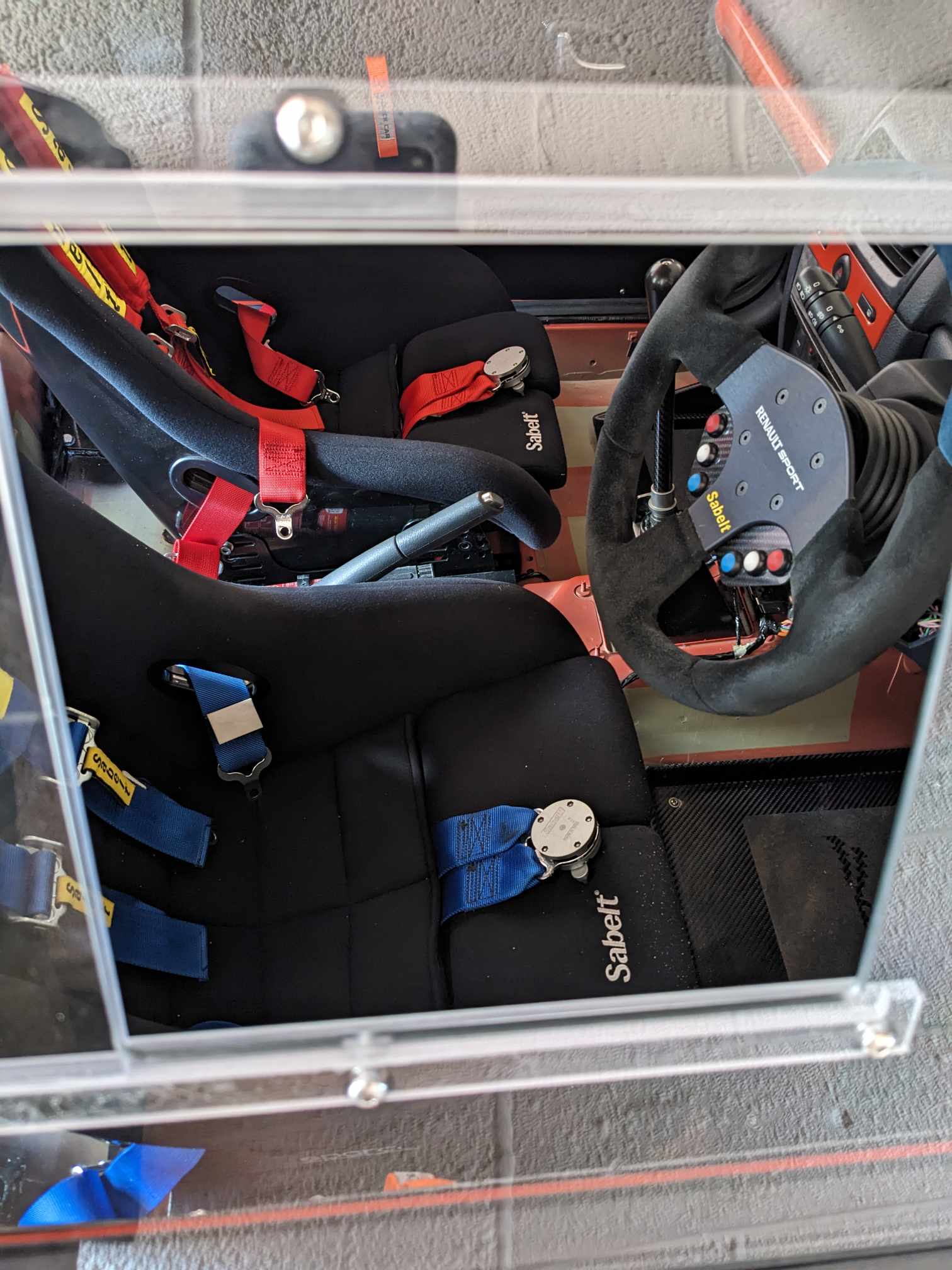

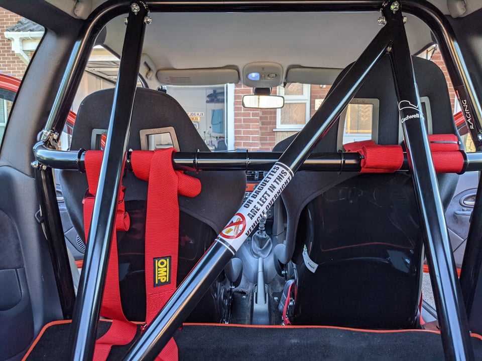

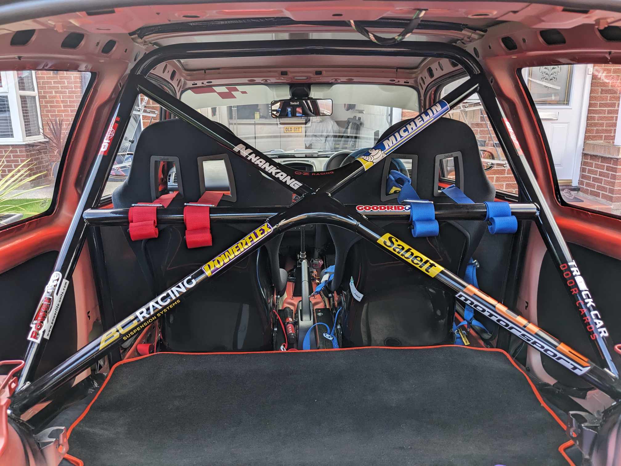

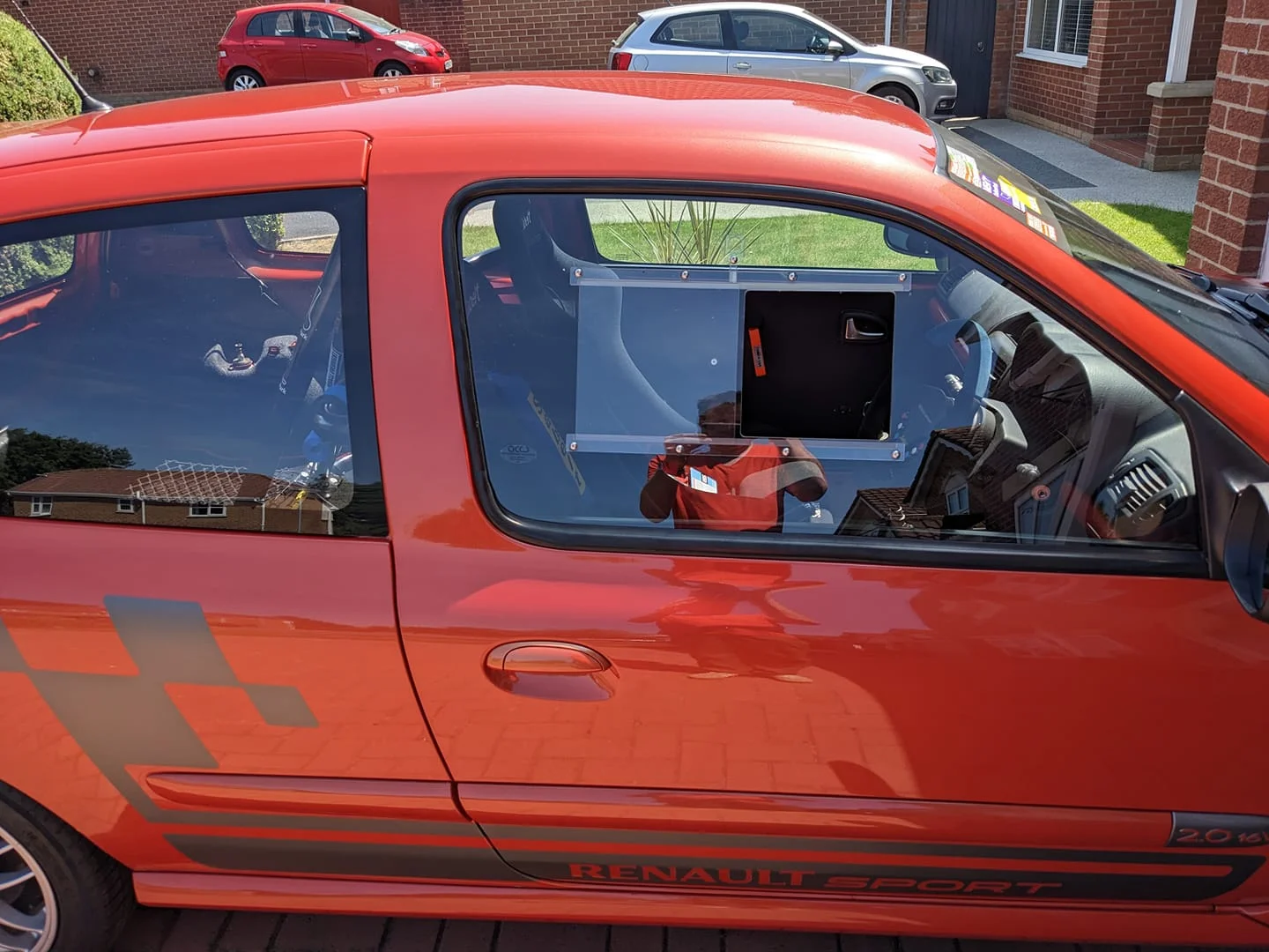

I decided to sell the bolt in K tech cage and went for a T45 half cage from JP cages, only cost me a £200 or so to trade up and it's 17kg lighter!
Got my stickers ready in advance ;P

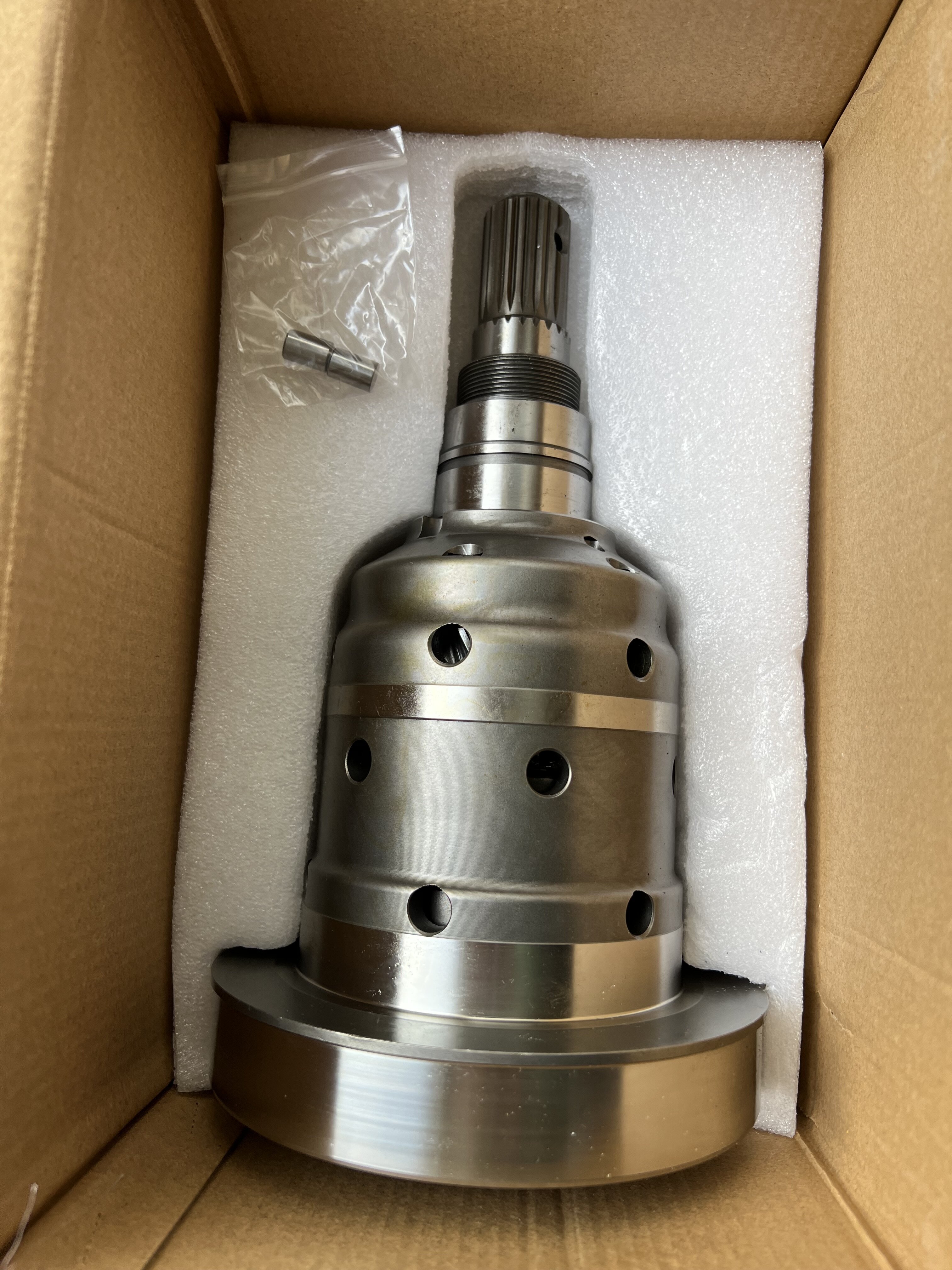

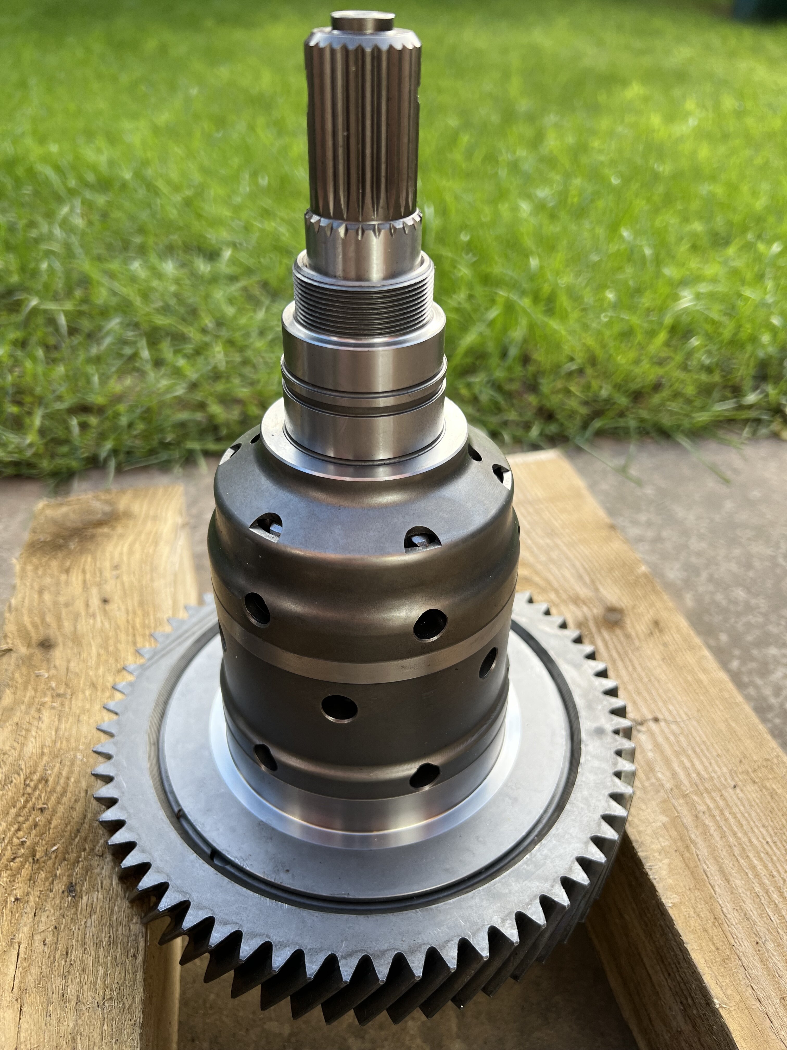

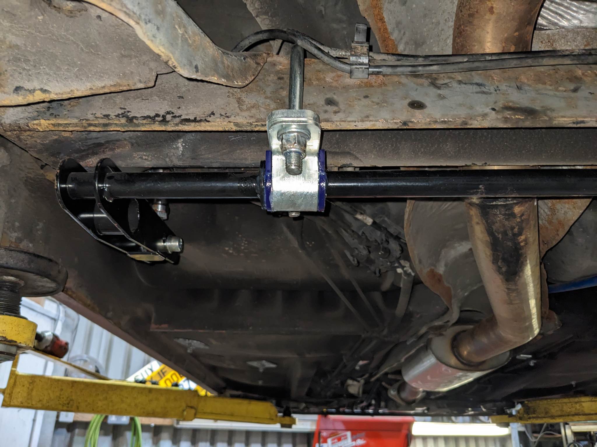

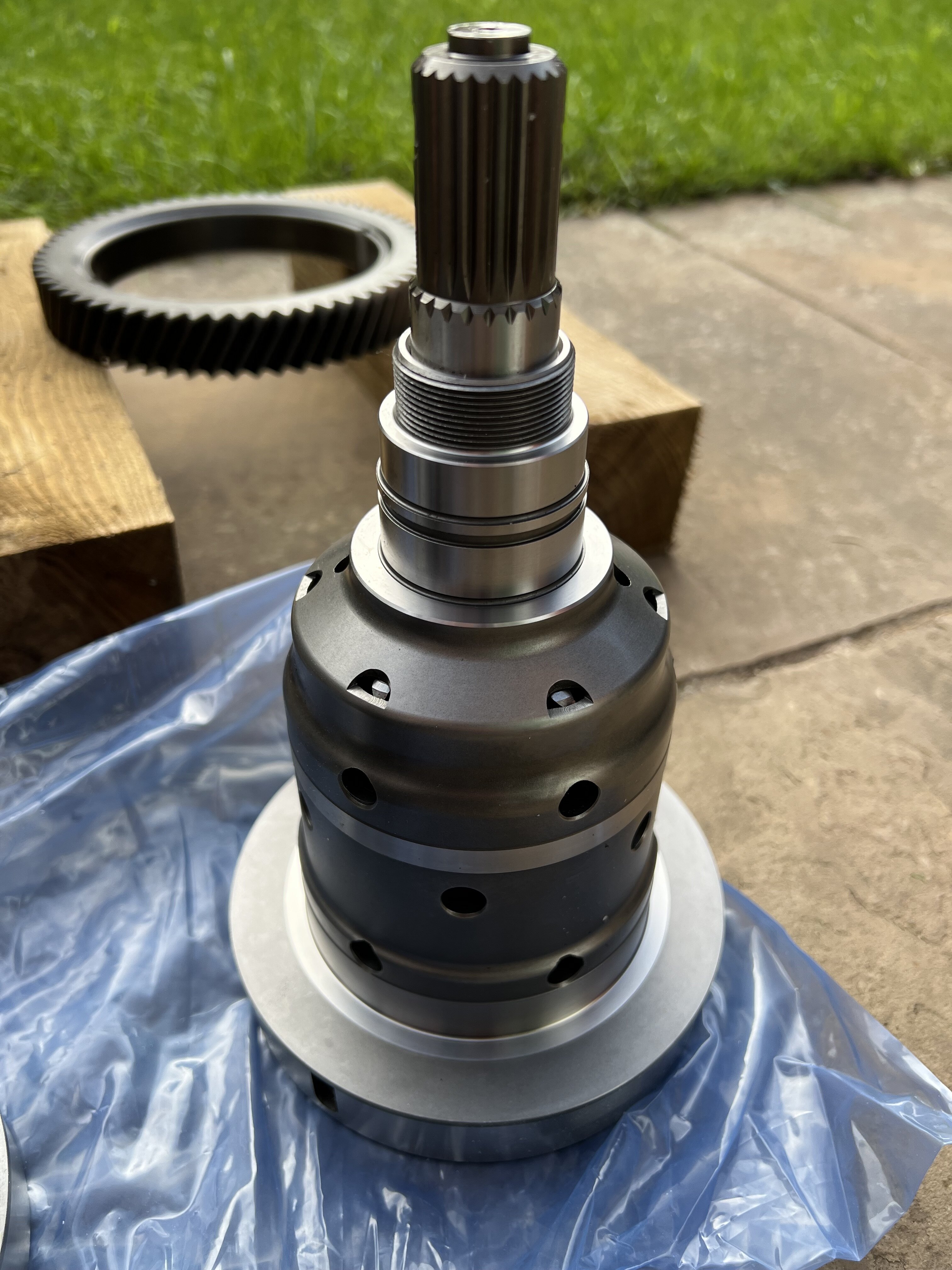

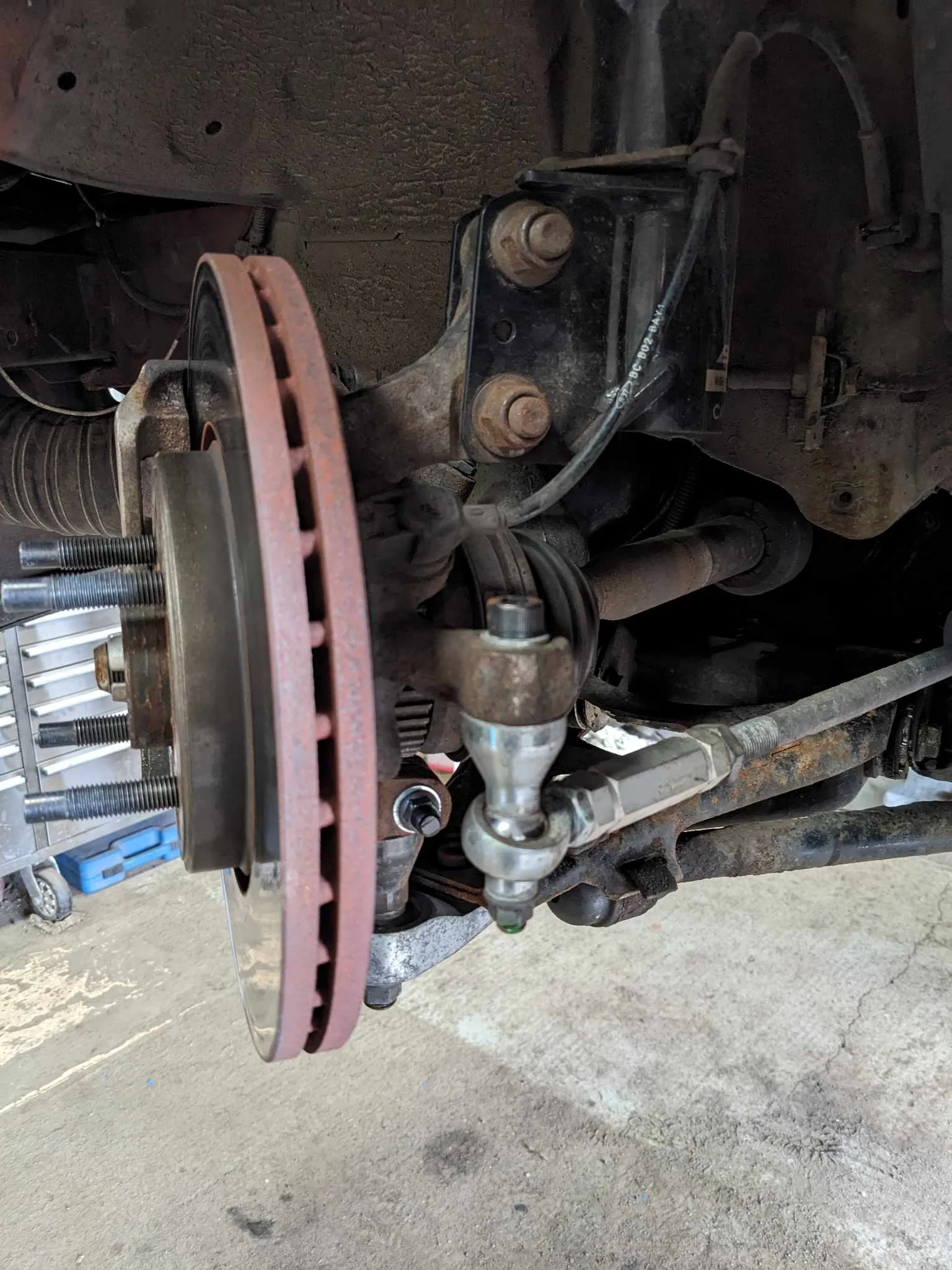

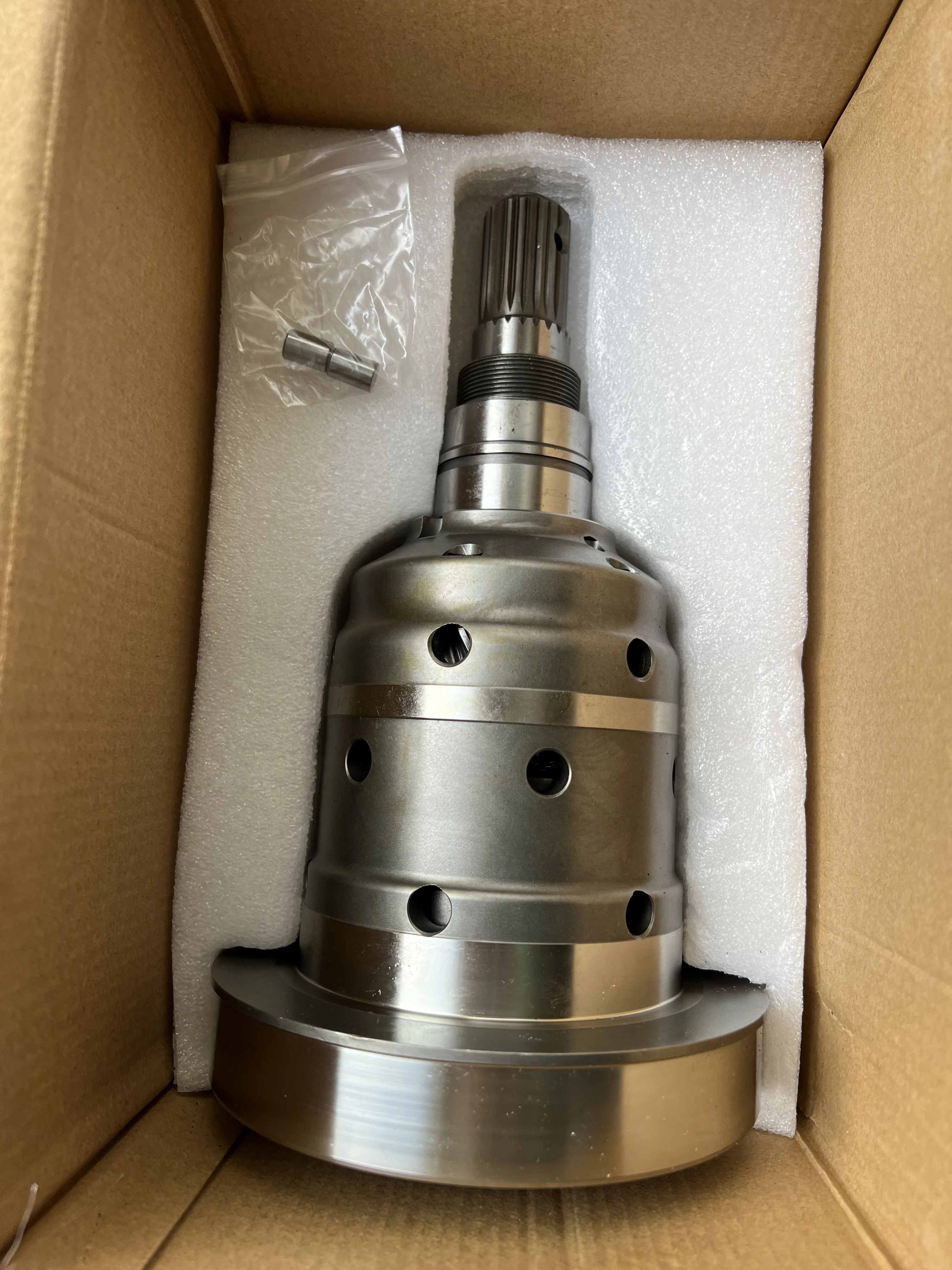

Once the Blackine LSD is in I think I'll call it done, will probably tinker for years, but just need to learn to drive it better now :) Most of the handeling mod have just given me more confidence to lean on it each time. The geometry kit was an eye opener, lots less understeer will be interesting to see what the LSD adds!
The LSD combined with that correction/bump steer kit will transform how the car drives.
I can remember doing mine and going around Croft for the first time. Turn-in and exit speeds were transformational.

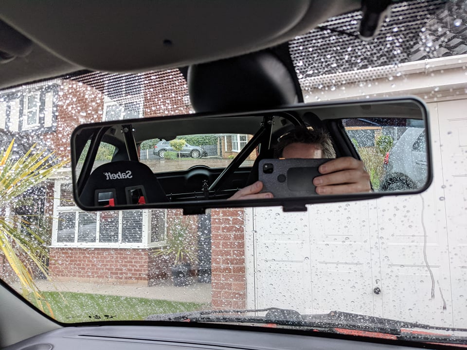

This was a great but cheap Mod, wide angle (caravan type) rear view mirror. £17 or so from amazon, much more rear visabilty.

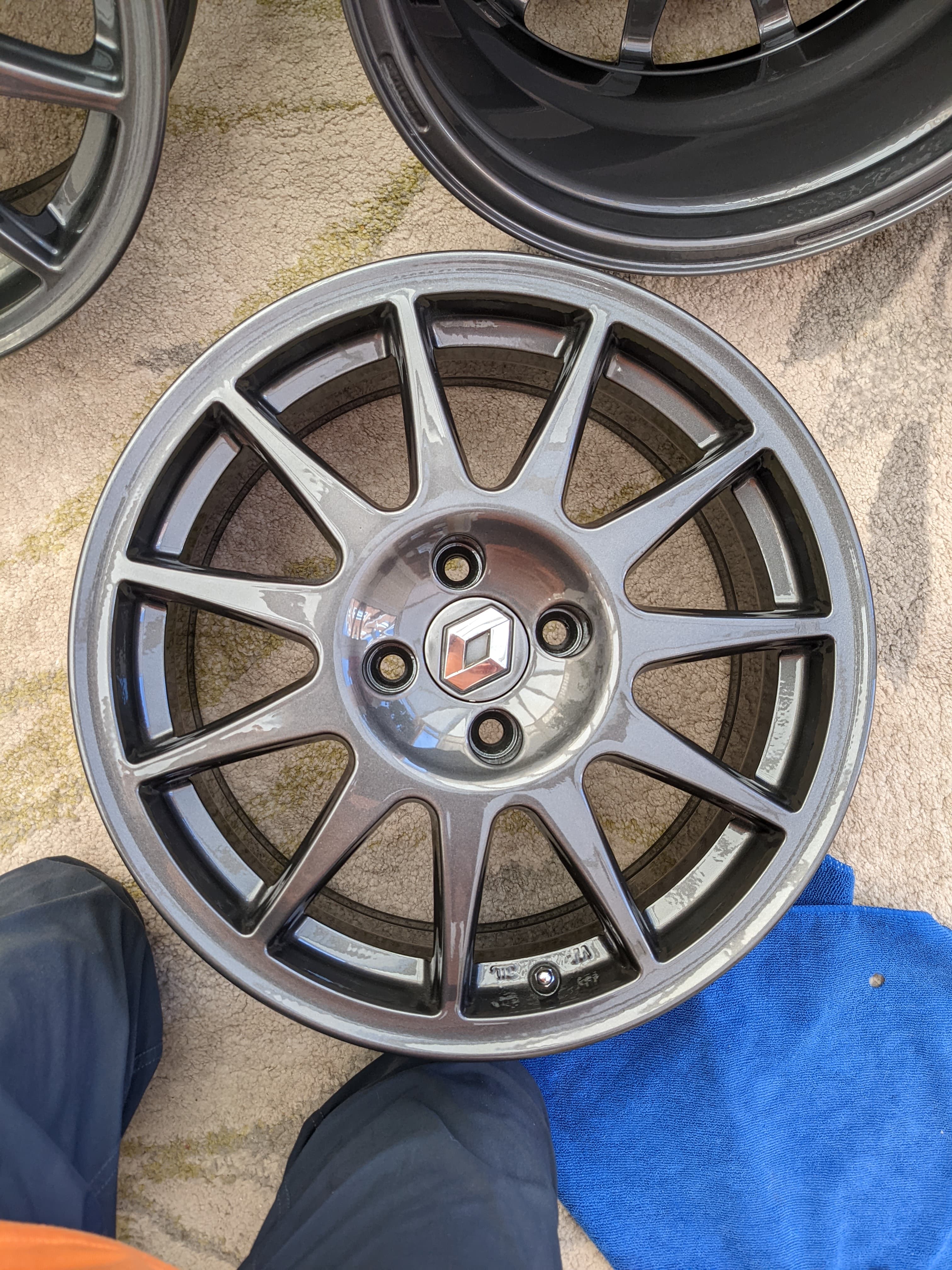

I sold the set of Turinis that came with it for £625 to fund a set of OZ Ultraleggeras.

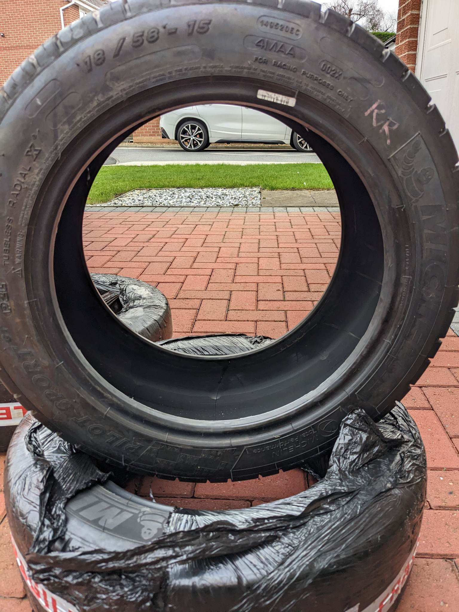

Upgraded the rainsport 5's (which are excellent for the money) to some pre used competion wets after seening some other people out on track with them.
I've not had a wet trackday since buying them though, looking forward to bugging some pork on cups 2's :P

Cage looks great! Is it just a bolt in setup? I may cage my 172 in the future but would like something that's reversible.
yeah bolted in to welded plates in the inside. was advised this was the best way for a stripped interior. The other option is plates on the underside and holes to clamp it togeater.

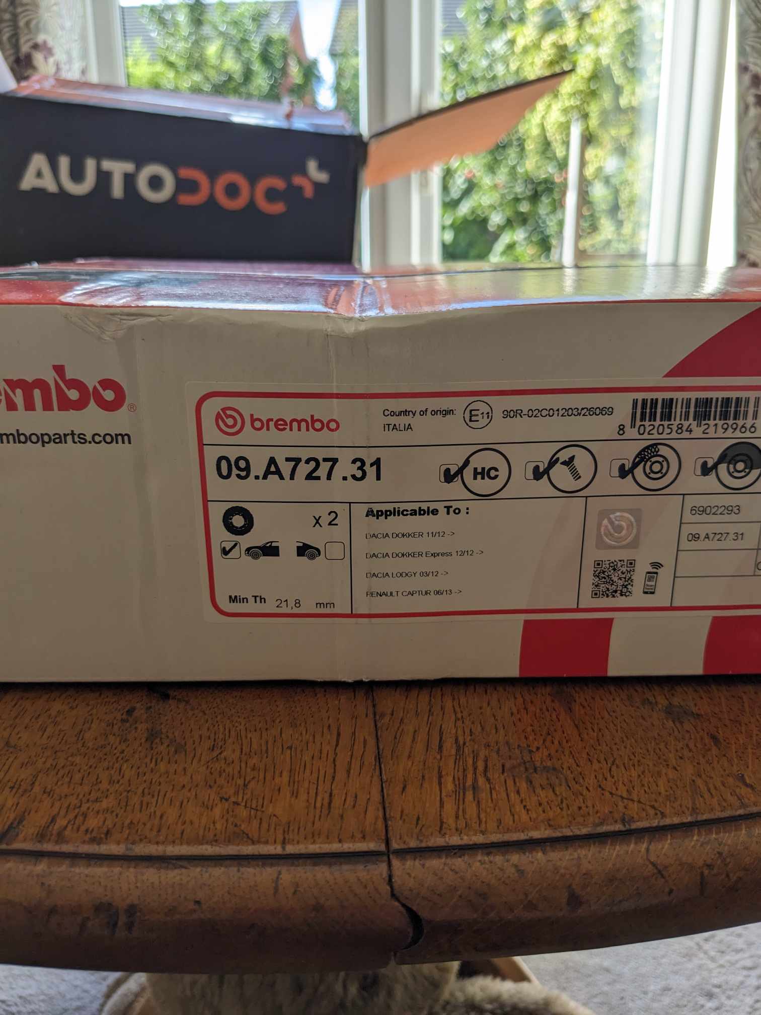

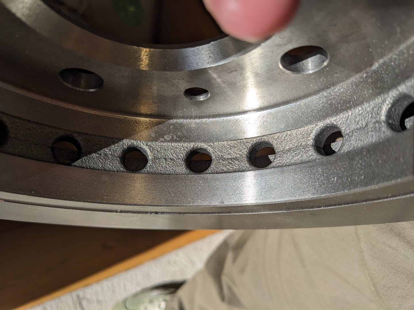

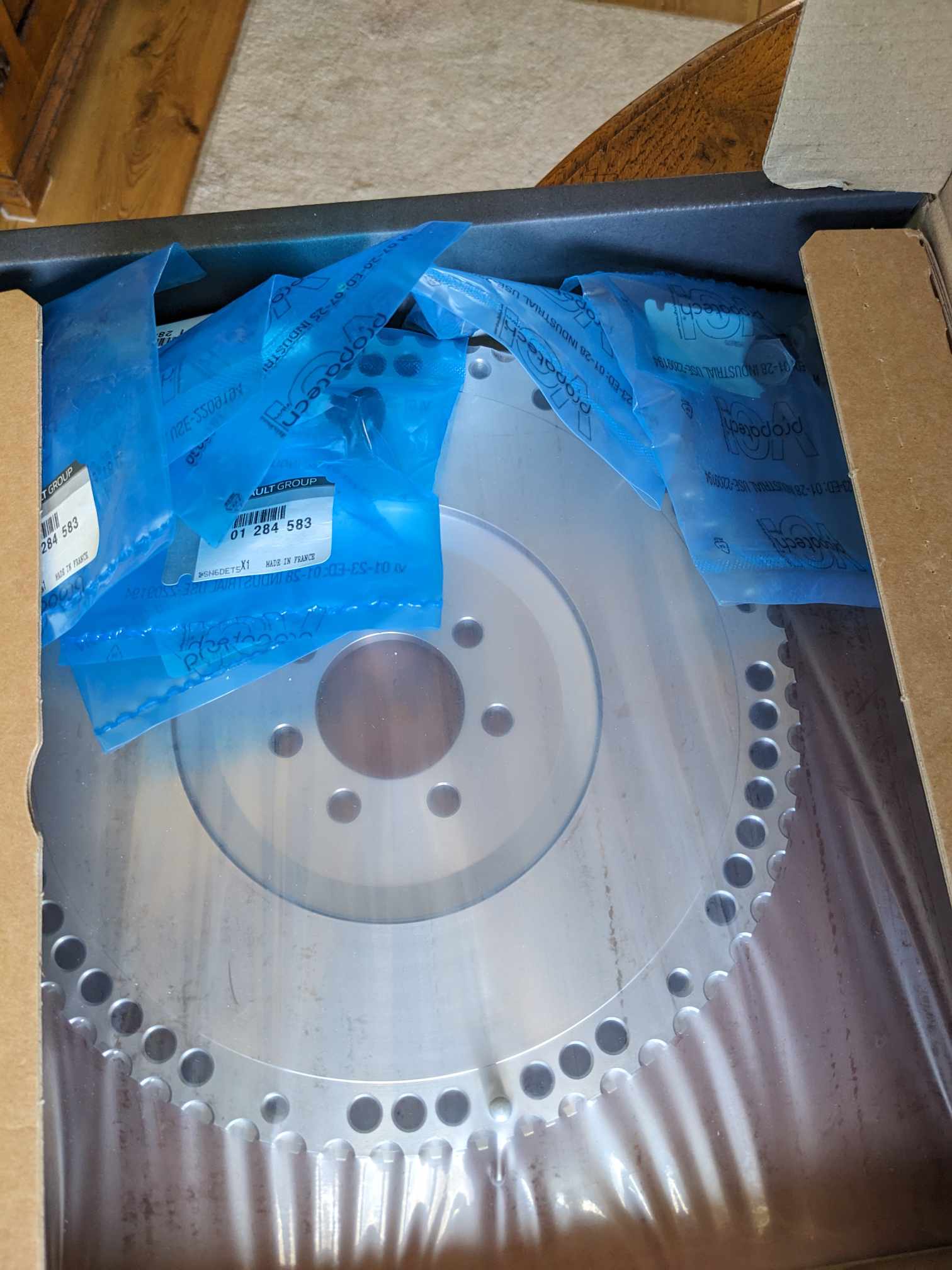

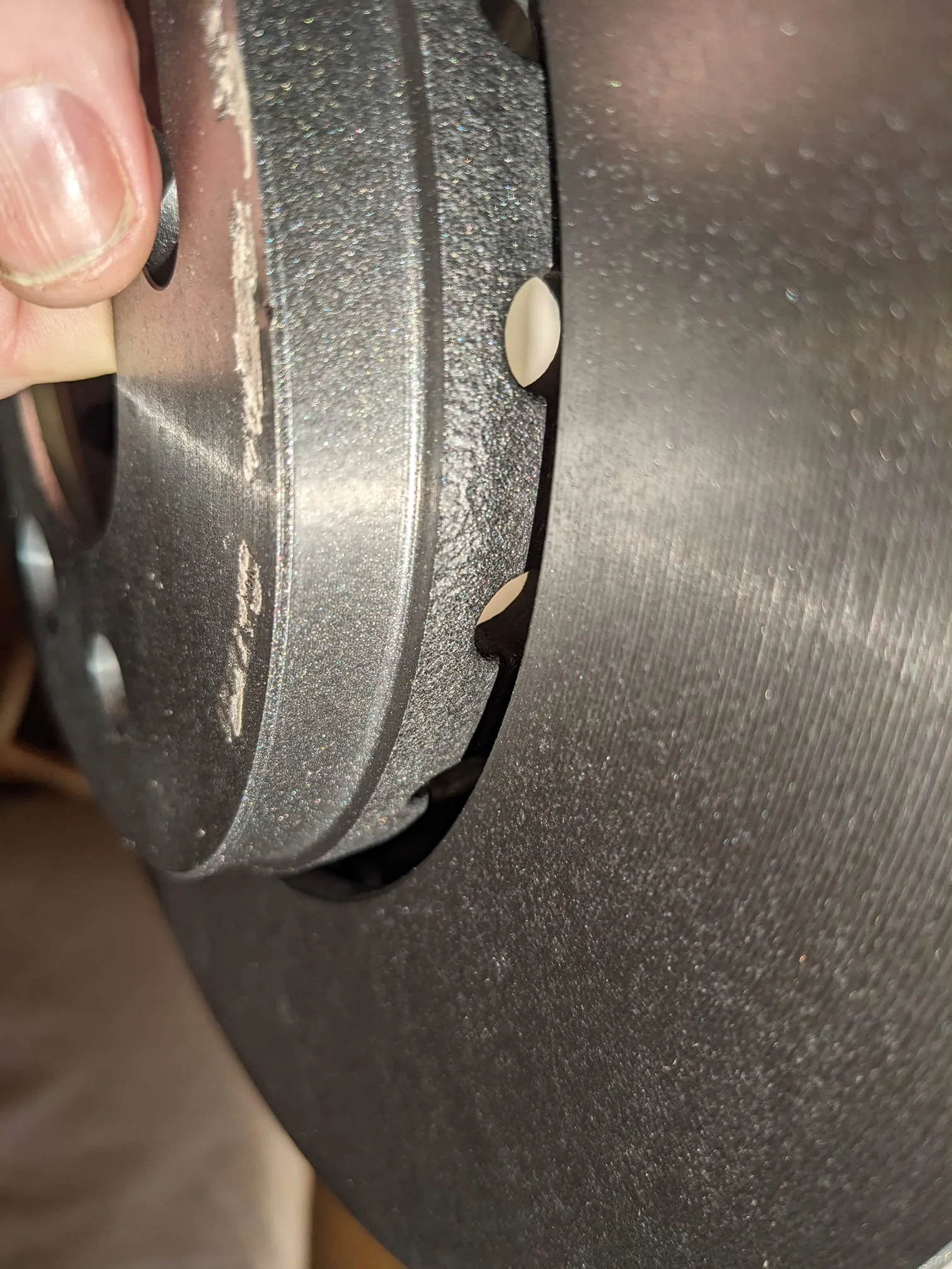

"Track Spec" Brembo Disc , bigger holes in the Hub part. I cooked the OEM ones practicing trail braking into Knickerbrook despite the cooling ducts.

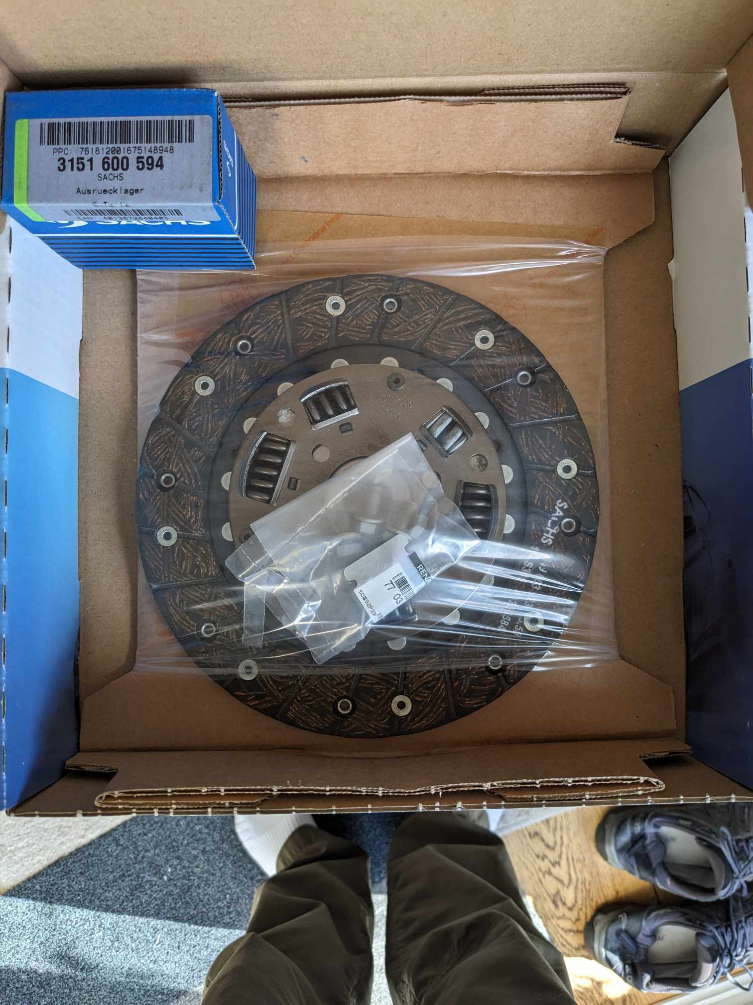

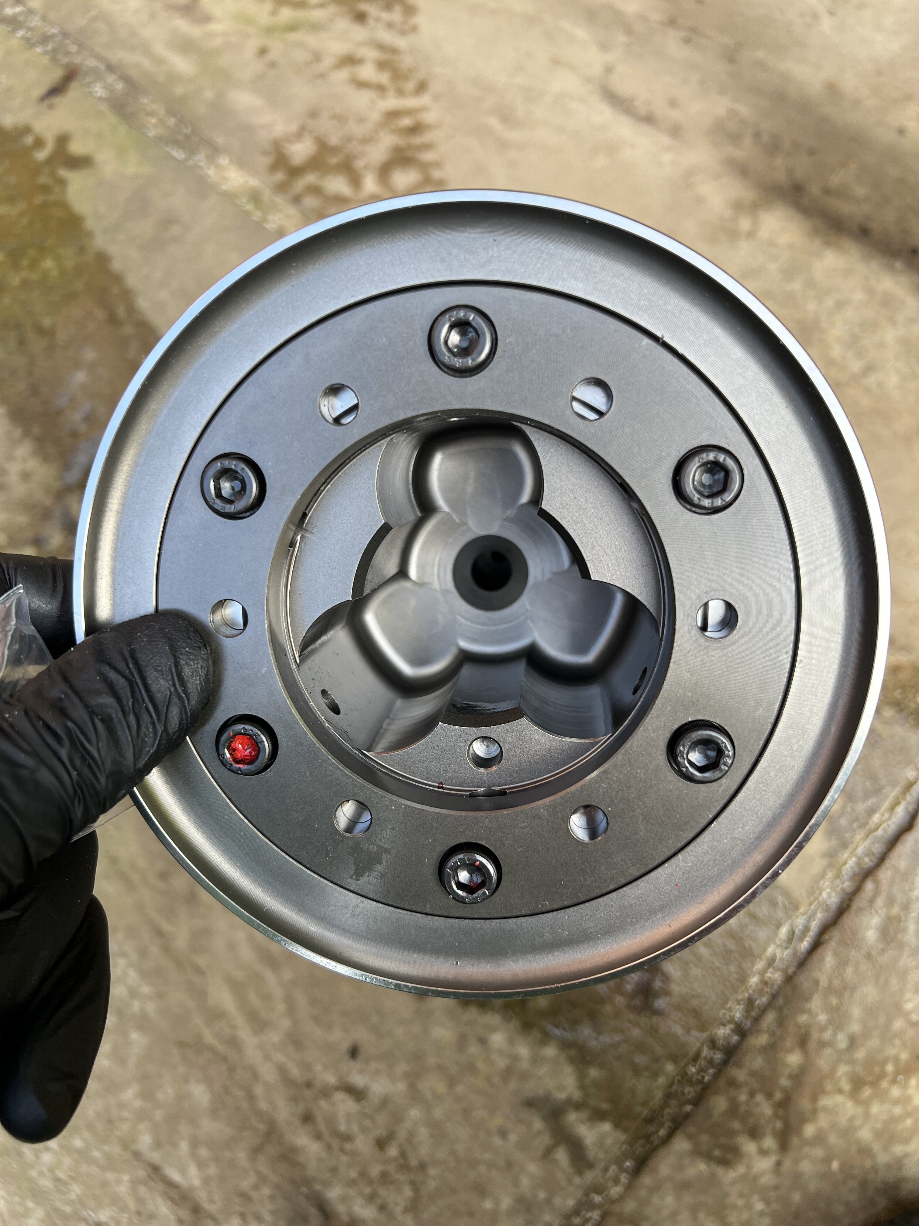

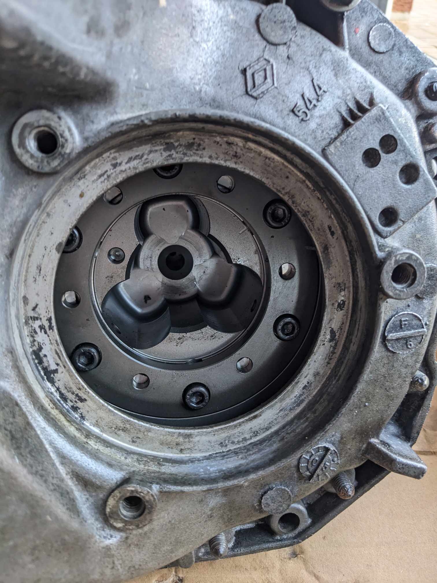

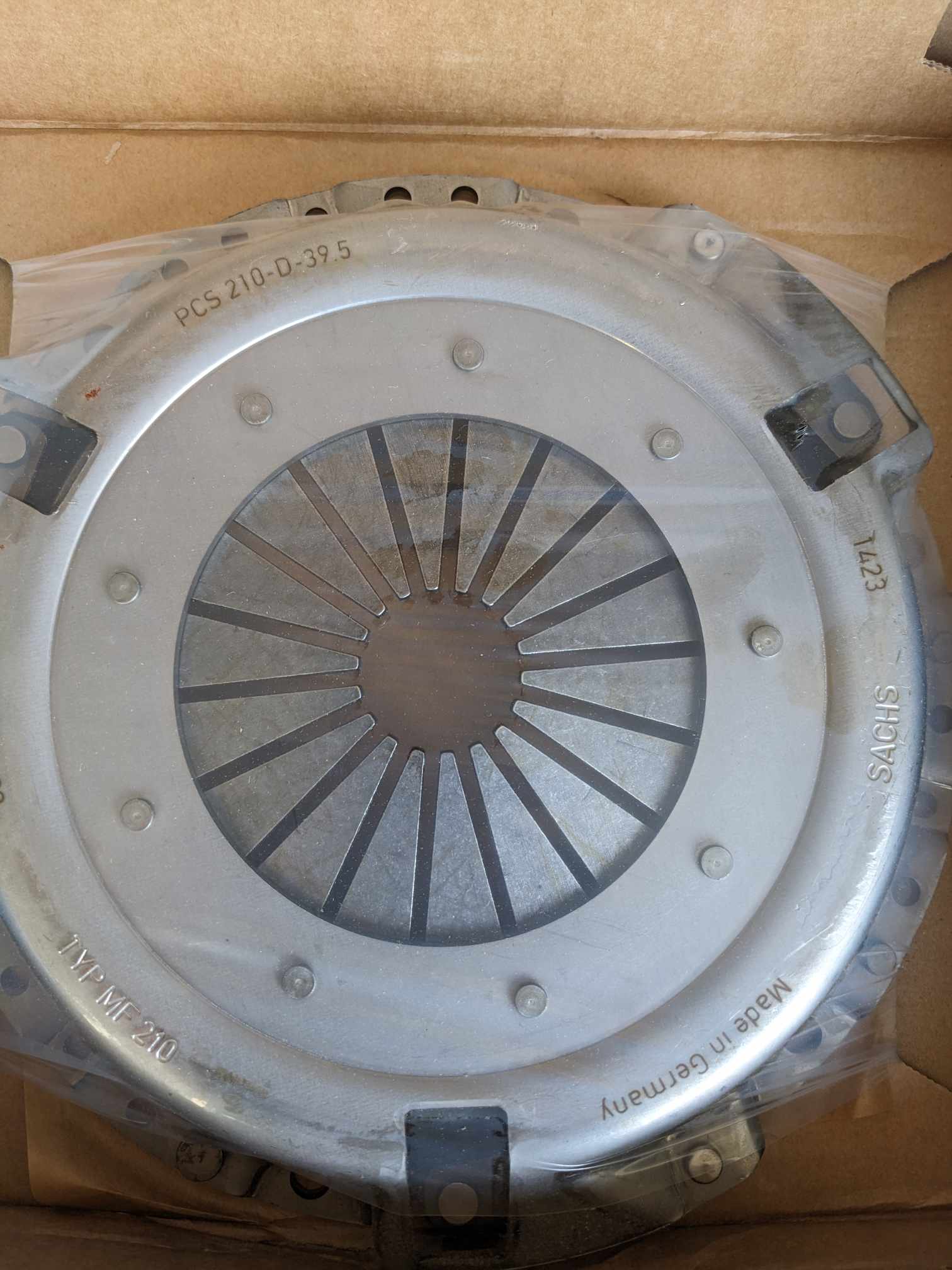

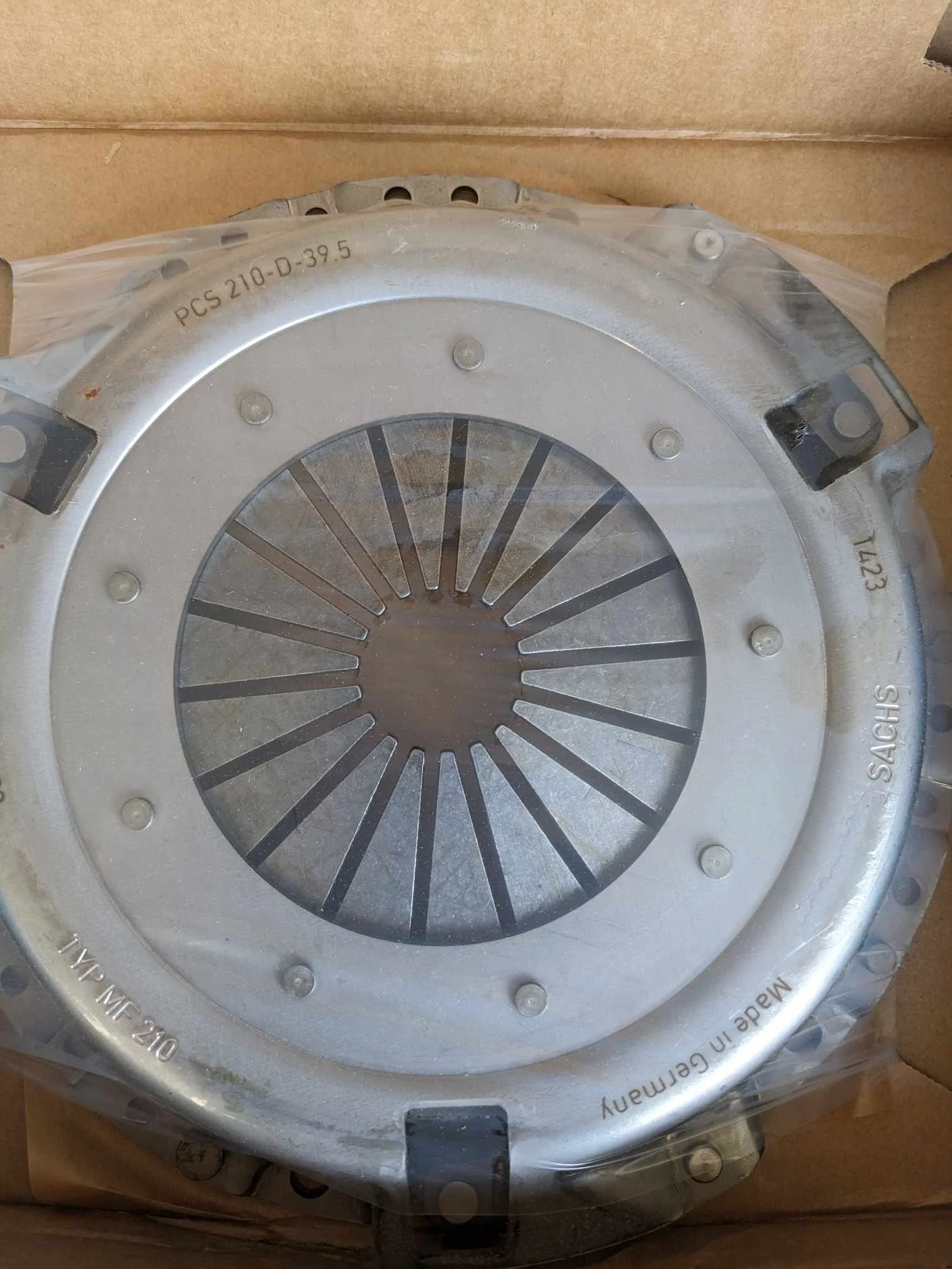

I also managed to finish the clutch off at Cadwell Park, Sachs Clutch and lightened flywheel. Didn;t fancy a paddle Clutch as my noob clutch control likes a little more leway.
