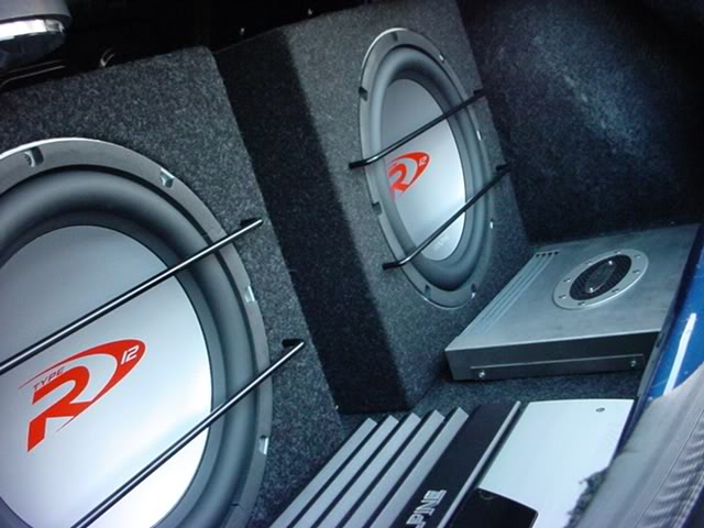

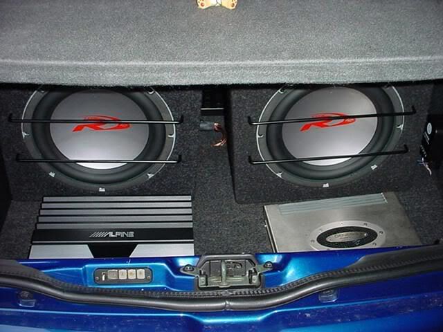

my install!

How on earth do the Amps not blow up..?
Have you fans feeding cold air around them?
Wiring is a mess too.. Should all be tidied up, and seperated, as static from the cables can cause the amps to do silly things, and distort the speakers..
2 x 12" boxes just threw into the boot of any car will never look right.. Go for a double box, or even spend the weekend and do something proper, as those are a couple of good subs, and deserve to be mounted right..
Could keep going, but I'll leave it at that :S

dont need fans there are in the amps if u knew abou alpine amps, wiring would have been tidyer if i had more room obv, so its not a good idea 2 have to singles so i can take one out if i need space rather than move 'your twin box' and then have no subs gr8 idea m8 :dead: , o ye build a custom box and i then have the same problem... keep going im interested ....:rasp:

Im only after installing 2 MRD amps and 2 10" Type-X subs into the boot of an Audi A4, along with SPX components and a further Alpine amp, so i must have a slight clue about them, dont ya think?
When i suggested external fans, i knew exactly what i was saying.. The fans that are built into the amps are all well and good, providing the amp is free-mounted, not buried in a spare wheel well.. They are probably going to reach dangerous operating temperatures, which would cause them to cut out, go into safe mode, or just burn out if that were the occourance... Thats why you need to feed cool air to them from OUTSIDE the spare wheel well.. USE YOUR HEAD :dapprove:
As for the 2 single sub boxes, in MY opinion, they both look naff, and seem pretty pointless.. Your on about needing room in the boot.. Then why not use just 1 sub, as opposed to the 2, and make a permanent fixture for the remaining unit..? Would more than likely be better in SQ terms anyway, as there wouldnt be as much bass to drown the Mids and Highs up front..

Not a bad install, few hints;
  • Make sure those sub-boxes are well-bolted down! An emergency stop may save the dog for 2 seconds while your sub flies past your head and squashes it!
  • Un-hook your boot-light as it's taking the "attention" away from your blue lights
  • Somehow vent your amps - they NEED to breathe!
