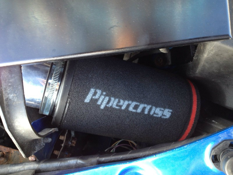

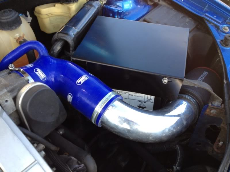

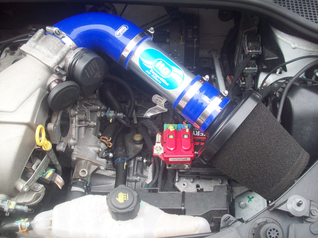

Great update today.

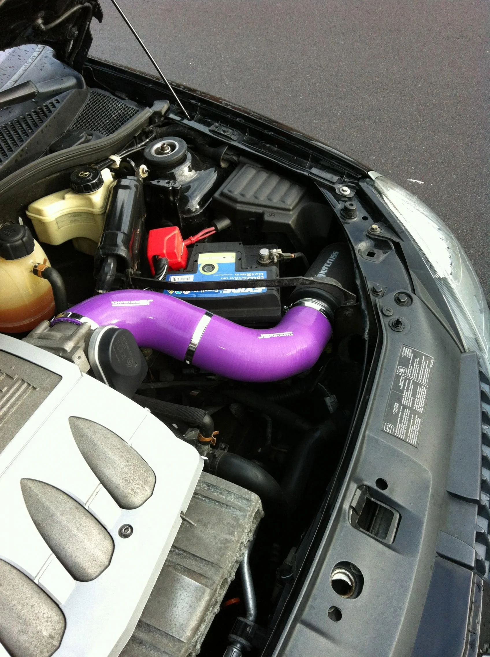

First things first, off comes the passenger side wheel along with the arch liner. The acoustic valve then came off, bolt in the end of the lil hose, and tie everything up.
Next I went about removing the airbox and the two air feeds, replacing them with an 90 degree alloy bend and a Pipercross filter I bought from Regals Motorsport. I wasn't 100% sure whether the Pipercross would fit behind the headlight but as you can see it went in there easily with a little room to move around and position. I think the setup looks great in the bay.
I've taken it for a quick drive and the sound is amazing!! Driving sensibly up to around 3.5k you cannot hear it at all but as soon as you open the taps it roars and puts a massive smile on my face. I'm really happy with this set up (some might say similar to the k-tec item) and it has cost me about £110 all in.
I'm very interested to see what you guys think?

This was the filter I was looking at. (Part number co171?) Looks nice next to the battery cover :)
How much do it cost?
The Pipercross was £41.99 delivered from Regals Motorsport: PIPERCROSS C0171 Universal Air Filter 70mm ID Rubber Neck

I did this only yesterday but personally i would have used a second silicone bend like this... IMG_0466.jpg

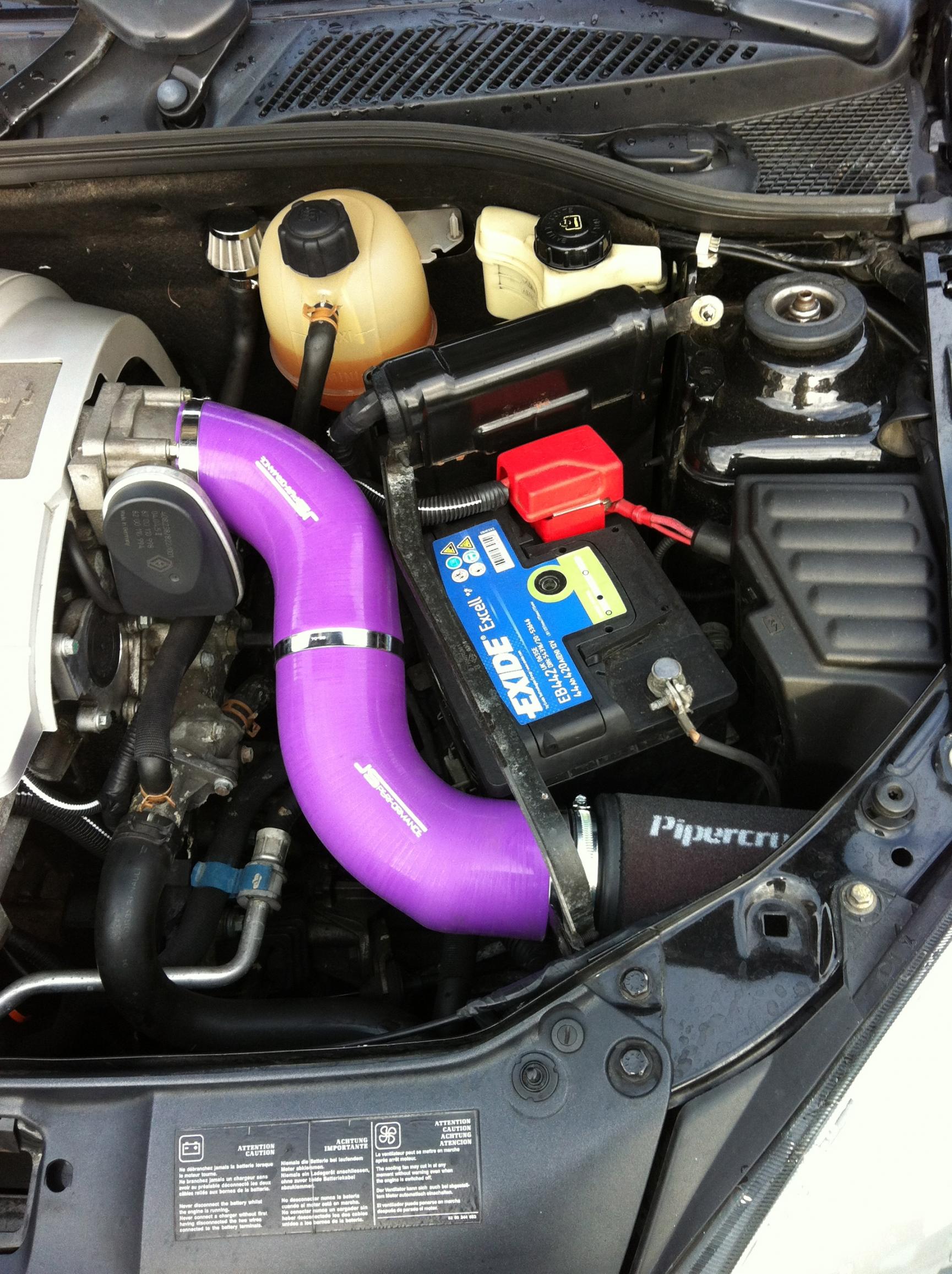

yeah i wanted purple to go with my BG 182 but ktec wanted over 200 ! so thought id give it a go...

Like the purple hoses. Might see if I can get some orange ones for the bean.

2x 90 degree with 120mm leg, 2x 75mm alloy joiner, 3x jubilee clips and a bit of slicing the first 90 degree hose to get the right angle and to shorten the leg ill get another picture up from another angle, and then a small hose coupler for the breather and clipped at the back of the engine bay

They don't sell 75mm alloy so i bought 150mm and cut it in half as it worked better that way, also the diameter is 70mm id for the hose and 70mm od for the joiner, and i used the same filter as the op from regal, i think it came to around 40 ? before filter so not a lot ! get the JS performance hoses as they do 2 brands and these are the better after a discussion with the bloke from boost junkies !
any questions just ask! ohh and they sent it all out special delivery before 1pm... cant argue with that !

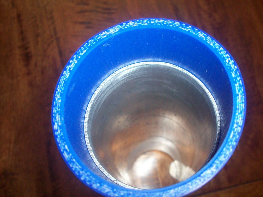

Together with some 70-90mm jubilee clips. The alloy bend needs a 70mm OD to fit the Samco and Pipercross. A much cheaper silicone bend could be used than the Samco but I wanted one with the breather pipe built in.

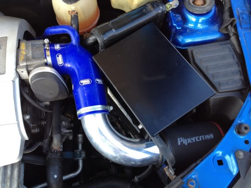

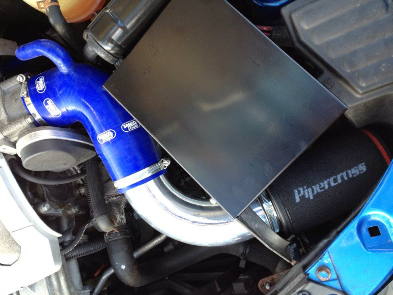

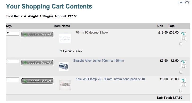

For those of you have been asking me for a detailed list of parts and a how to here goes!
All parts bar the filter are from www.boostjunkies.co.uk

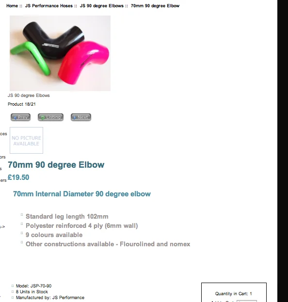

- 2x 90 Degree Silicone (Internal Diameter 70mm) JS Performance hoses - Here

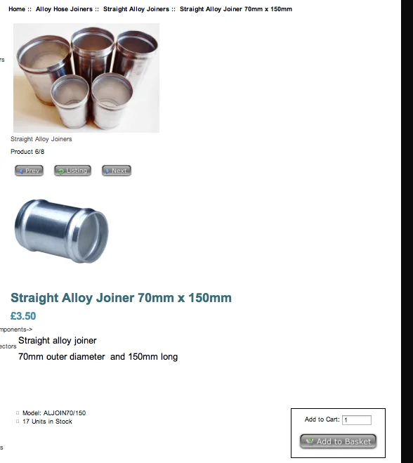

- 1x Alloy (70mm Outer Diameter) 150mm in length - Here
- 3x Jubilee clips (I bought a pack of 10) - Here
This comes to £47.50 before postage in whatever colour you pick !
You have to cut the first silicone bend down on one leg as it is to long, I did this by putting a jubilee clip round and then running a new Stanley knife around the jubilee clip to leave a perfect edge.
The next thing you have to do is take the 150mm Alloy joiner, measure halfway along (75mm) and then mark and cut using a hacksaw or pipe cutter which is preferable as it leaves a better edge, if not just file it down to create a smooth edge so it doesn't damage the silicone hose.

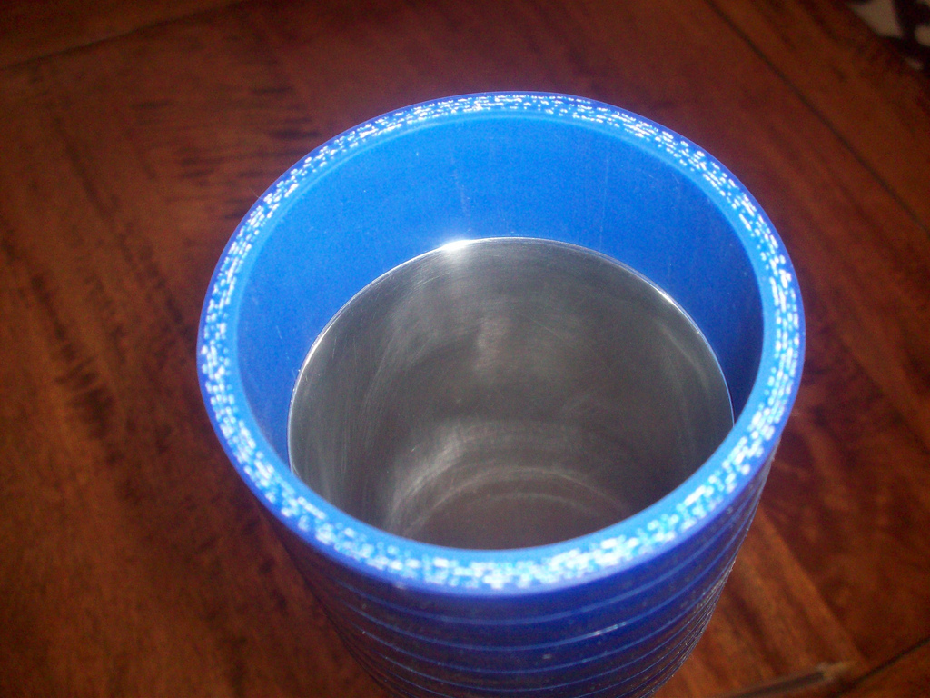

Then place half of the silicone pipe in one of the 90 degree bends and then insert that into the other bend to create the S shape, at the filter end of the pipe insert the other half of the 150mm joiner that you cut and attach a filter of your choice, I used the co177 Pipercross filter from regal motorsports as did the OP.
Then slide over the center jubilee clip ensuring it is half and half over the join, adjust the angle of the hoses to your desired fitment and then remove and tighten so the screw for the jubilee is on the underside of the hose.
This bit is worth a note ensure that you have slid over the jubilee only just loose enough to adjust for the throttle body end before you place it over as it can bee quite tight to get it between them so saves alot of tightening when its just one twist and your done!..
To attach the filter I approached it from the right of the battery tray so I didn't damage the filter and then obviously bolted it up.
Finally i loosened off the battery and slid it against the hose/jubilee clip as you can see in the image bellow and tightened it up to prevent movement of the hose and filter when accelerating.
Any Questions just send me a pm and ill do my best to answer :)
Cheers Ben
