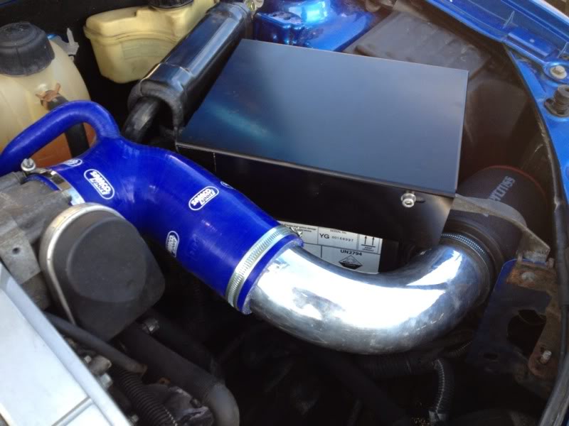

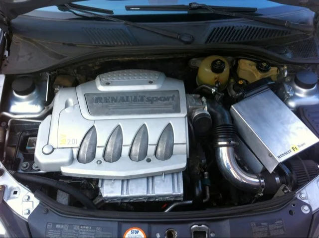

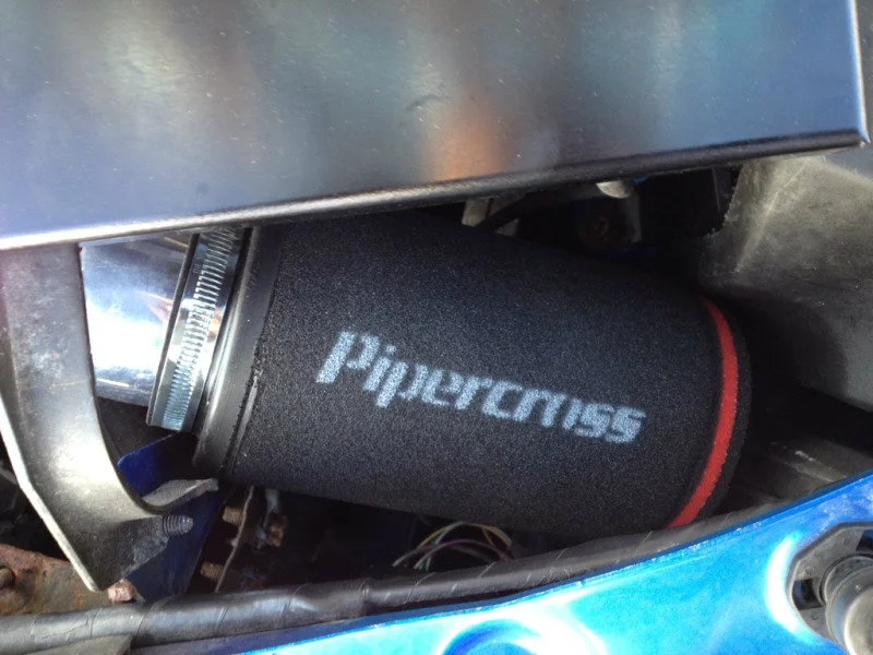

my attempt :) filter is big but it fitted just lol

Wow that is a tight fit! Bet it sounds great though. Mine is still going strong and still sounding amazing.

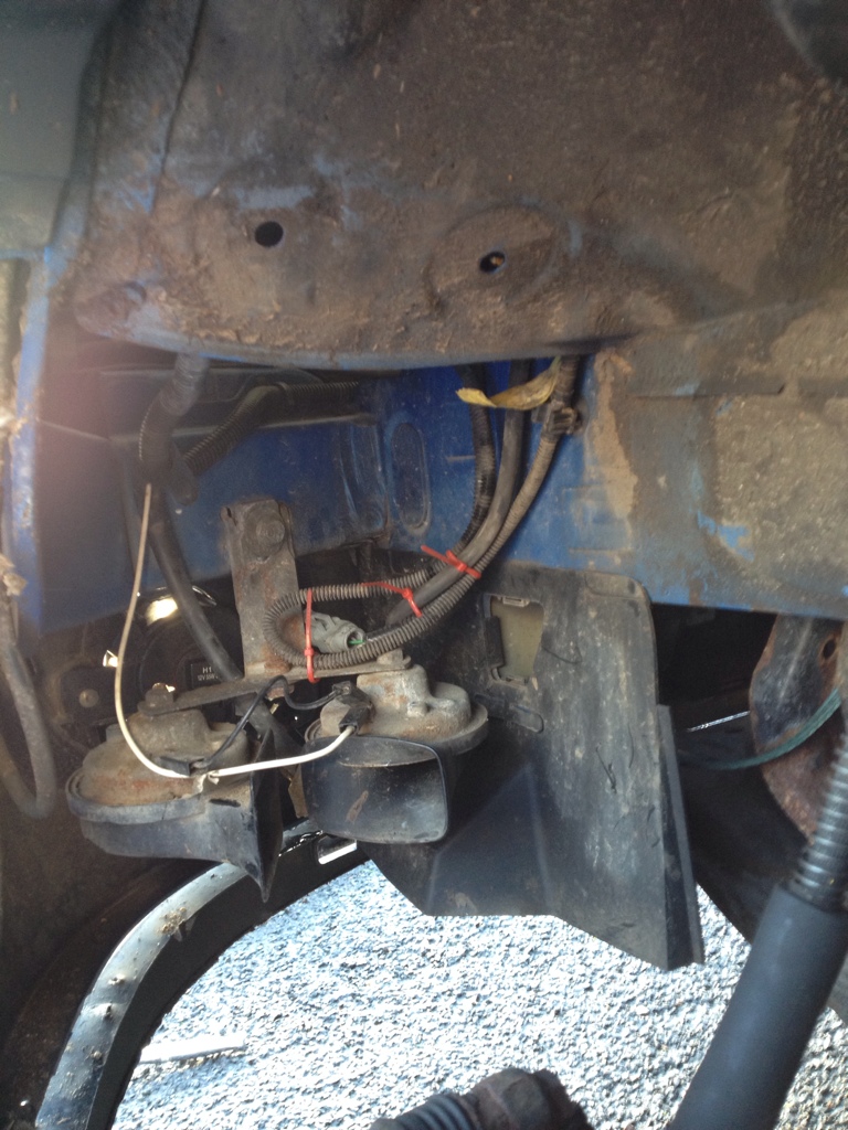

Since you guys are online at the moment, I had a quick look at the caf that connects the acoustic valve to the side of the standard box which is in the way for this set up of course.
Is it possible to disconnect it without taking the acoustic valve out? Had a quick attempt in the dark and it seemed a little obtuse, bit of an awkward angle to pull at and it I didn't want to just yank it out with so many wires in that area of the bay.

Looks good Chris, hows it sounding with the ramair filter, incidently which one is it? I have came across a few ramairs ranging from £18-60 with ID neck of 70mm.
sounds fooking nuts lol im sure its just cos of the noise but it feel like it pulls better in the higher revs , il get a look at the invoice mate and let u know
dyno testing in a few weeks should be interesting

Well the CAF on mine disconnected once I'd taken the acoustic valve off but I'm almost certain the CAF will come off without even touching the valve, just give it a good yank haha.

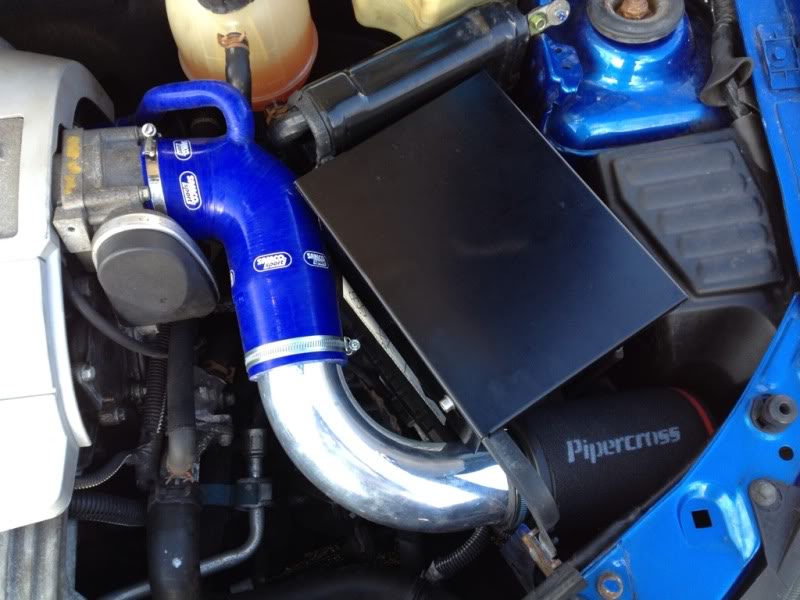

Hello guys,
Because of this thread, I saved money, and completed my intake.
To complement this threat, I thought I should add my set up.

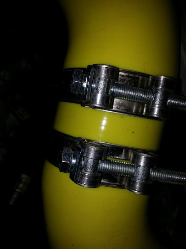

However, I believe I overkilled the tighteners a little bit.
Other then that, the thing sounds fantastic, and is so much more reliable now.
Now it looks like it has a fat amazonian snake attached to the motor!

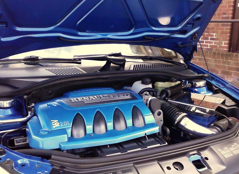

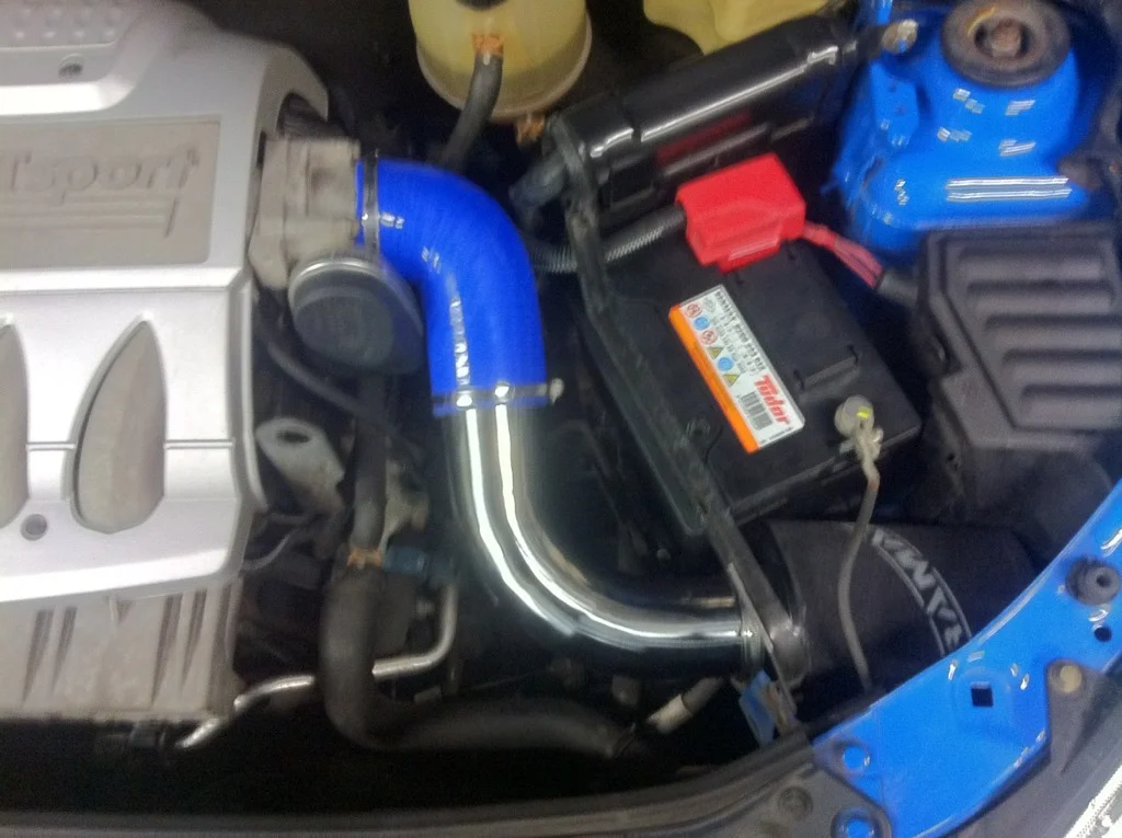

here is mine. Already had the samco so just got a 70mm 90 alloy elbow. Had the Ramair filter at first but was a very tight squeeze so swapped it for the one shown. Really easy job and a great noise.

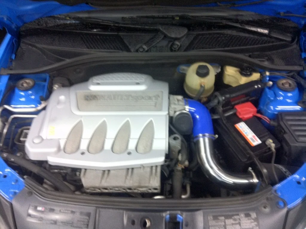

Mine...

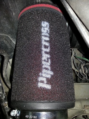

I went with a Pipercross, as have many, as they fit so well in the space and are great quality.
PIPERCROSS C0171 Universal Air Filter 70mm ID Rubber Neck
danward
  M135i
Mine isn't secured by anything, I tried using cable ties but this did not work. The Pipercross fits pretty tightly behind the headlight so although I imagine it does move around a fair bit, it isn't catching on anything or causing any damage. I have had it on like this for a fair few months and the Pipercross itself is still in great condition.

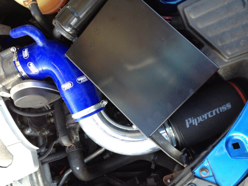

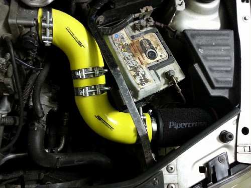

Taken from my project thread:
Great update today.
First things first, off comes the passenger side wheel along with the arch liner. The acoustic valve then came off, bolt in the end of the lil hose, and tie everything up.
Next I went about removing the airbox and the two air feeds, replacing them with an 90 degree alloy bend and a Pipercross filter I bought from Regals Motorsport. I wasn't 100% sure whether the Pipercross would fit behind the headlight but as you can see it went in there easily with a little room to move around and position. I think the setup looks great in the bay.
I've taken it for a quick drive and the sound is amazing!! Driving sensibly up to around 3.5k you cannot hear it at all but as soon as you open the taps it roars and puts a massive smile on my face. I'm really happy with this set up (some might say similar to the k-tec item) and it has cost me about £110 all in.
I'm very interested to see what you guys think?

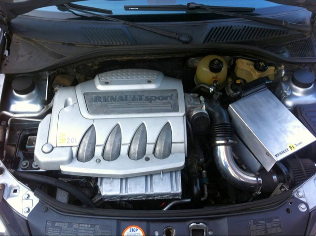

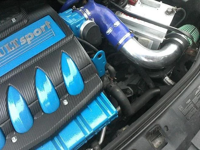

I already had the k&n filter when I bought the car so I just bought the alloy bend on eBay for about 15 quid and here's the result.
Was scared maybe it wasn't gonna fit because everybody is using such small filters but it fits nicely and looks the part I think. Also makes a monstrous sound compared to the regular fitting of the filter! Was thinking maybe a bit too loud for my taste but ill give it some time..
