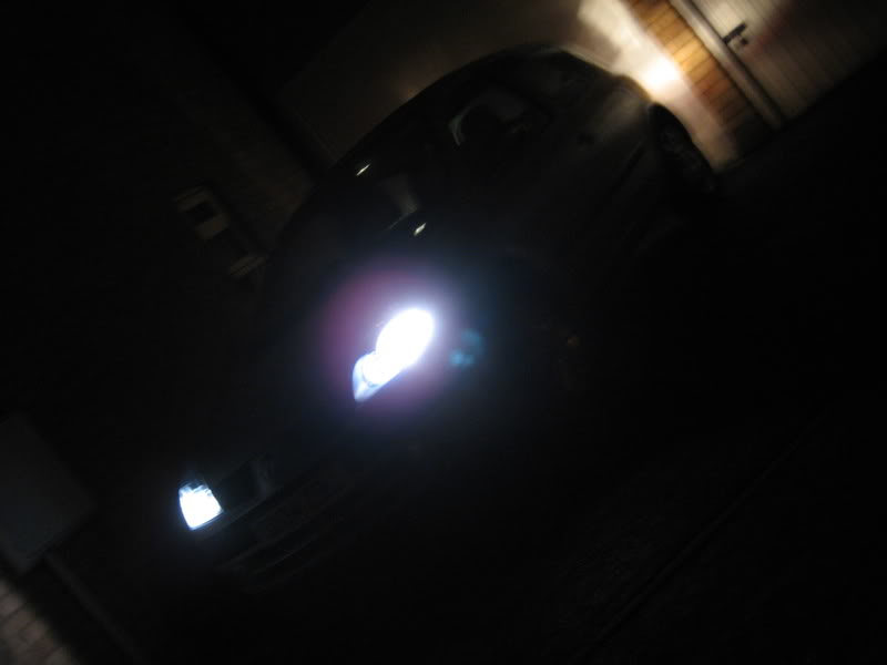

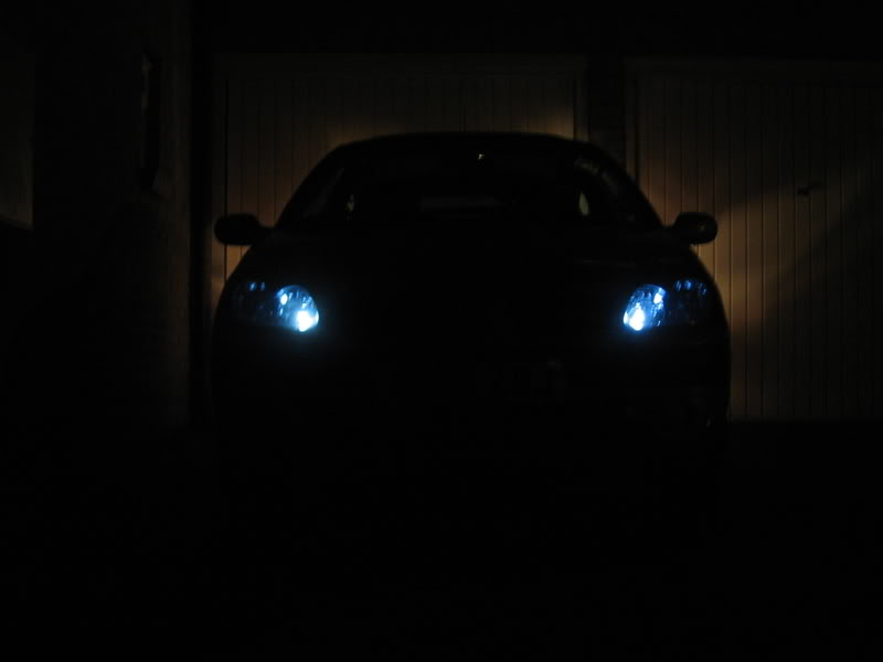

Oh yeah, if u get chance could u post a pic up with the lights turned on? Just wondering wether its a decent cheaper alternative to buying a pair of Xenons!! Thanks
  clio 1.2 16v,
yea mate will get some pics tonight they really do look the part my dad gets them quite cheap own his own car buisness
  clio 1.2 16v,
rite the sidelight look blue there white its really hard to take pics and it was raingin
  Ph1 172 + Combo van
i got the sidelights too mate. are yours 6 or 4 led? gay how the pics make them look blue, done the same with mine

Those look good actually mate I might opt for sum bulbs like urs, easier than paying a three figure sum for a set of original xenons

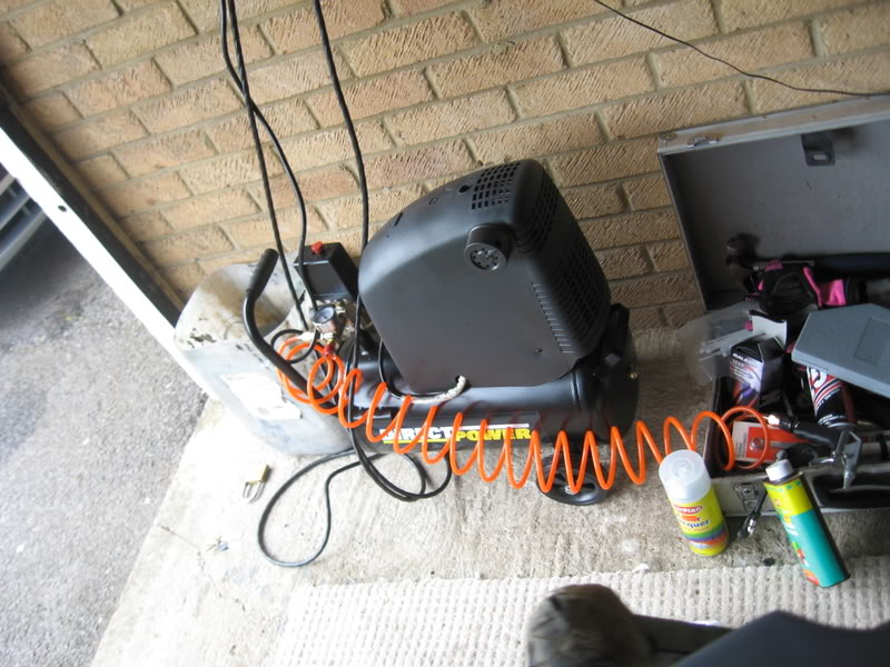

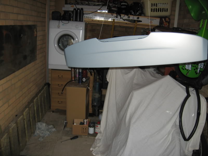

will take some pics tomo with my new compresser in use !!! woo sprray ftw
  clio 1.2 16v,
and excuse me looking rough :p

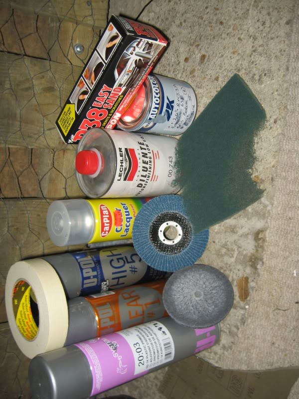

this was what i spent my day doing....
first poped down to my local store, and picked up my supplies :)
then got my new toy rigged up with my spray gun :p
then got my spoiler that was ment to be done, into the primer position
ooooo and cant forget safty procautions
once the primer was done, i decided to heat the room and spoiler a bit so would dry faster :)
and then got going with the spraying , not finshed yet, as have to leave it over night to dry next bit of paint tomo :)

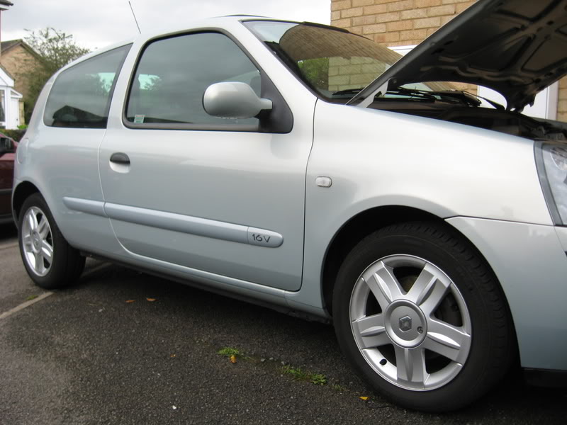

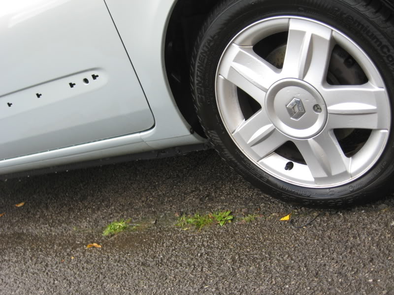

well today i started to get on with the side strips so decided to just go for it really.
starting with......
of the car
primer on

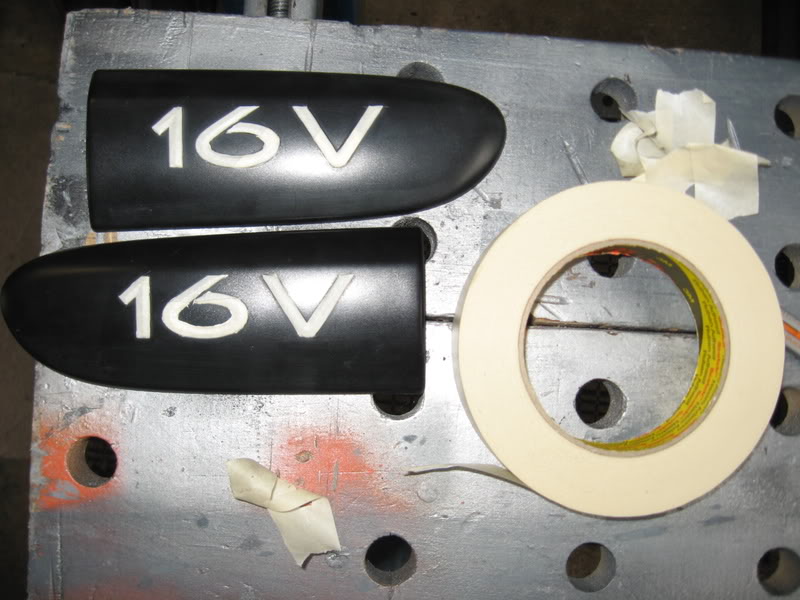

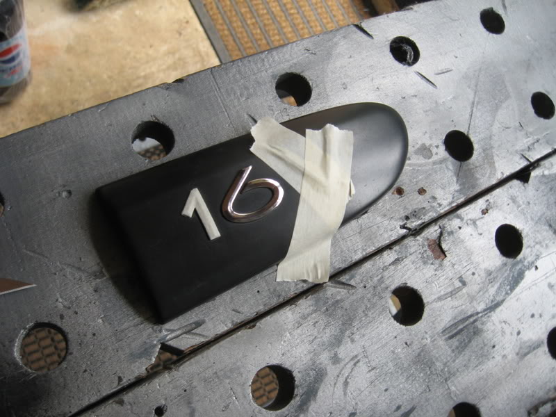

masked up the 16v badges, trying to keep the chrome.
finshed that....
primer finshed
just a random

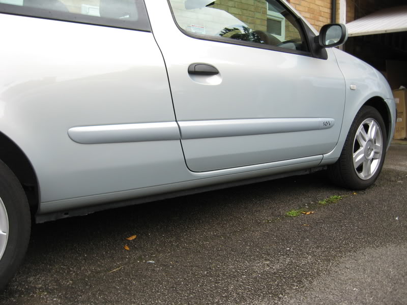

and sprayed, went really well....

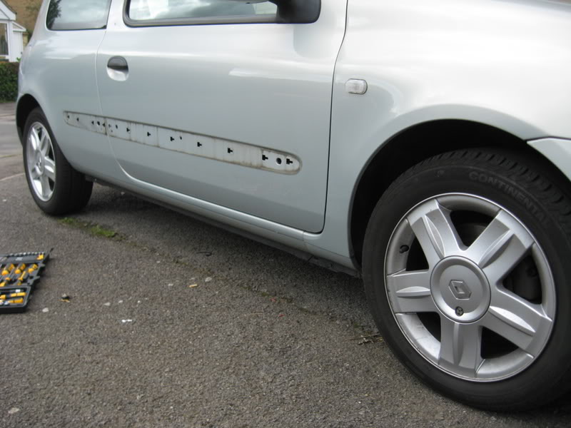

V good progress. I still use the rattle cans, can't afford this high tech equipment ;)
How did you sand down the sidestrips? I spent hours on them taking the orange peel effect off...
  clio 1.2 16v,
they still have a tiny bit of orange peel on them but planning to change them this was a test, use 5 lots of sand paper and green stuff, with a maching, also with a bit of sand blast

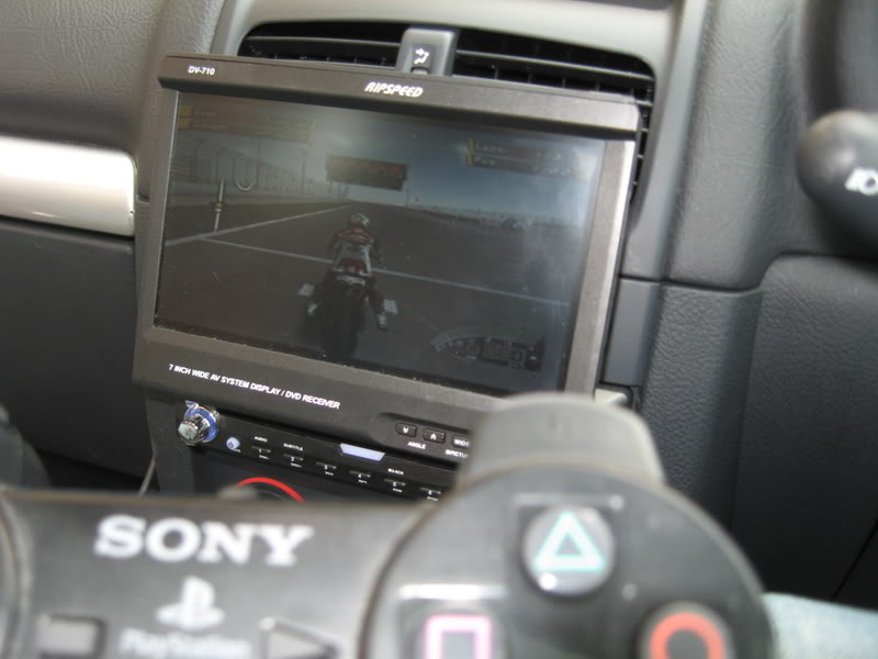

The PS2 install looks pretty swish, much trouble?

its really once you get a very bright light to it, i was planning to have the bumpy effect on it, (i quite liked it) but turned out better not,
just finshed my mates smoothed his rite down,
i started with them off the car,
sand blasted them, took some off, smoothed it with some wet and dry and teh used green abrasive stuff toge t the rest of with a machine, really smooth!!!! took about hour to get it perfect.
step 2
drying them off with air gun. and then using plastic primer, clear primer , then use high build grey primer filling the gaps/ as you can see in the pics of the badges and stuff...
step 3 after drying with hot air gun, baking, all of that mixing paint half paint half thinners.
step 4 hanging them up, and spraying used about 3 4 coats, of silver, then 3 coats of shinny laquor,
turned out really good
thats is basicaly a short quick version of what i did :)
