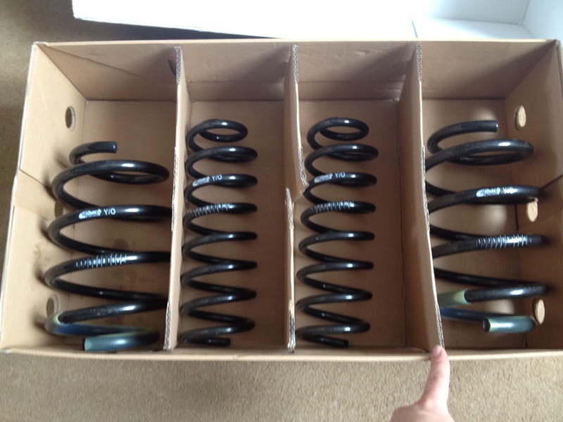

Ordered up new track rod ends from ECP (Thanks Nickson) front pads and discs and rear pads from G172 on cliosport, rear discs and caliper pins from worldsaparts and Eibachs from Demon Tweeks using club discount so they were actually the same price as 2 rears!

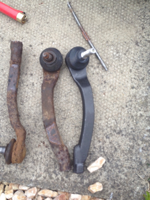

Started with changing the TREs

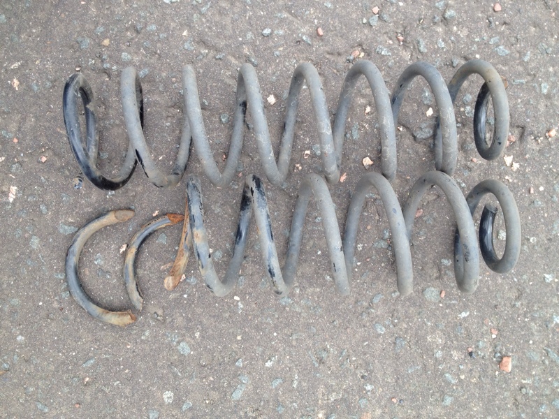

and then moved onto the rear springs and you can see the difference here
as you can see one was very past its best!

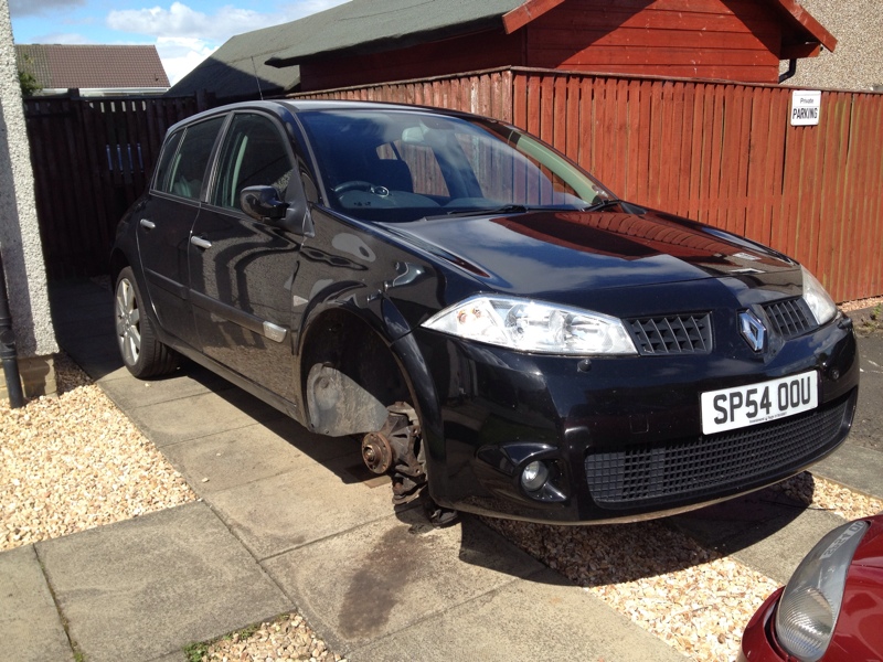

Did the fronts today, which was an overcomplicated joke of a design imo but maybe I'm still annoyed that I can remove and refit a clio 172 engine in less time than just this one job!

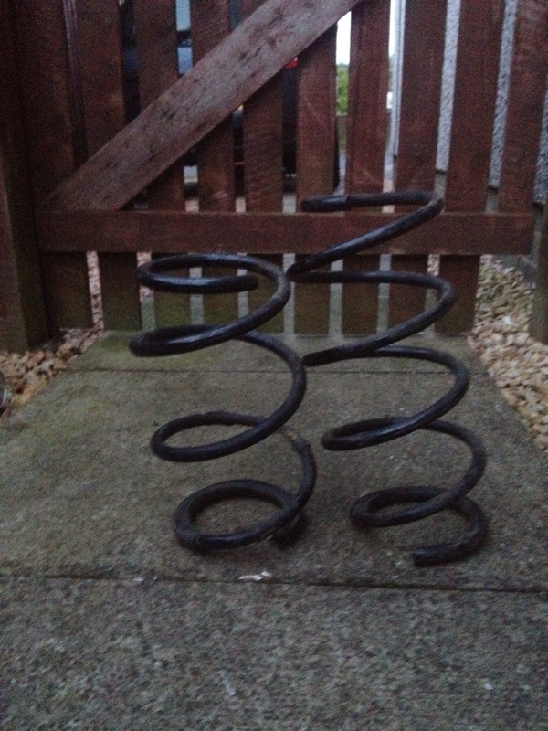

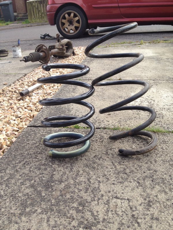

When I took the springs off the shocks I noticed something. it had clearly had 1 cup spring fitted at some point! Very glad I went for the Eibachs now! Will get a pic of them next too each other tomorrow, forgot to today!
The 2 front springs that were fitted!
The difference between a non cup and eibach

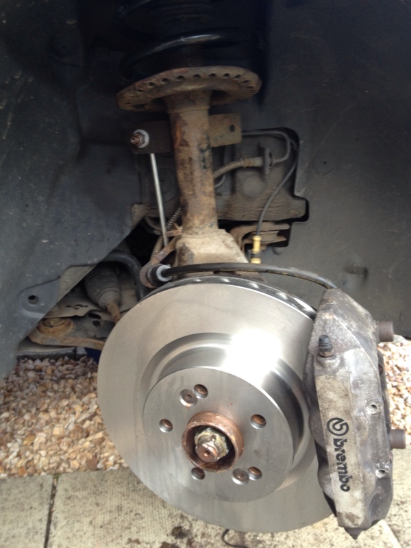

Just waiting on a couple of parts to arrive and going to order up some drop links tomorrow and that should be that taken care of for a good few years again. Both hubs seemed to mover nice and freely at least!

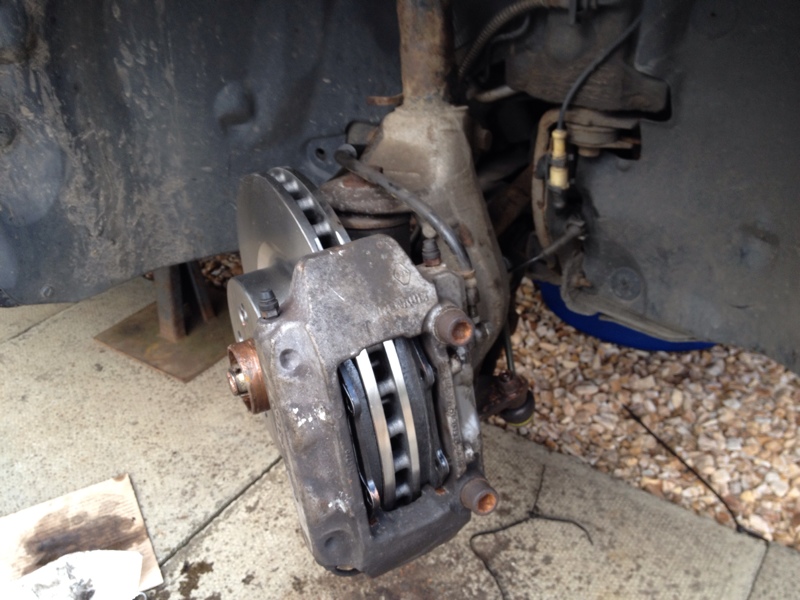

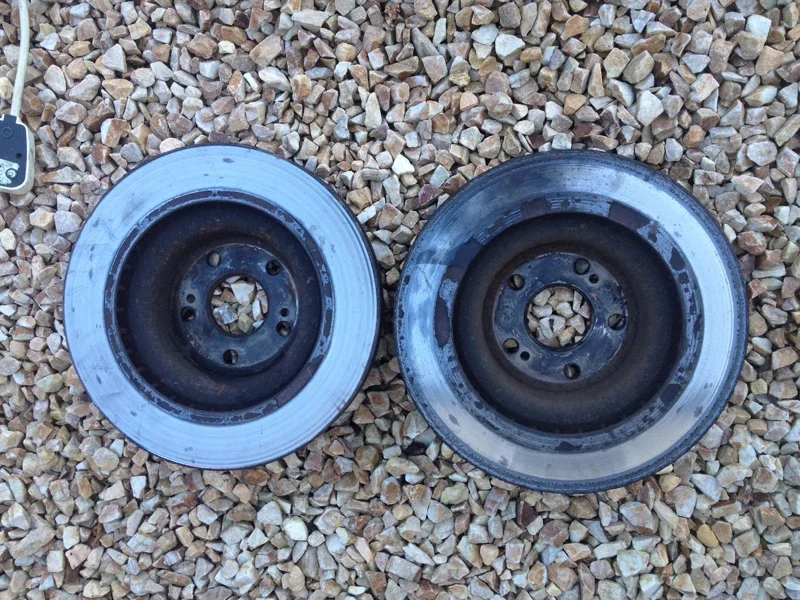

And this may explain the front brake imbalance abit!
Gonna make sure all the pistons are nice and free too.

Those discs look baaaaaaaaad! My rears were just as pitted before I changed them.
The difference between the Eibach and the standard non-cup springs is ridiculous!

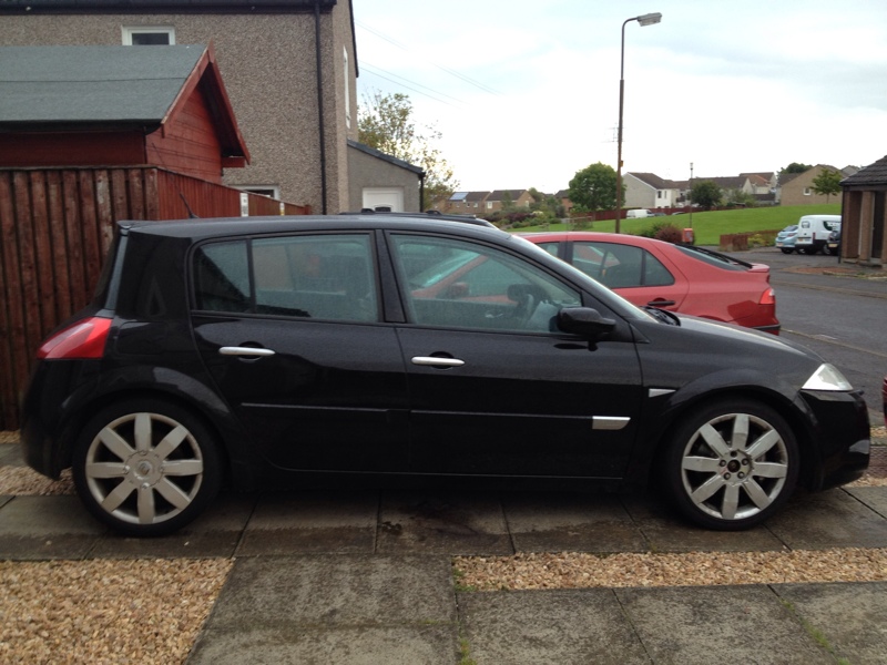

Aye should be a nice drop but without it being too much.
This is how it is just now, think the springs need to settle a little ;)

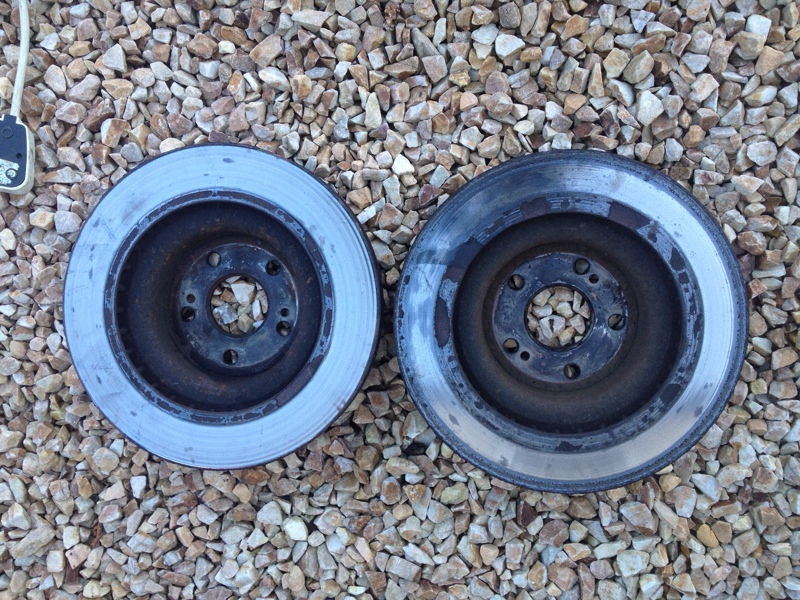

Oh and wait till I take the rear discs off! I knew they'd fail but hope I could chat my way out of it. Then I saw them and didnt even try!

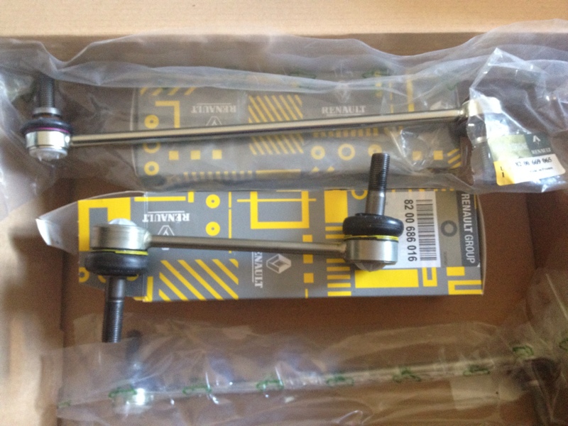

Nope, the drop links cost £48 for the pair, the smaller hub links cost £87 the pair. And thats from RPD with a further 10% off, should've been £150. Hub link is a 225 specific part. f**king cars.

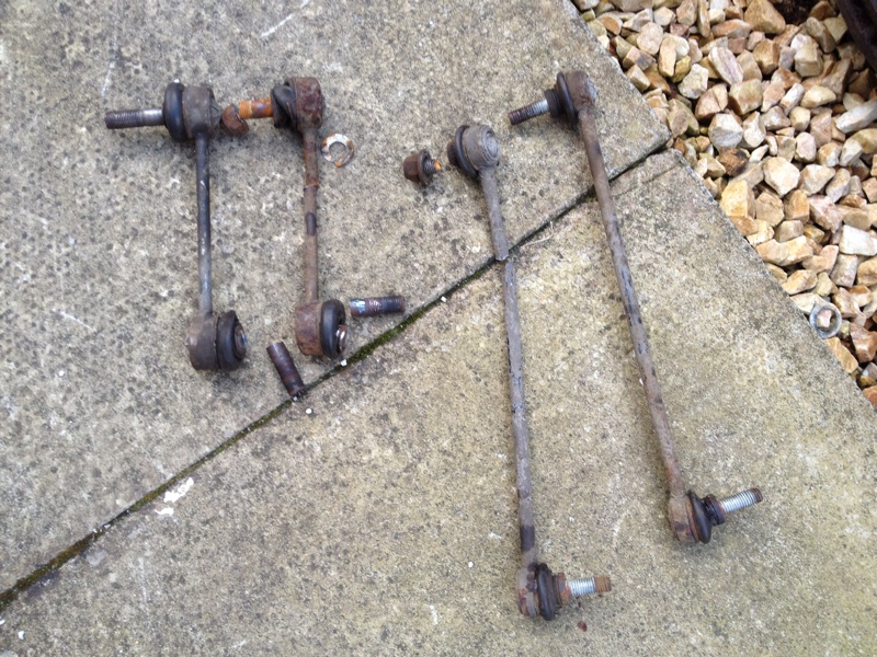

Progress is progress, kinda. Not everything is going to plan! Still waiting on some parts arriving and as you can see in the above pic the hublinks came without nuts. Which I thought was kinda tight when they cost so much and you should use new nyloc nuts each time really. No worries I thought, I'll nip out and get some M12 nylocs, but no, these are M12 Fine thread and a special order for my local specialist tool shop, dont waste your time going to halfords, maplin or b&q (all were where I was anyway!) as they don't do them. Hoping that the ordered ones are right and if they are then I'll have 96 spare that I can sell on to anyone that wants some.

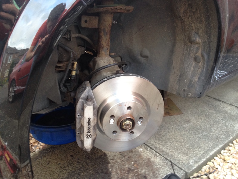

Only had 1 nut off the old hublinks so had to free off the others from the remains of what we'd grinded off but at least they are on so I could drop the car back onto its wheels. Also fitted the front brakes. Kind of. One of the parts I'm waiting for is the caliper pins so the pads are not secured at all so handbrake only to stop it when rolling it back on the drive!
Firstly the remains of the previous droplinks and hublinks
New ones fitted along with the new brakes
And dropped back down. Uneven drive way and brand new springs mean I think it'll drop a good 5-10mm more once out on the road and being used.

Your drop links and connector arms were rather worse for wear.

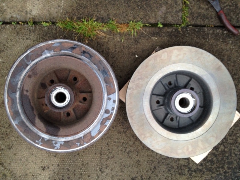

Finally the rear discs and caliper pins have arrived!!
So I got all the tools out earlier only to be met instantly with a hailstorm like I've never seen before and thunder and lightening for the next hour followed by about 4 hrs of persistant rain, bugger!
So after dinner I manned up and faced the midges and got cracking.
Got the rear disc off the os and whilst I'm quite embarrassed to so you this pic it is a good visual reminder of why you shouldn't leave calipers that are seized and you should fix them asap.
Whoops!
Anyway, chucked the new disc on, put the pads on and then the bloody heavens opened again and the thought of continuing in the dark and pishing rain wasn't appealing very much so will carry on tomorrow.
