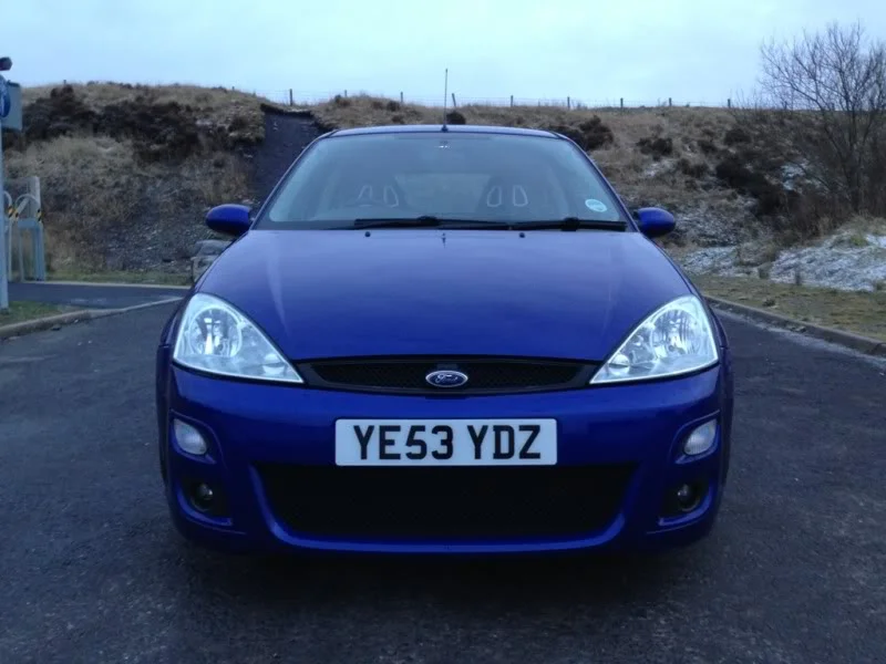

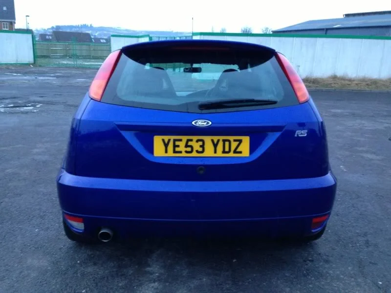

Plan was to wait a while and get some money together but i lasted all of 2 days and bought the RS

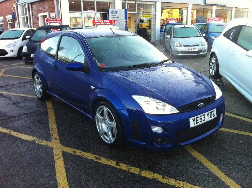

Saw it advertised in a local ford dealership and jumped at it
Picked it up on a really cold and frosty morning :)

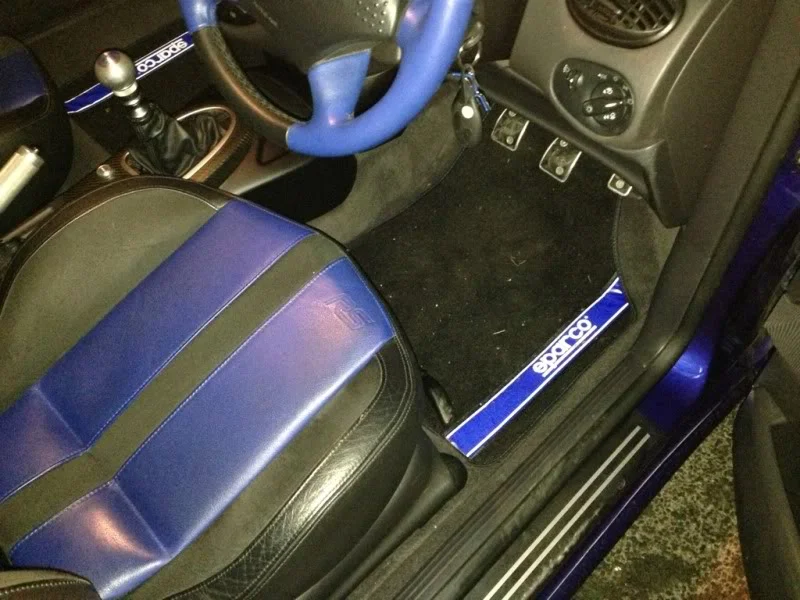

First things first was a set of sparco mats to keep the theme going (not to all tastes lol)
Was really over the moon with it, only issue was that the chargecooler pump was acting up so bought a new one and got that fitted straight away, alon with a 'smooth' plastic rear wiper arm and got rid of the rubbish looking metal standard one

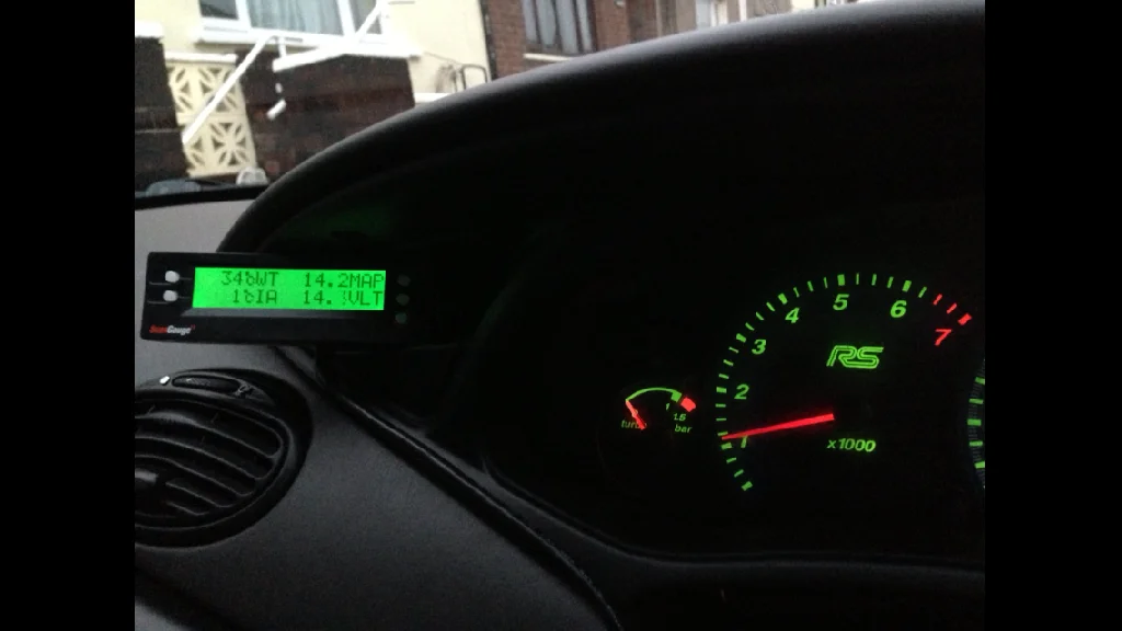

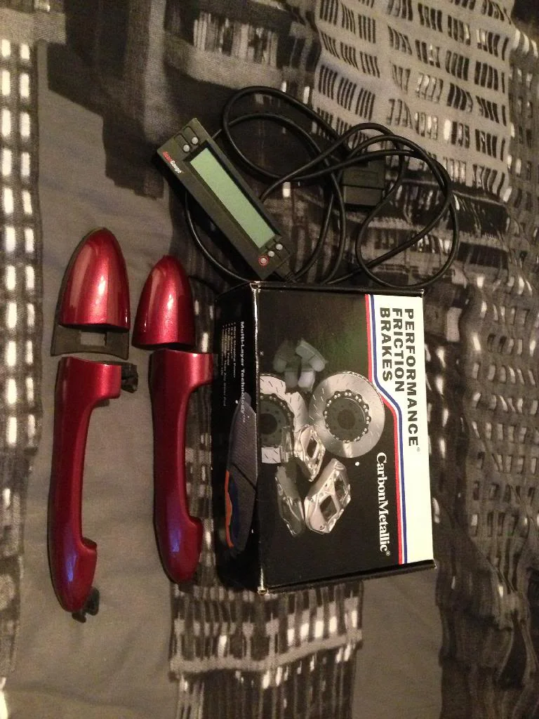

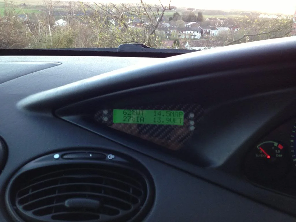

First up was to sort out a scangauge, the RS doesnt have a water temp gauge and i didnt like this so bought one of the RS forum
Along with some new pads on the front as i didnt like the redstuff pads on the front

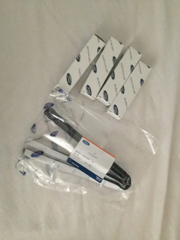

And some focus 5door rear handles which will be painted and used to delock the front :)

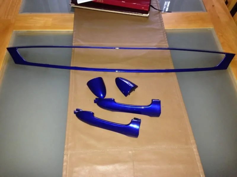

Thought id get the grill surround colour coded too at the same time
Scangauge in, temporary i just wedged it in the coin tray, and was going to tidy it up later on

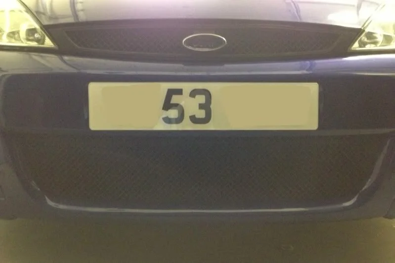

Some clean number plates
Slightly cut down on the front to fill the gap like the clio

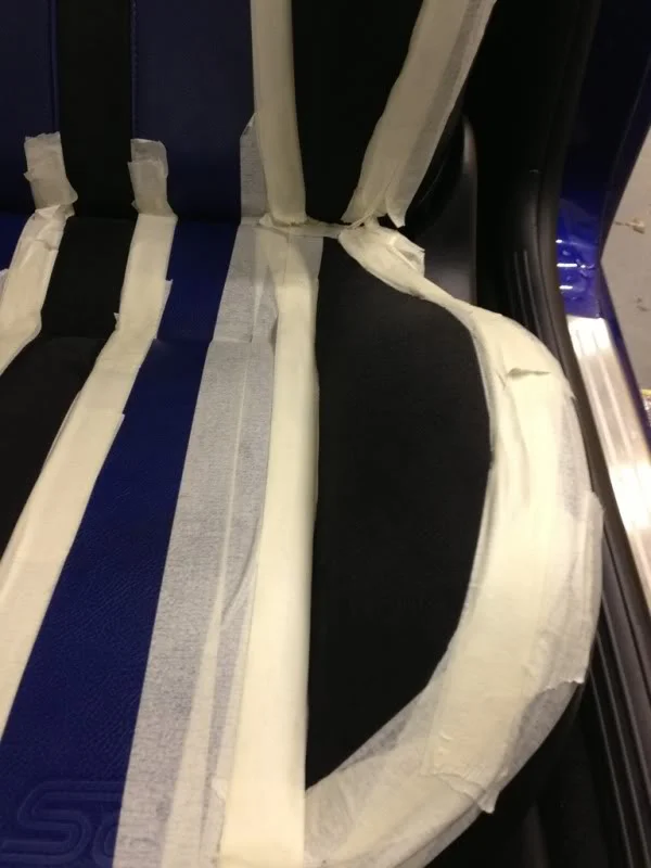

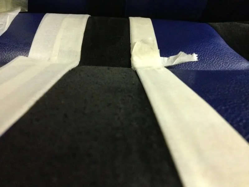

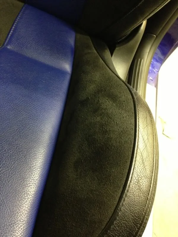

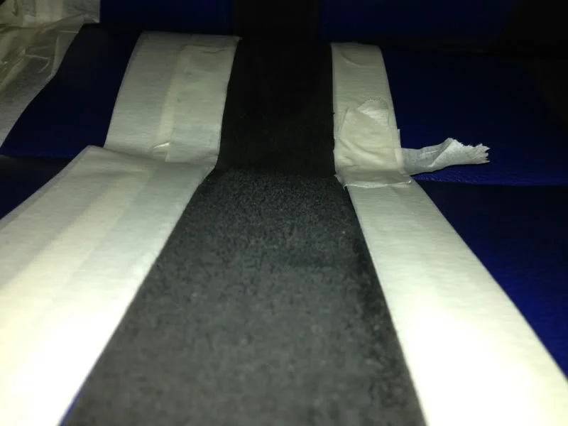

And the alcantara was bubbling so put a razor to it to clean it all up:
Before:
After:

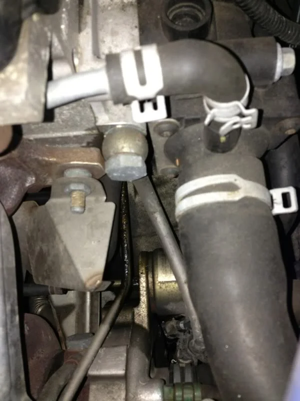

Went to the garage one day and found a small puddle of oil on the floor and on the turbo actuator
Luckily i traced it back to the cam sensor o ring had split, new o ring for a few pence and was back in business

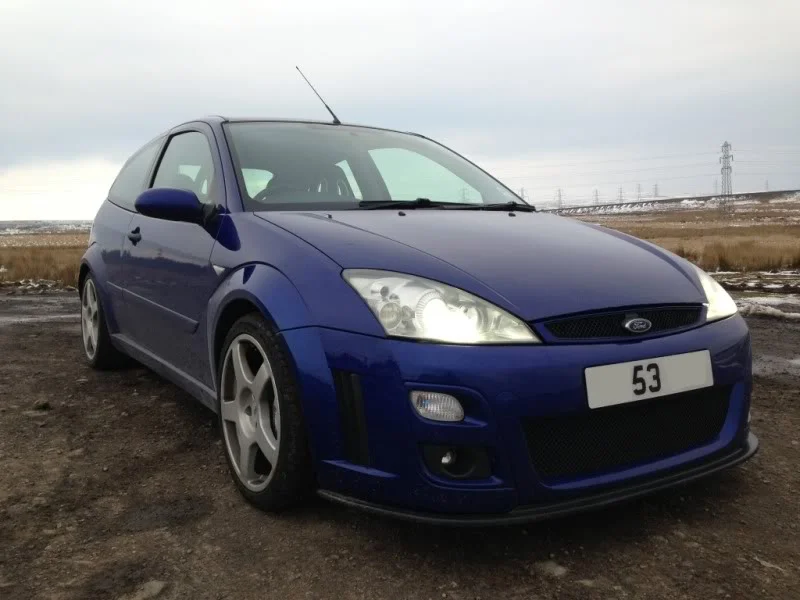

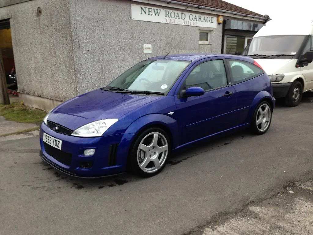

Then browsing ebay i came across a front splitter for £20 delivered!
So i snapped that up straight away and fitted it (front grill surround missing in this pic as it was being painted)
Sets the front off lovely :)

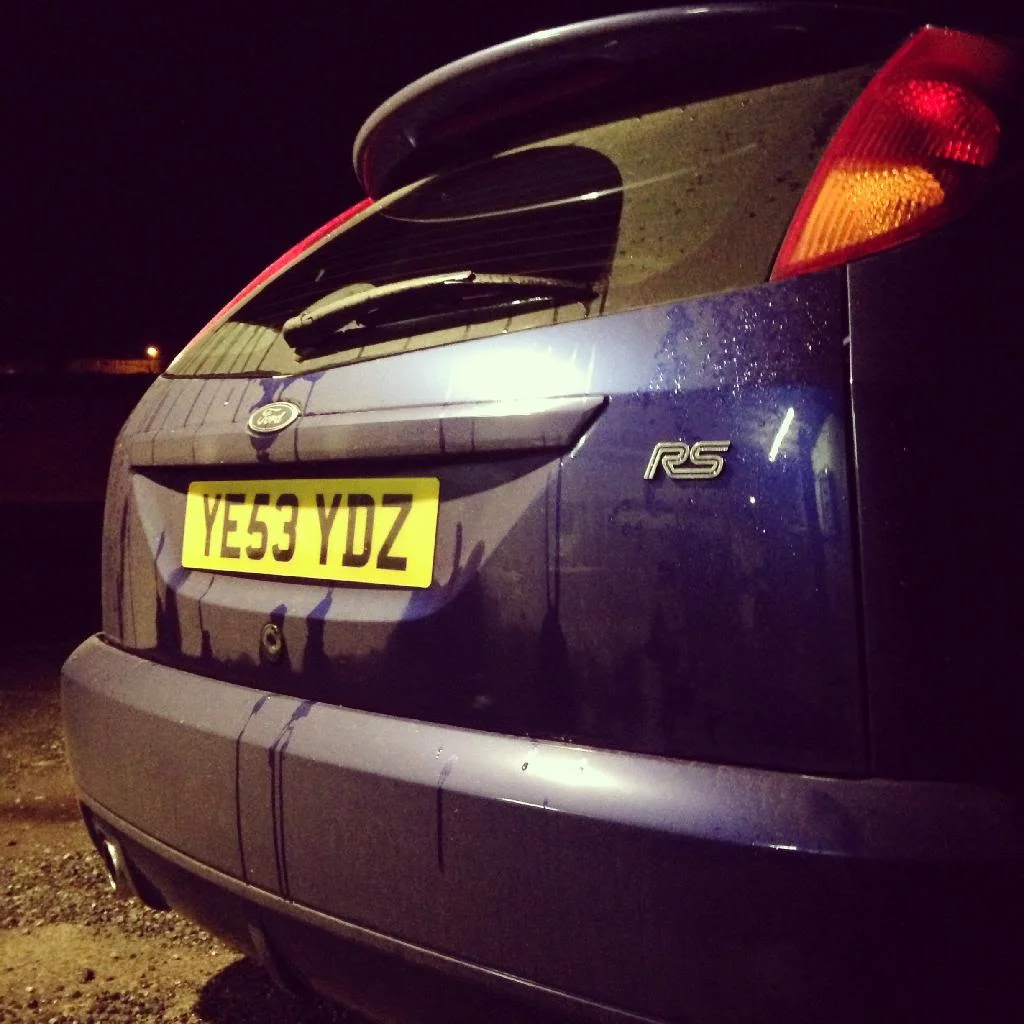

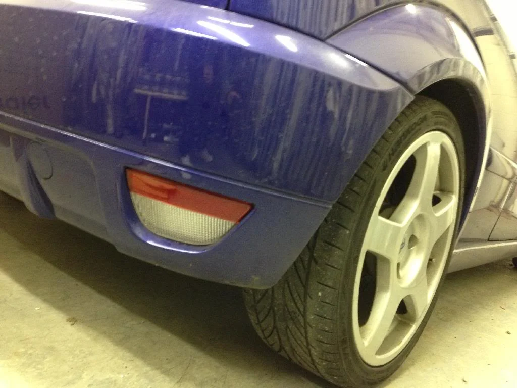

Another popular mod is a 'euro' reverse light off a left hand drive focus so they matched, another ebay bargain at £11 delivered from lithuania lol
(Metal wiper arm back on in this pic as i snapped the plastic one accidentally lol)

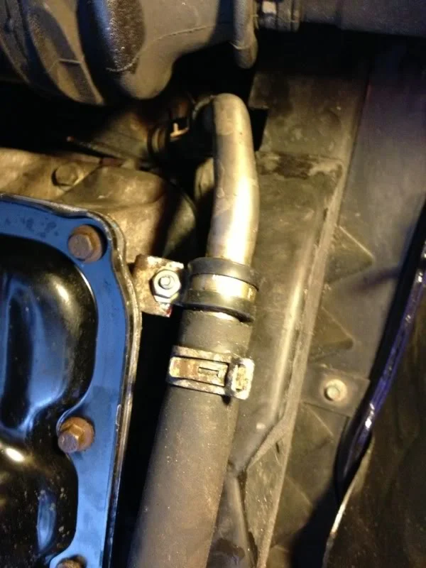

When doing the belts the guys at sabre pointed out that the sump was rusting pretty badly and theres a pipe that runs from the oil cooler that rots and this is starting to go

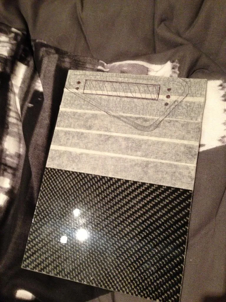

Got started on the scangauge mount, purchased an ST170 clock surround which does away with the coin tray and a nice space to put stuff so i got to work:
All done :)
Going to redo it sometime in the future and tidy it up

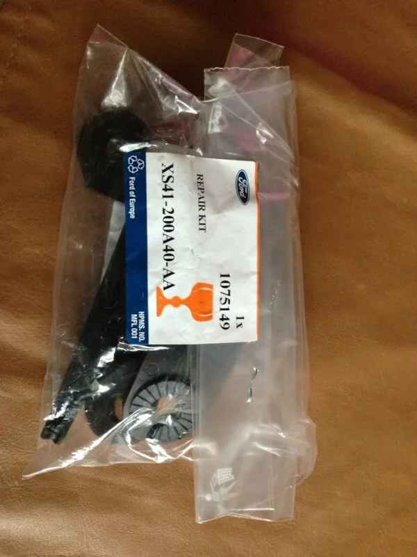

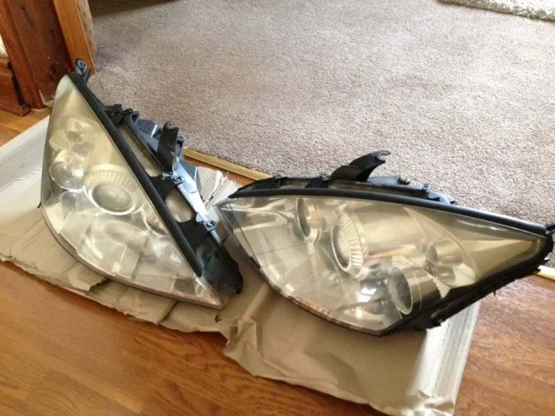

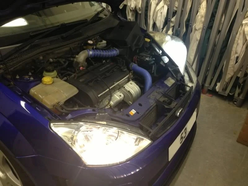

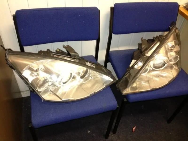

Main thing i missed from the clio was the xenon headlamps, was tempted to put a HID kit in but thought id do it properly, xenon headlamps out of the ST170 are a good upgrade but on ebay a good set was fetching upwards of £250 so thought id wait then these beautys popped up:

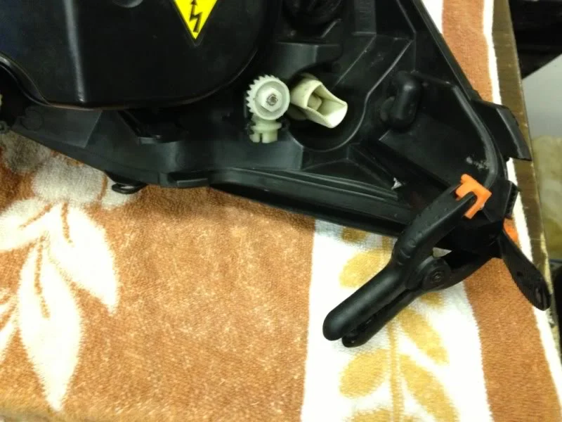

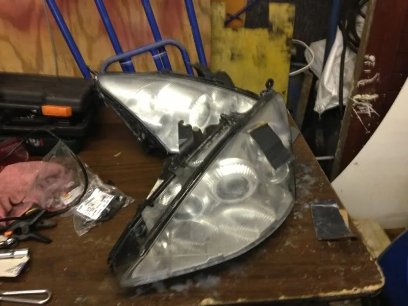

After some messaging with the seller they had all ballasts etc present but were hazed over and snapped lugs but a cheeky offer just into three digits and these turned up
Yep, looking pretty rough.
Have to rewire them to work on the RS, took my time and got there in the end, did the full job and they also work with the headlight leveller inside the car, was a pig to wire but worth it
Ordered a lug repair kit from ford
Then was time for a test to see if my wiring was any good
One…
And two…
All that was left was to tidy up the lenses
Used the guide on here to restore them, bit of sanding and then polished up
Job done :)

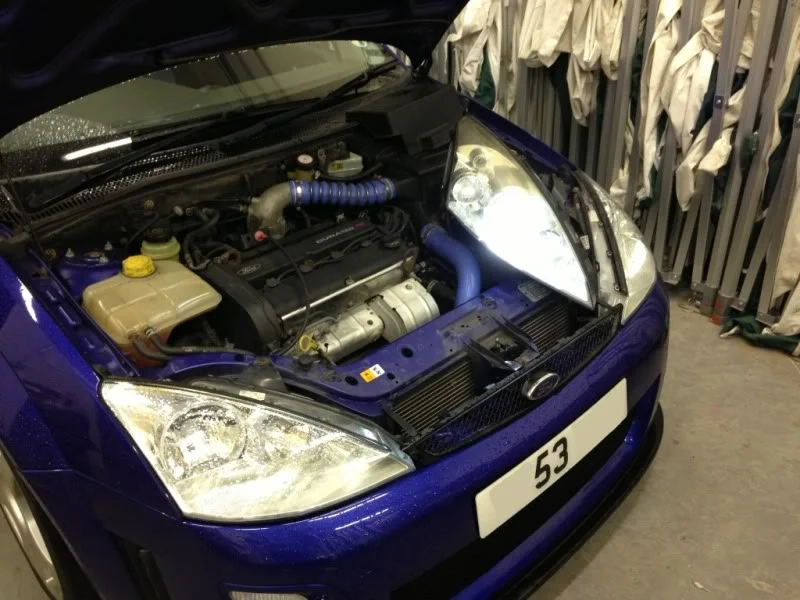

Time to get them fitted:
Job well done

Grill
Handles:
One of my favourite changes the handles, should have been done from factory

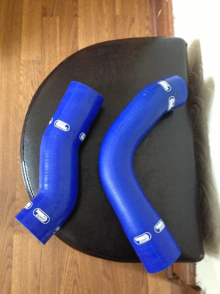

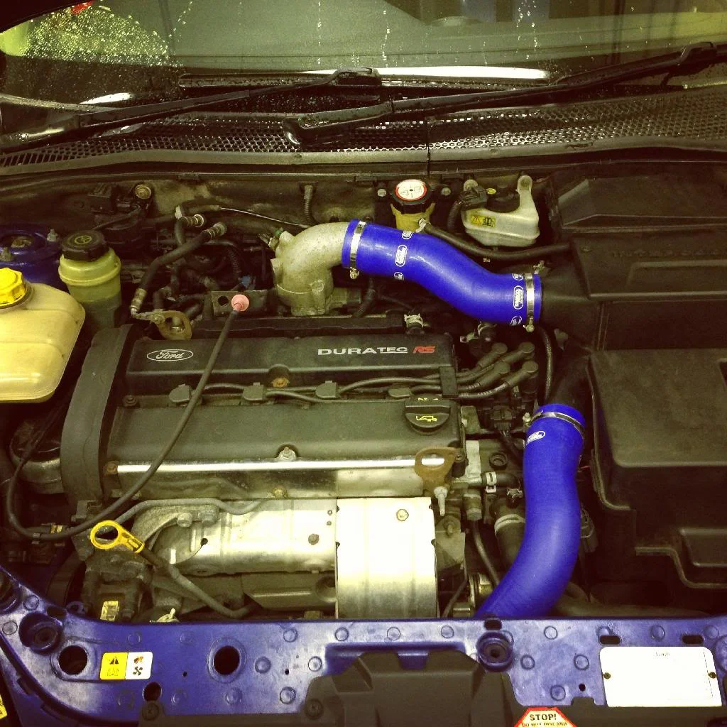

The car was starting to get a little laggy on gear changes on boost, another common fault was the standard boost hoses are paper thin and collapse under pressure as they age so some samcos took care of that
Was crazy the difference they made to the way the car drove

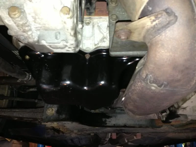

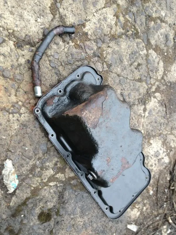

Previously i mentioned the car was advised of a rusty sump and oil cooler pipe, as i was going to service the car it was pointless putting fresh oil in a sump id be taking off soon so got it all done in one go,
Nice pile to keep me busy
Dropping the cat off was a bit of a nightmare but got there in the end
Nice new sump
Alloy oil cooler pipe
Two offending items ready for the bin

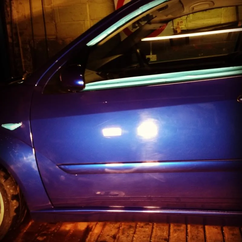

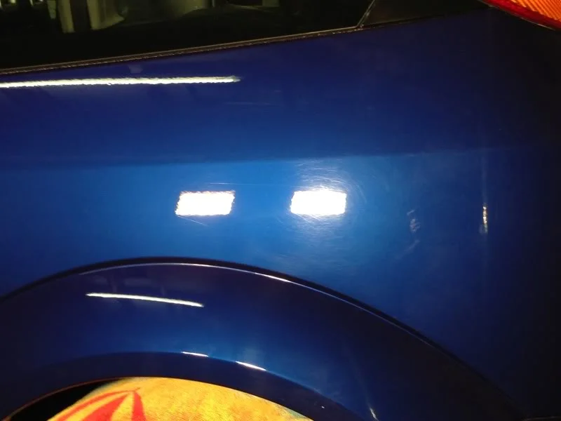

Next up was to sort the paintwork out, really badly swirrled
I think the previous owner was meticulous with servicing etc but just put it through a car wash or a fiver hand wash job,

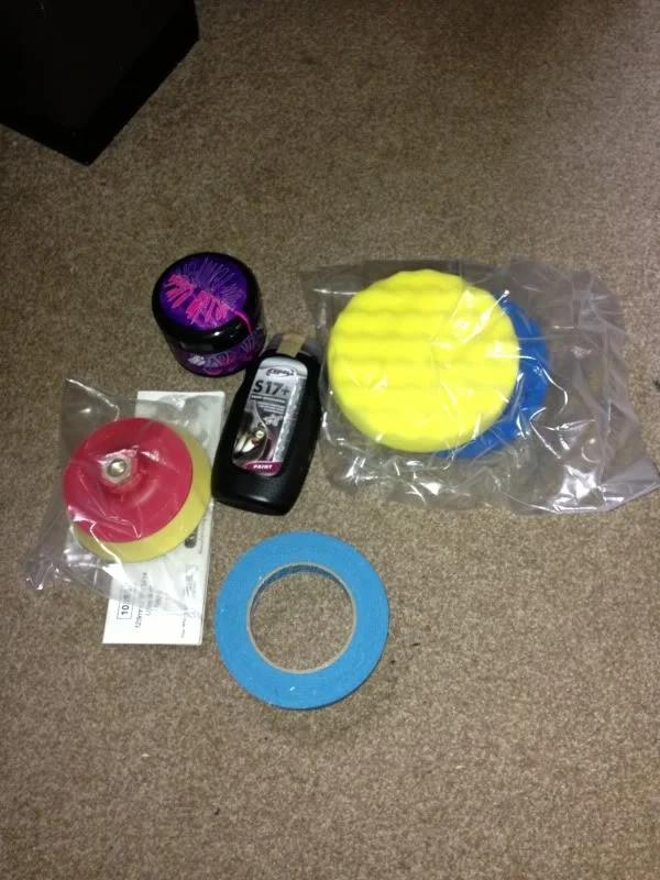

Being one to 'have a go' i asked for some advice on what products to use on a rotary i borrowed off a mate i bought this little lot:
70 quid doesnt go far lol
And i set to work, got my lights setup, washed and clayed the car etc
Sort of 50/50 on the door
Rear quarter
I was only looking to improve the car and not perfection, theres a few deeper scratches etc left but im happy with it for a first attempt

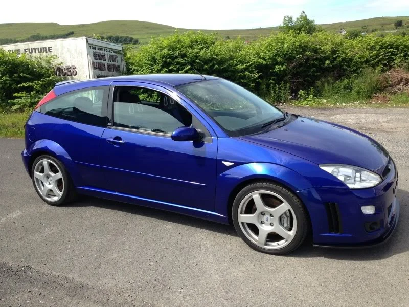

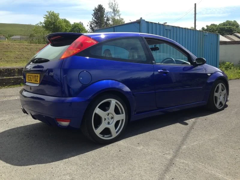

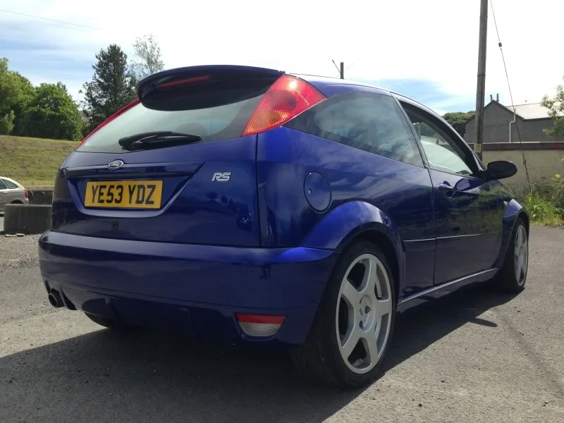

Some finished pics:

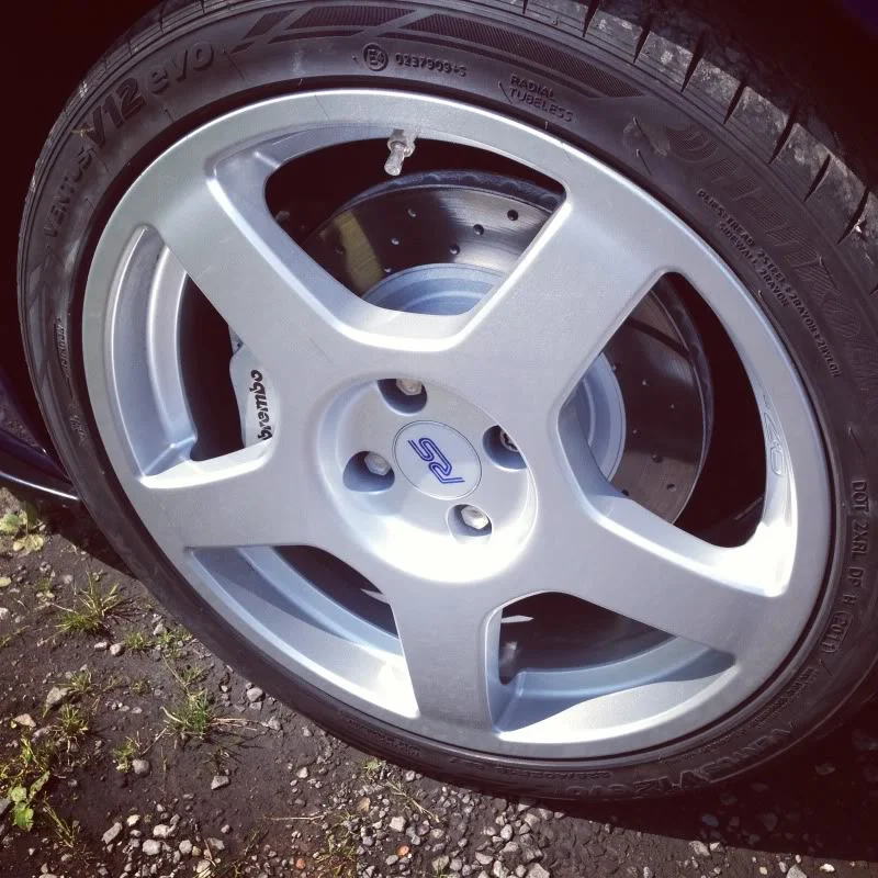

After this the wheels were letting the car down, badly curbed and the centre caps were corroding, so i painted the discs as they were rusty too and got the wheels refurbished with new centre cap badges from DMB graphics

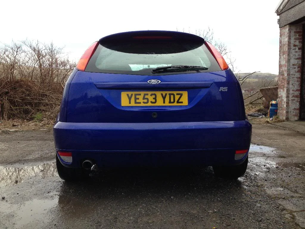

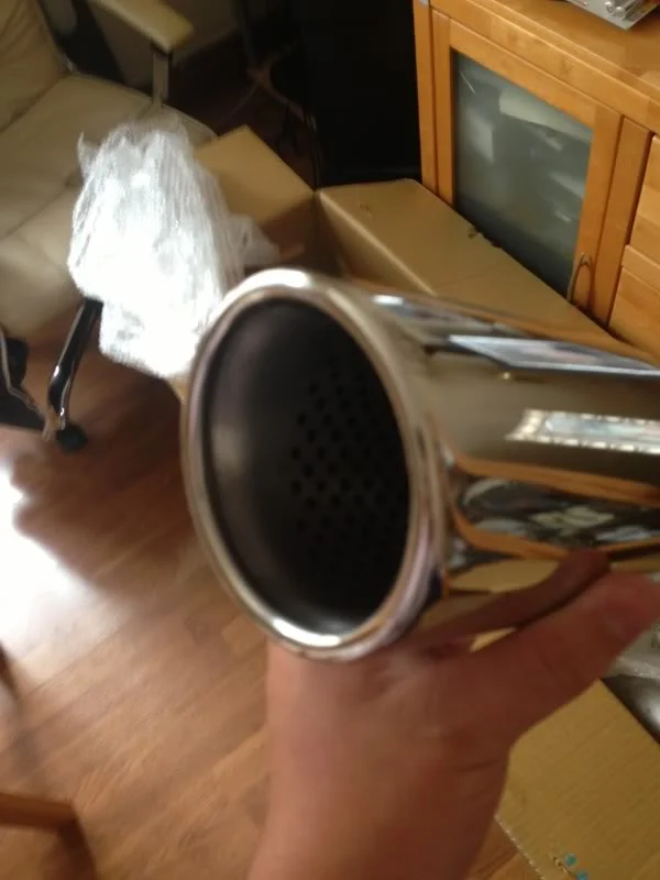

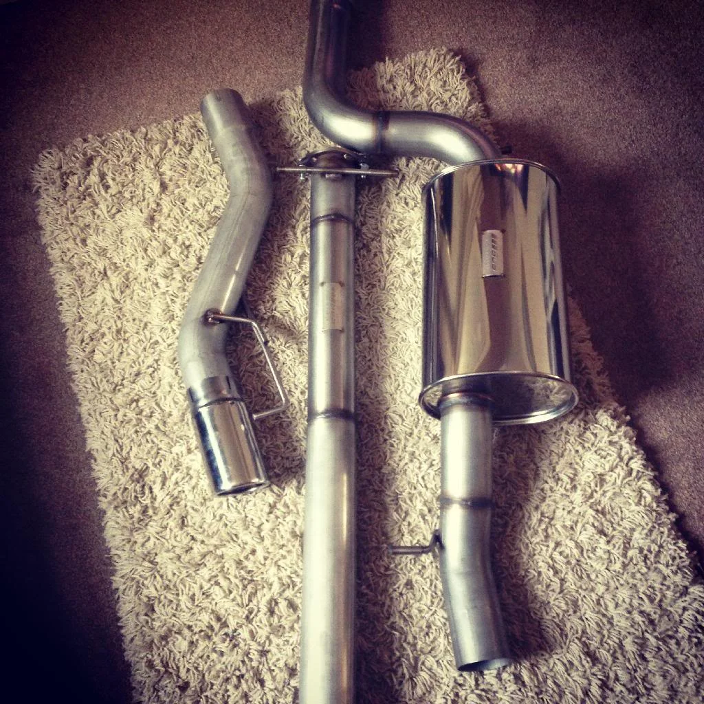

All went quiet for a while and i just enjoyed the car, but the itch for some mods took over and bought this BCS 3" single box system from the flexi back

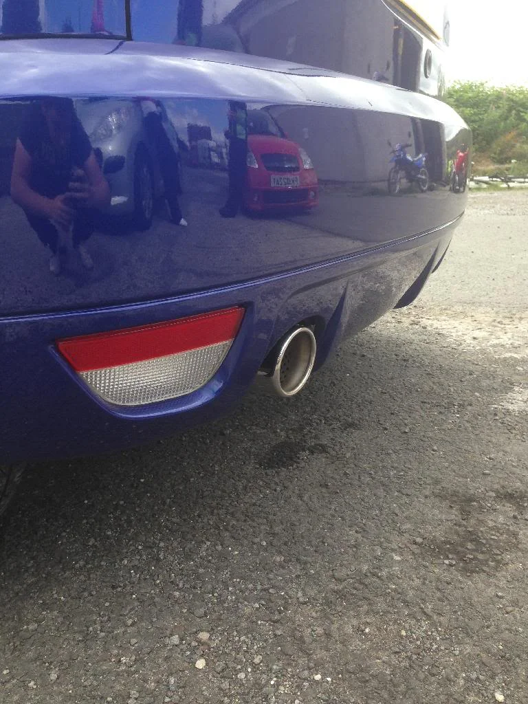

Didnt want anything OTT for a tailpipe so went with a 3.5" inward roll with a slash
fitted it

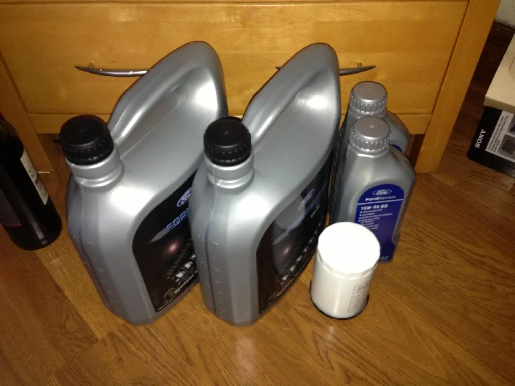

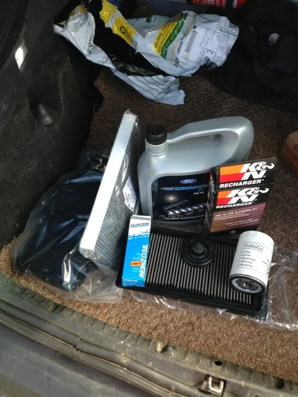

Gearbox oil, engine oil and filter change

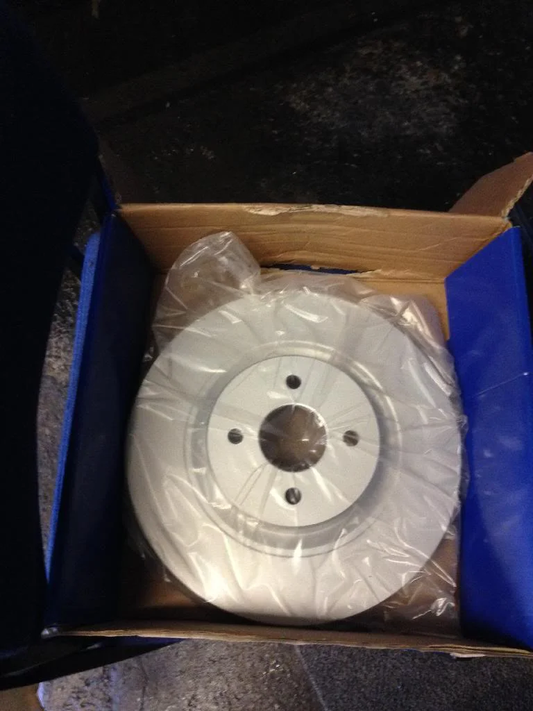

And some nice new discs for the front, already zinc coated so no need to paint these
