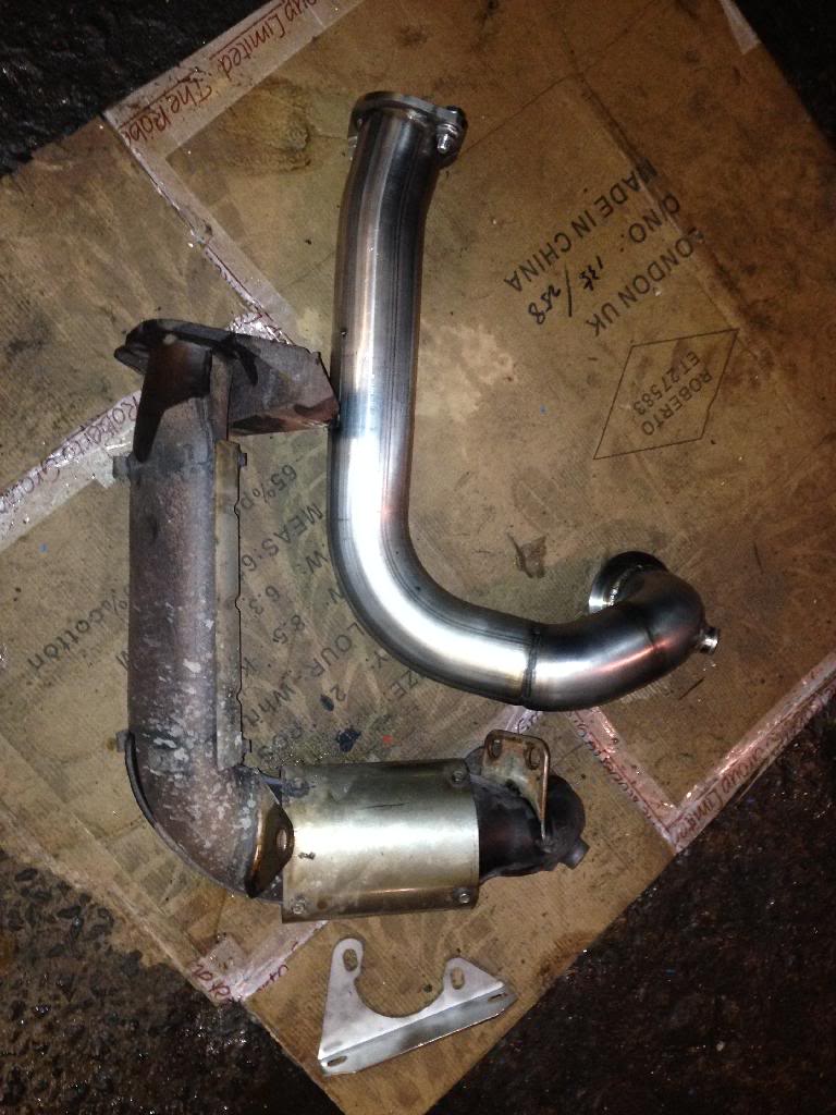

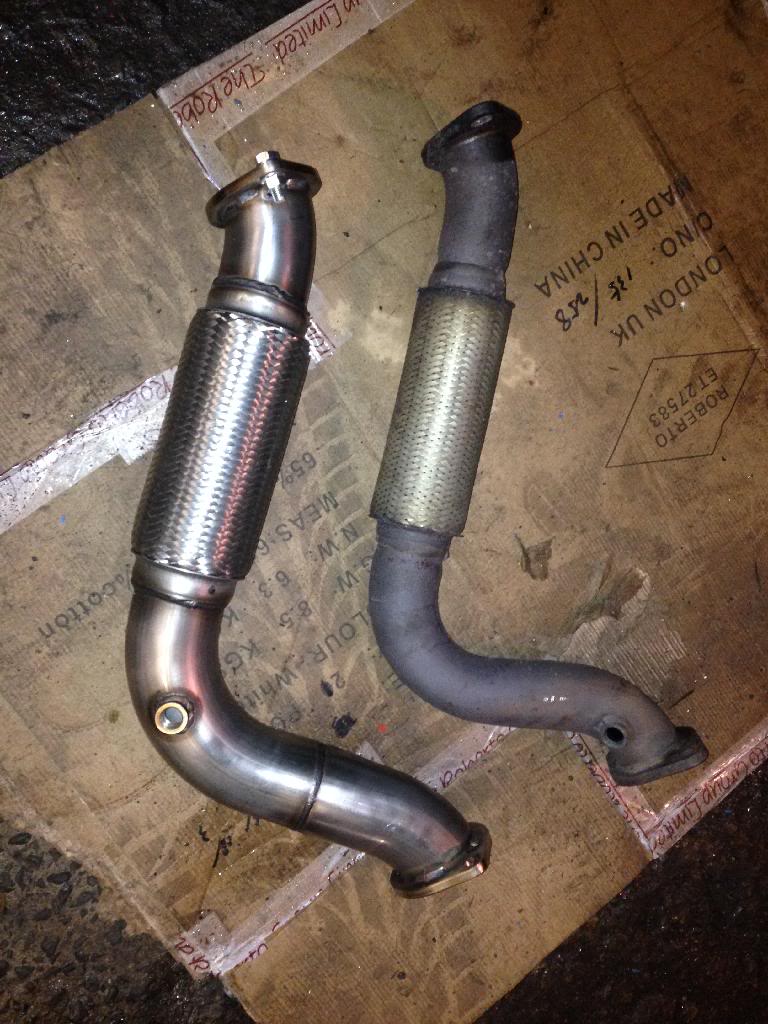

these turned up today, 3" BCS flexi and decat, hoping the gaskets will arrive tomorrow, may see if i can get it on before the rugby lol
well worth the wait

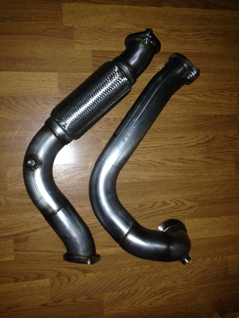

Bit of an update,

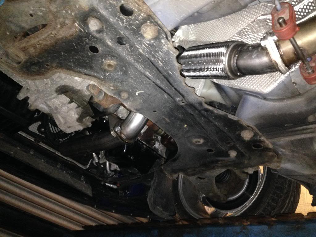

Had the flexi and downpipe on a while but havent updated.
a little comparision of old and new

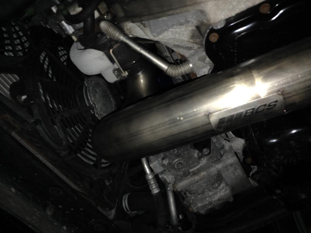

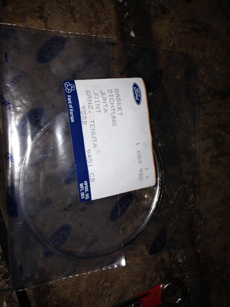

got it all on once, but as i rushed it i completely forgot about the O ring between turbo and downpipe lol
had to slacken the V band clamp off (again) bit of a pig but its in and no more blowing
£13 for an O ring! And thats with discount lol
all done :)
im trying to sort a video but it sounds great and spools up a lot quicker

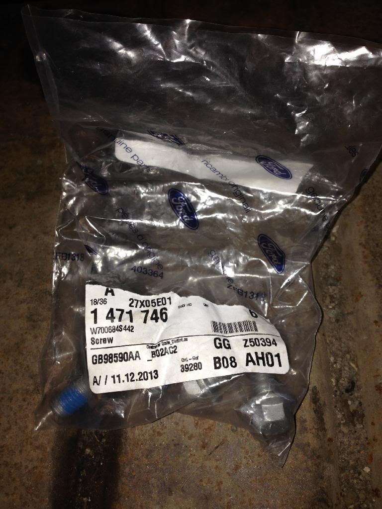

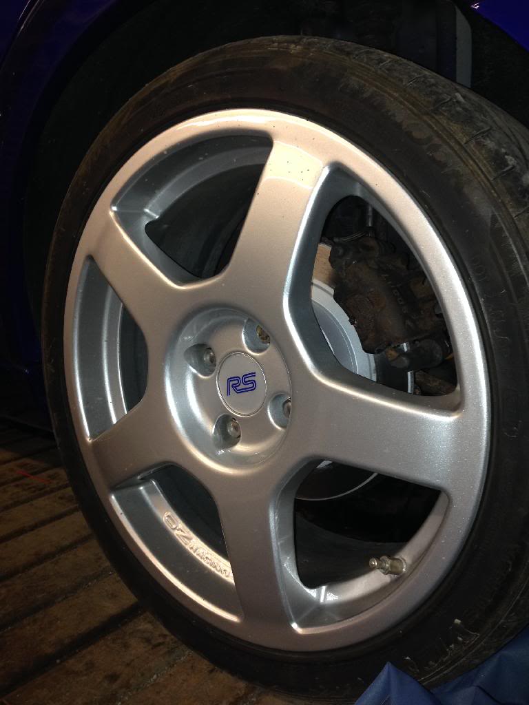

Some small updates, i finally got around to fitting the rear discs and pads after a trusty coating of VHT paint
But strangely the rear caliper bolts had seized in and started to round even though i had them out a few months prior.
Think it may have something to do with me trying to change the brakes with a hangover lol
New bolts from ford at under a quid each it wasnt worth the hassle, i was going to paint the calipers in silver too but thats a job for another day…

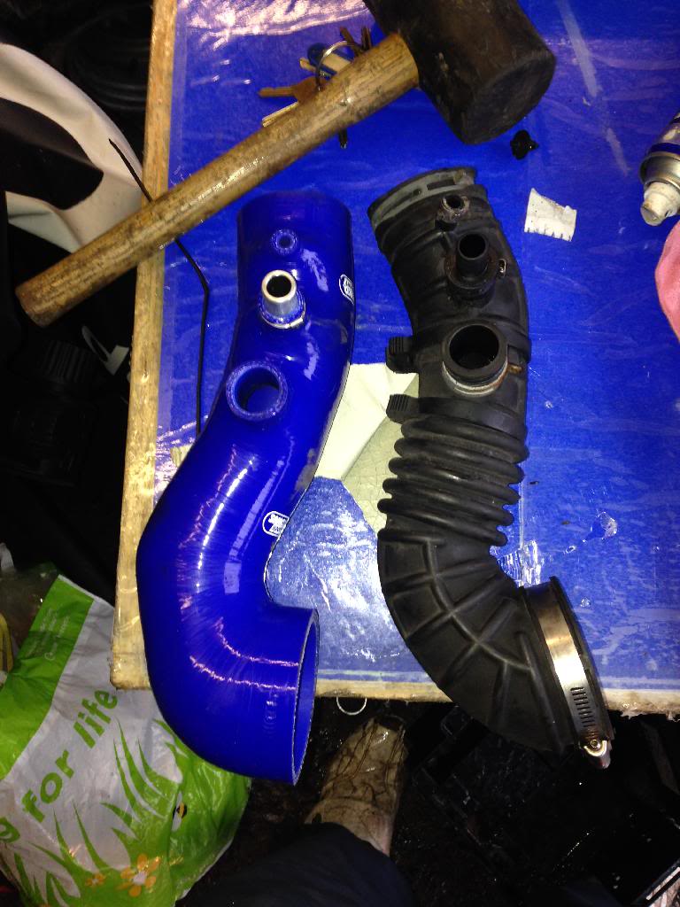

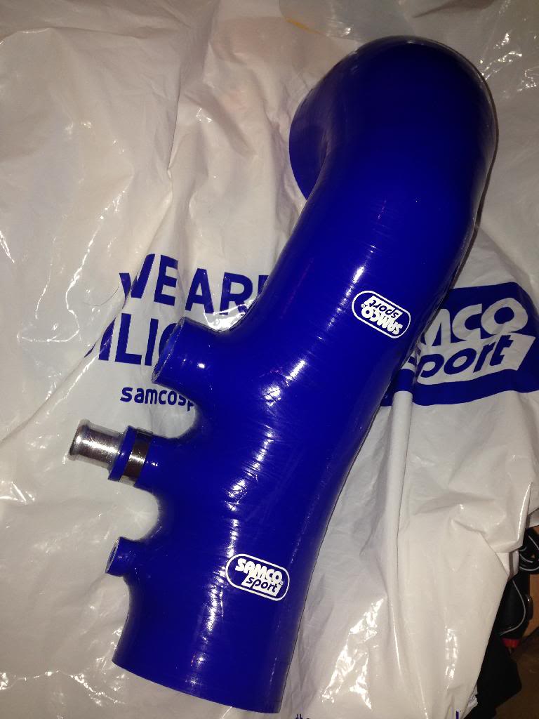

Then i stumbled across this badboy on ebay at 2am one night, pretty new release by samco and i wanted one but wasnt paying £110 for it!
Bought it there and then and its basically brand new and an even bigger result was that it was only in Merthyr so collected after work and saved a tenner off postage
As with the boost hoses, this hose is known to collapse under pressure and let out a squealing sound, the old was was still pretty sturdy but it'll alleviate issues in the future
quite awkward to fit but got there in the end, shame its not that visible

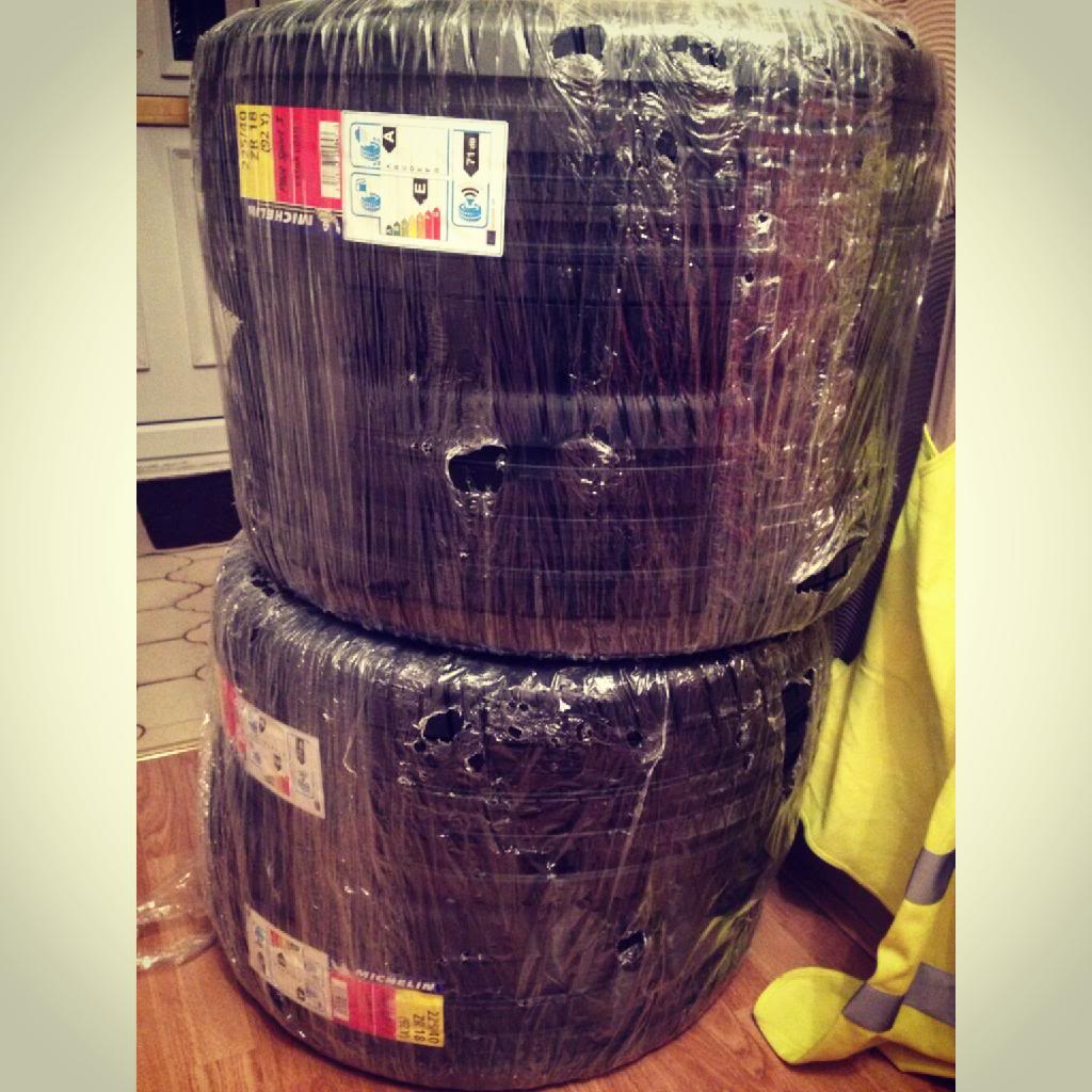

and then i had these delivered yesterday:
4x pilot sport 3s to replace the hankooks that the car came with
going to get them fitted tomorrow and get the car taxed on the 1st ready for its first outing and the welsh black mountains run on the 6th :)

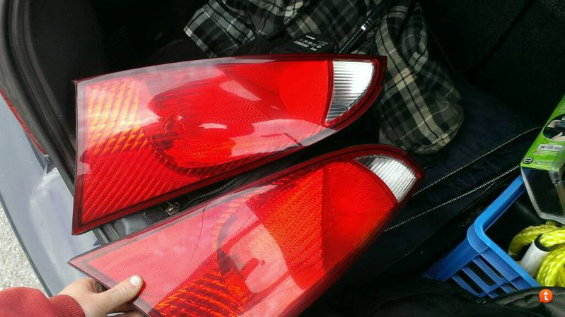

i went to canada in june, and really fancied a set of US spec rear lights but didnt want to pay the £150 odd premium they fetch over here, long story short, got in touch with a guy out there that wanted some uk spec focus saloon lights, so i bought some, took them out in my suitcase, met up with him and swapped lights and brought home a set lol
heres the pic he sent me before i left for my flight
got home and fitted them :)
really happy with the look,

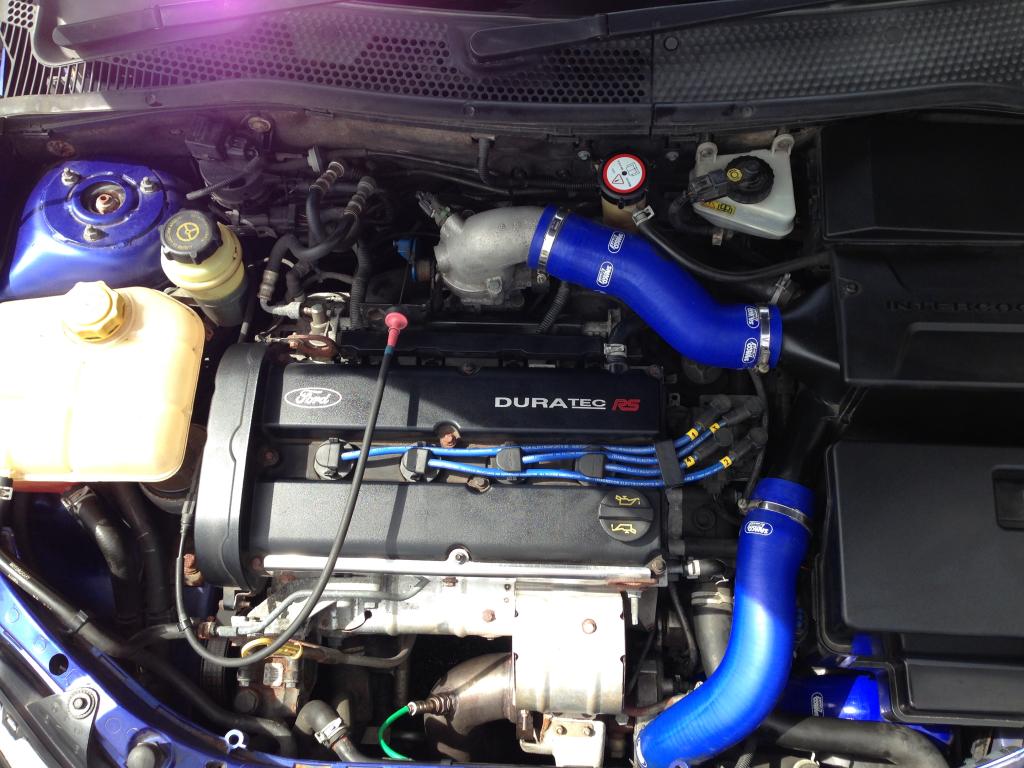

and the only other thing is that i bought a set of magnecor leads, no gains other than the fact they are blue and thats what i wanted lol

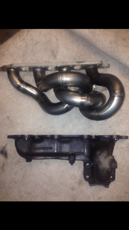

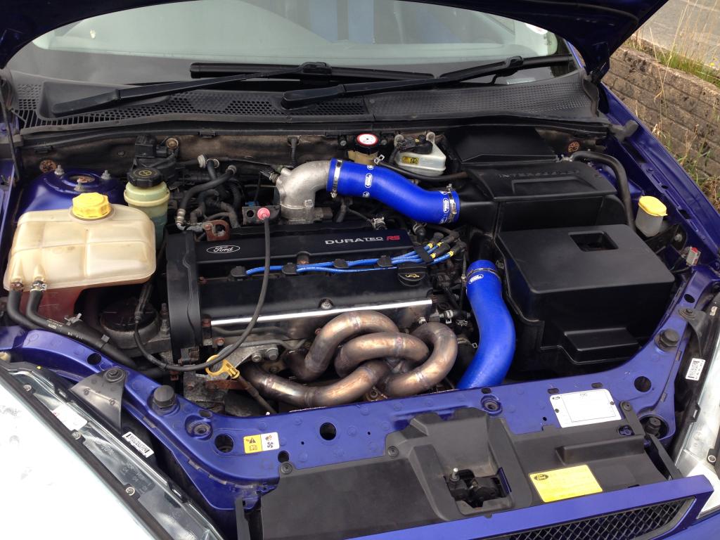

I also went and bought a tubular manifold, made a great difference to spooling etc,
Quick comparison of std vs tubular
And fitted :smile:

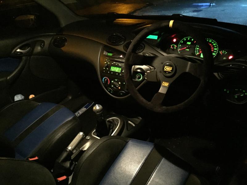

Us at the PFC Expo they were selling cheap OMP wheels so on a whim, i bought this OMP WRC steering wheel, makes a difference to the feel of the car, plus is preserves the standard wheel which fetches good money in great nick which this this is

First of all ive reverted back to the standard HT leads, lot of people have issues with the magnecors but mine were fine untill i added the manifold, on fast gear changes it would sound like a shotgun going off, i was loving it until it eventually got worse and became obvious it was a misfire 😧
Swapped back to standards and job done

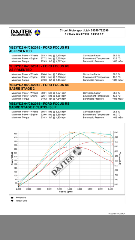

With all the mods it was time for a map to tie it all together but as the cars getting on a bit i thought i best upgrade the bits that are prone to failing after 12 years,

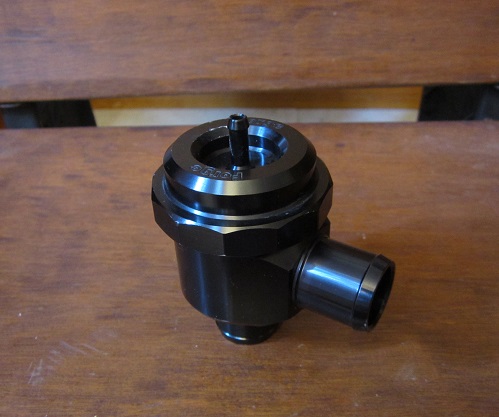

First up the standard recirc valve was swapped for a forge 007p, the standards begin to fail and not hold higher boost so needed to be done for mapping,
Went for a black one as it looked more OEM than a chrome one,

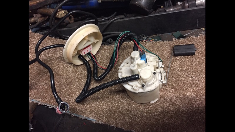

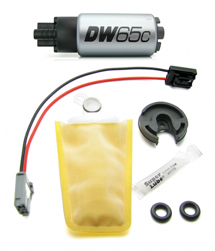

Next was the fuel pump, hadnt had any of the common issues with poor starting etc, and the standard one can flow enough for the power i was expected to acheive, but again its getting on a bit, and best to swap it out now instead of waiting for standard one to pack in
Choice off the forum was the deatschwerks fuel pump, pretty much drops straight in, bar trimming a small piece of rubber and wiring it to the loom on the pump
So took the car for a drive to burn off whatver fuel was in the tank and get it low as possoble i set about dropping the tank,
After getting fuel in my eye, and inhaling a load of v power fumes (felt like setting fire to the thing at this point) the standard pump was out
No pictures of the after, but it was all basically done on the morning before i went to france on a trip as i ran out of time and i wanted the pump in for mapping.
I then took the car to Sabre tuning in Bristol the day after i came back from france, and the standard wastegate actuator on the turbo fails, the diaphram can split and cause a lack of boost and cant hold higher pressure, so i had the guys at sabre fit an uprated garret actuator so at this point everything should hold up.
Had a phonecall later in the day off leighton when he was on his way to pick me up, good news, car is mapped and making good power
Bad news, clutch is slipping badly and will need replacing, i was bloody gutted seeing as i was taking the car to the ring the month after, and i didnt have £800 spare for a new clutch to be fitted in time that Sabre quoted,
Anyway the car made just shy of 330bhp
Figures are with a pinch of salt as i hate dyno talk, but it goes very well and its fuelling right, job done

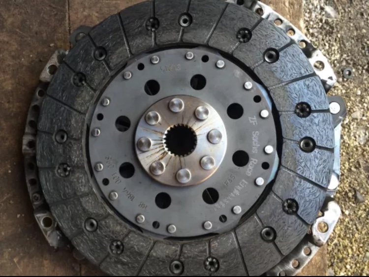

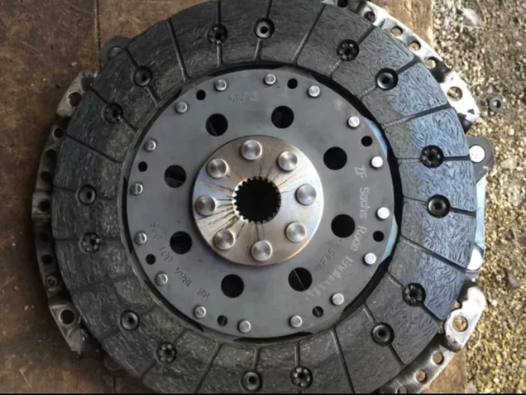

So drove home disheartened thinking what im going to do, i didnt really want to slap £1000 on a credit card for a clutch but it would have been my last resort
waited a few days and a used sachs clutch popped up on the RS forum for sale, just 5k miles use and was only £200
Ideal, the plan was to get this fitted, have it tie me over for the ring and fit a new one in time,

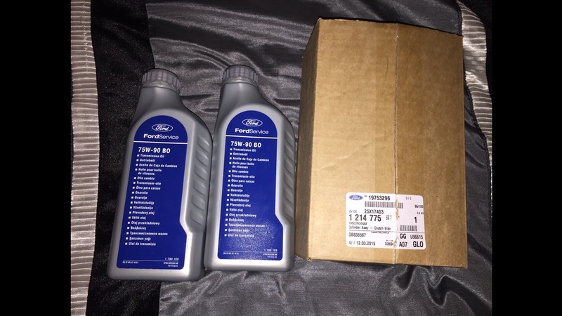

So another round of fresh box oil and a genuine release bearing whilst box was out
Phonecall from the garage doing the clutch swap, cars all done and back together, but the clutch is still slipping
I felt sick, theres people slamming a lot higher torque than i was through theirs with same clutch, but i picked the car up and after driving it a few miles it stopped slipping and 'touch wood' has been fine since

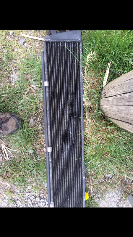

Found it!
The core had split in the chargecooler box, quite common, leaking coolant into the inlet :(
Caught this just in time, a new chargecooler box from ford is £3500, and theres only one in the country and theyre now NLA. found a new one on ebay for £400 but id rather spend that sort of coin on a proper FMIC,

Looks brilliant! Quick note; the 007P leaks more than the standard item. Lots of info on the Audi forums about them not passing bubble tests - worth checking you're not losing boost now.
