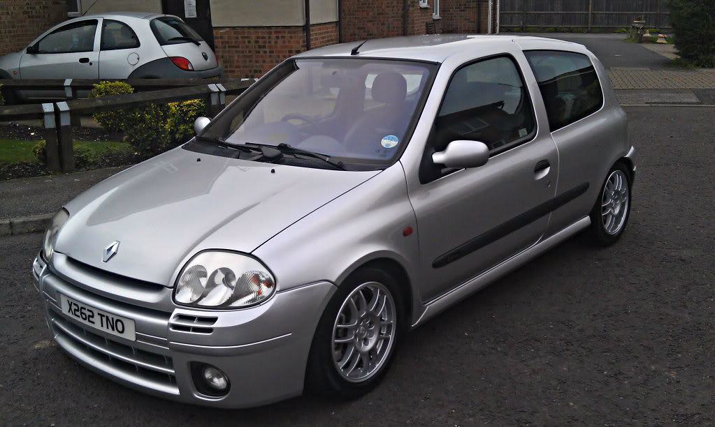

I have this as well which ive owned for 3 years, i love it and it ticks many boxes but i also love working and building the Fiesta to the spec that i want so im going to keep it and crack on!!
