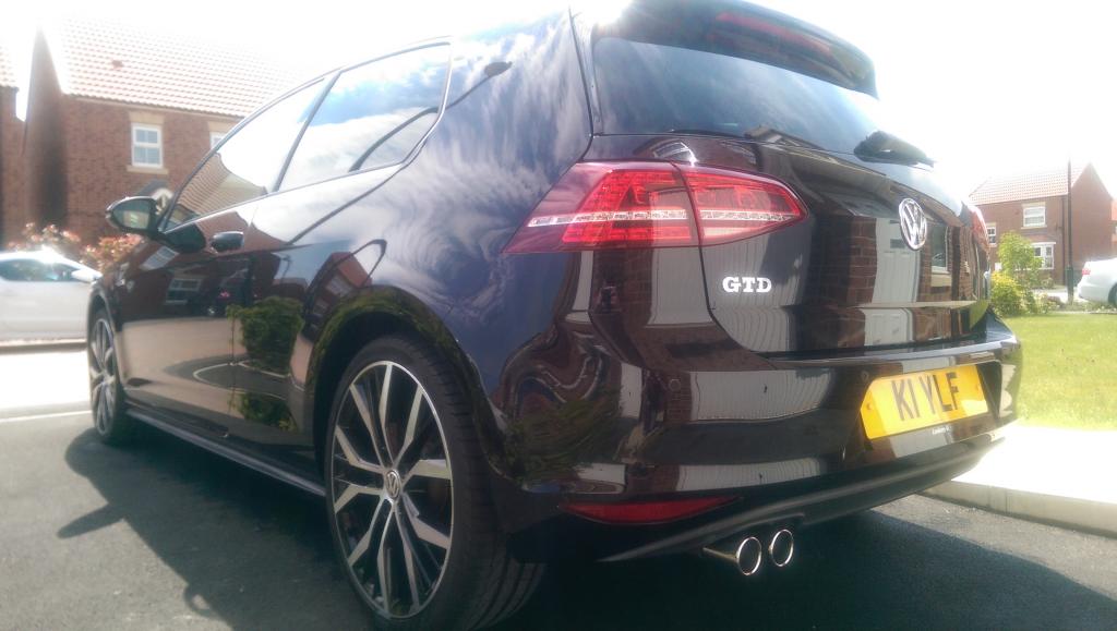

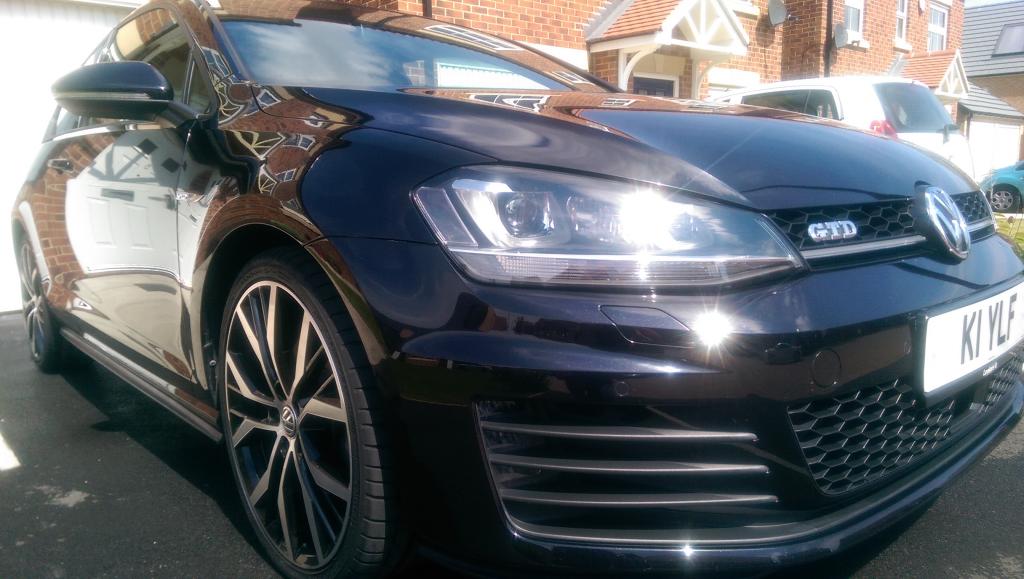

Long time reader of this section but only recently got into detailing. Need to invest in some Tyre shine, is Megs Endurance the go to?
Comments are appreciated my methods are as follows:
Valet Pro PH Neutral Snow Foam
Rinse off
Wash car with AG Shampoo Conditioner
Rinse
Clay car with Farecla Clay Mitt (Really impressed with this)
Dry with Microfire towels
Polish with AG Super Resin Polish
Wax with Fusso Soft Coat Dark (Used to use AG HD Wax but my car was literally covered in dust within an hour)
The results (HTC M8 is to blame for the poor photos!)
