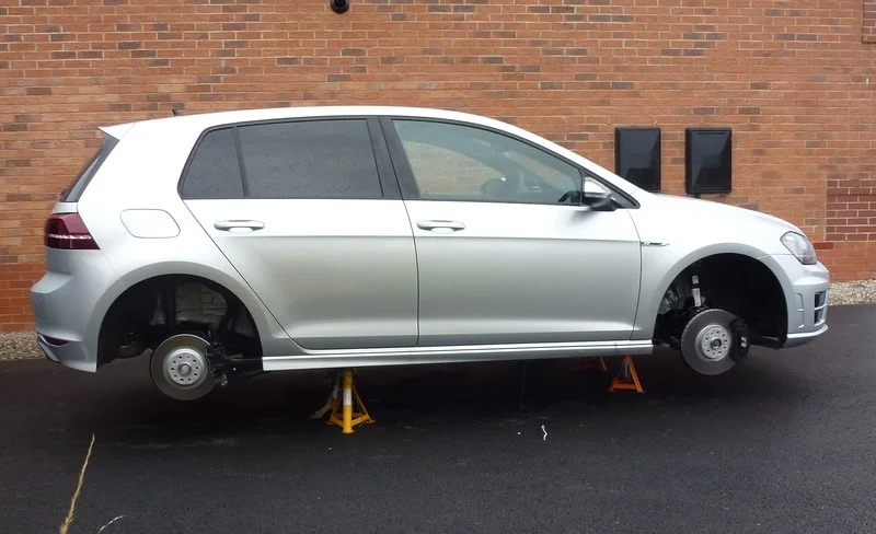

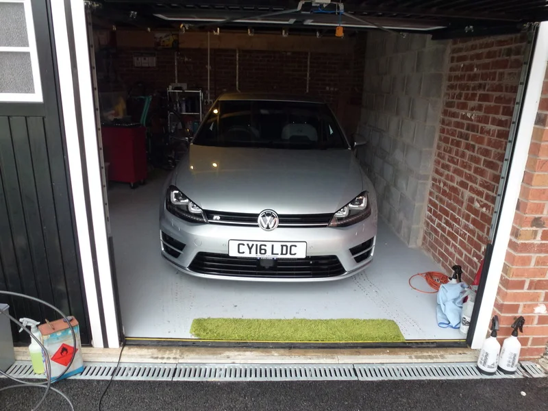

Right then. 2 Weeks after picking it up I'm ready to give the new Golf a thourough detail.
No editing or arty pics here I'm afraid, just an old point and shoot camera!
Here it is:

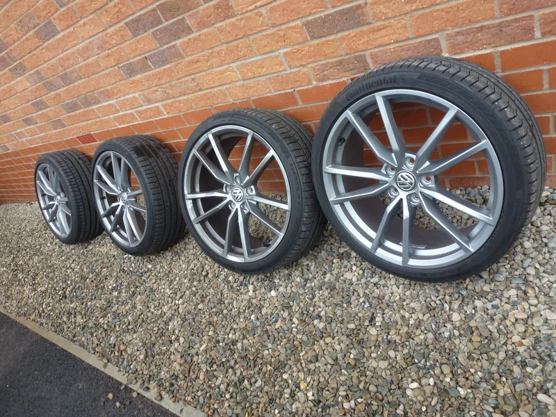

First job, wheels.

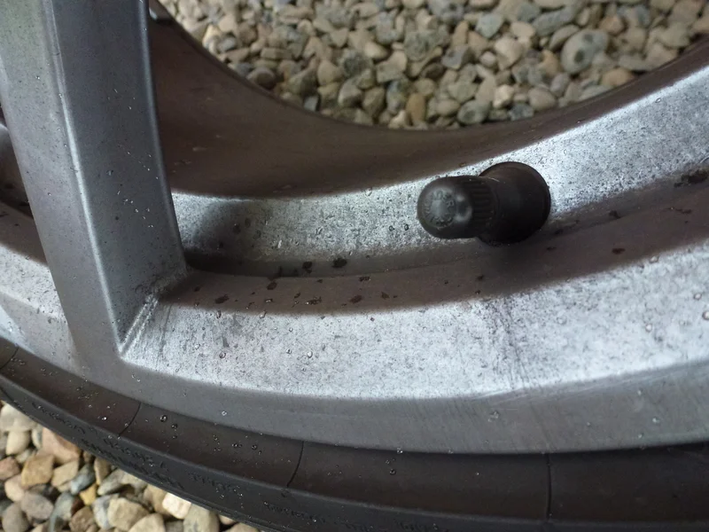

Generally mucky, Golf R front brakes are VERY dusty!

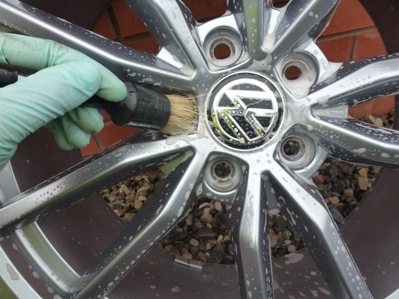

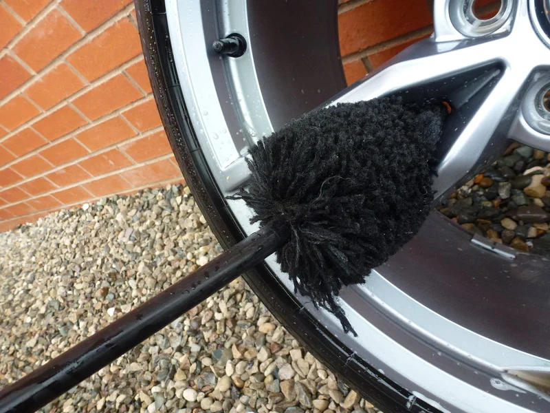

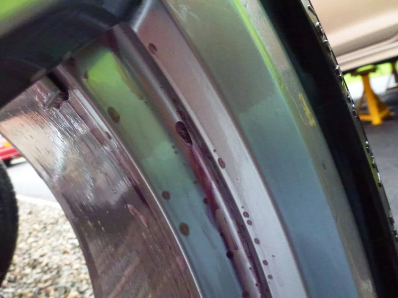

Wheels were jetwashed, soaked in 1:10 solution of AF Imperial, and agitated with a range of brushes. Despite the wheels being off the car, the EZ brush was necessary to reach the groove that sits behind the spokes.
Rinsed off

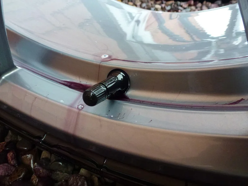

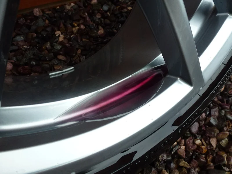

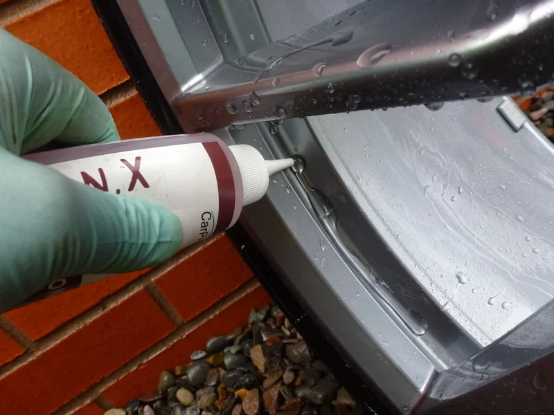

Doused in CarPro Iron-X
Not too bad, but stubborn areas were then treated with Iron-X paste to remove any remaining contamination.
Wheels were given a second hit to make sure it was all removed, then jet washed off.

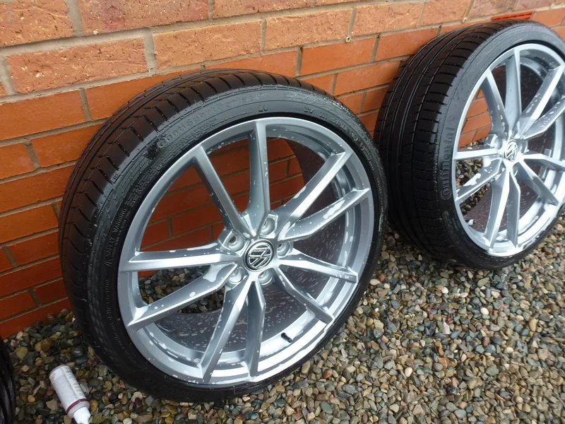

Then, the wheels were given a final wash in a fairly strong 1:3 G101 solution
Rinsed off, blow dried and brought inside to dry/warm up.

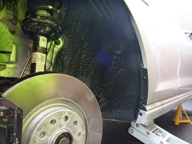

Arches scrubbed with APC and rinsed, then Tardis and rinsed

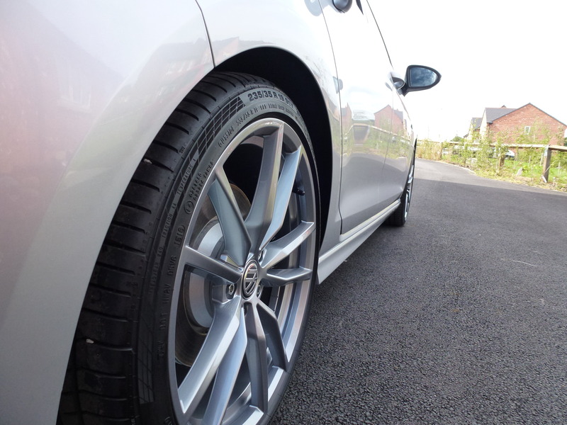

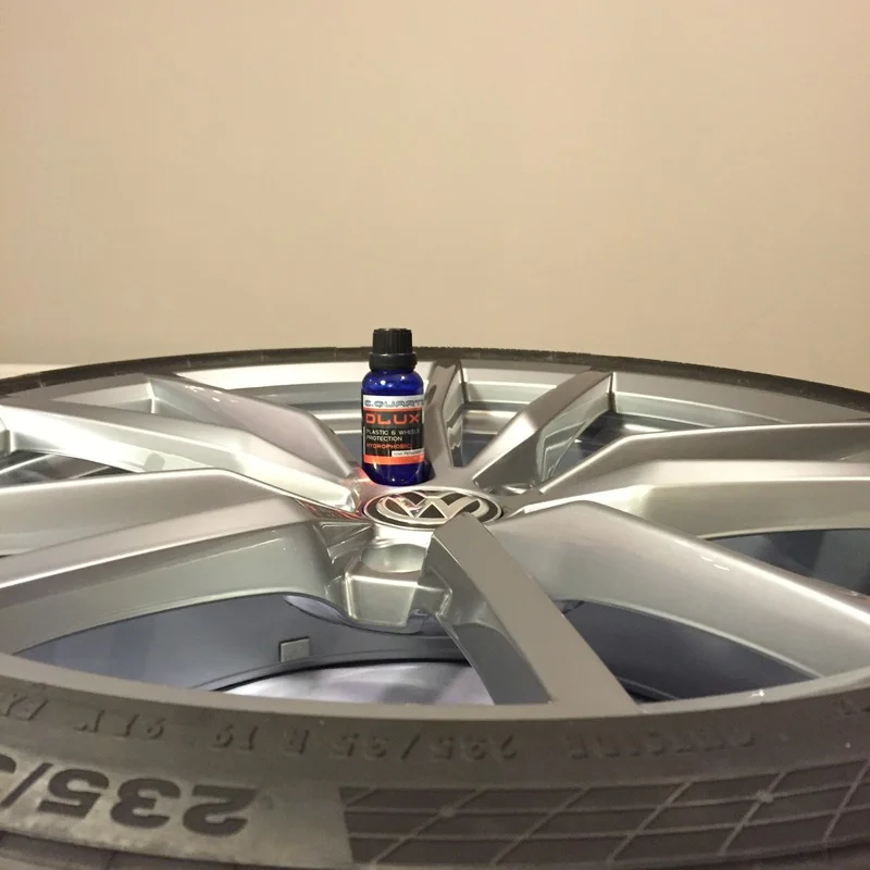

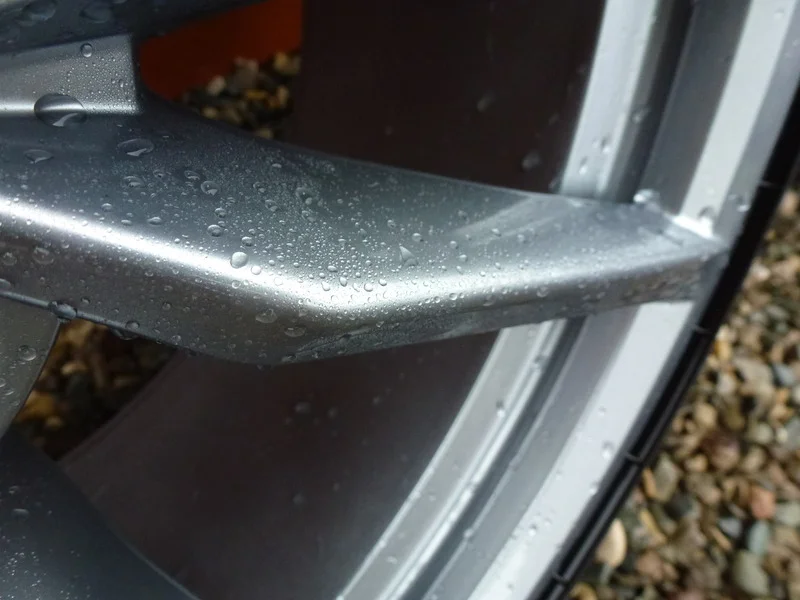

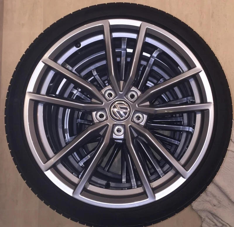

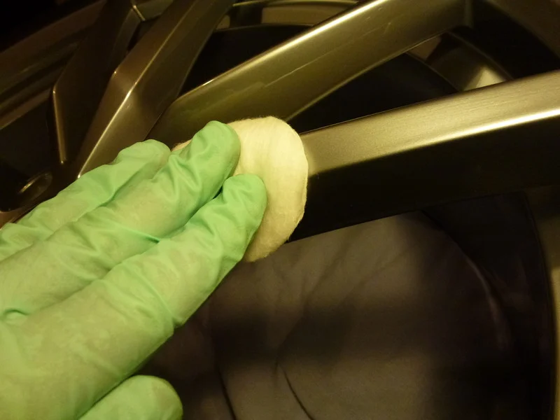

Wheels given 2 wipedowns with straight IPA, now time to apply Cquartz DLUX
Inner barrells applied with the applicator and spokes with a make up pad
Wheels given 2 coats and left indoor over night to fully cure.

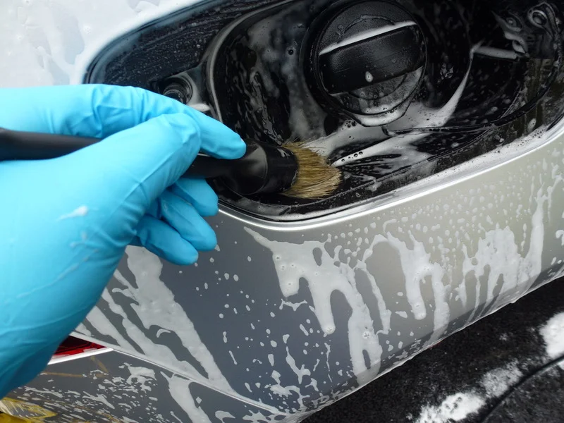

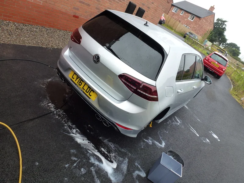

Snowfoam with VeltPro Combo 2 snow foam laced with a bit of G101

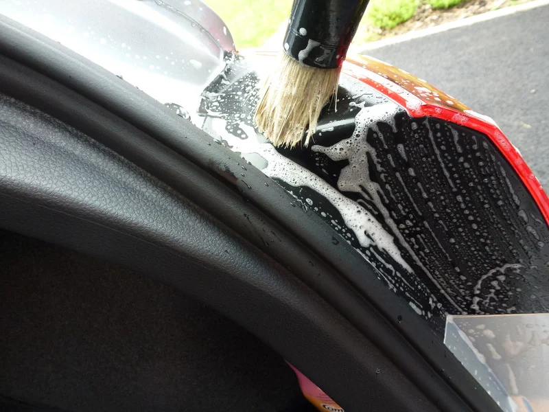

Shuts abd trim cleaned with brushes and a little extra APC
Jetted off, then washed with Dodo Juice BTBM and CarPro Merino lambs wool mitt. (2 bucket method & grit guard)

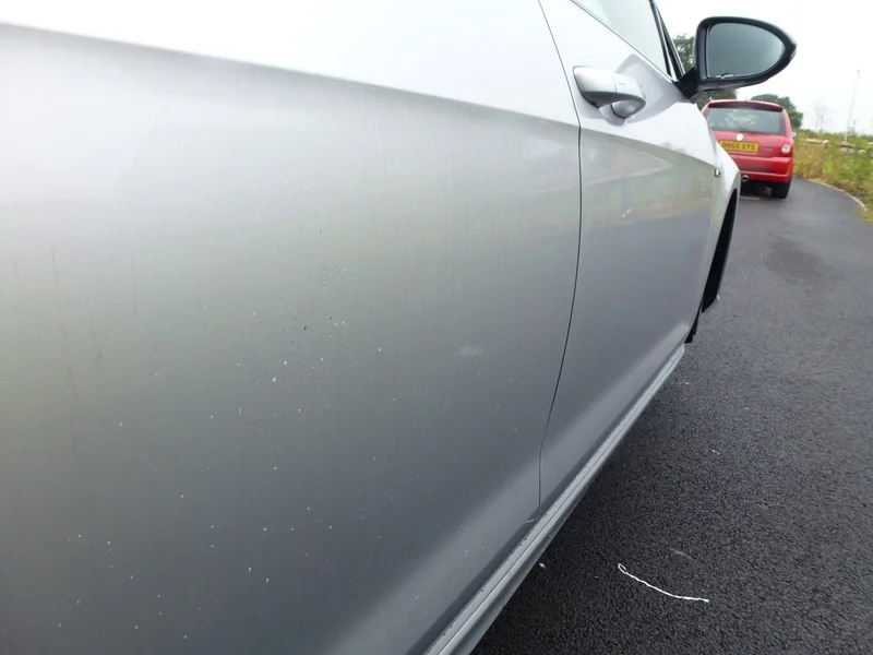

Next decontamination. It probably doesnt show in the pics but it was very lightly raining all day, like a fine mist. This meant that IX etc were getting diluted, but it also meant I could up the dwell time.
Heavily doused in Iron-x
I was expecting worse tbh.
Process was then repeated for Taris, followed by another snowfoam wash, another BTBM wash, and Pat dried with a big yellow fluffy towell.

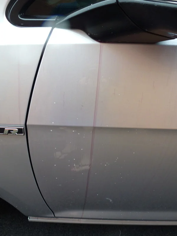

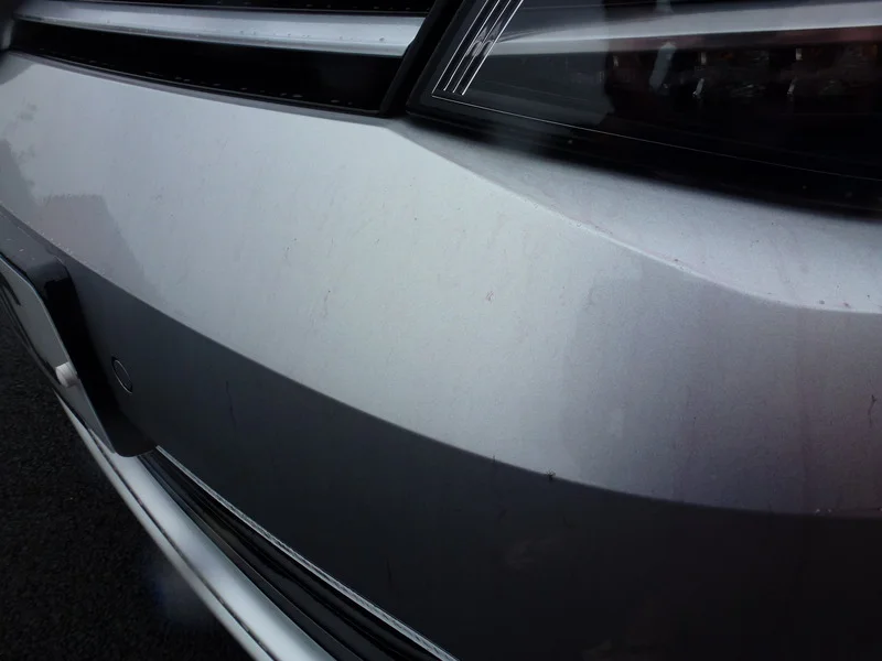

After close inspection I decided that clay wouldn't be necessary on this occasion.
Wheels back on and rolled inside for polishing

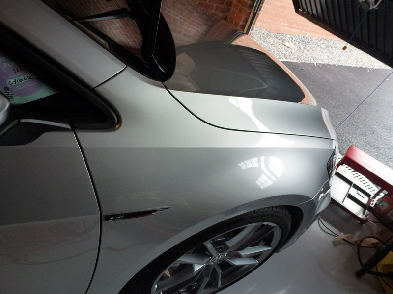

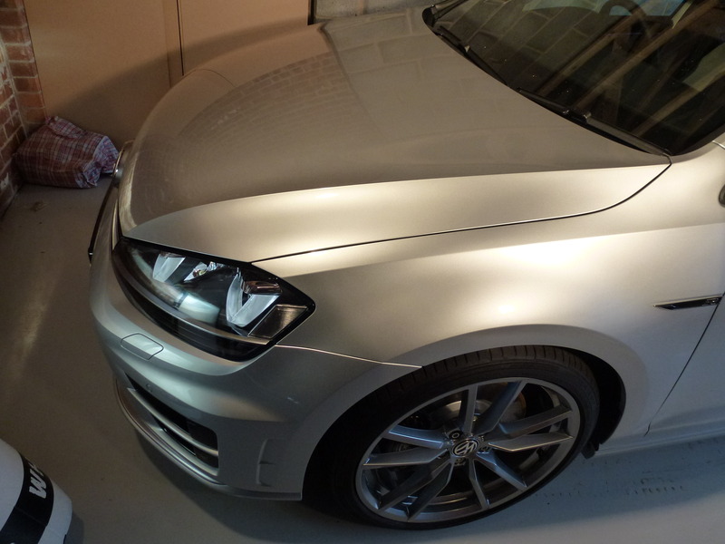

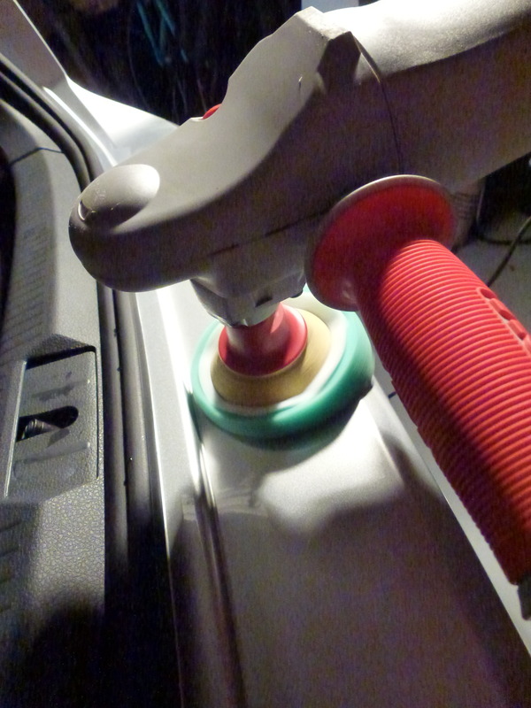

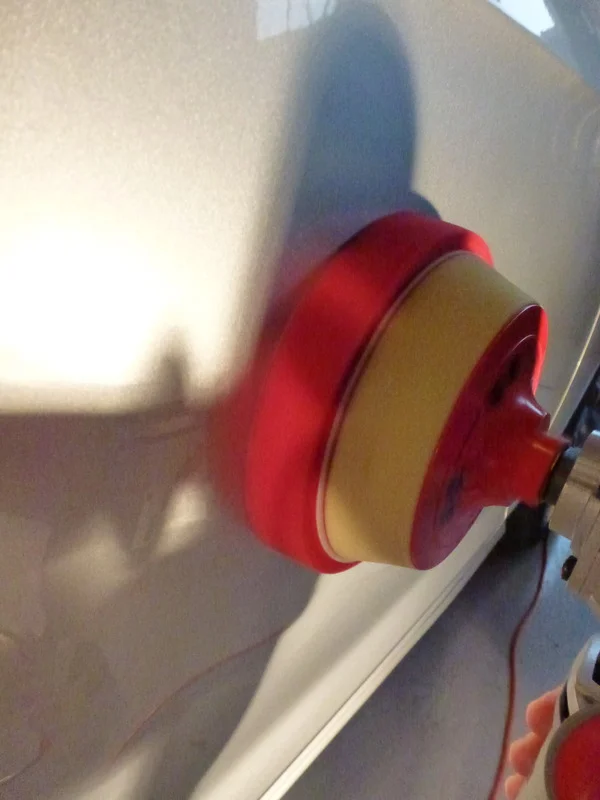

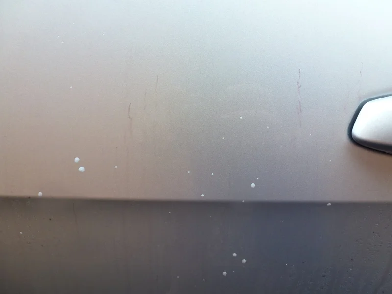

Polished with CarPro Essence via 3M rotary and Hexlogic pads

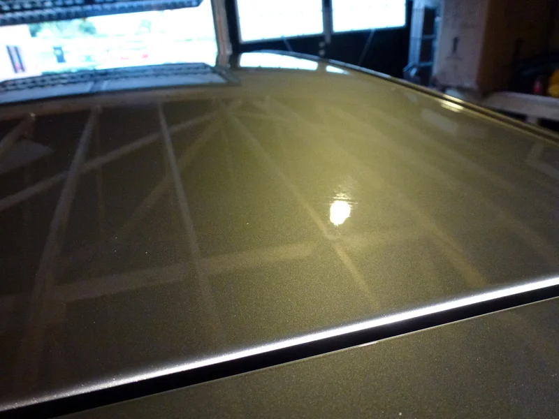

There was a bit of a 'stain' on the roof that needed some more intensive polishing but I pretty much got there in the end

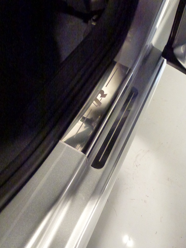

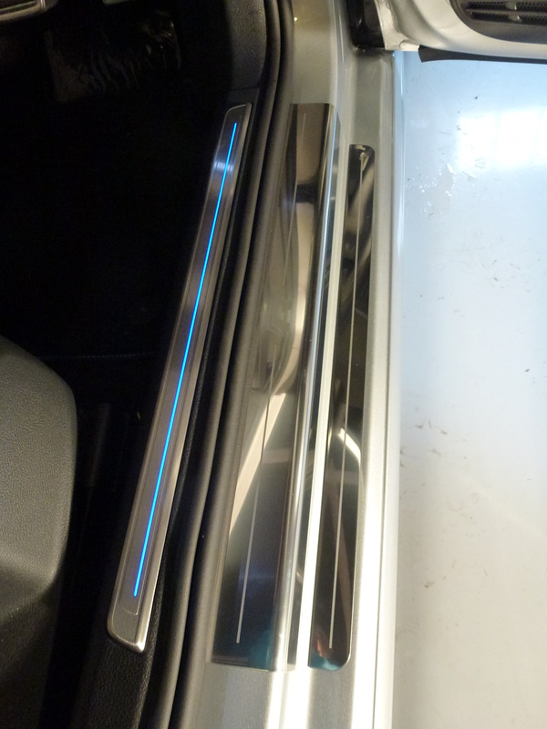

New sill protector plates coated in DLUX
And fitted onto polished sills
Very pleased how OEM they look!

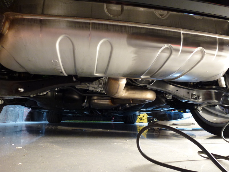

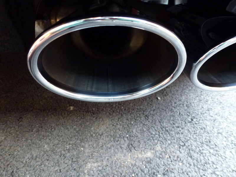

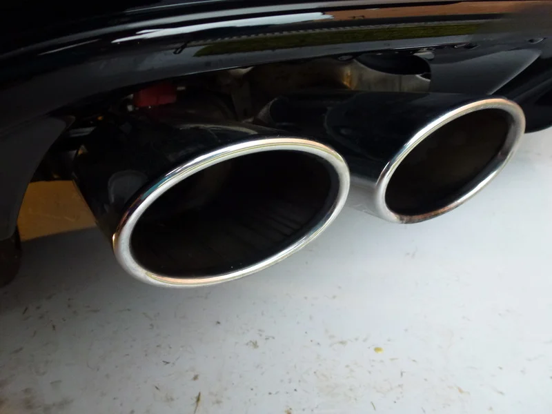

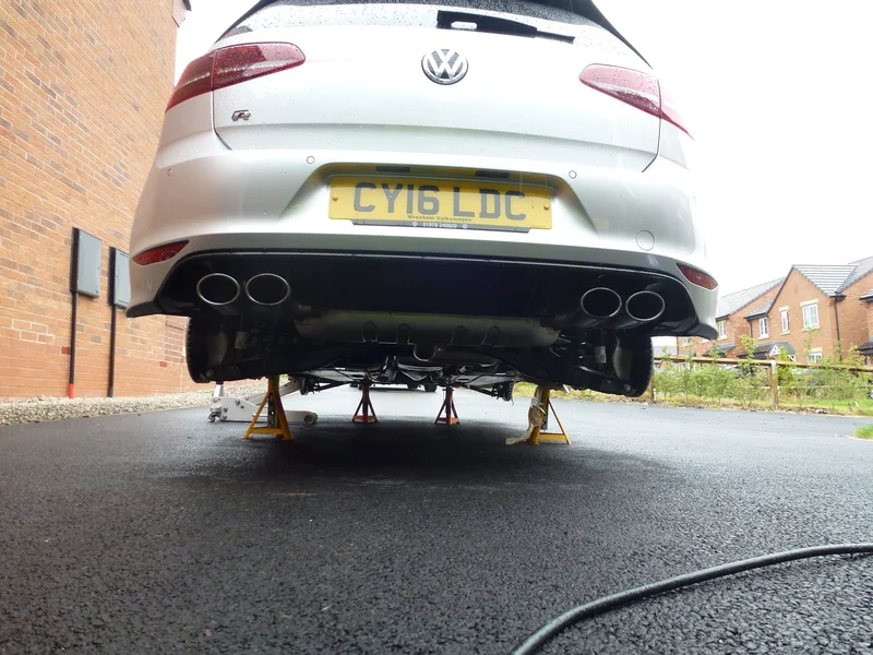

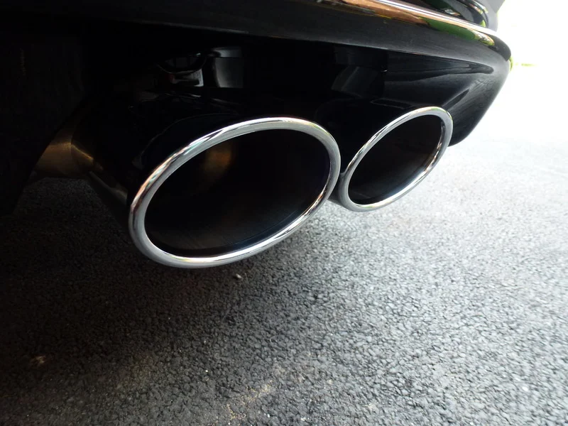

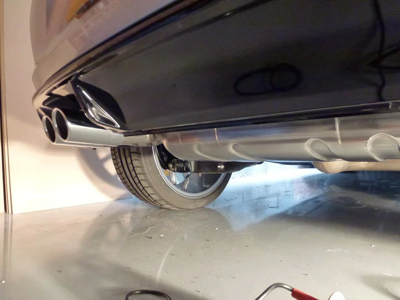

Exhausts polished with a foam drill bit cone and Autosol. Clean vs dirty
Backbox polished up a little
The Clean tips wiped down with IPA and coated with DLUX

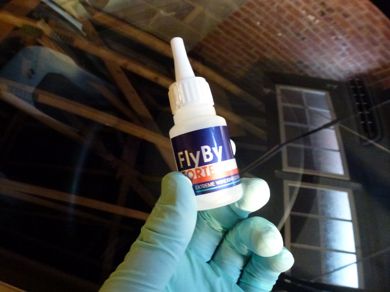

Gloss plastics on the front bumper were coated with FlyBy Forte. This was my first time with Forte and I muched preferred the application to GTechniq G1.

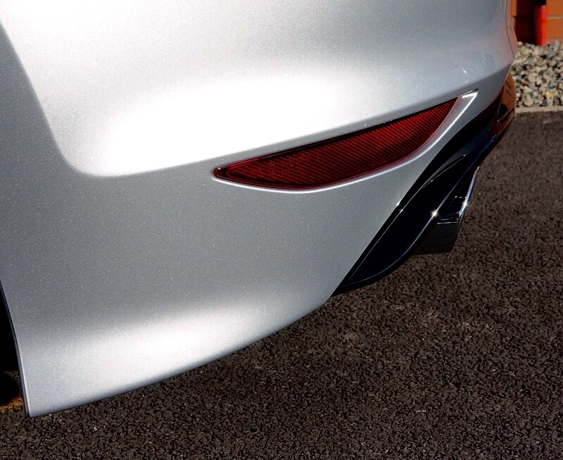

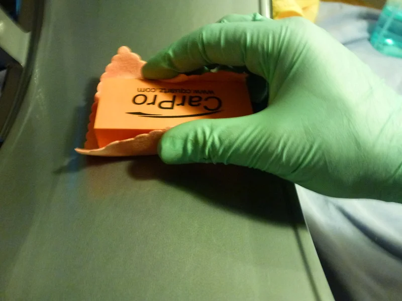

Time for CQUK.
Applicator prepped

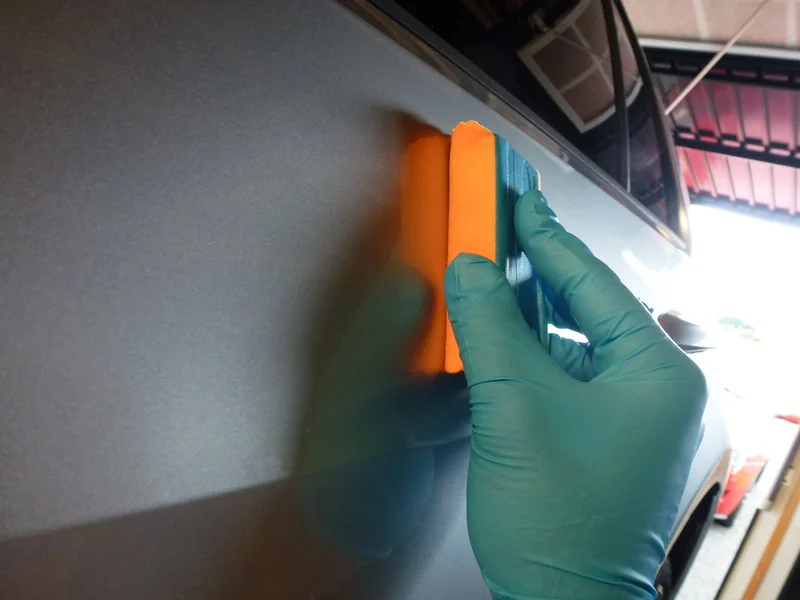

Applied in sections and residue removed with the supplied suede towell and a second buf with a short pile MF.

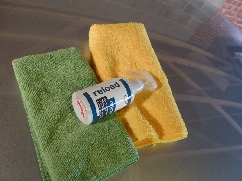

Left overnight to cure, now to be topped with Reload
6 or 7 (I can't remember) layers in total

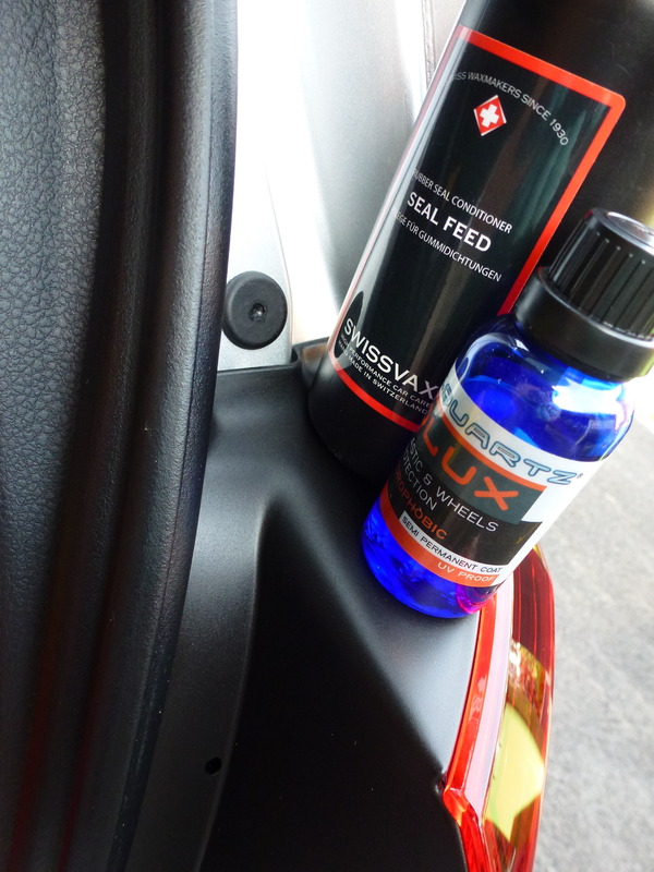

Trim dressed in Dlux, seals dressed in SV Seal Feed

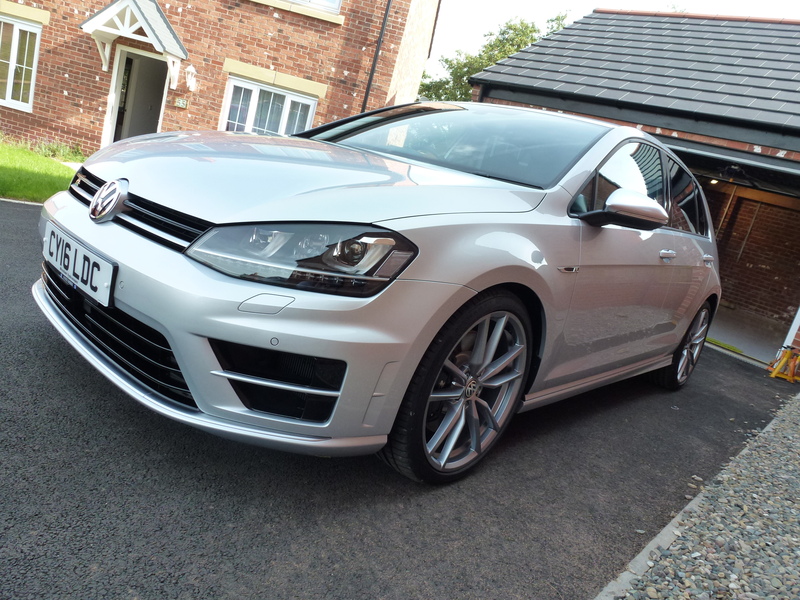

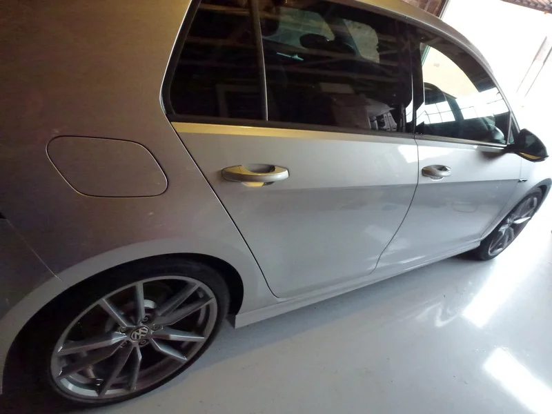

Rolled outside for inspection

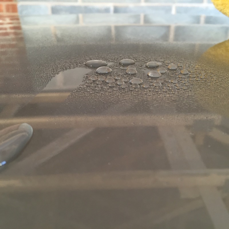

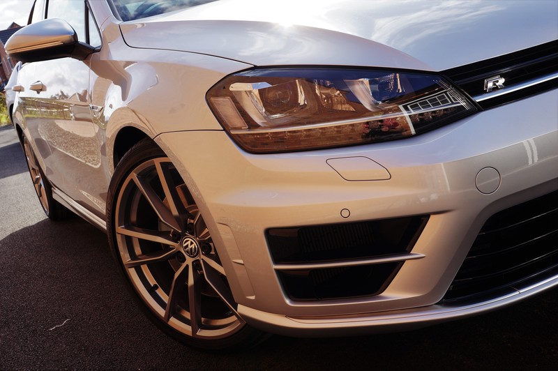

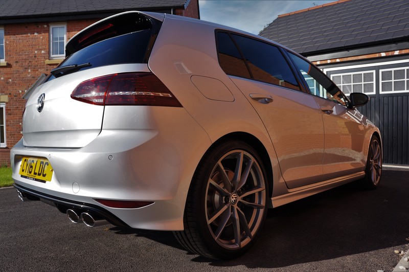

Obligatory beading shots
[/URL]

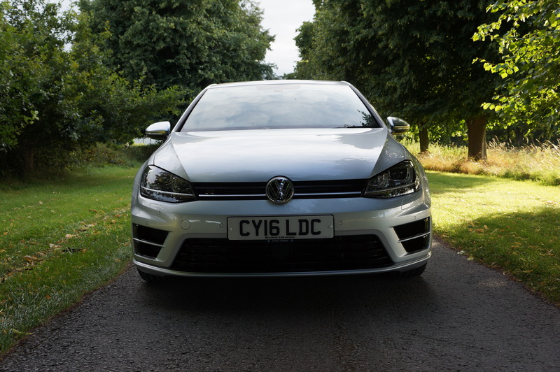

I'm still waiting for some decent weather / light to get some proper 'after' shots. It's been so dreary his week!
