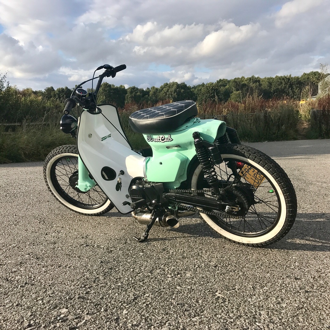

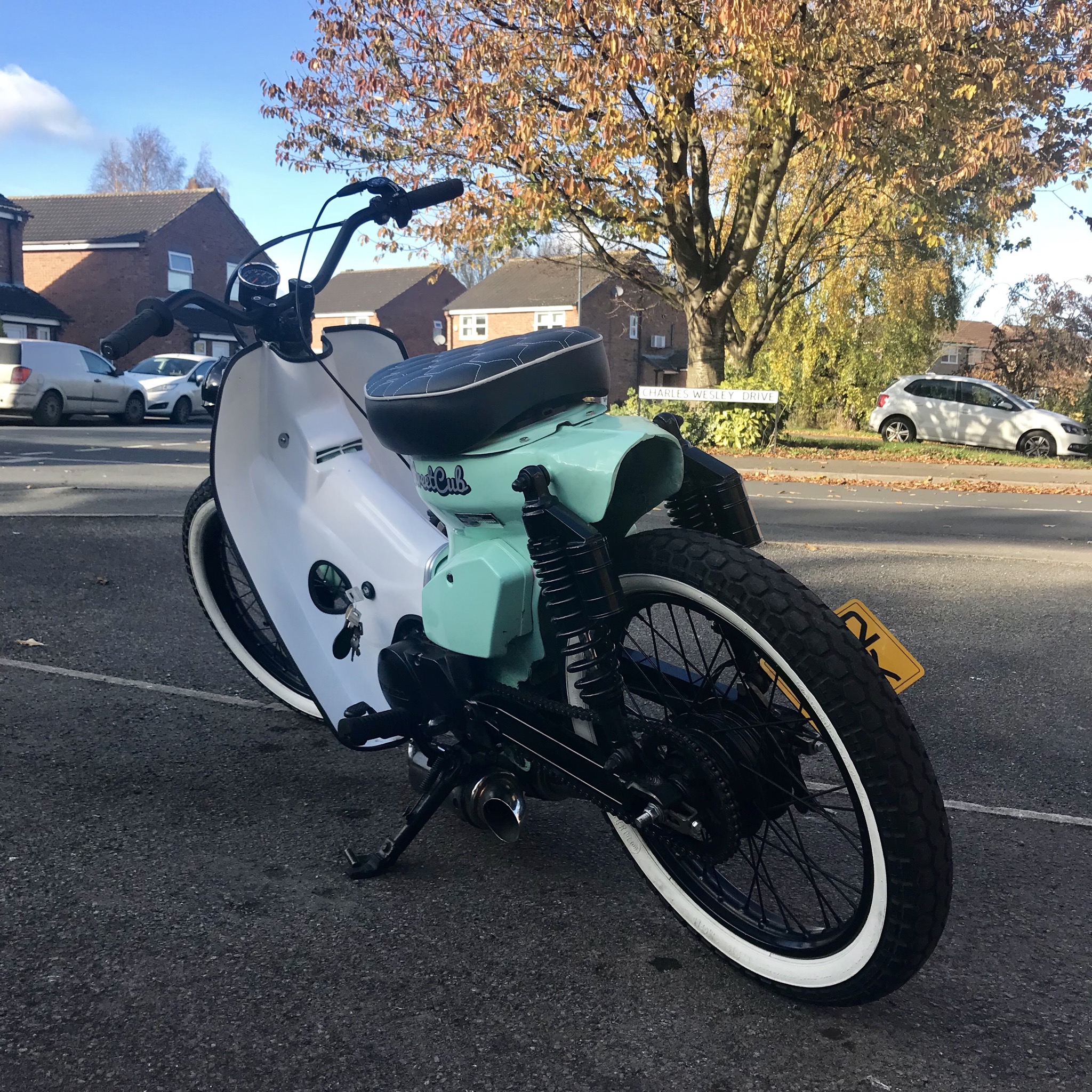

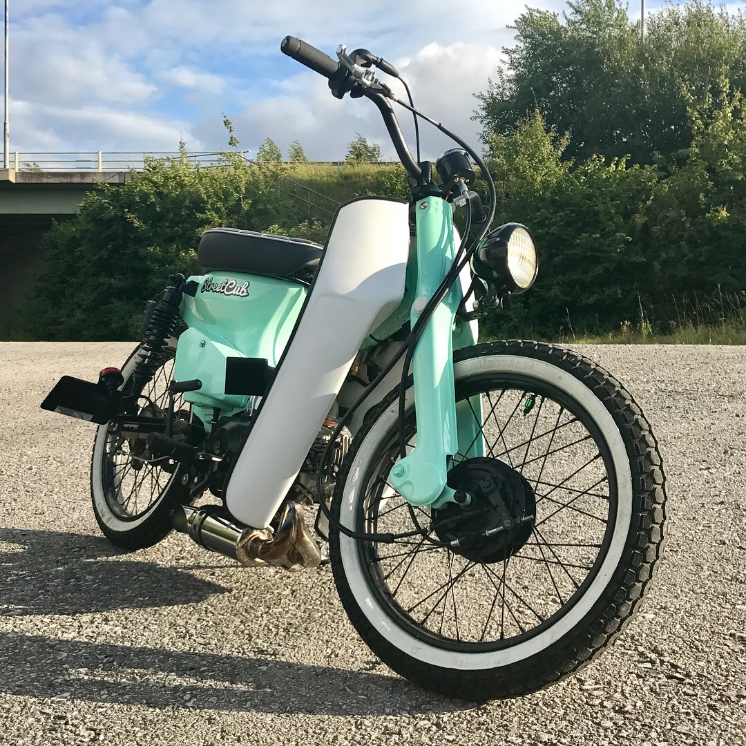

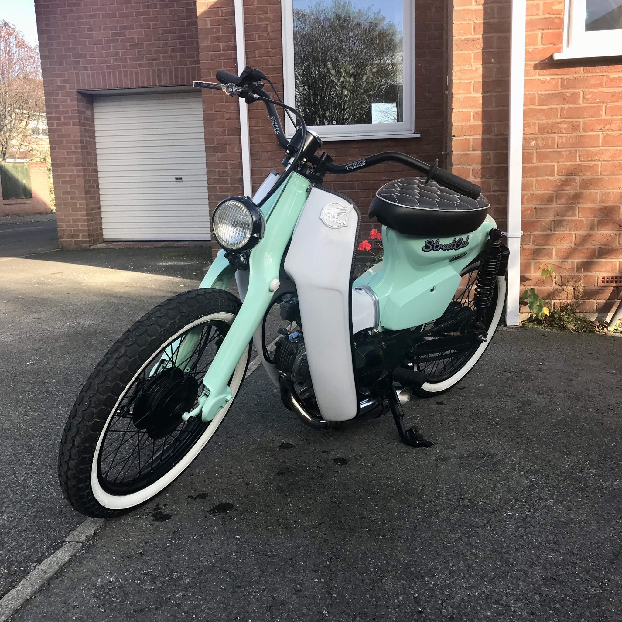

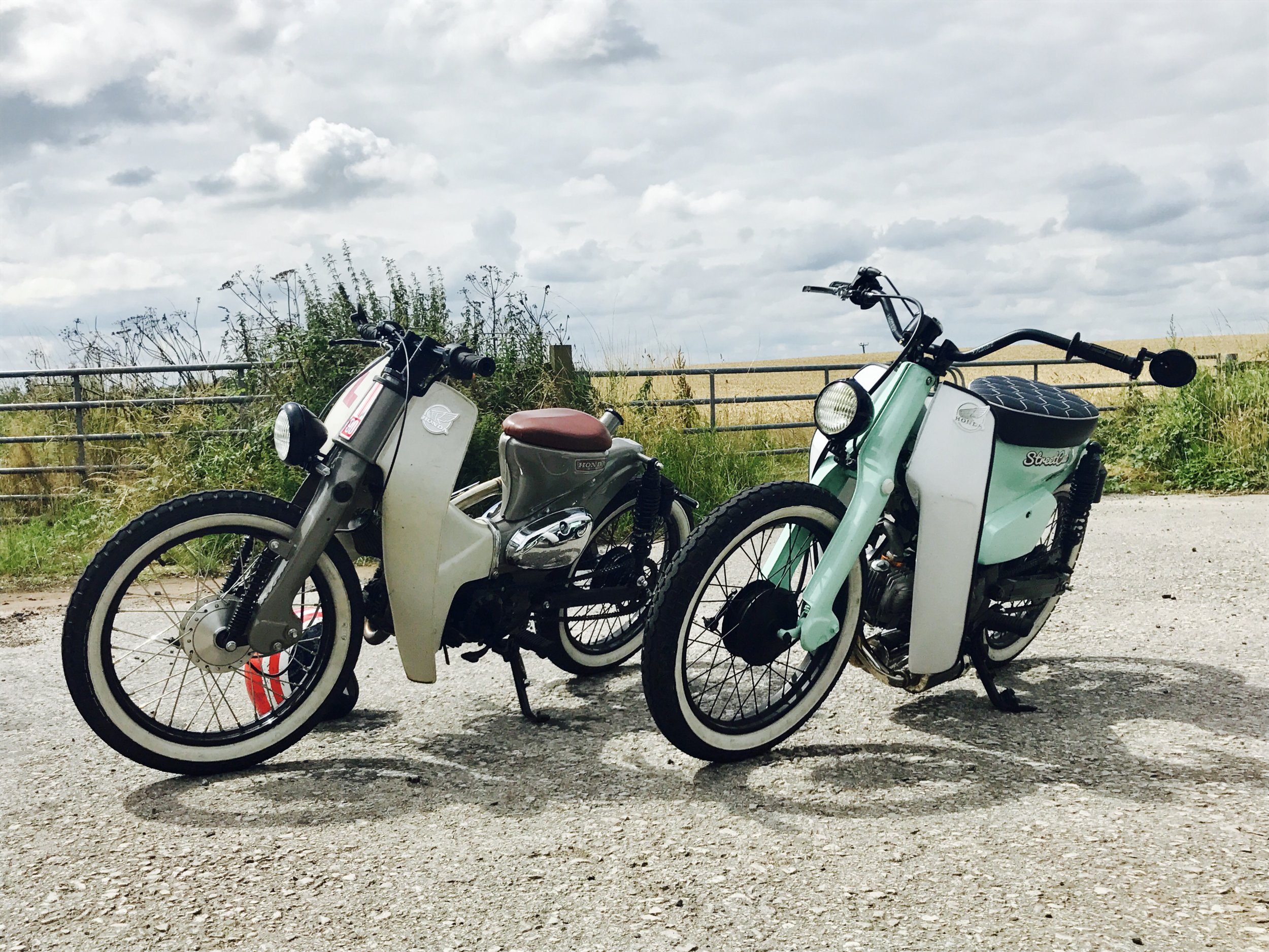

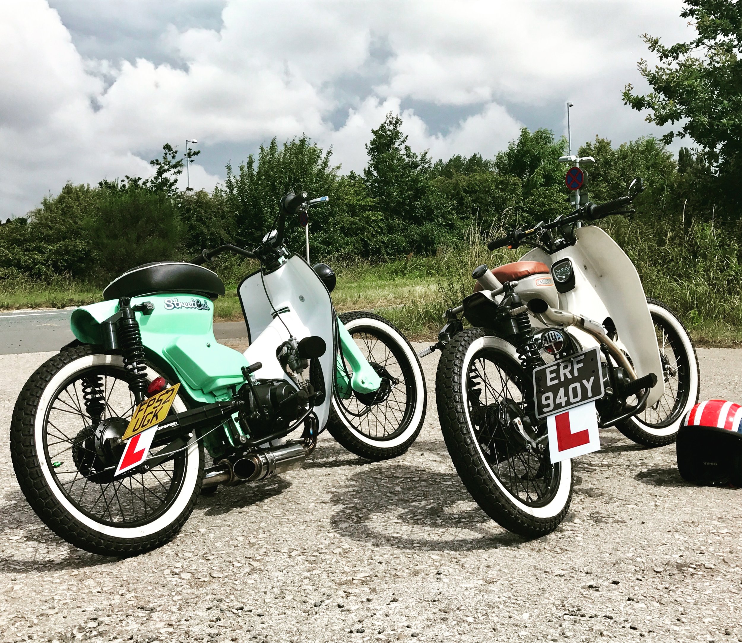

No not got a build thread or a spread sheet! But i do have a few pics as i went along, its got kepspeed swing arm and forks, kepspeed flat bars and conversion plate, kepspeed exhaust, standard wheels powdercoated black rear and just black rim front. Brand new honda brake shoes with new springs. Mad munk headlight and switch gear, mad munk front brake lever and cable, conti air filter, home made seat, custom fuel tank to relocate the fuel cap to the rear of the seat. Original 1983 leg shields, continental 2.75 whitewalls...
Think thats about it! Il of missed something but its all more or less brand new

The wheels, did you take them apart yourself and just chuck them, spokes and all, into a powder coaters? That's my biggest question!
I have brand new conti go's so just need the wheels done. I'm going for form a list later and see what it's going to cost me. I need a project anyway.
  106 rallye

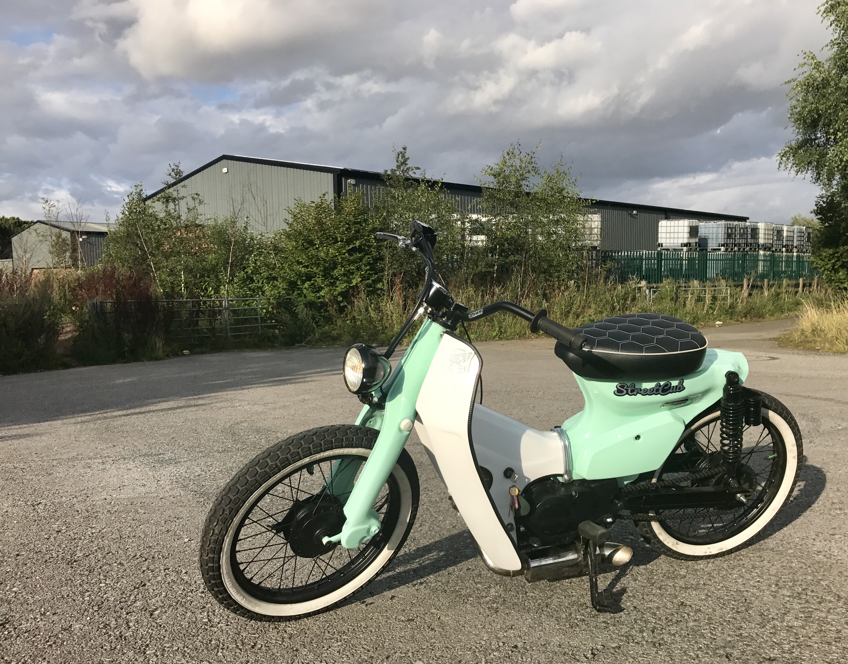

@Rob just chucked the full built wheel in the powdercoaters! But on the front wheel i only got the rim powdercoated as i wanted it silver on the front with black rim but full black on the rear.

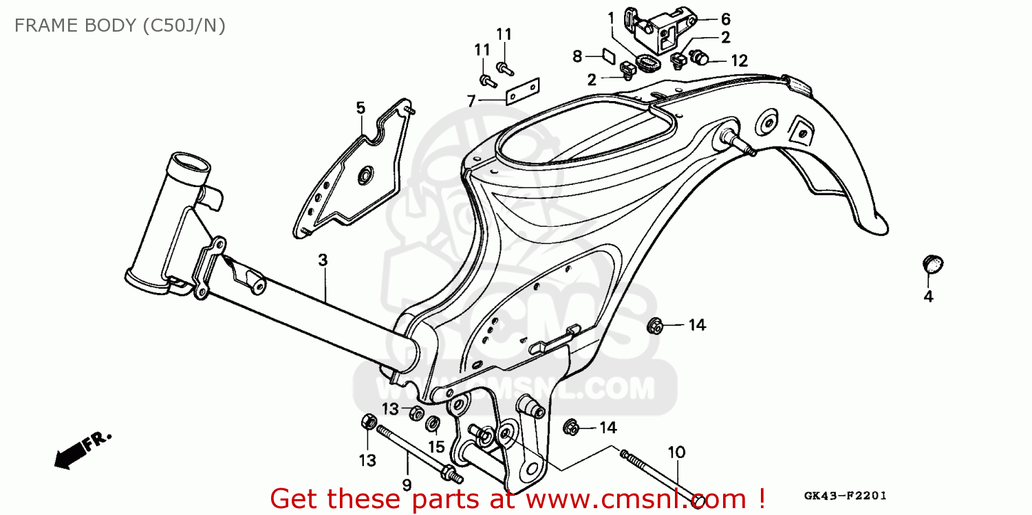

It seems they vary, but bare frames on many cubs are like this:
This is a 50, but it was the best I could find:

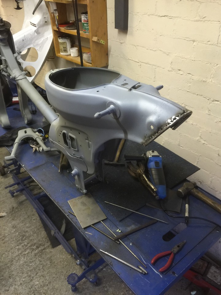

So people bob the tails like this:

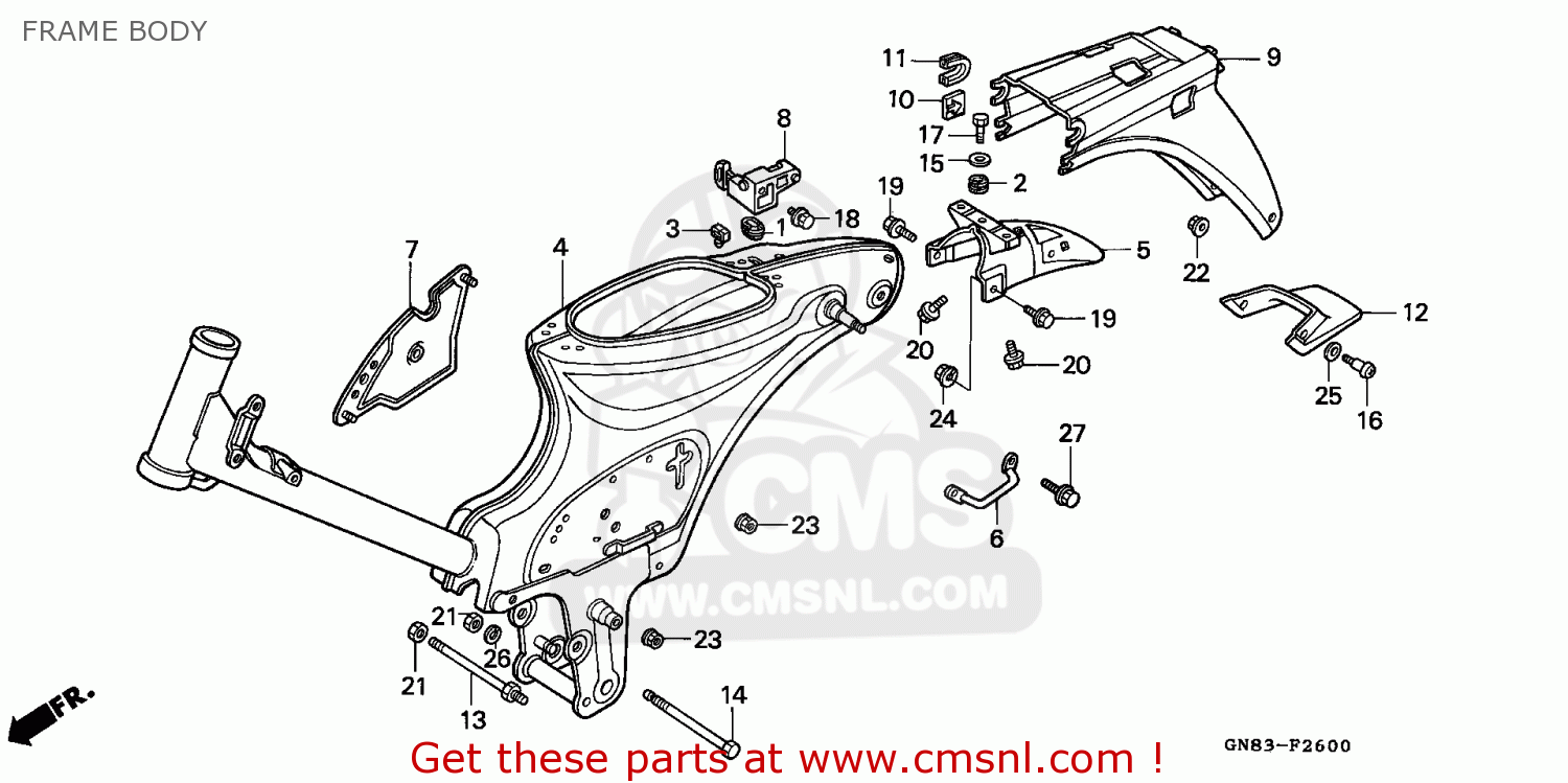

It seems some of them however came with a different frame:
Which sounds like what you're describing?

Yeah I'm pretty certain the bottom one is my frame :)
