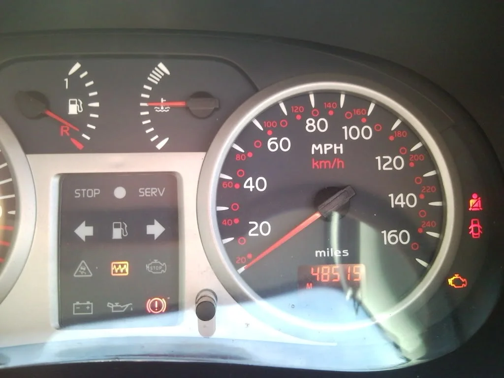

yeah its blinking and showing a yellow [ ~] , the car have power and when trying to turn on it kicks too life then suddenly dies and cant start when trying again. No no the big belt is on. nothing is missing besides old wiring looks alittle rusty but cars ok.
The orange ~ squiggle in the middle is ignition system fault. So this could be anything from coil pack, HT leads, spark plugs, fuel pump, injectors etc.
This one?
yes , and a drunkard of a mechanic said its obviously the fuel pump. i trust him but i wanted too check for more security in answer and action.

It sounds like the the battery to me. You say the " green indicator " on the battery was black ? You recharged it but but still nothing ? The green indicator is only showing that , that 1 cell is ok so isn't the best way to tell if the battery is in good / bad condition . The battery needs to be around 12.6volts , use a mutlimeter to test it or borrow a good working battery if you can . When my battery died , I had my red immobiliser light flashing repeatedly .
yepp tried now and nothing changes, first key gives equal results as the 2nd yes i landed on Immobiliser issue at first. but i dont understand why taking out the battery too charge it will make the Immobiliser issue kick in .. it almost started on first try so no fuel?but then again 2nd time around its seems like its doesnt spark too life .
