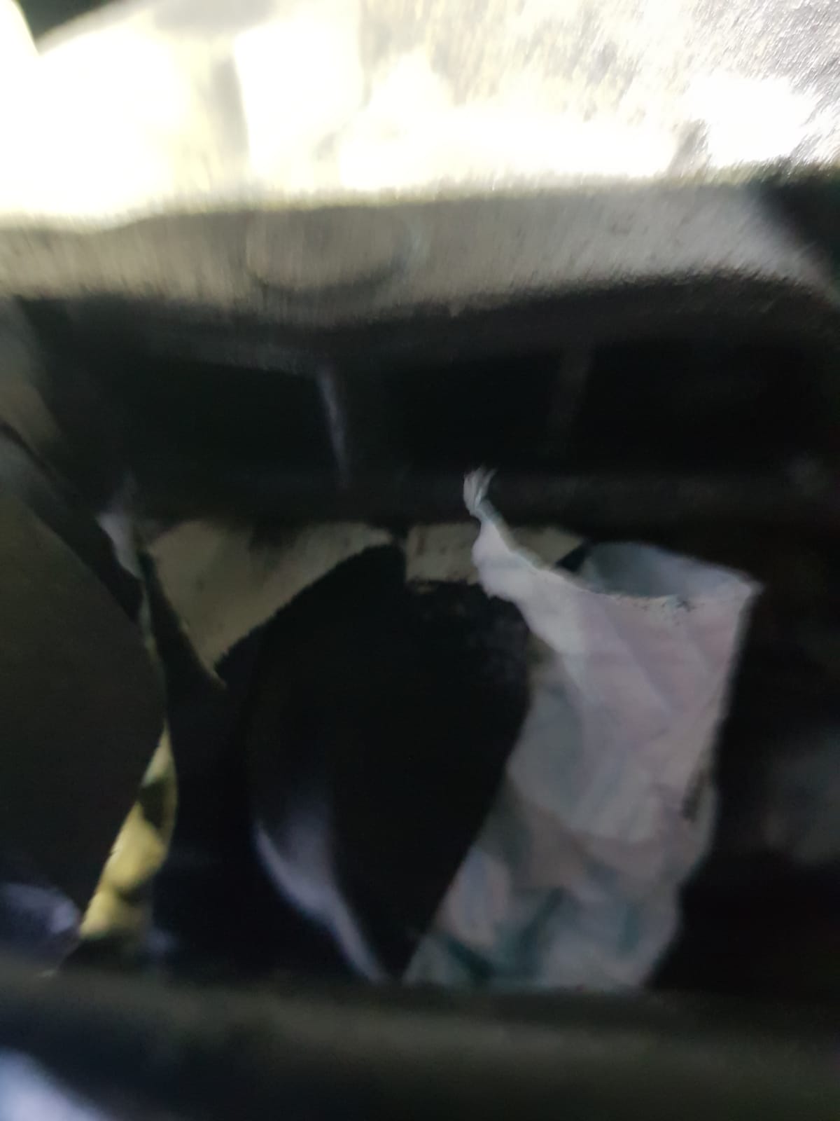

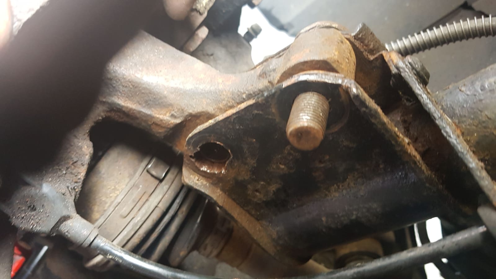

Paper covered with oil and graffer tape in the gearbox... That is not a good sign:

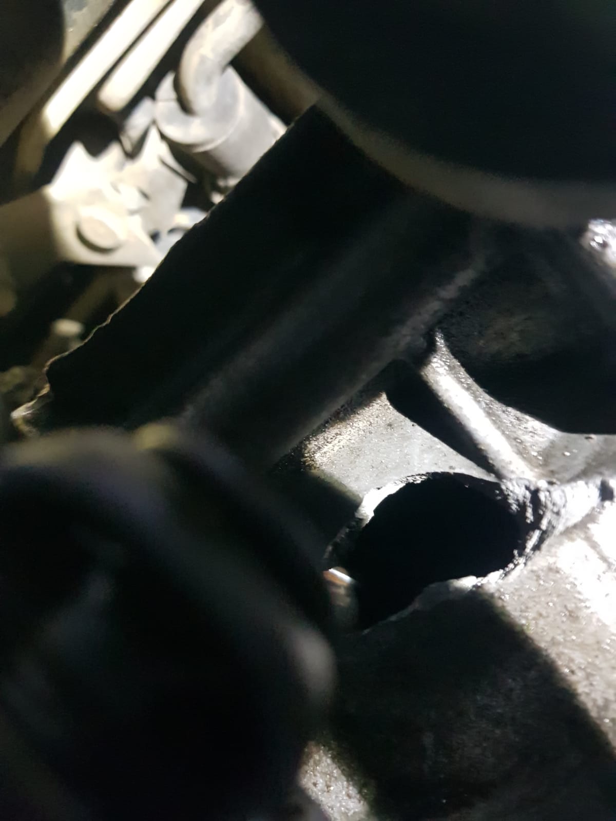

But the worst was UNDER the paper....
whenI saw the hole, nearly burnt the car straight away... but decieded just to park it, and have a though about it.

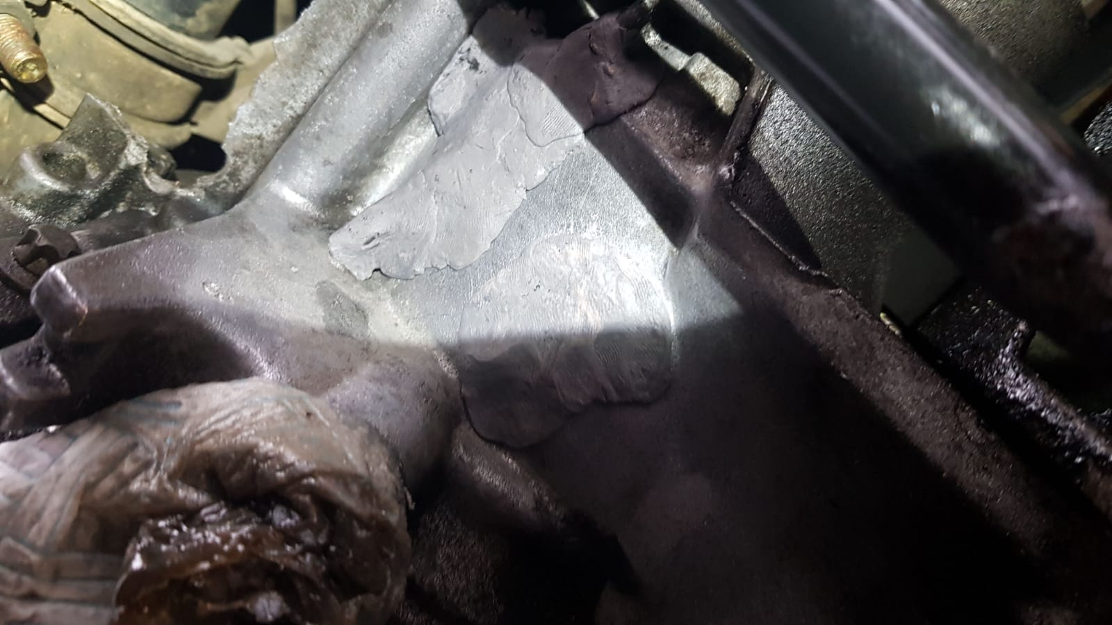

Next morning, decieded to investigate, how a fully operational gearbox could have this massive hole... as this normally means that something is tried to escape from there. And decieded that someone had trown the car over an axle stand while working on it. And... decieded to seal the hole, put oil and see what happens.
That was my bodge (chemical metal with an aluminium plate to the shape underneath). 500 miles after, is still perfect. Of course, I´m on the hunt of a gearbox... but meanwhile this one works.

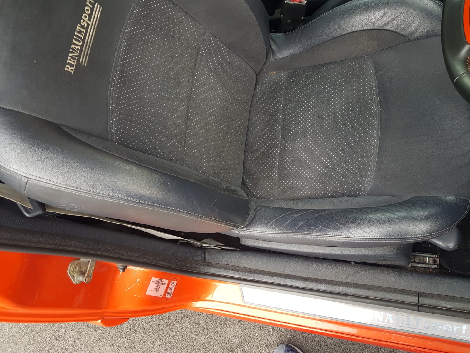

Find a few pictures of the car after a quick clean up...
