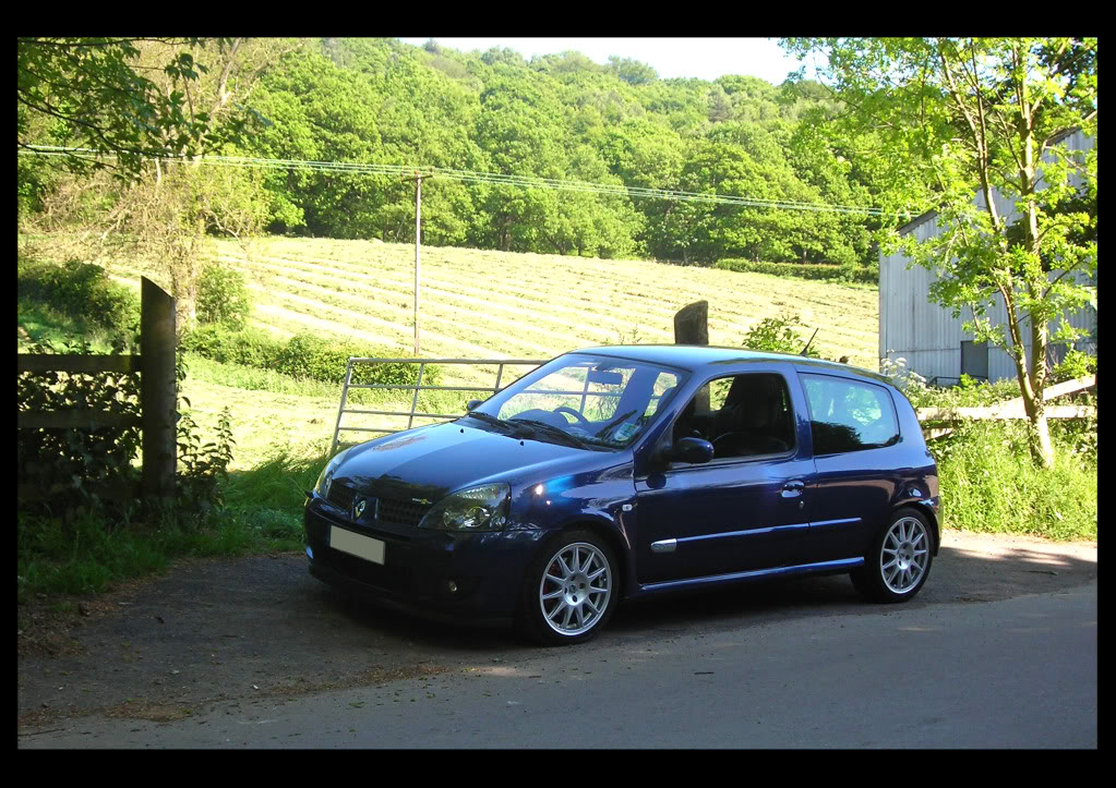

Sold my Ph2 172 at the end of May.

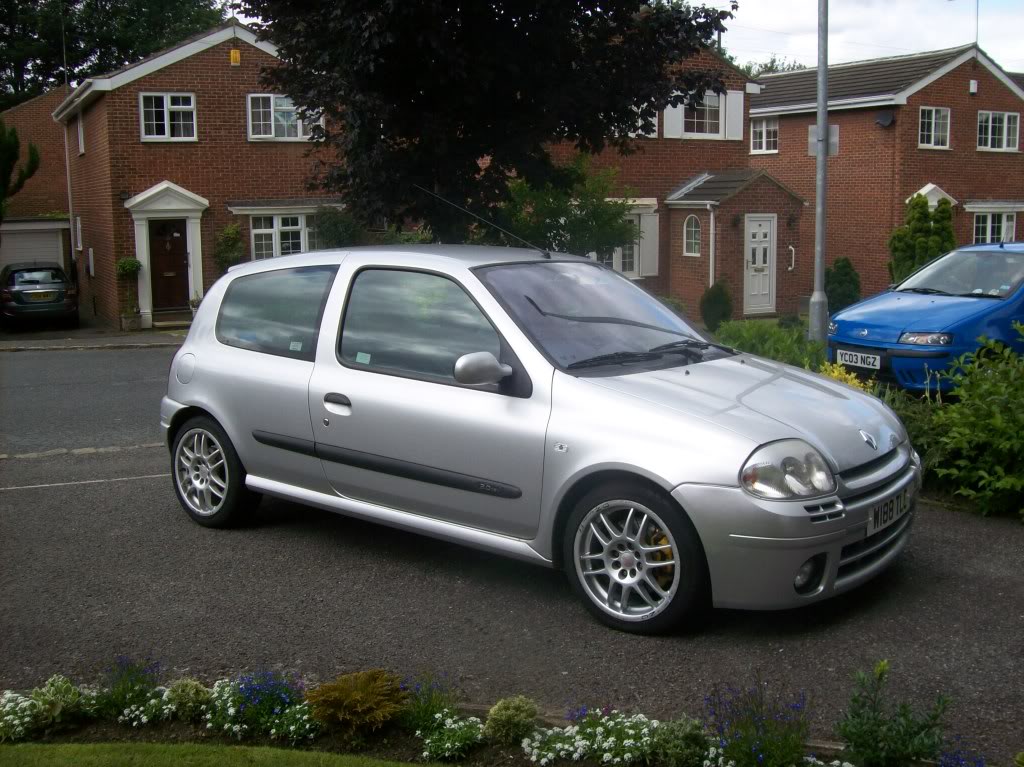

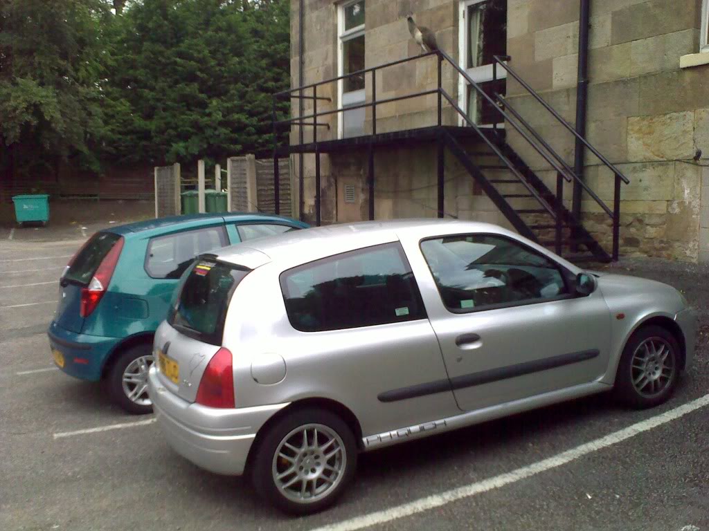

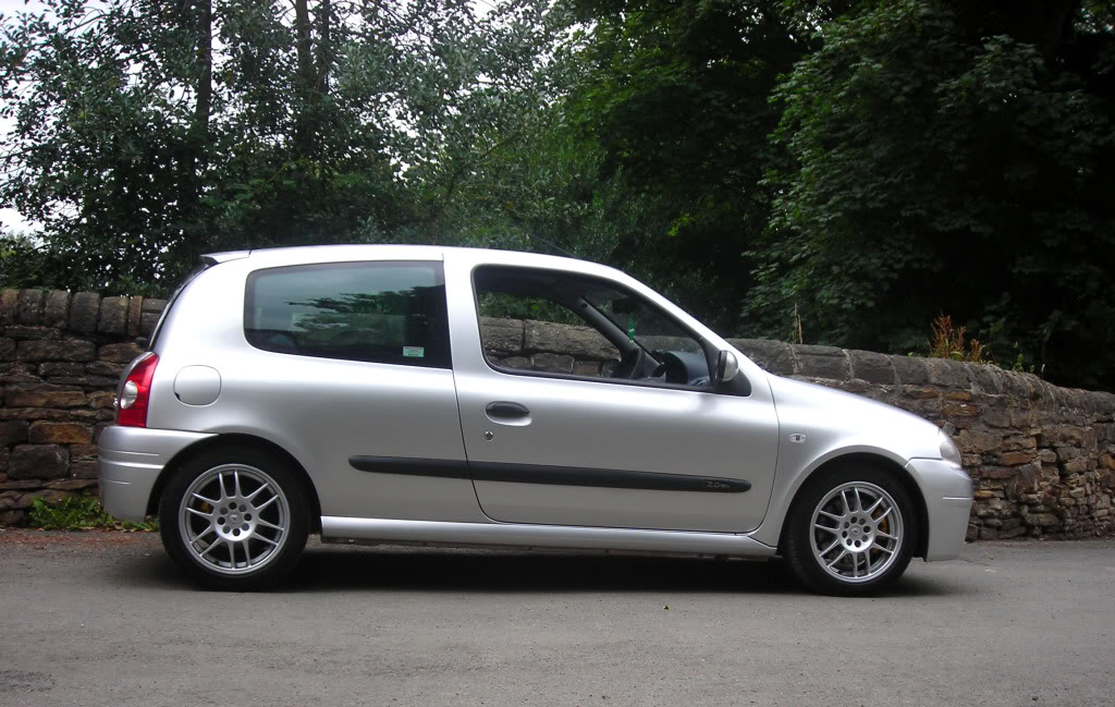

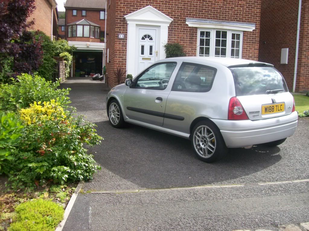

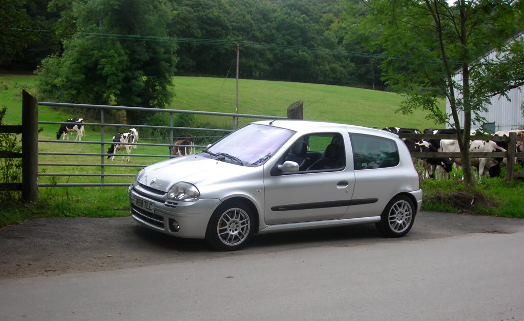

Bought this off a cliosport member back in June. It's a 2000 W plate 172, and had 53k on when I bought it. The only faults were exhaust related, blowing and a rattle on start up. Sorry a lot of the pics were taken on my phone.
At a pub on the way home.

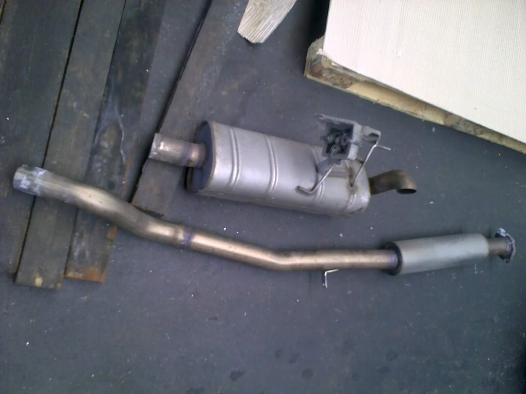

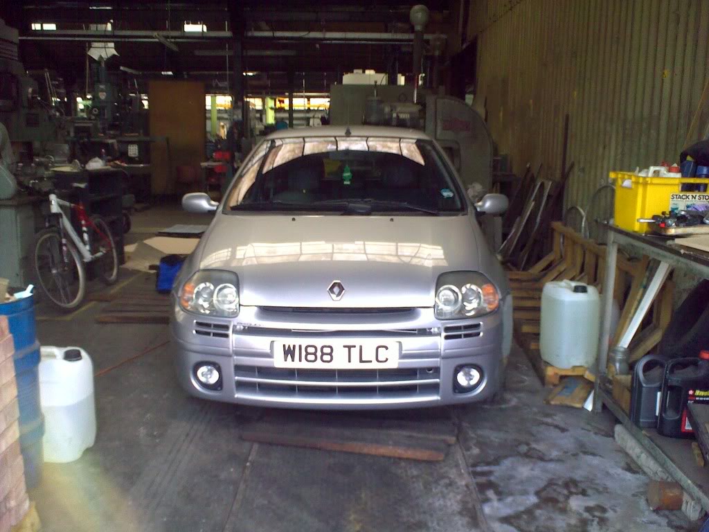

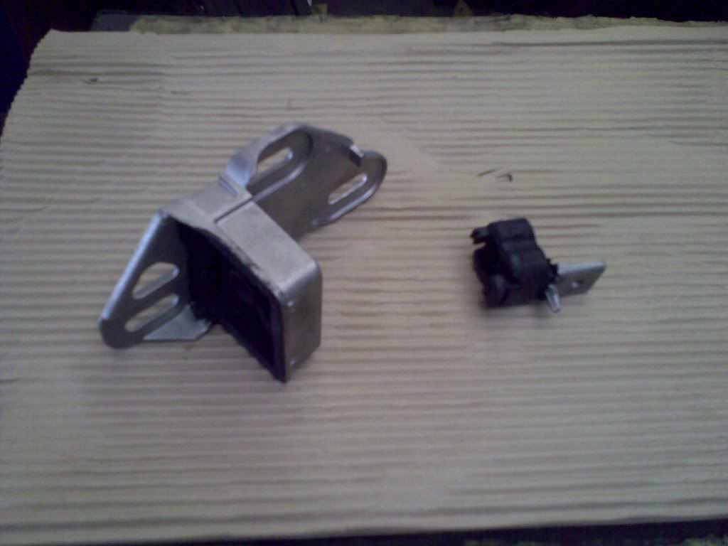

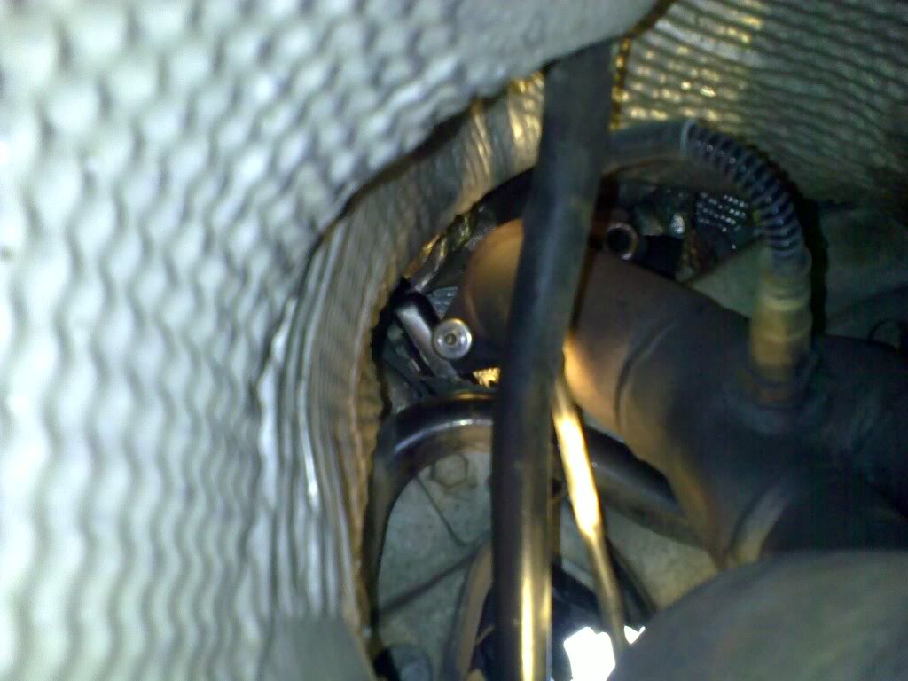

So the following weekend had the car over the pit and took the exhaust off.
Found that the cat was being held on with one bolt.
So I re-fit the exhaust with new brackets.
However this didn't get rid of the rattle on start up, so back over the pit it went for another look. Checked gear linkages but it turned out to be a lose bolt on the bottom engine mount. So after a saturday morning in a pit the car sounded much healthier.

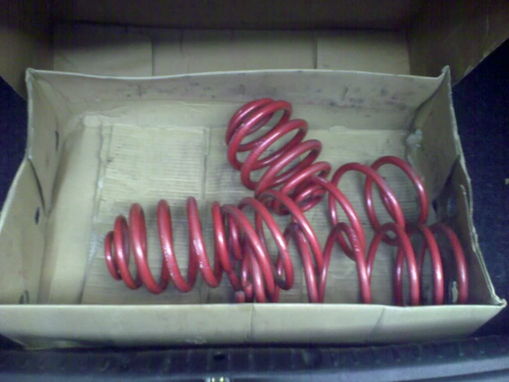

Bought some Sportlines off drunkenmonkey.
Got them fitted along with some clear side repeaters and Ph2 rear lights.

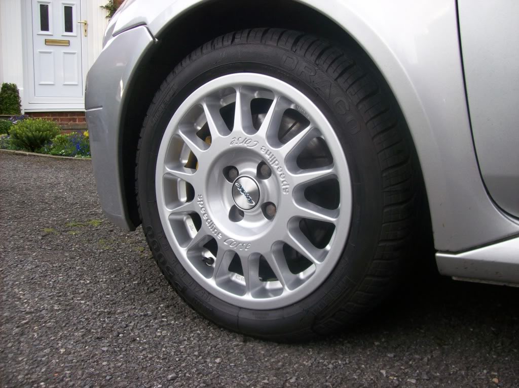

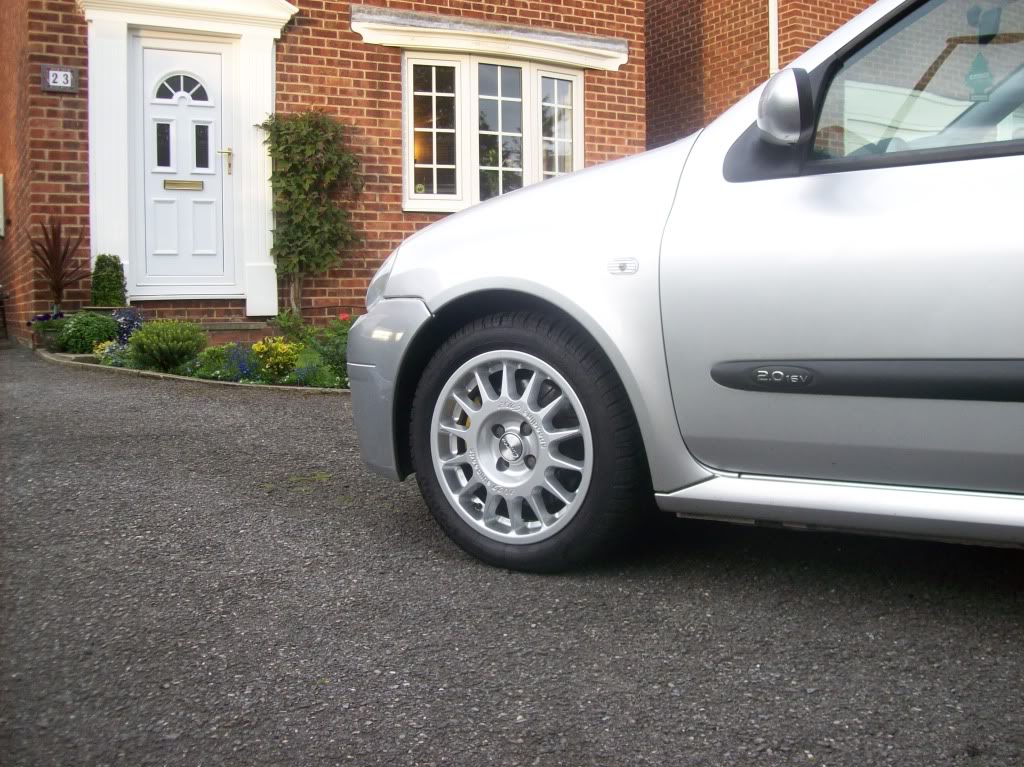

Decided on some 2118's in silver as I fancied a change. But only had them a couple of weeks as I just wasn't keen, think if they had been anthracite it would have been a different story. Can only find the below two pics.

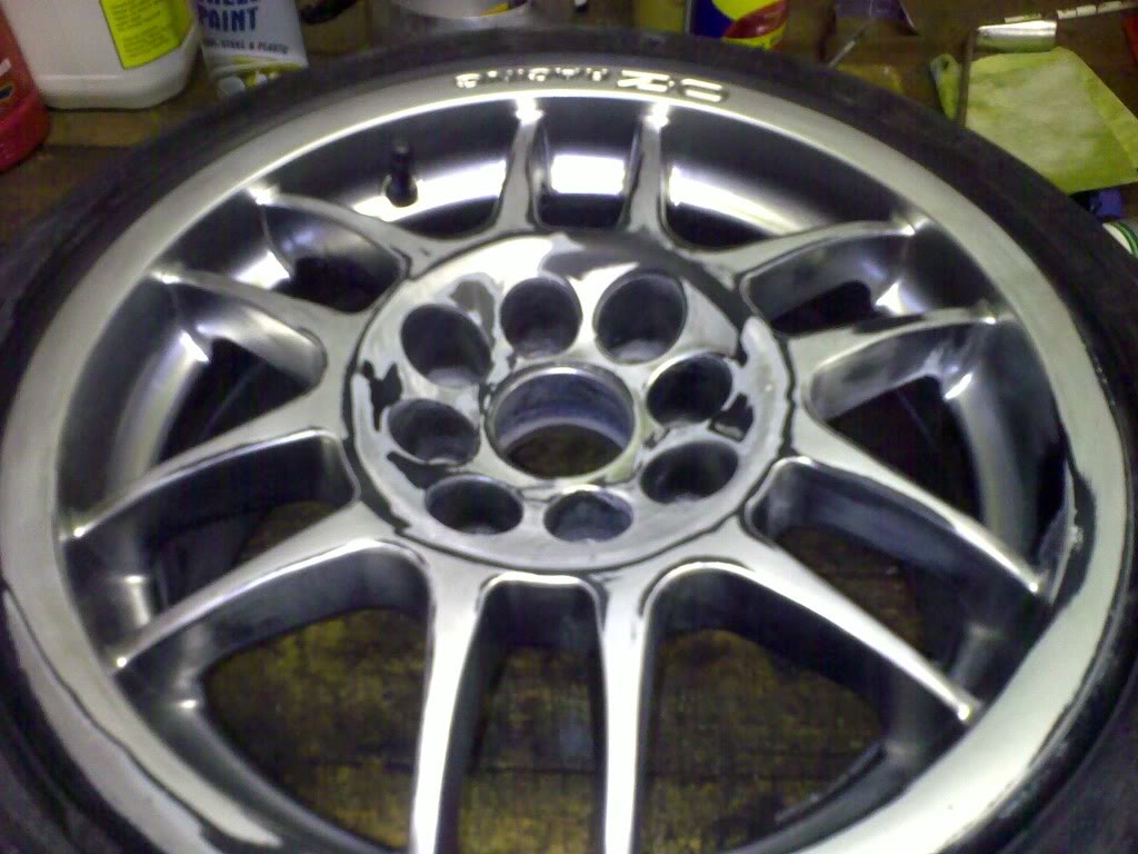

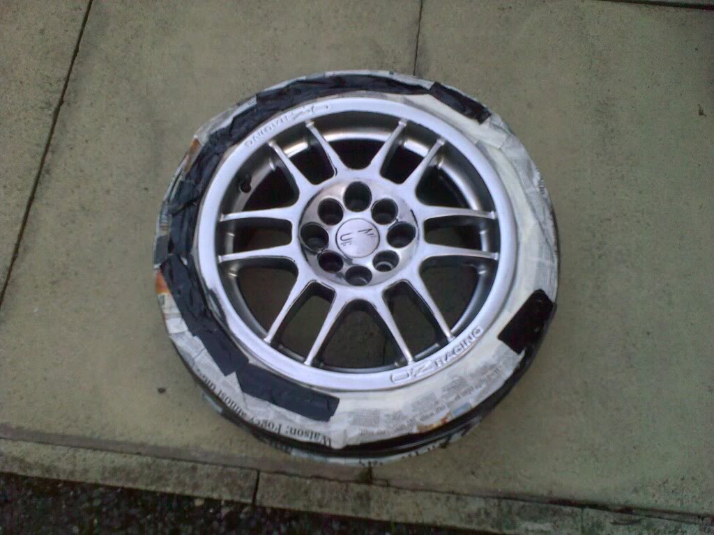

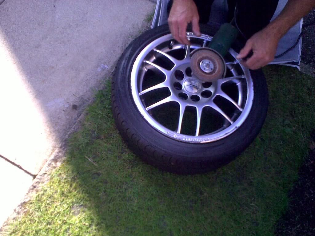

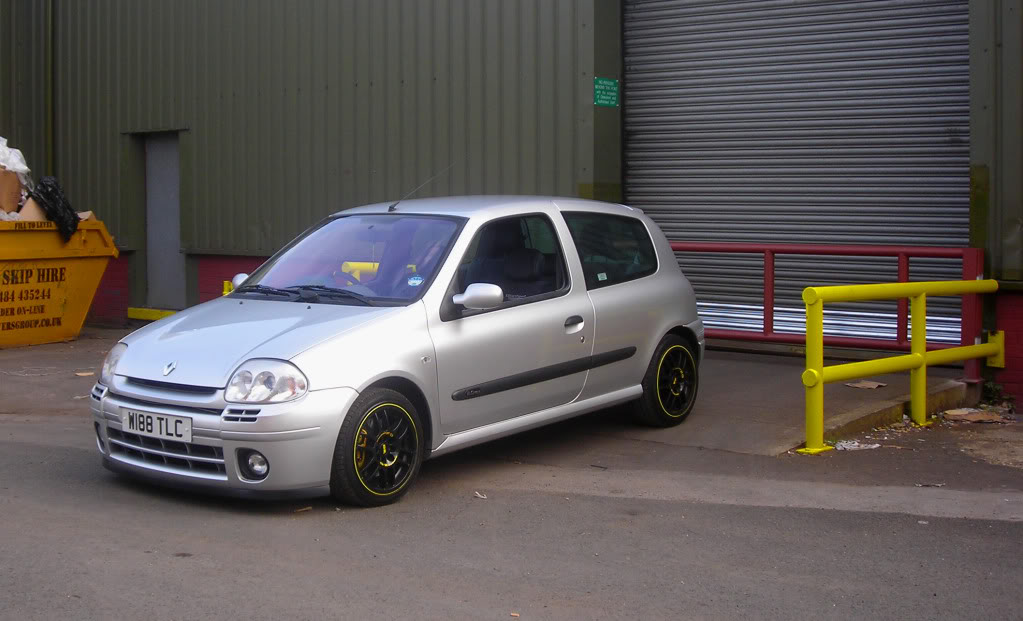

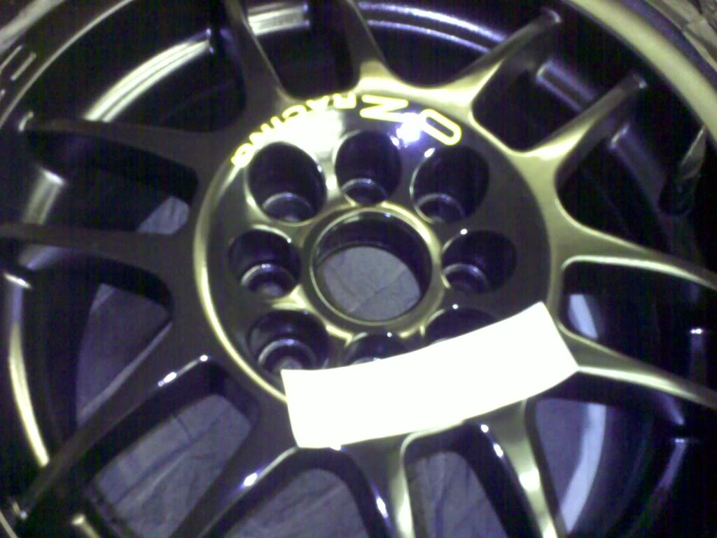

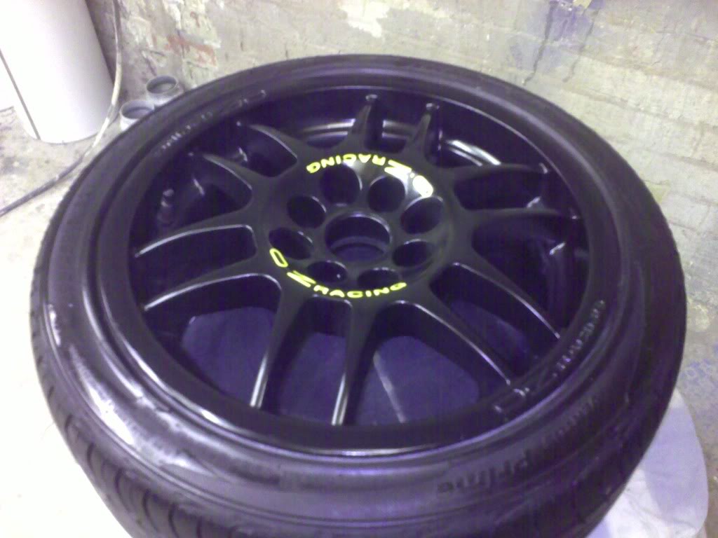

Wanted to try and refurb a set of wheels so managed to pick some 15 inch OZ F1's up off the bay, alot of the paint was bubbling and they were curbed.
Set about rubbing them down, knew it was going to be hard but it did take longer than I expected.

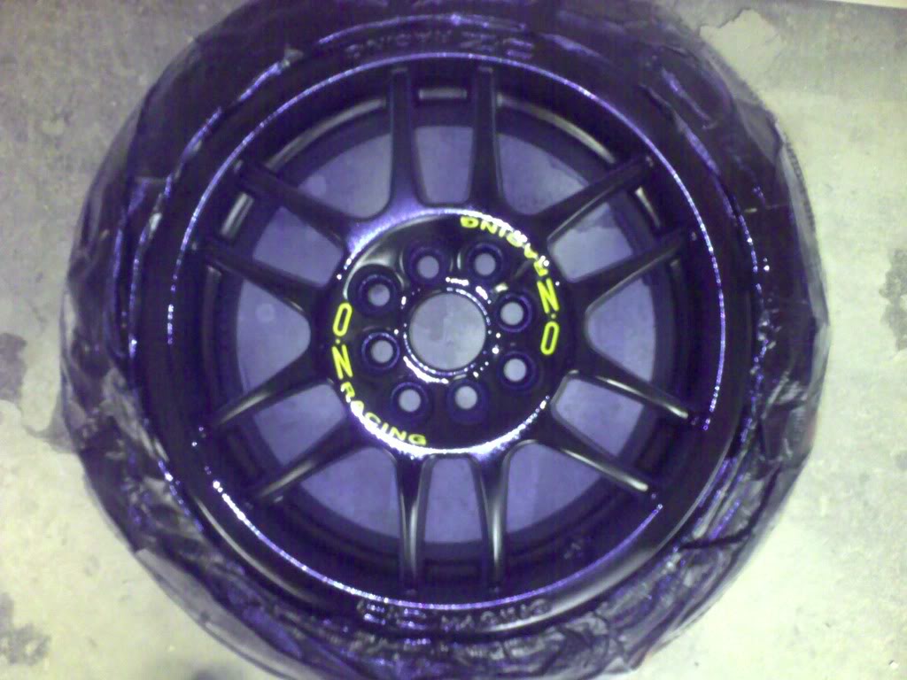

Several coats of primmer, black and laquer later and I was very pleased with the result, the time spent rubbing down felt worthwhile.

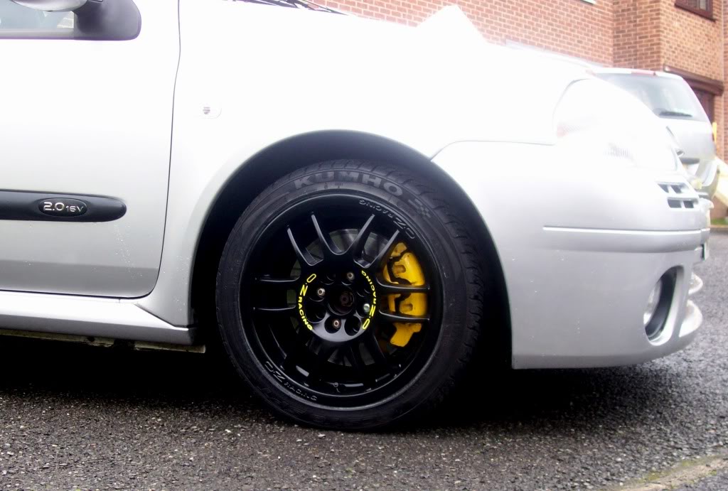

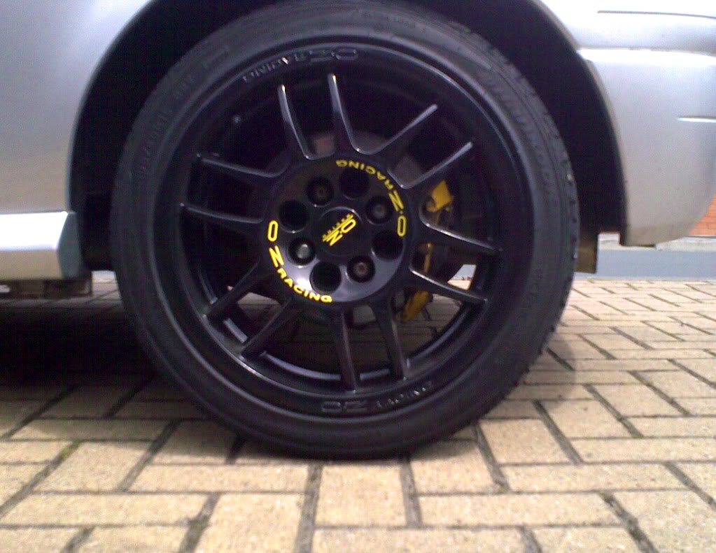

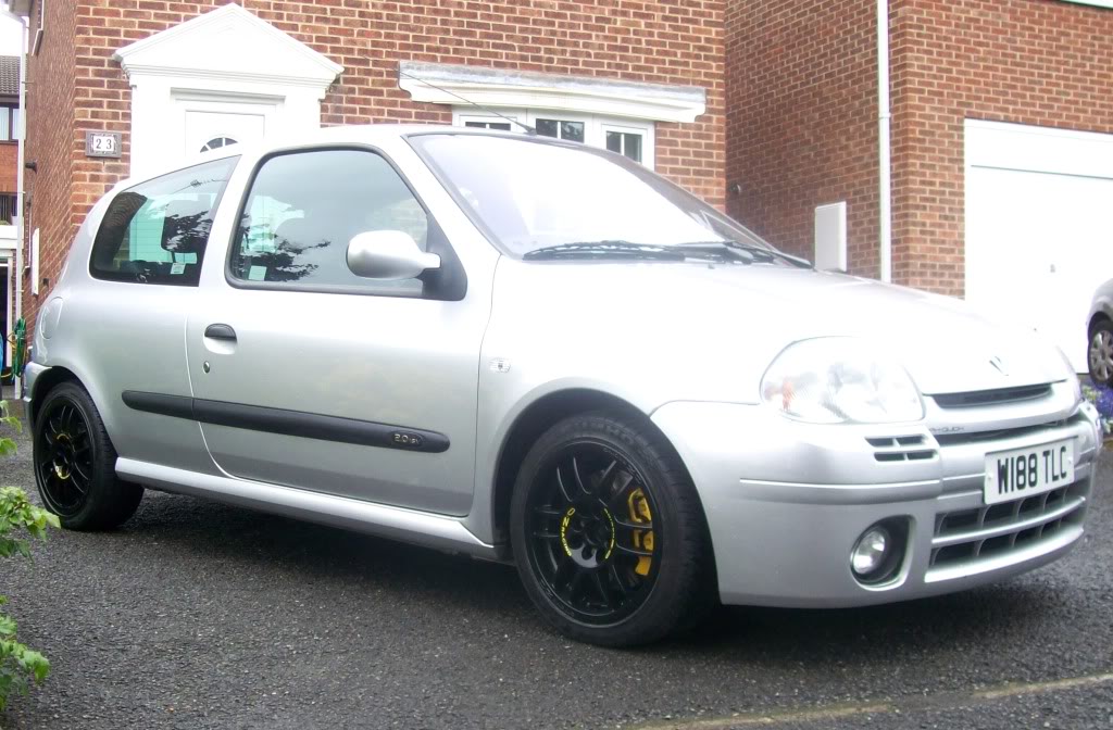

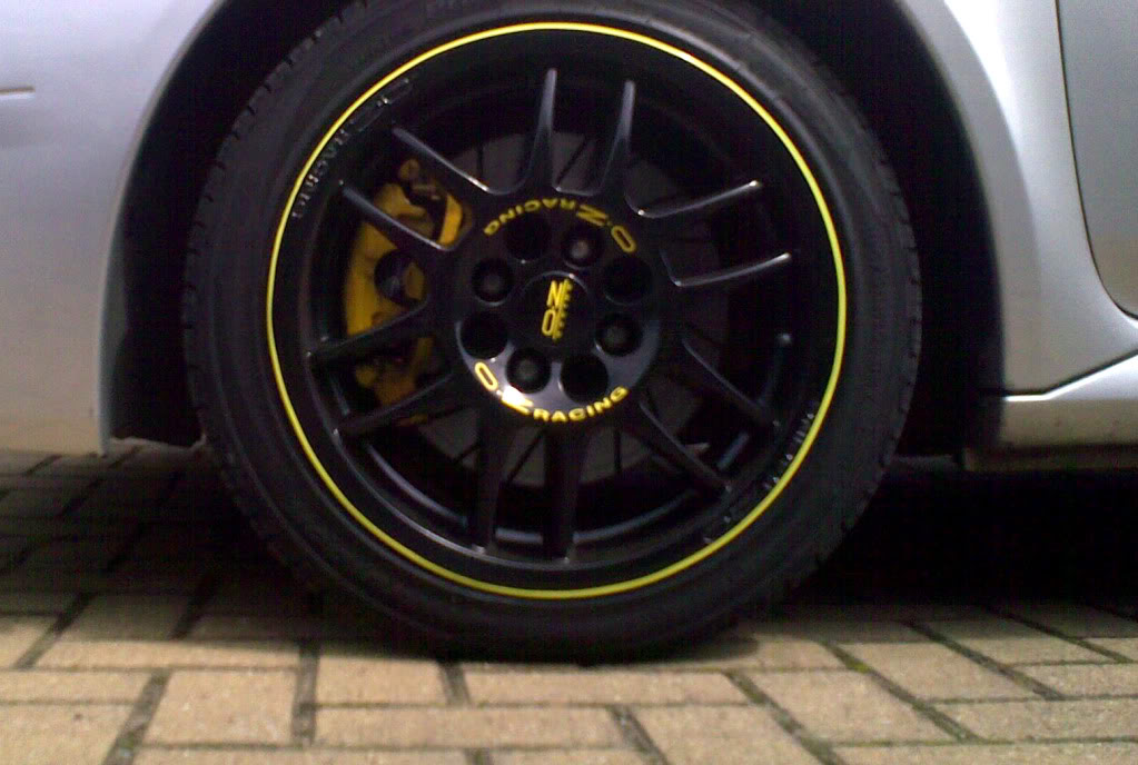

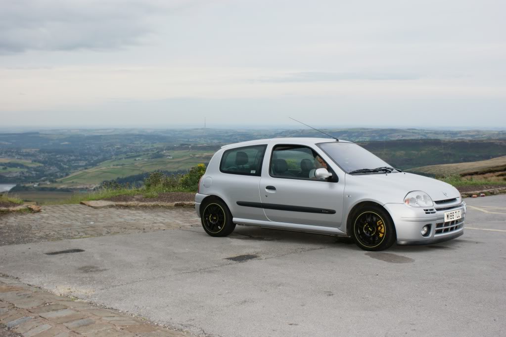

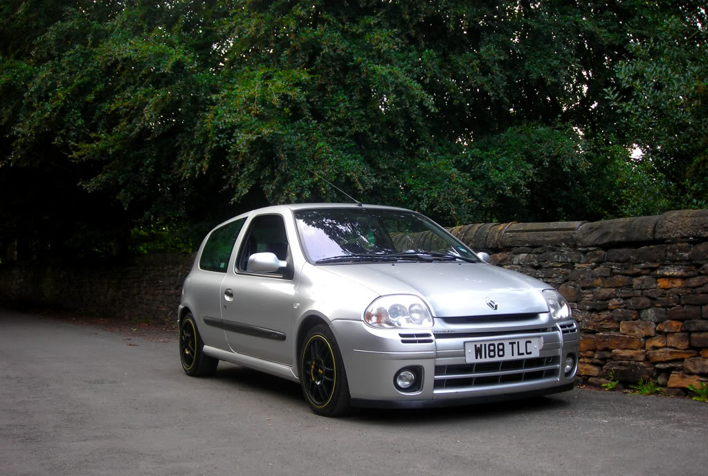

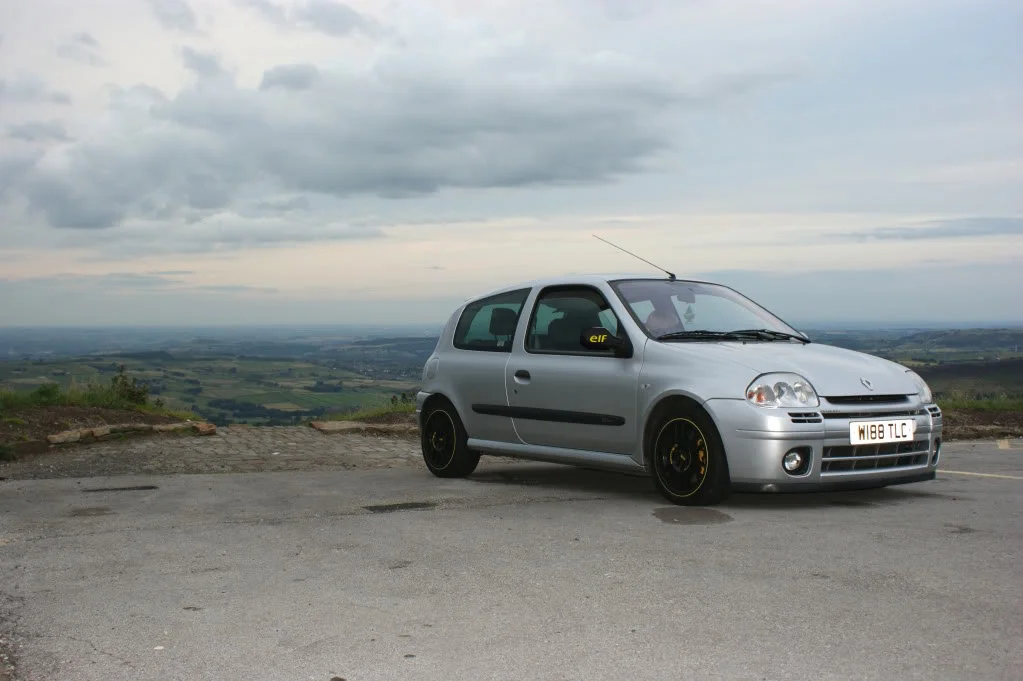

Got them fitted.
Finished the centre caps off and added some wheel tape that Greeny supplied. Still can't make mind up about the wheel tape, but it took that long to put on I don't really want to take it off.

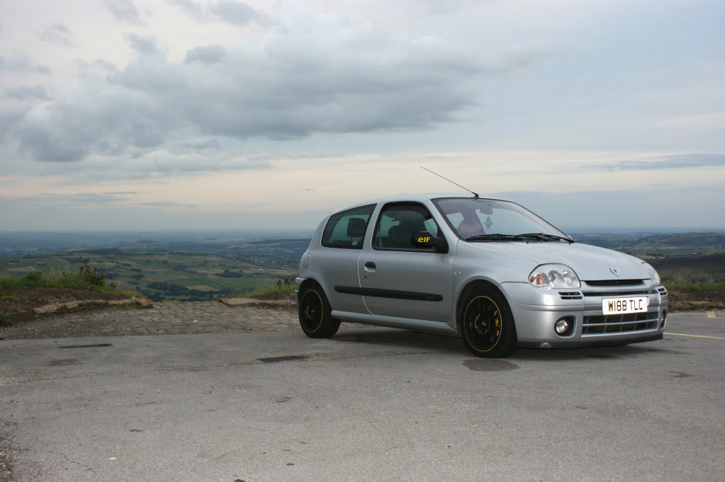

Then came a 307 splitter, which I think has improved the stance of the front end.

Looks great,you have made a nice job of the wheels,the front splitter I want one of those for mine,307 is that off a peugeot 307?,which model? were did you get yours from?

that looks f**king lush. looked a bit tired when you first got it:cool:
It just needed a clean, didn't give him much notice when I went over to view it. The paint work was/is in really good nick, not a swirl in sight!

The black wheels look great as does the splitter. Did you keep the original plates after you took them off? They were the orginals from 2000. Paint was in good nick as I had PC'd it quite a few times so had a good layer of protection on it.
Really annoyed about the bolt missing out the cat. I'd recently had that done prior to her being sold, it cost me the best part of £100 including the labour and parts!

Yeh I remember you telling me a garage had replaced a gasket on the exhaust, you did say you thought it hadn't be fitted correctly. They must have lost a bolt and possibly slackened the engine mount to access the front of the cat and not tightened it up.

Still not sure about the black wheels, I'm in the process of collecting another standard set just in case I want to put it back, just need one more.

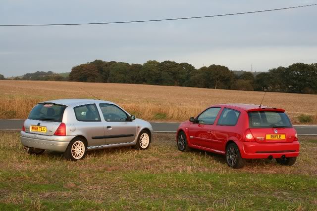

The black looks good in the pics, but coloured wheels always look smaller in the flesh. I had them white briefly:
Not one of my best ideas! LOL

I don't know, it doesn't look bad with white wheels.
