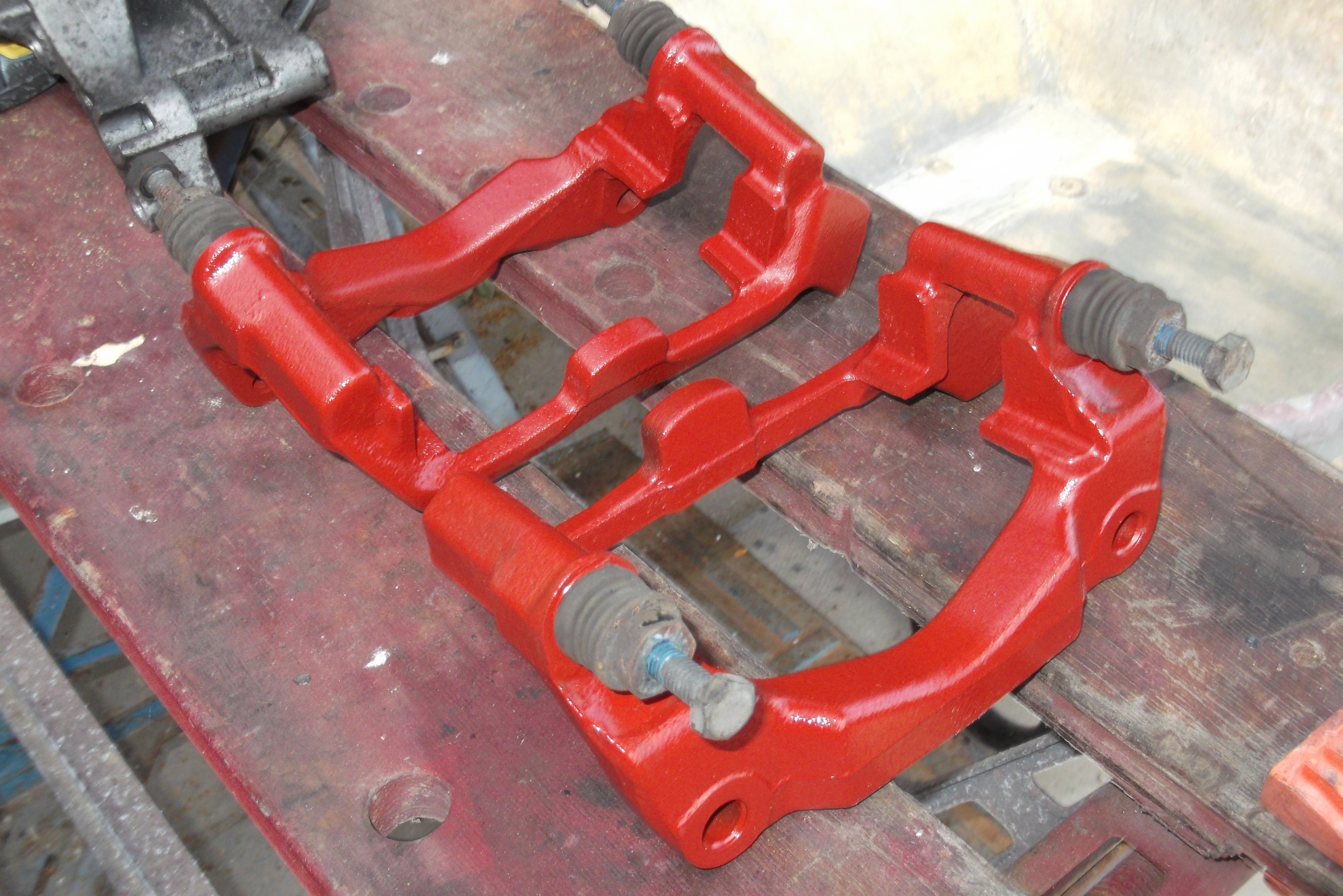

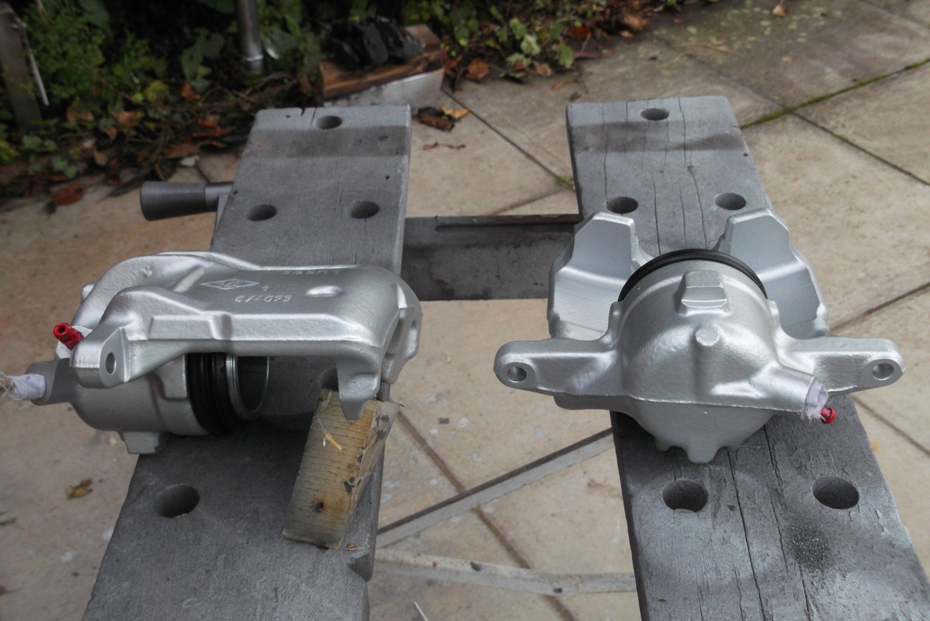

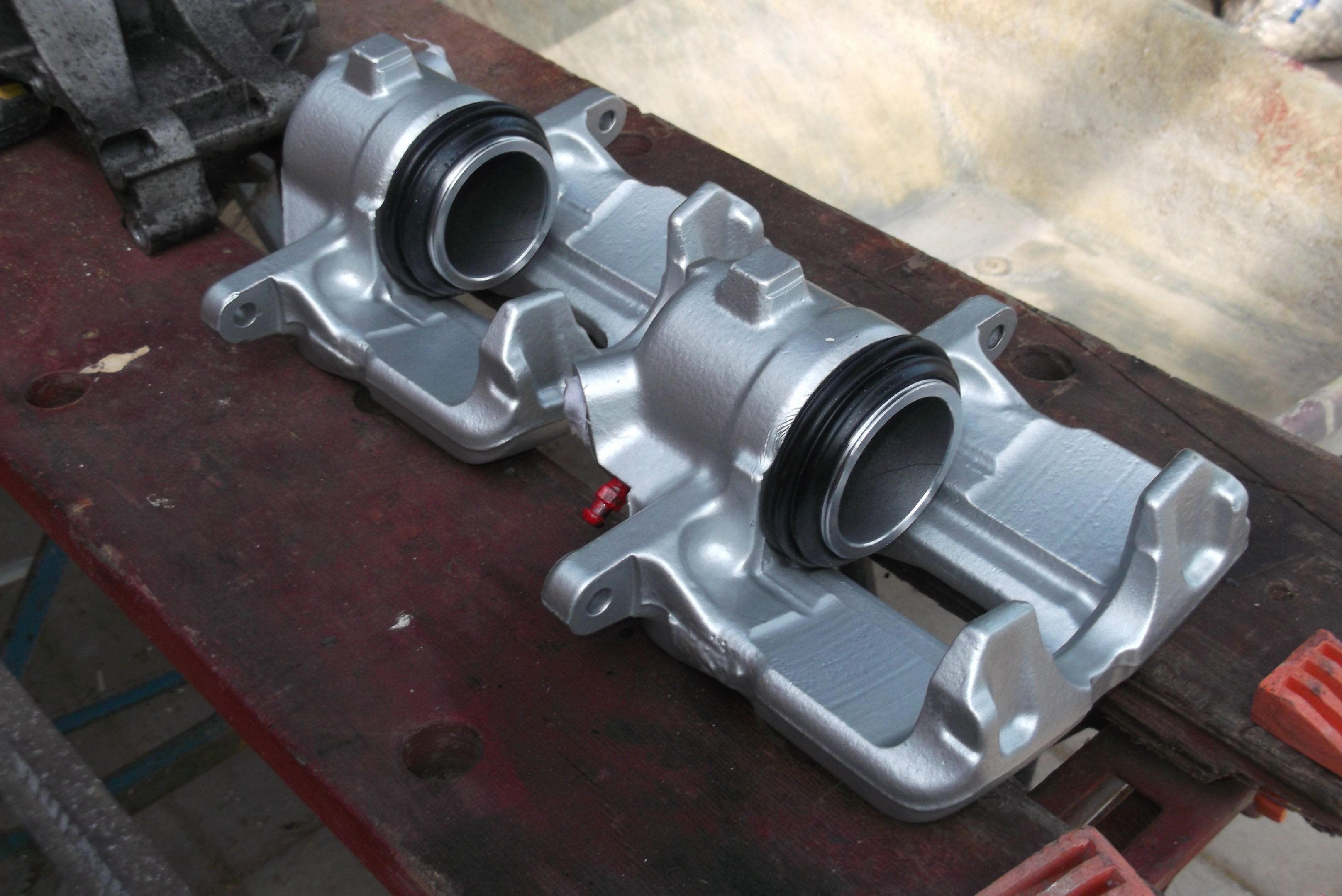

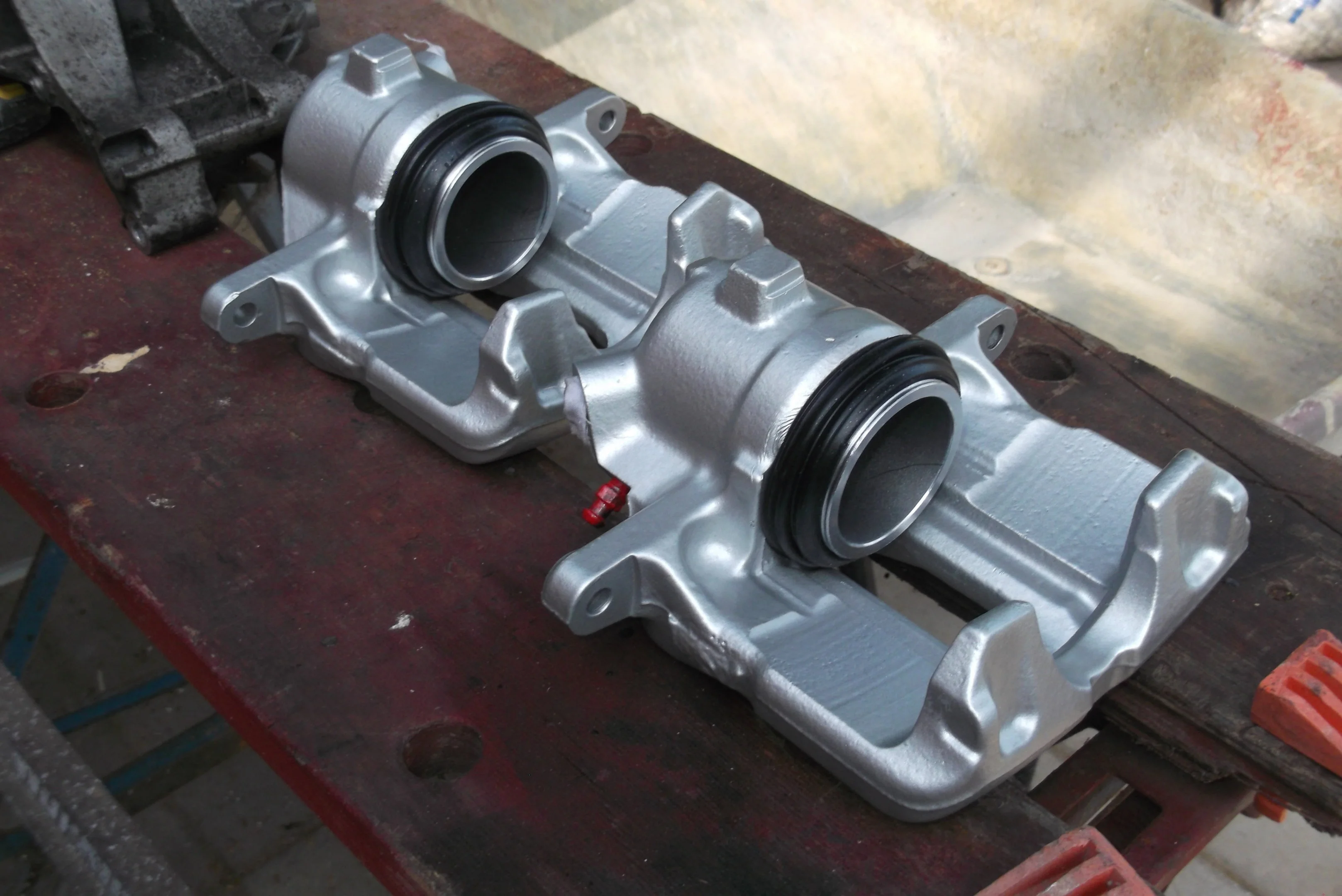

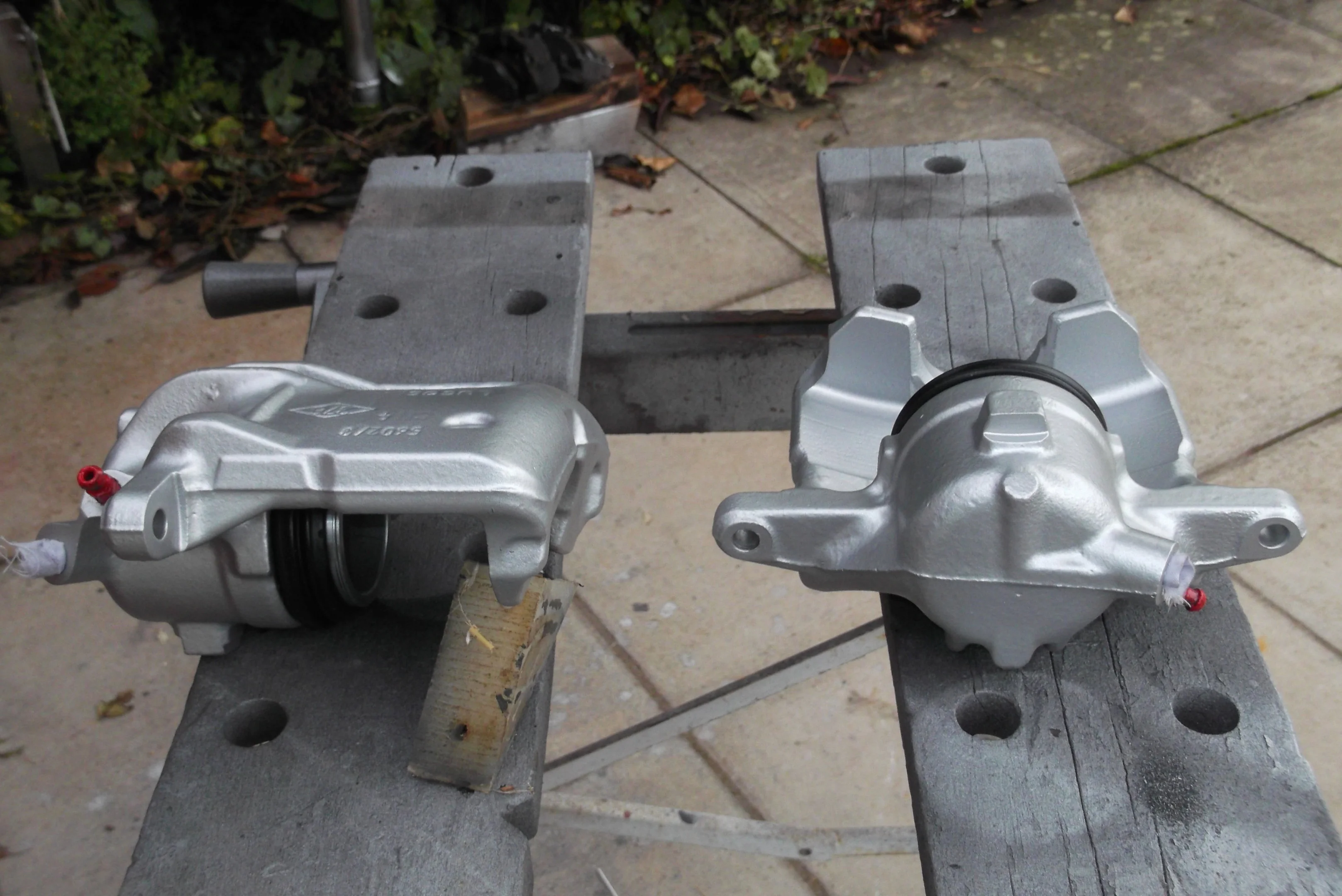

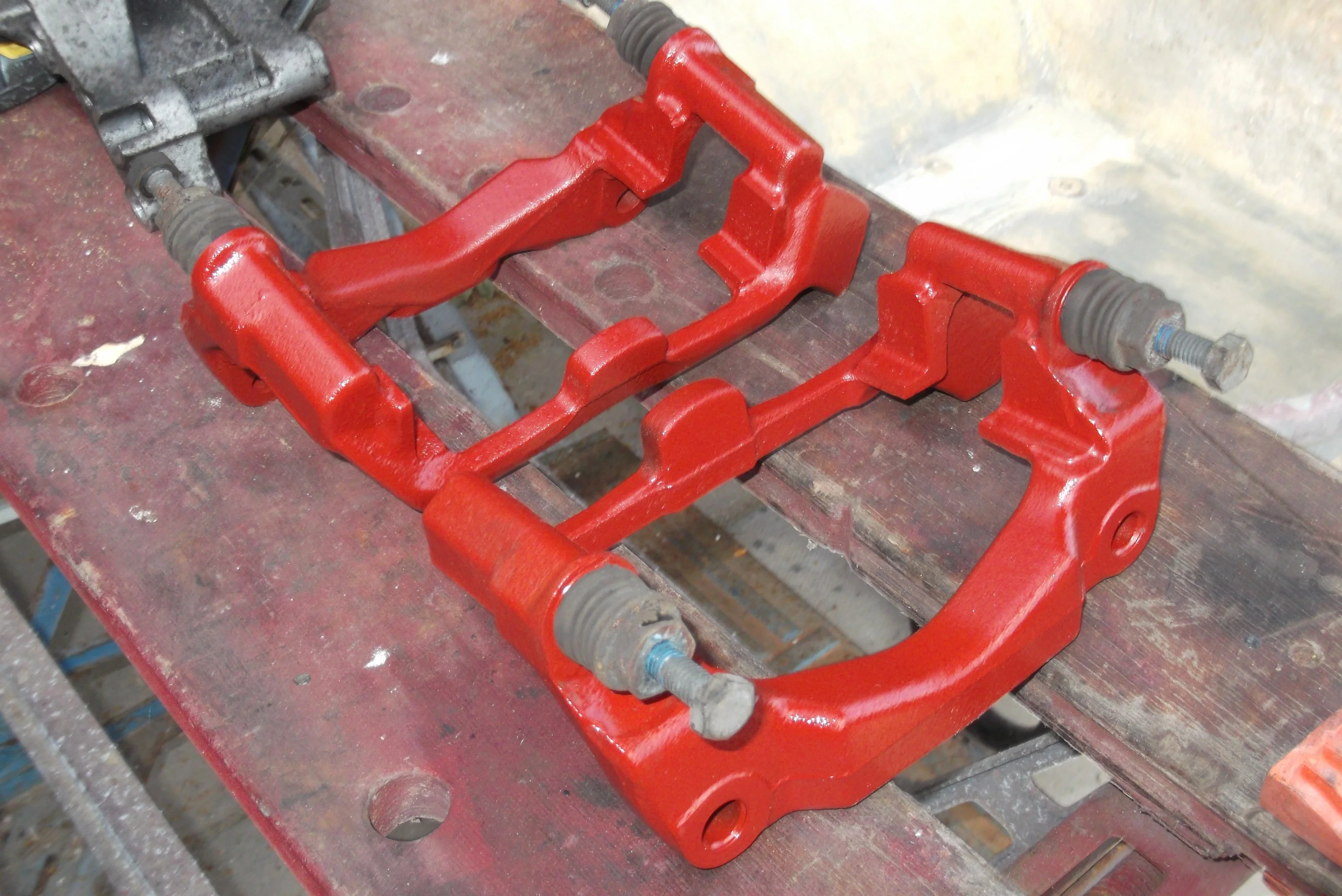

My brakes are fine but I have spent many hours using a combination of deox and wire brushes in a drill to take this spare set back to 100% shiny metal, looked brand new. I then fitted new pistons and seals and gave them a coat of silver Hammerite, have also got some stainless bleed valves to fit.

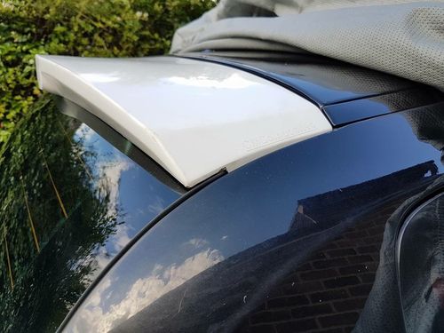

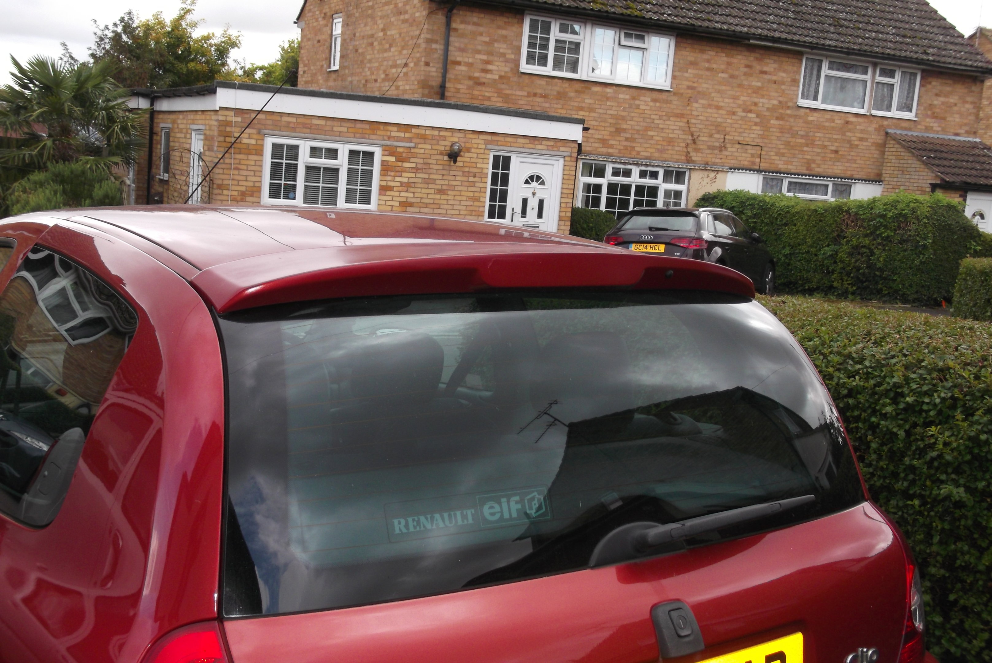

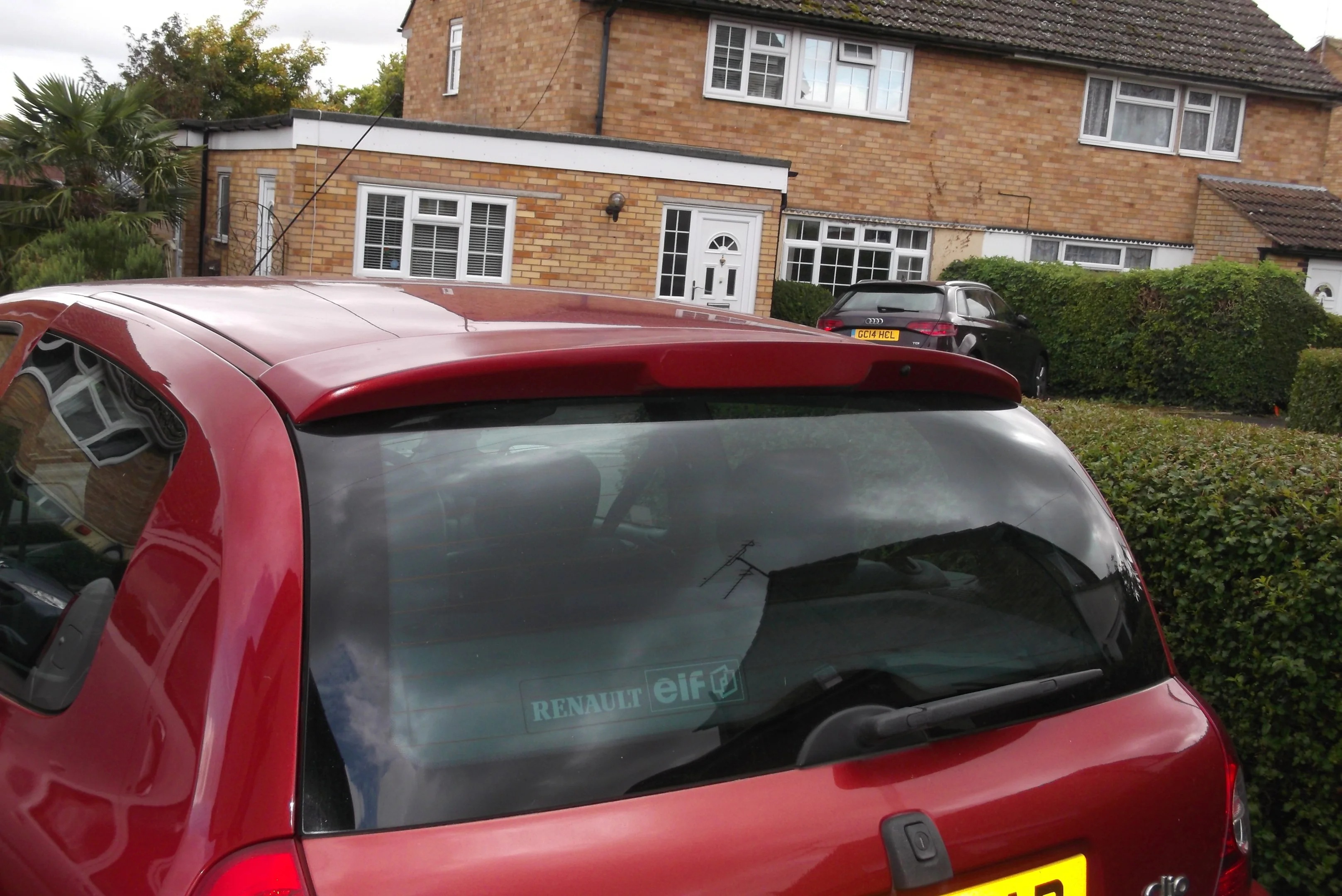

Had to fit the obligatory cup spoiler, but as the phase 1 dosnt have a brake light here, and I didn't really want one I filled the hole, not quite good enough though as its starting to crack.

The PH1 does have a 3rd brake light there, I don't understand why you didn't fit one in the cup spoiler.

Are you sure? Mine has a reversing light there, which I assumed was standard, ( none anywhere else) which I don't need as the phase 2 lights have the reverse lights in them, and as said I didn't want a brake light there.

100% mate. There should be a pipe for the rear washer too.

Yeah I have the washer pipe which I have kept, so where is the phase 1 reverse light then if that's a brake light? phase 2 has the 3rd brake light as the reverse is in the rear lights.

I the light cluster.

NO, recently sold some phase 1 rear lights, pretty sure no provision for reversing lights, that's the phase 2 lights, I think I'm right here,(but I could be wrong) and that's my last word on the subject.

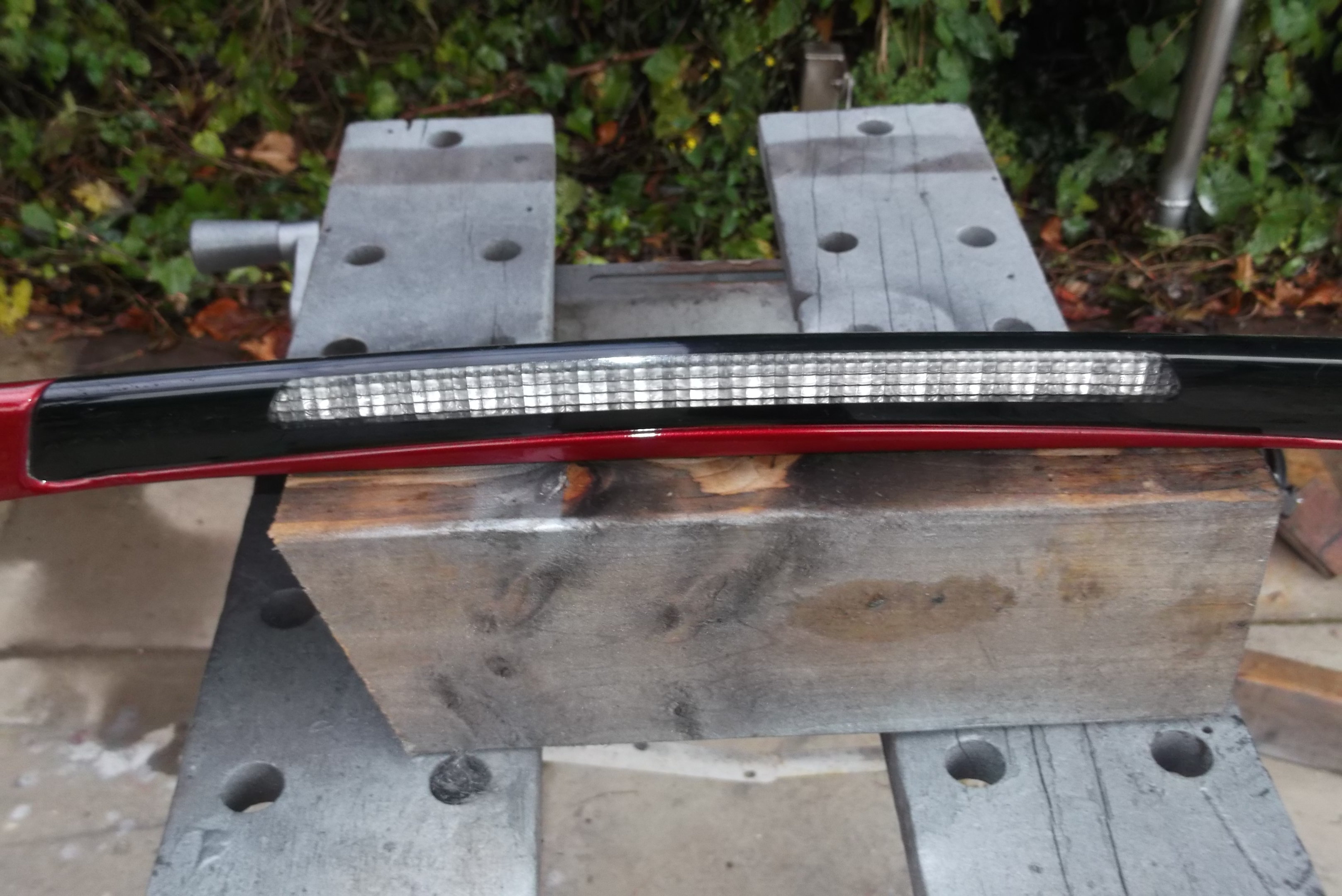

So where are the reversing lights, I don't see a clear section, mine came with phase 2 lights already fitted and I have no memory of seeing phase 1 lights actually lit up, Here is my original spoiler with what I believe is a clear reversing light.
That isn't a reversing light, it's a brake light. It's just the standard spoiler one, same as fitted to none sports. Put your car in reverse, get out and have a look from behind to see where they are in the clusters.

As said mine came with phase 2 lights already fitted, which have the reversing lights , the spoiler wasn't working as far as I was aware and being clear I assumed it was a reverse light, when I removed it. I never said I was right, said I could be wrong, can only go by my experience.

So, and this is my last word, connected the spoiler light to a power supply and it shone white, only kidding it was red, so yes a brakelight, apologies phase1sr, you were correct.

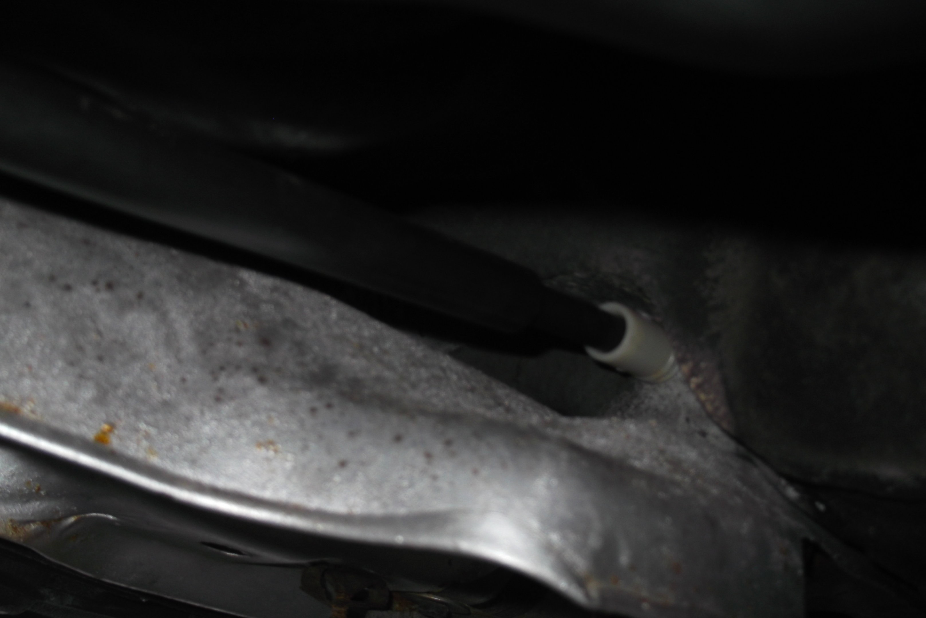

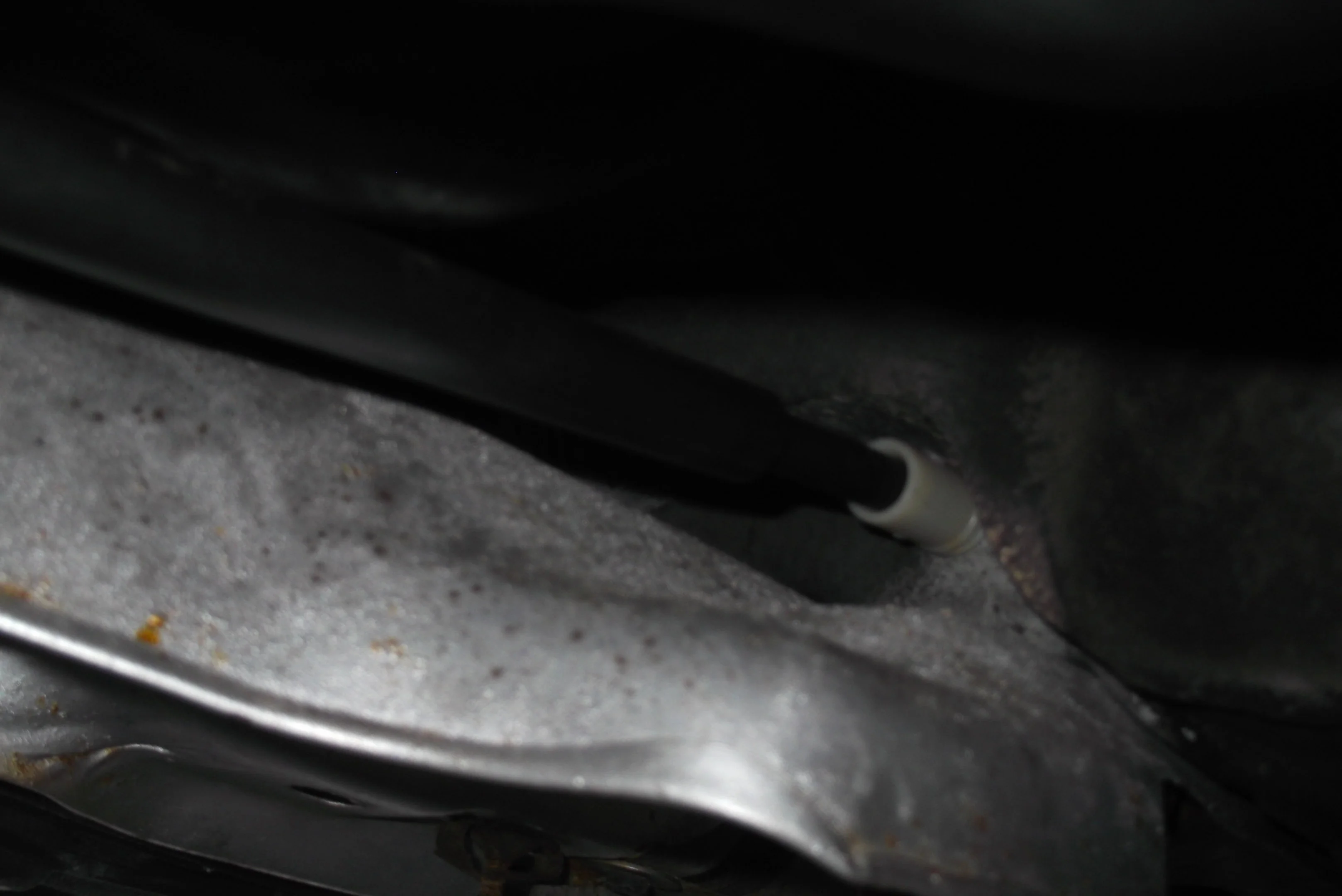

I much prefer the phase 2 clusters to be honest. I have seen a couple of owners post photos of the inside of the rear section of sill, so I thought I would take a look at mine. Poor photo but rust has a hold, will get some waxoyl on that which should slow it down a bit.
  Clio Williams
When you have so much rust you can trysome really hard specifics. Brunox or something similar. You put a whole bottle in atomizer and after brunox catch rust, you can put some wax etc
  phase 1 flamer 172
That's not so much rust, actually quite little. Anyway pulled the hand brake on, quite hard I will admit as I was in a hurry and "twang" broke a cable. possibly the 17 year old originals so replaced both. Photo shows not a lot.

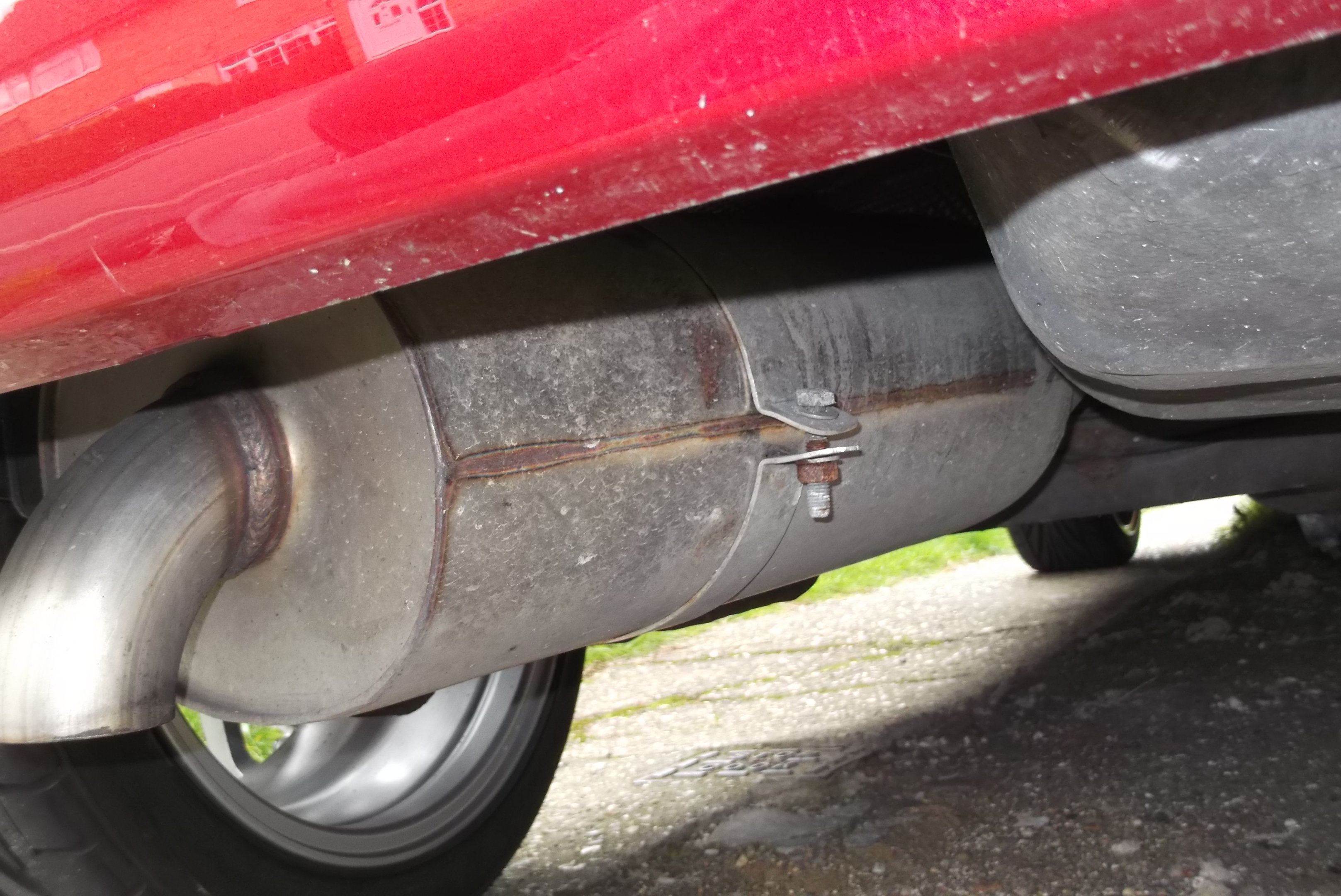

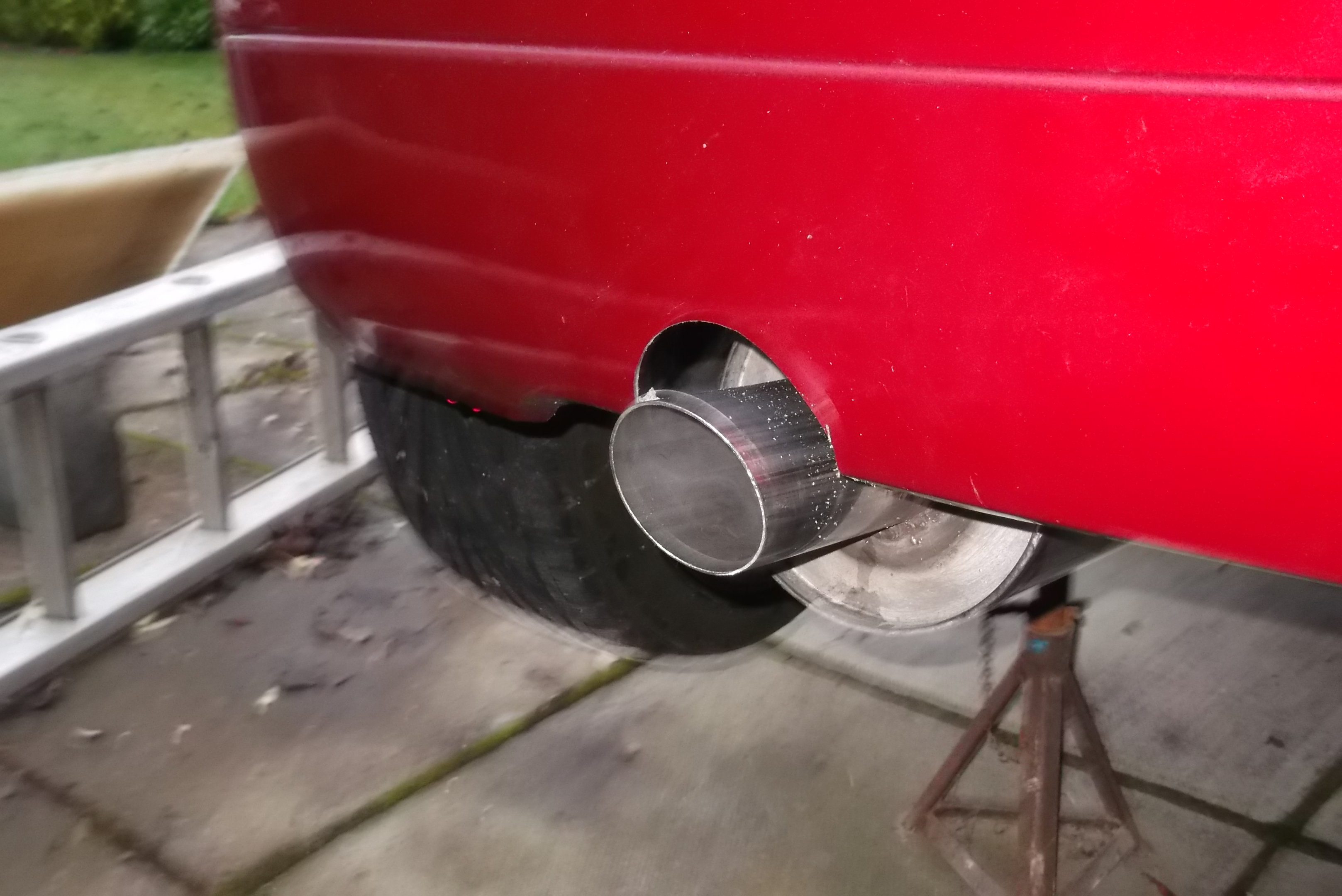

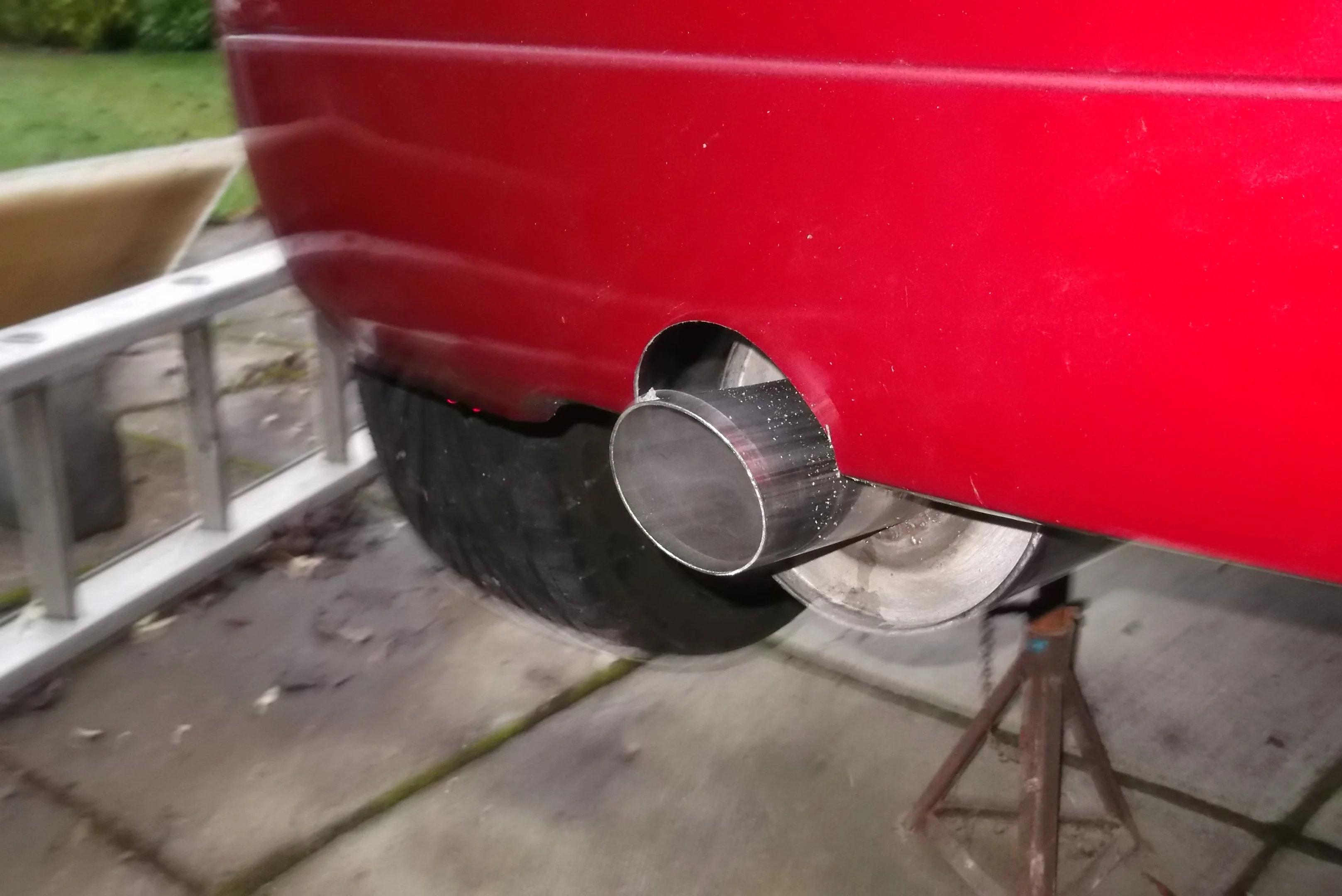

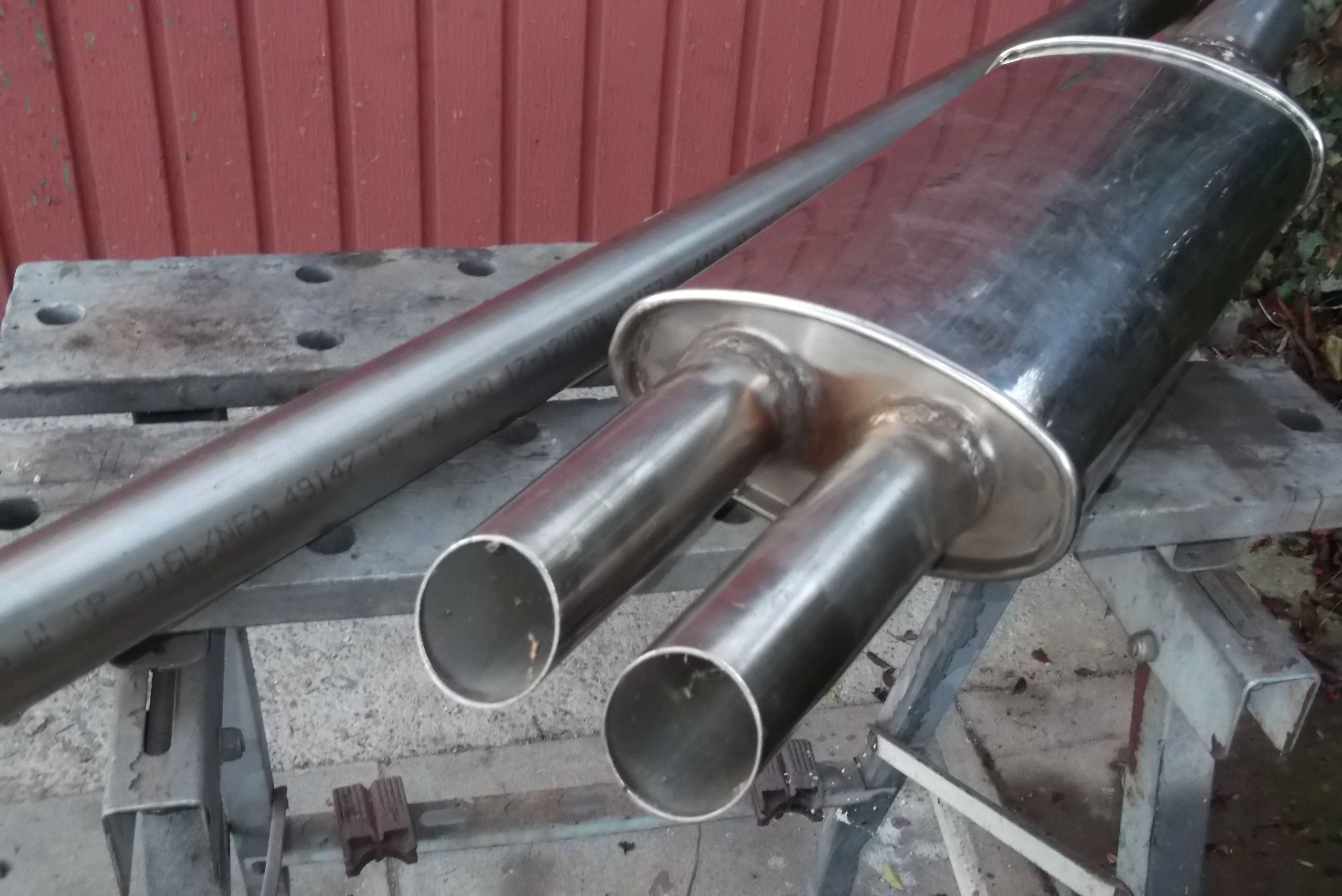

I cannot afford to run 2 cars, and have decided I would prefer to get my project/ modified mk1 golf on the road. So any turbo/throttle body/ long term ownership plans I had for the clio have gone. Also wanted to release some funds from it, so sold the superquiet k-tec exhaust, initial plans were to replace it with a used standard system, cheaply available on ebay. However this might only last maybe 6 months before it needed replacing and then I wouldn't be saving any money. But in my garage left over from a previous project I have 3 metres of 2 inch stainless and a ss box, so will attempt to make my own system for not much money, will need to purchase a couple of bends and another box to make a 2 box system.
  phase 1 flamer 172
Its done, not pretty but that wasn't a priority. So 2 box system, both straight through absorbtion type boxes, one large and one small. Dosnt sound too loud while blipping the throttle but yet to test drive it.
  phase 1 flamer 172
Test drove it today, noisier than the k-tec super quiet system I had, that was expected. Too noisy for me to be honest but as I don't commute in it or even use it everyday I can live with it, till it sells or gets broken, not for a while yet .

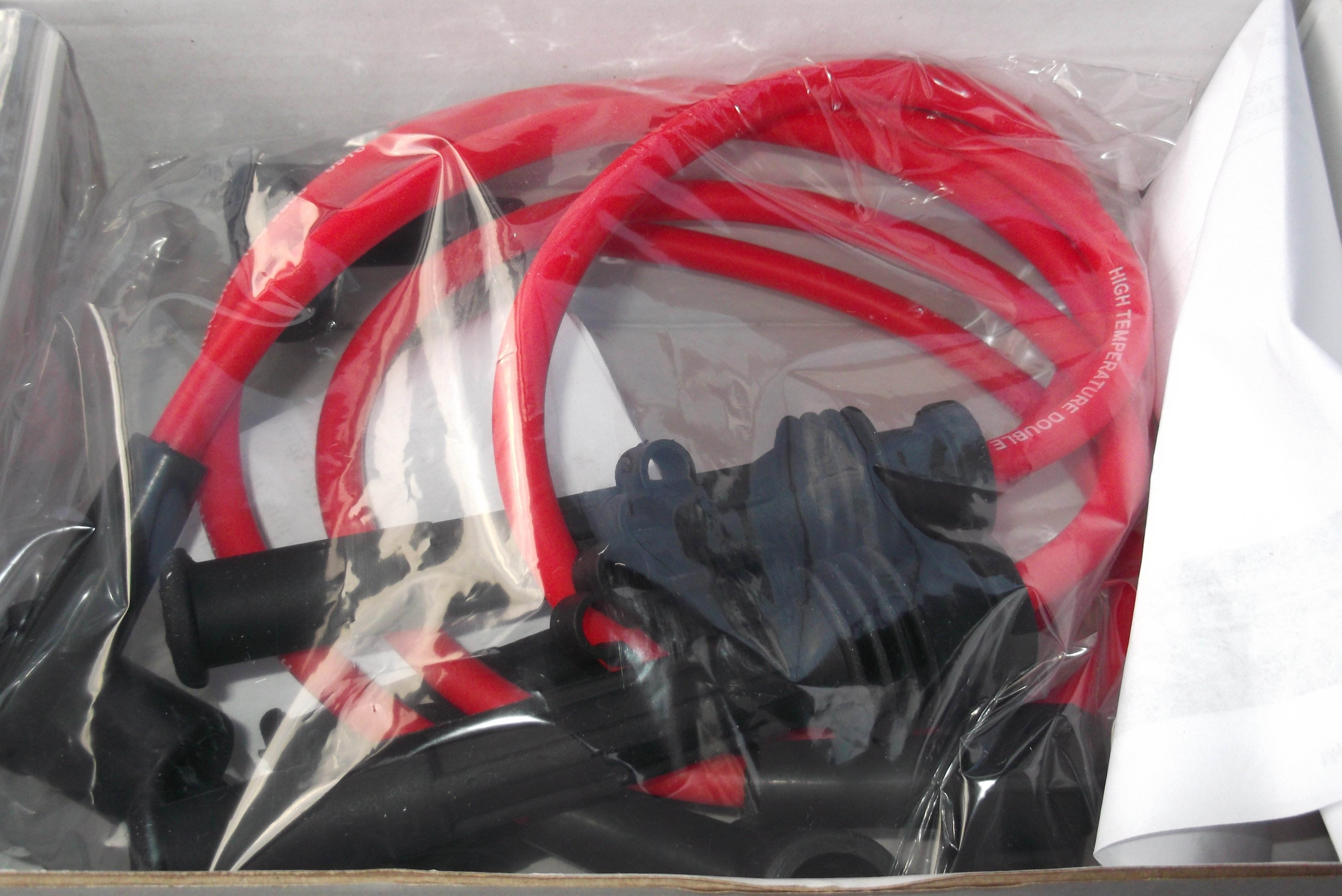

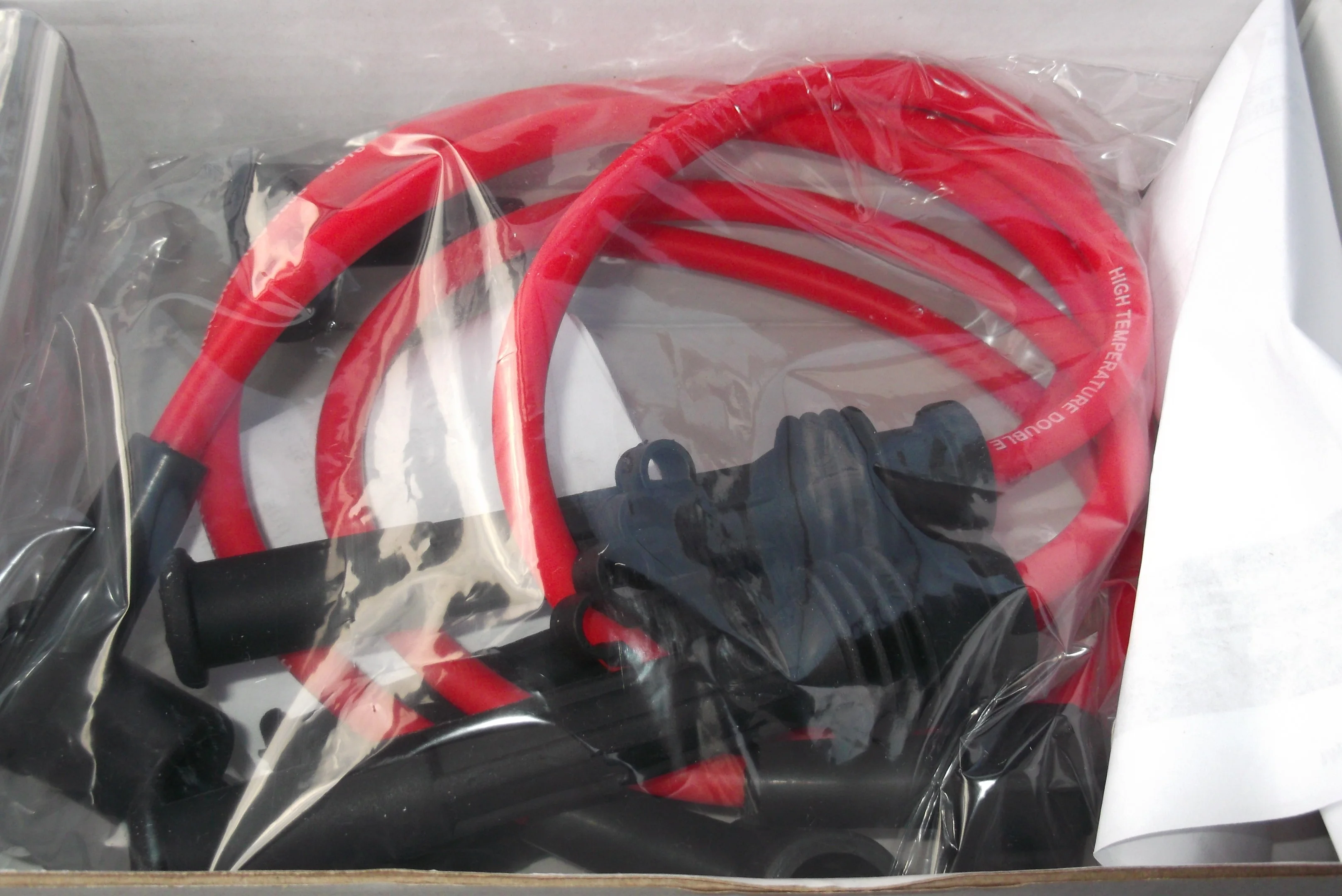

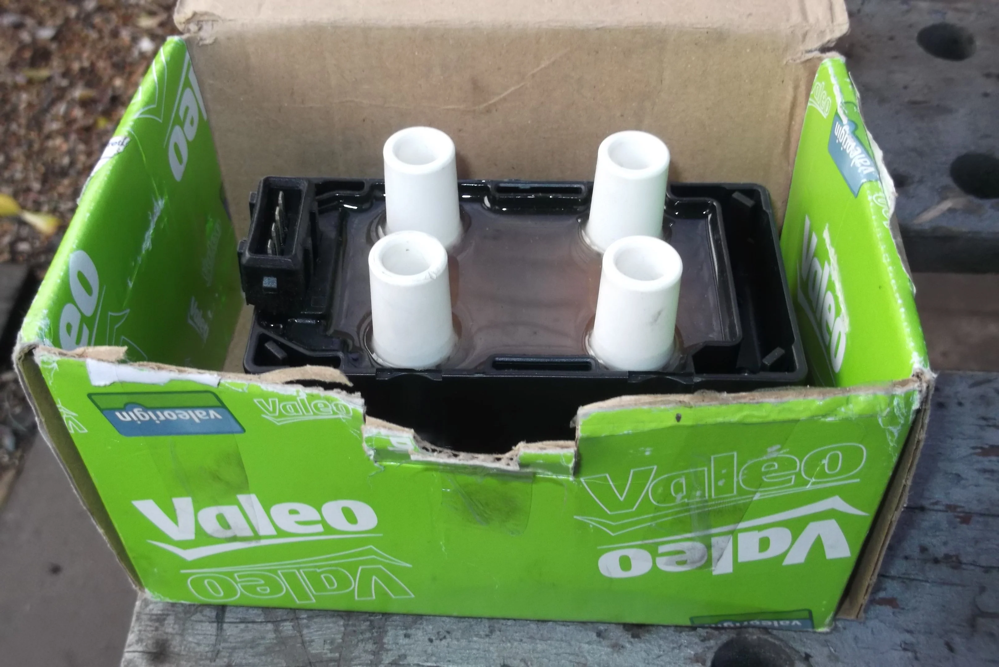

Werent sure how old the ht leads were, maybe original 17 year old items, so thought I would change them. Bought some pretty red ones which was a bit pointless as mostly hidden under the inlet manifold. While there be silly not to do the spark plugs even though I had fitted new ones not that many miles ago. Also had a new coil in my spares section so stuck that on as well.

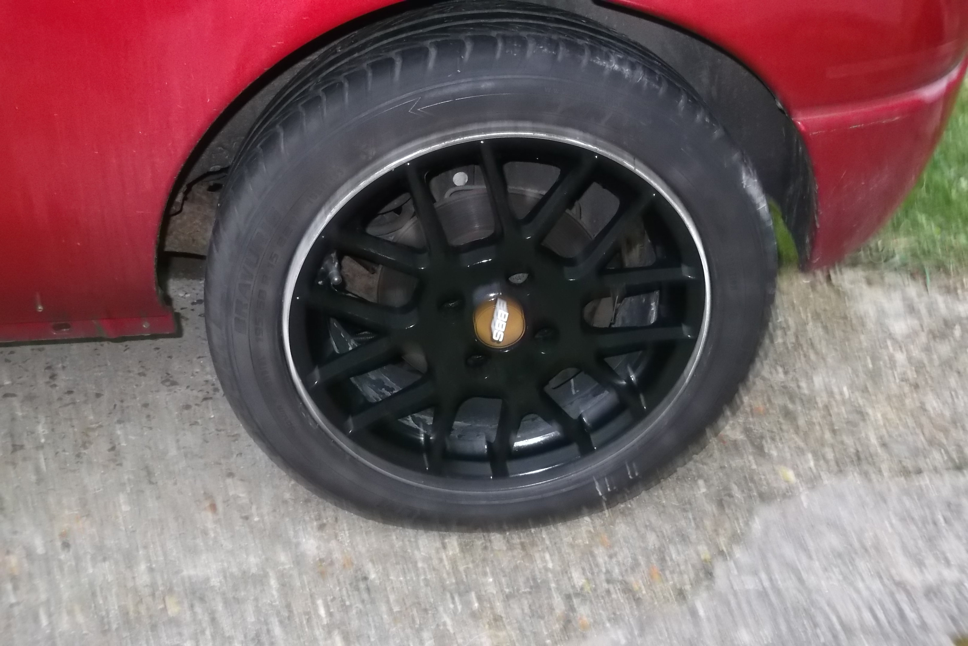

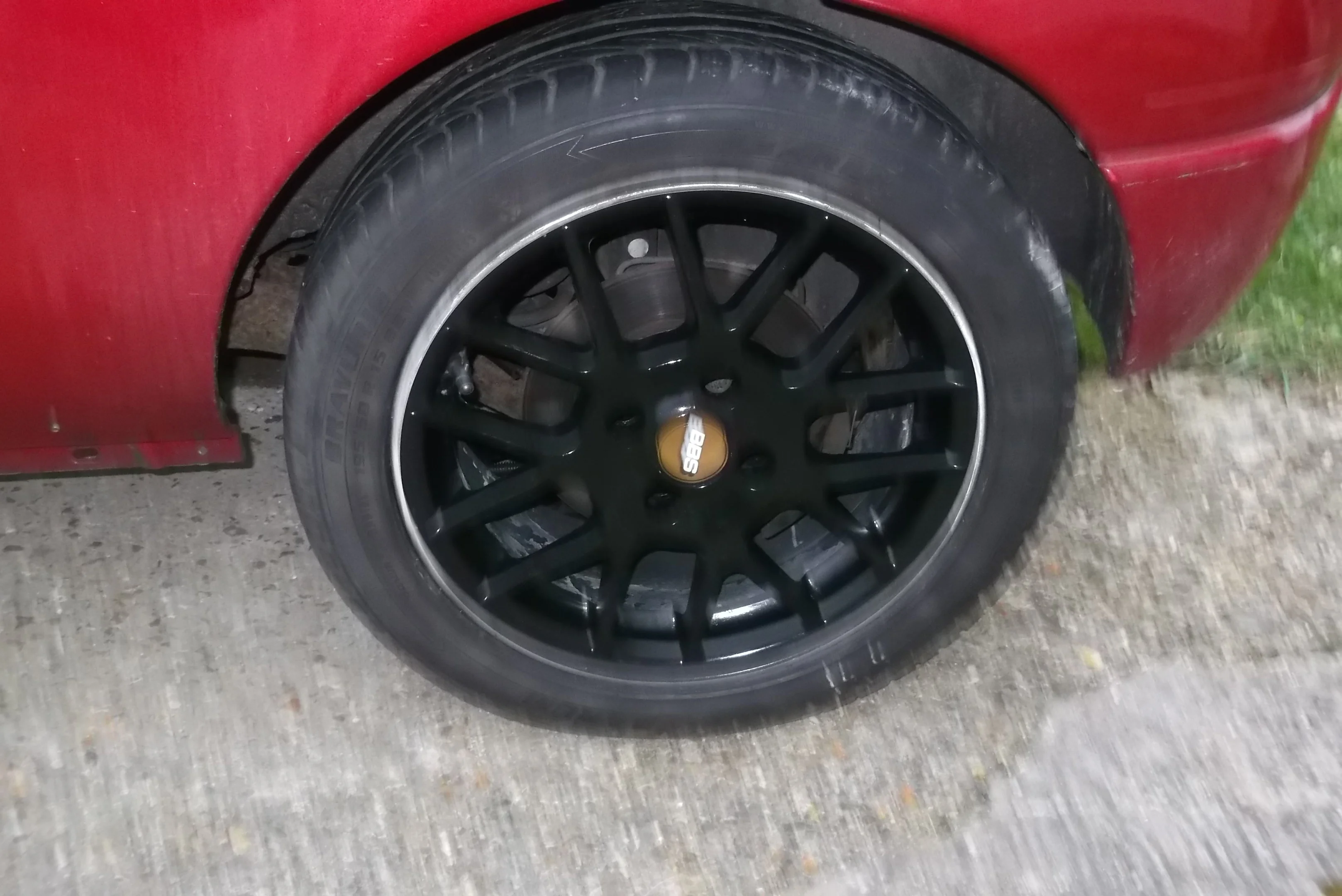

I sold the original wheels as I wanted to run 16 inchers, also wanted an et of around 38 to help fill the arch,s. The replacements I bought I now want to use on the golf so needed some more wheels. Got these, nothing special, certainly not the BBS the home made (not by me) centre caps proclaim them to be, but from memory not a million miles from the original design whose name escapes me.

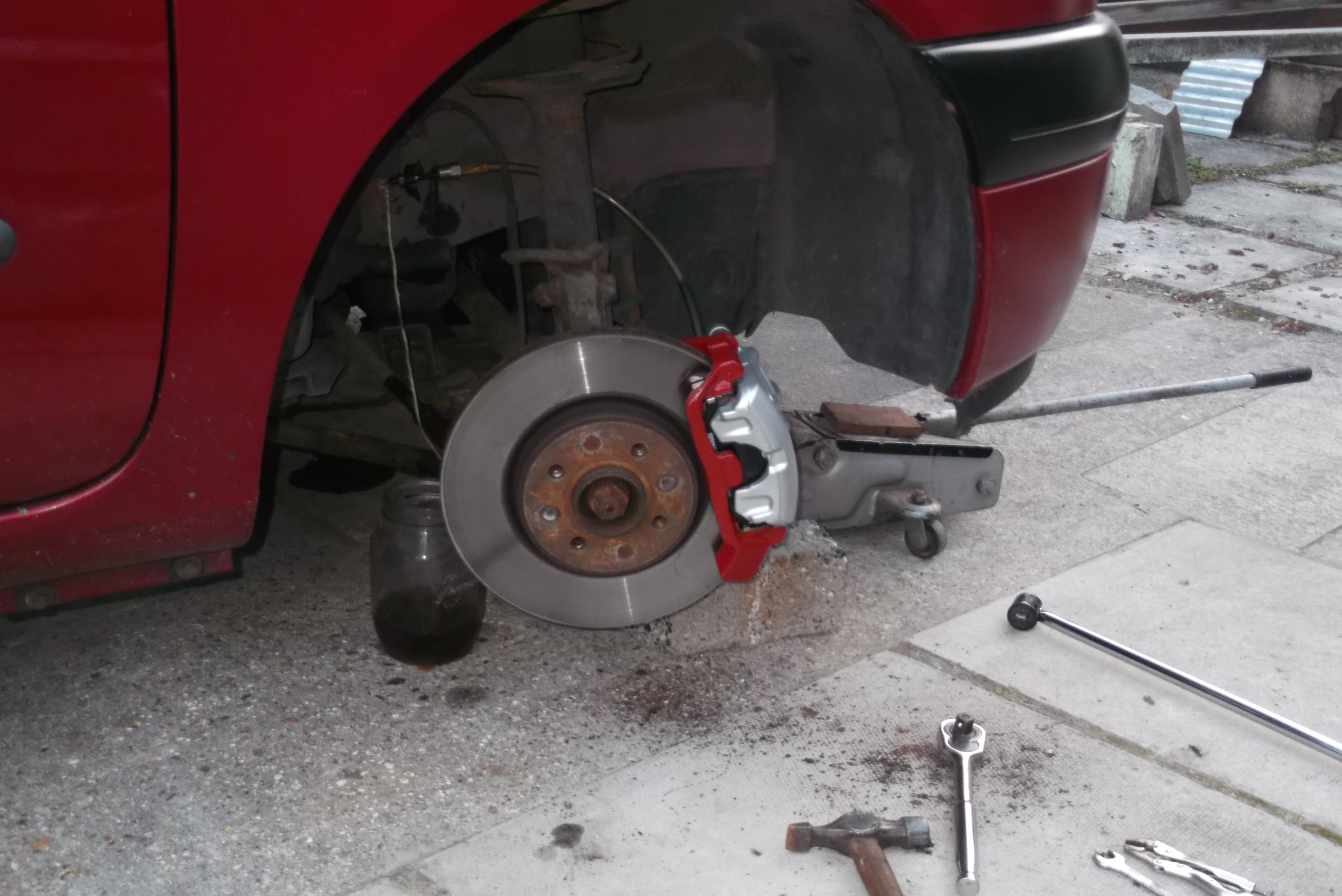

  phase 1 flamer 172

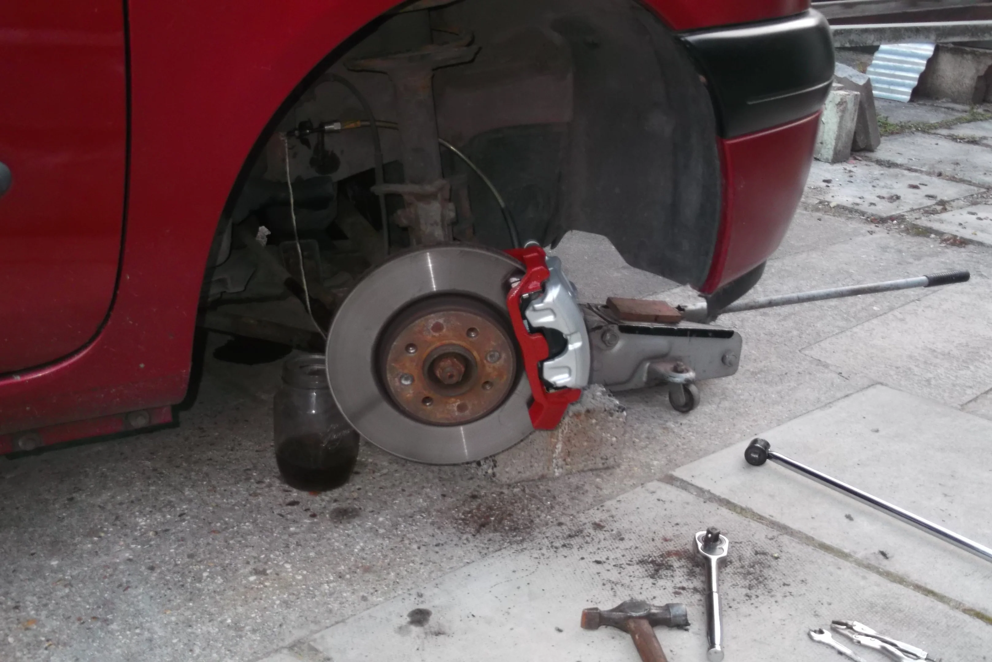

When i fitted new front discs i meant to fit some overhauled calipers ( taken back to shiny metal, new pistons and seals fitted) so i thopught its abot time i fitted them.
