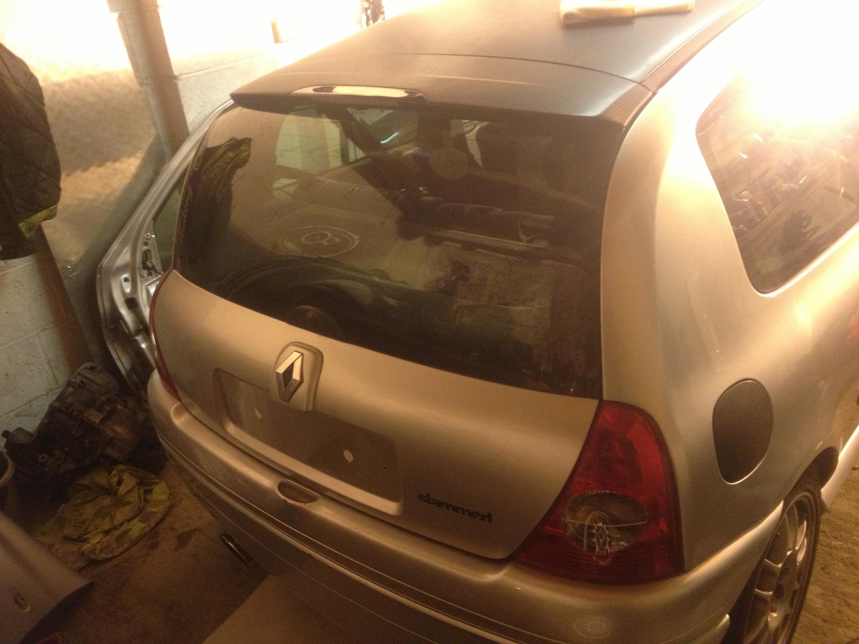

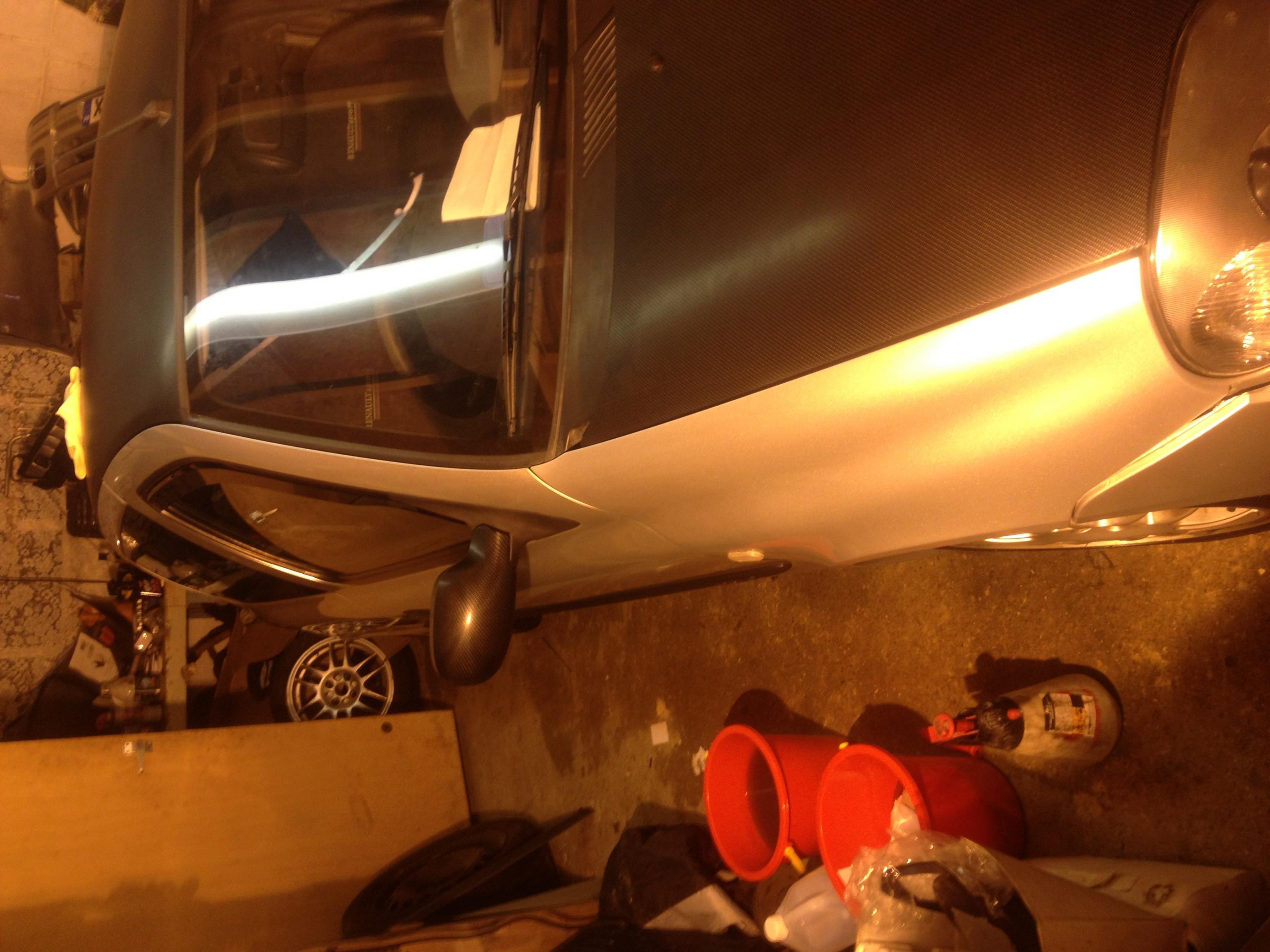

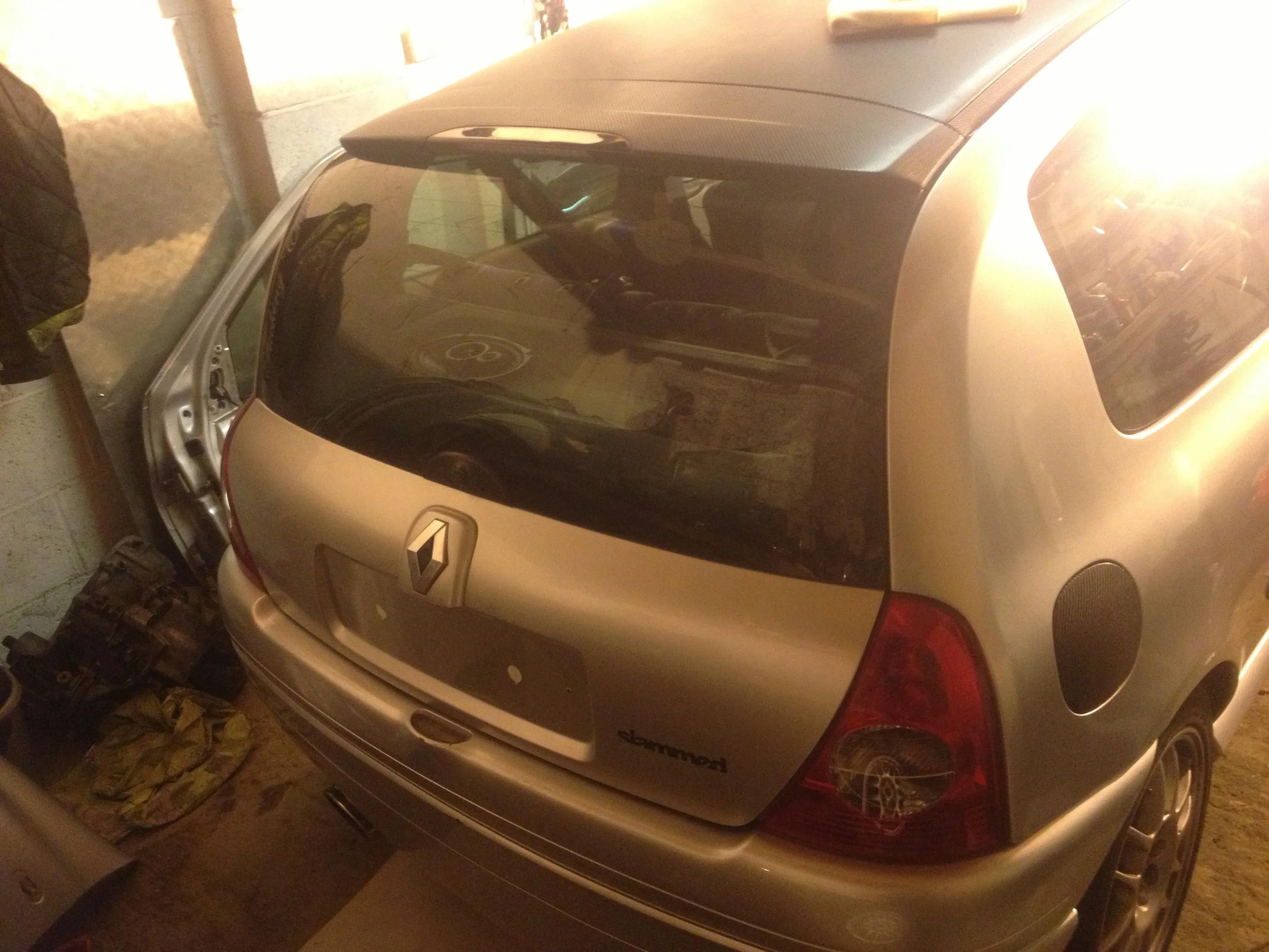

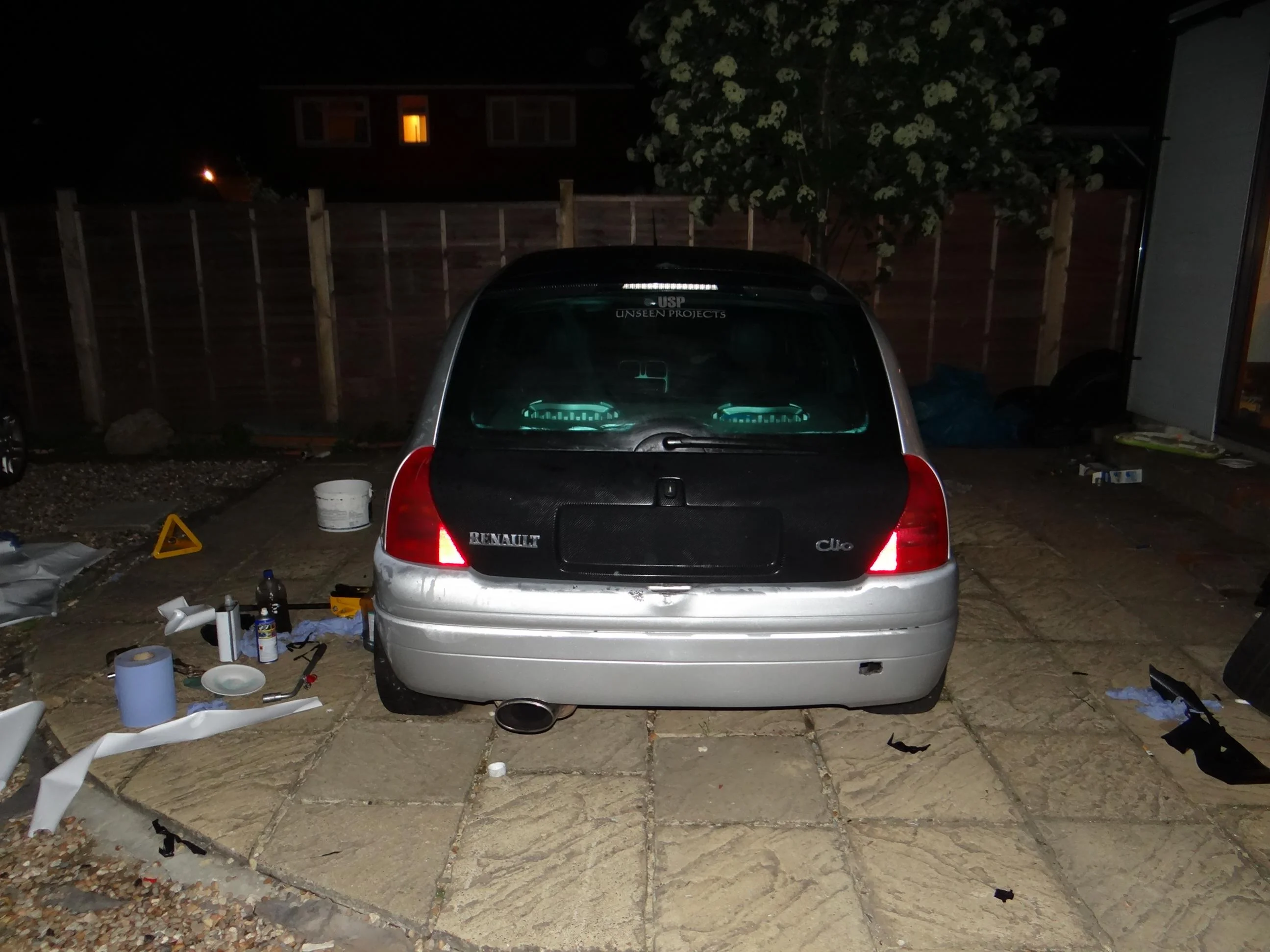

as you can see from the picture above i put a carbon wrap on a few bits to hide the really bad lacquer peel and faded paint

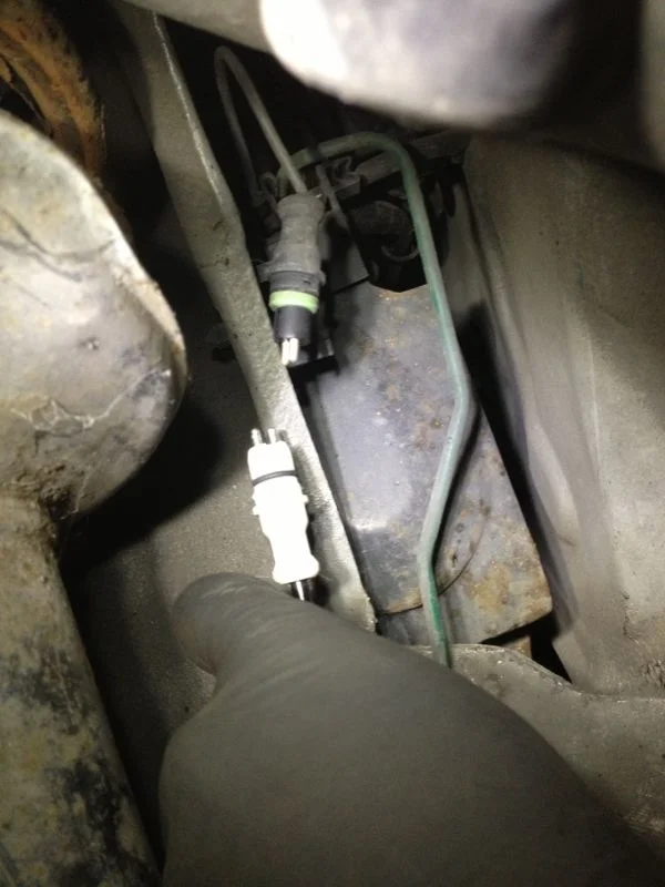

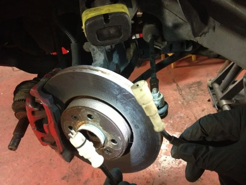

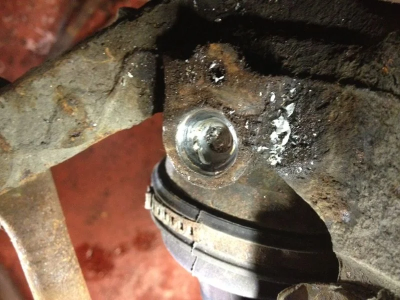

So i got the car mot'ed needed a few bits abs sensor, the exhaust emissions were really bad so a new abs sensor was fitted (right pain in the ar$e to get out)
As you can see in the second picture the abs sensor was the wrong one but the next day they replaced it with the right one
Thats better,

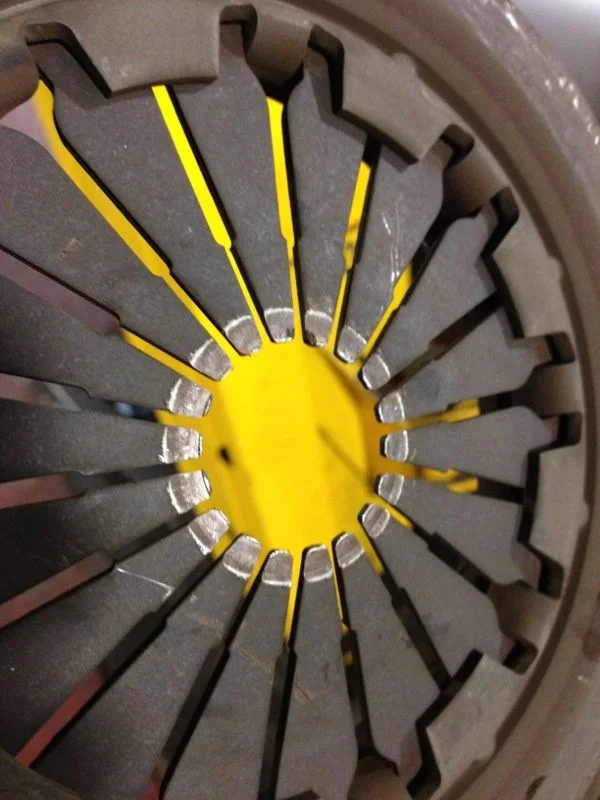

so i get a picture from the mechanic as he is doing the work clutch defiantly needed replacing
The fingers are nearly worn through! the next picture i received is the gearbox out on the floor with the dreaded cir clip hanging out, he decided to put the other box i bought from this forum in as it made sence, once the cir clips go your always waiting for it to pop again! and as far as gearboxes go this looked really clean! again i have pictures but it wont let me upload.

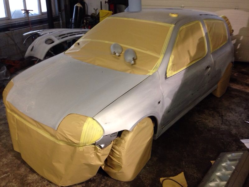

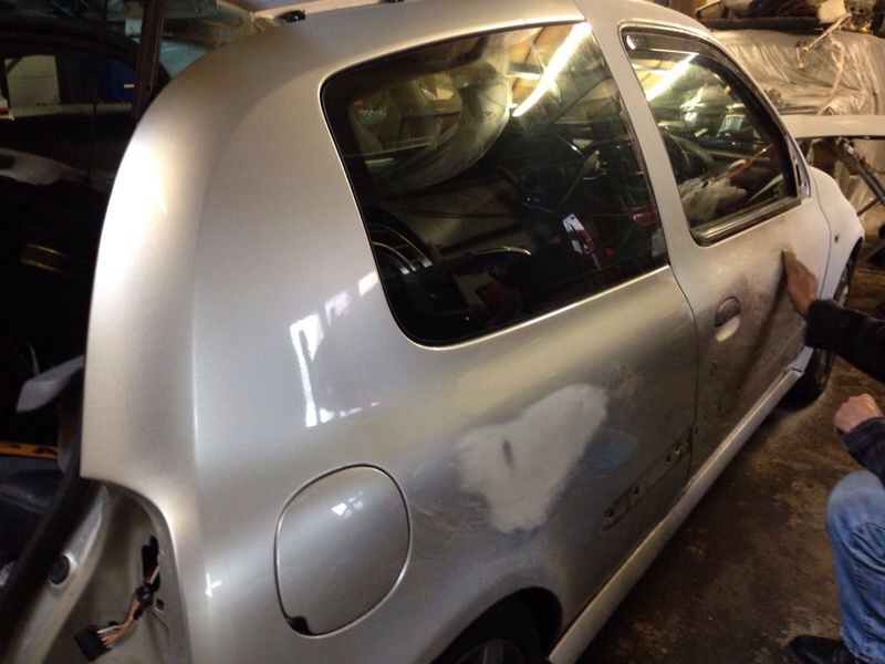

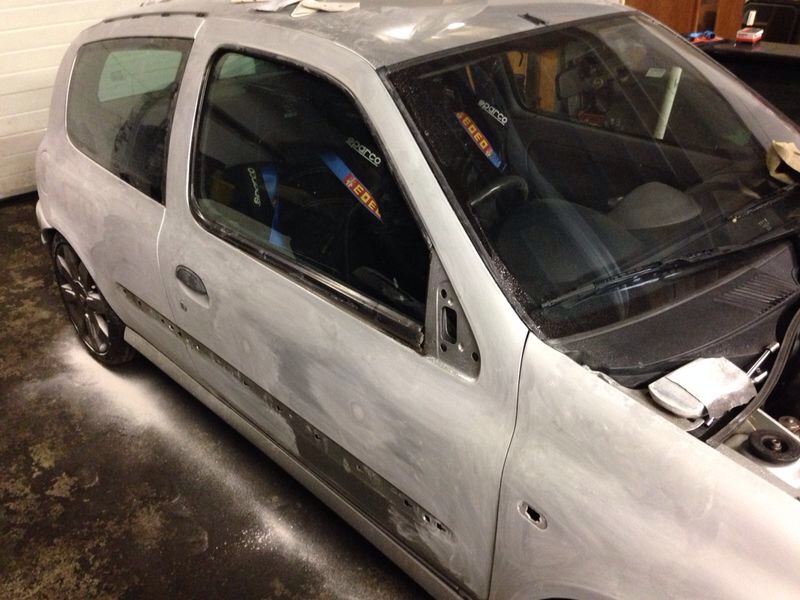

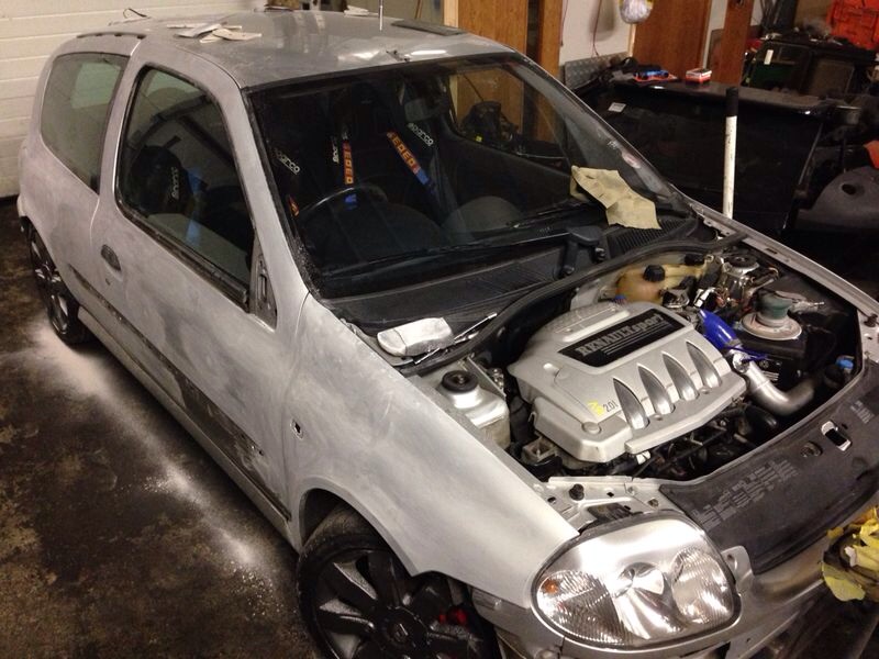

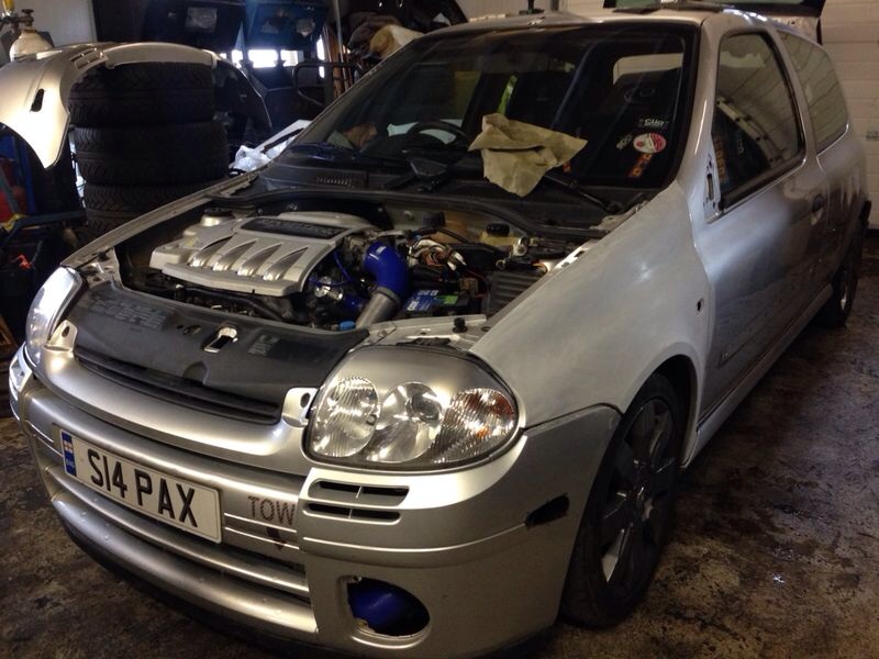

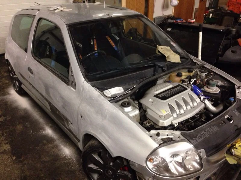

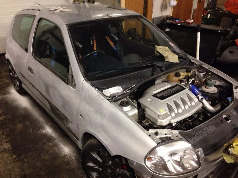

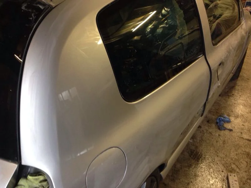

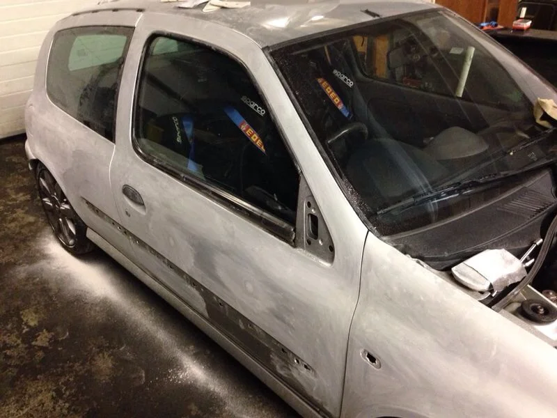

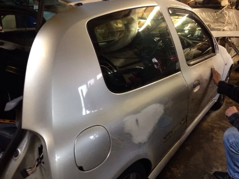

Done a few bits n bobs to the car the last couple of weekends. i managed to get hold of some better condition panels
so I fitted new wings doors and a phase 2 tailgate with phase 2 lights!

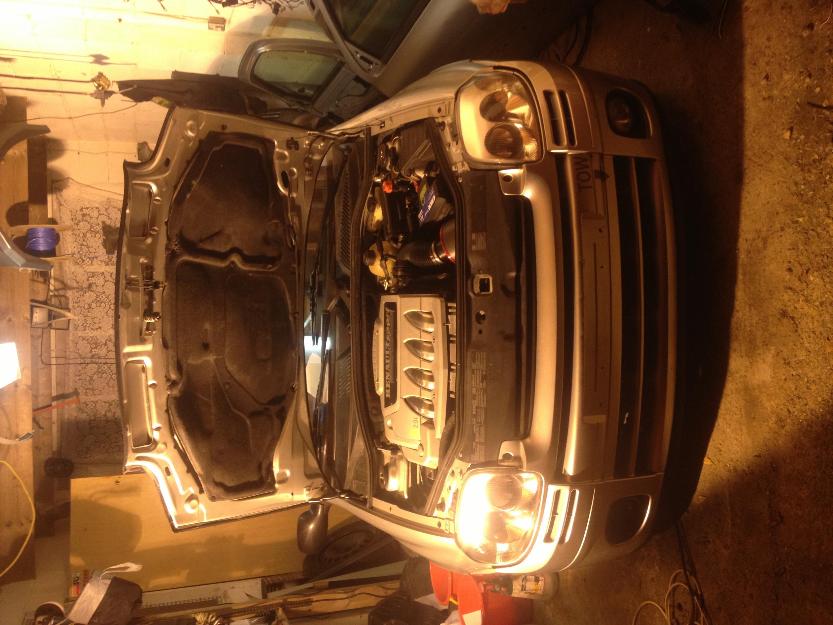

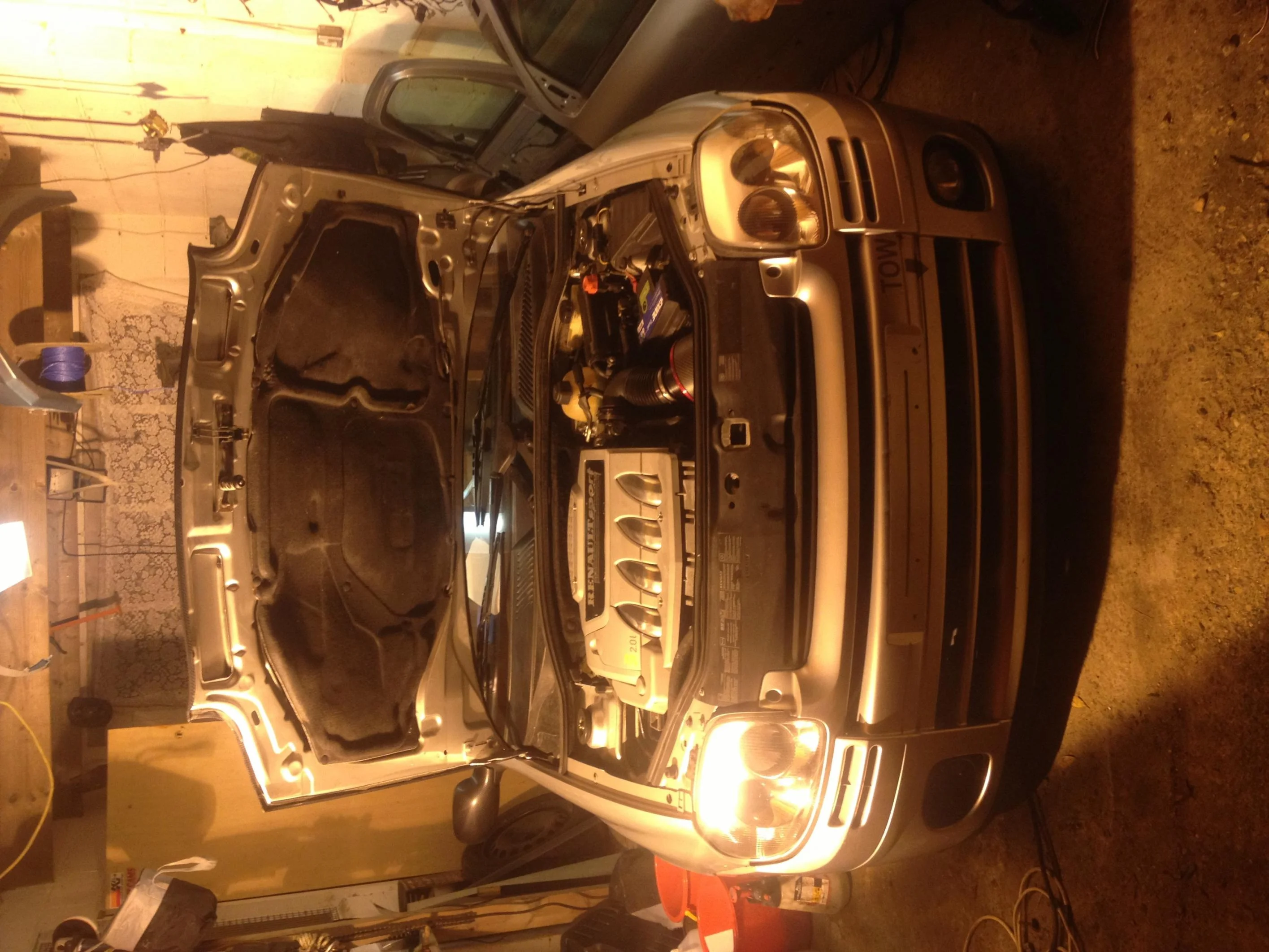

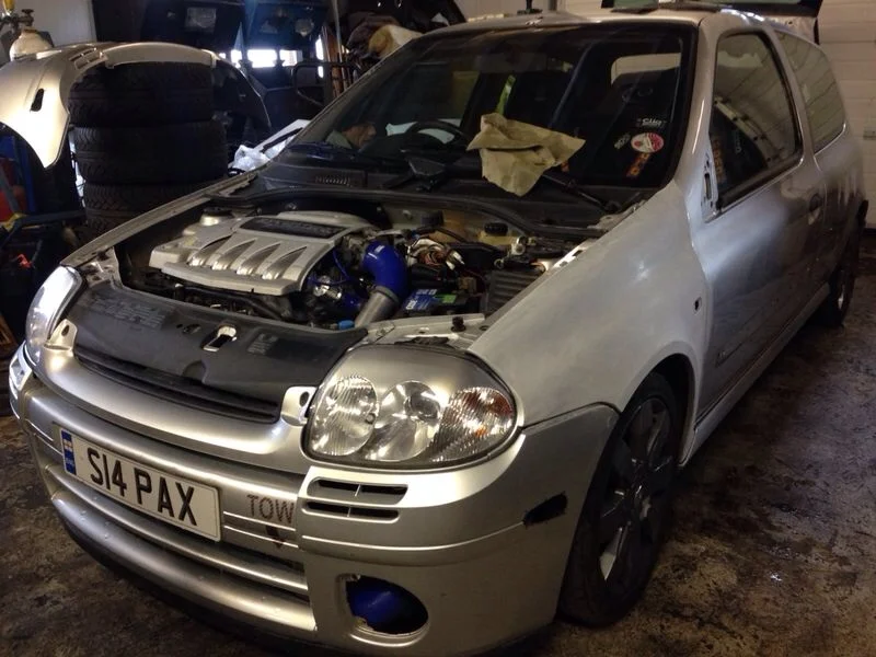

I've also bought a supercharger kit which is in the process of fitting! Once that's done and I get my funds back up il get it fully re painted! And get hold of some better alloys as I think one or two of my are buckled!
Oh and last little thing I've had my gearbox sent to agency transmissions to be refurbed as I didn't think there was much point in adding a load of bhp to an old jc5 box apparently he's going to mod the circlip to stop it from poping out!

The supercharger has been fitted a good few months now..... It's epic!

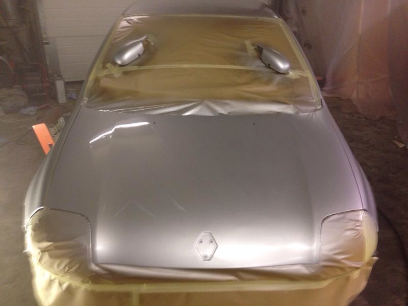

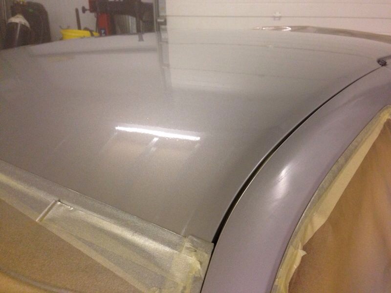

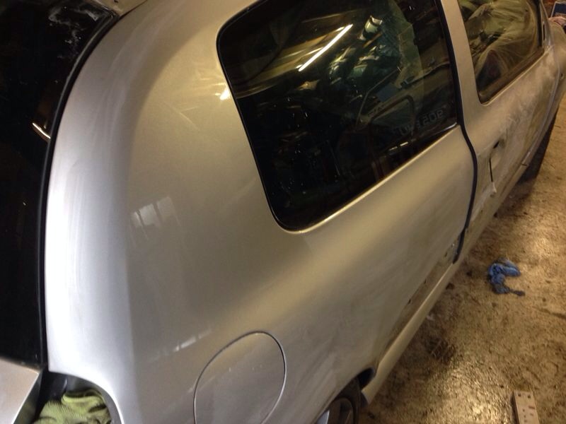

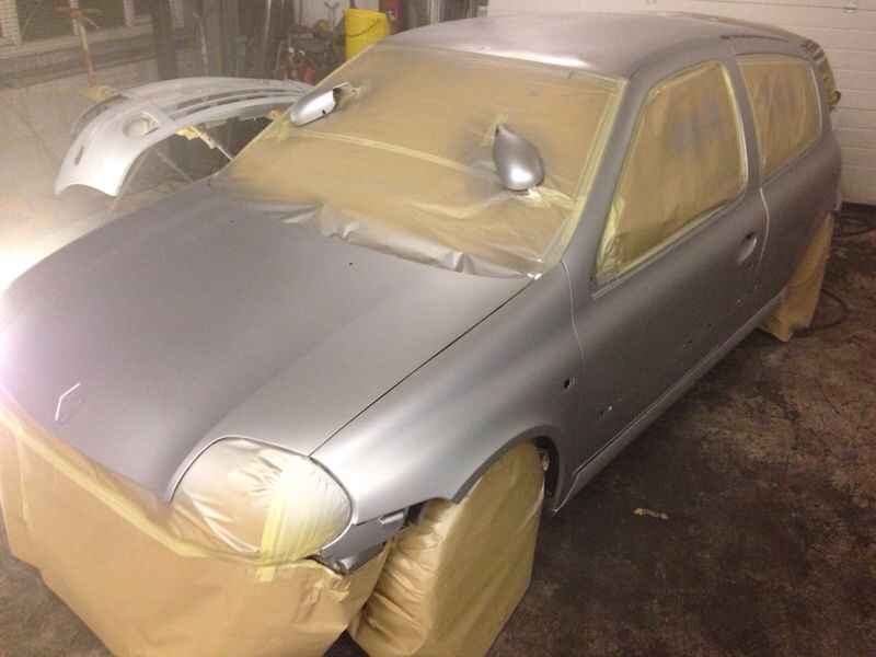

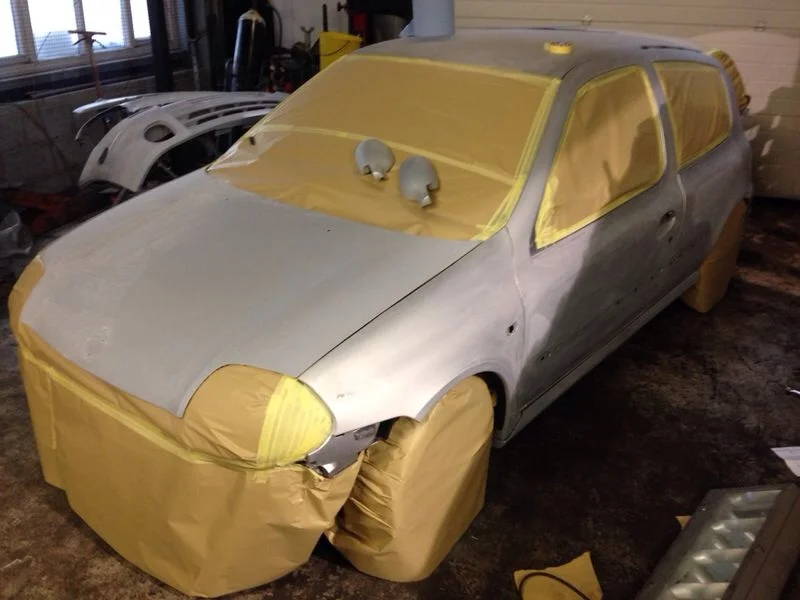

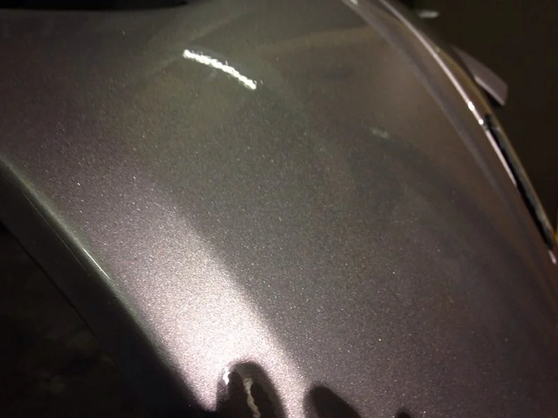

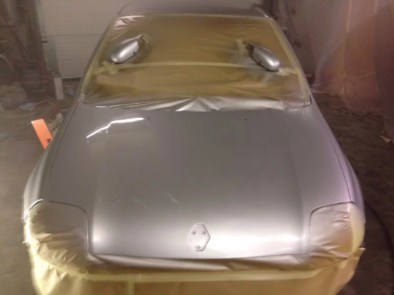

ive had a real good deal with the paint job, my old boss/friend owed me a few favours and done the whole paint job for 400 including returning all four alloys!
timmsy he is moving workshop ATM but I can ask for a price for you, he can also deliver and pickup for a price aswell.
I've had the door handles and side strips done to I Cnt wait to pick it up tonight

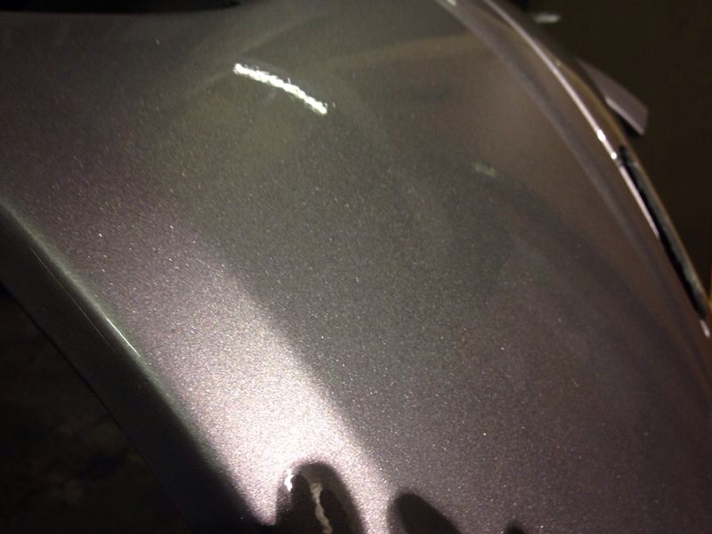

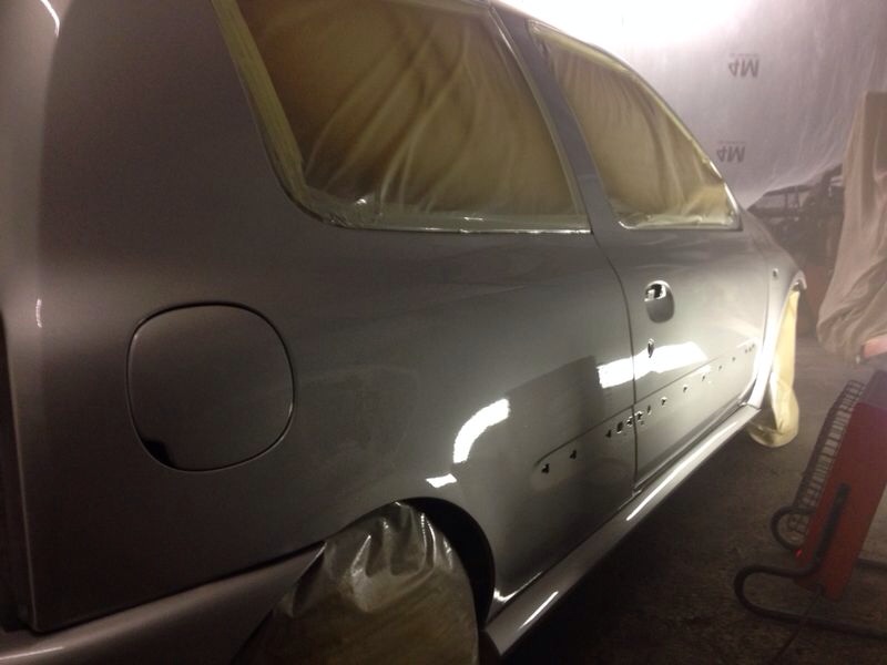

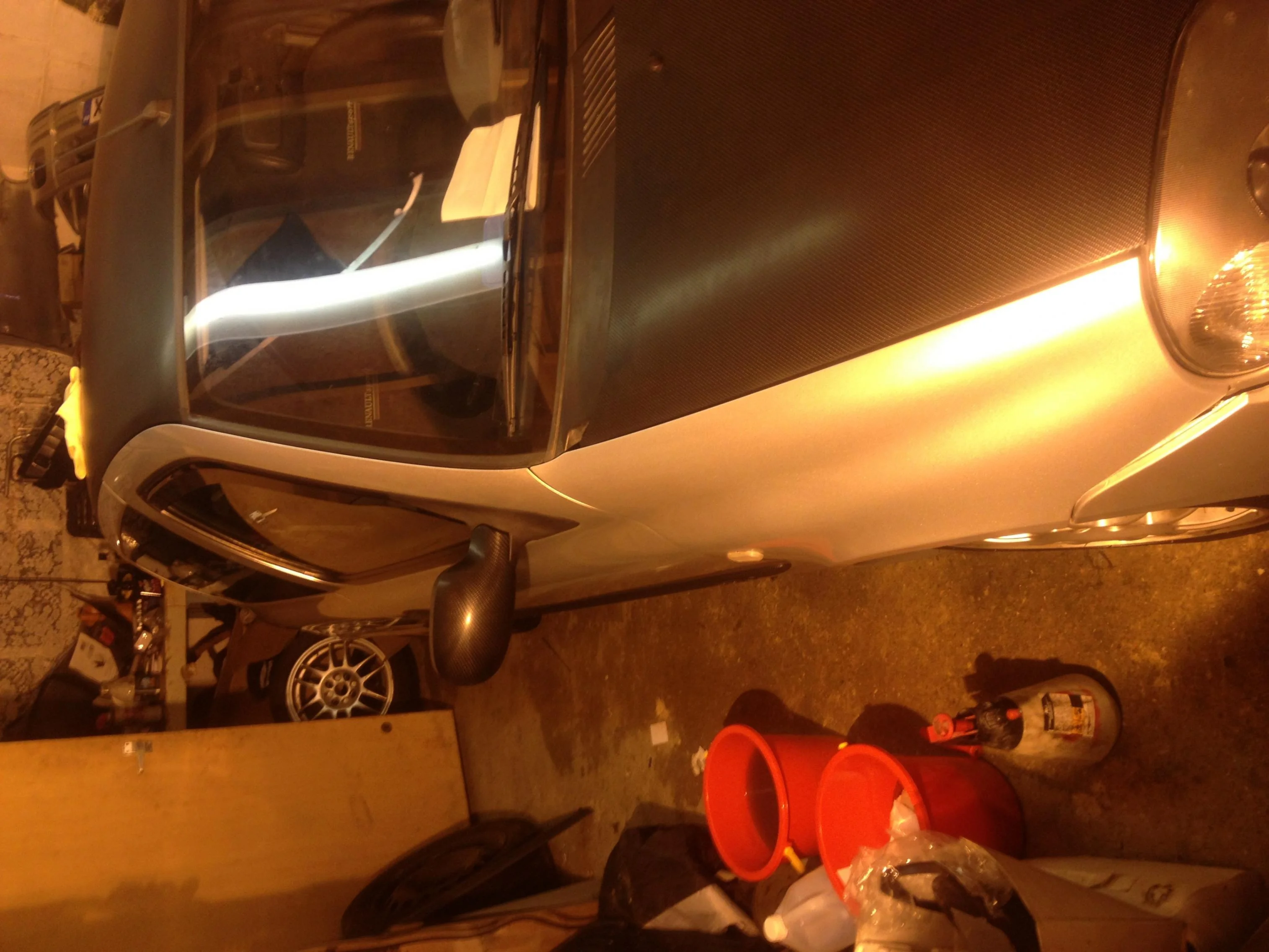

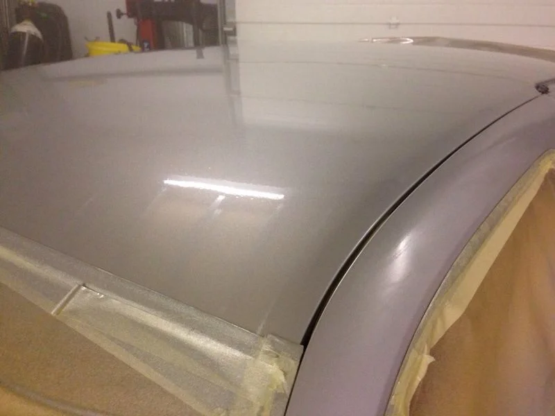

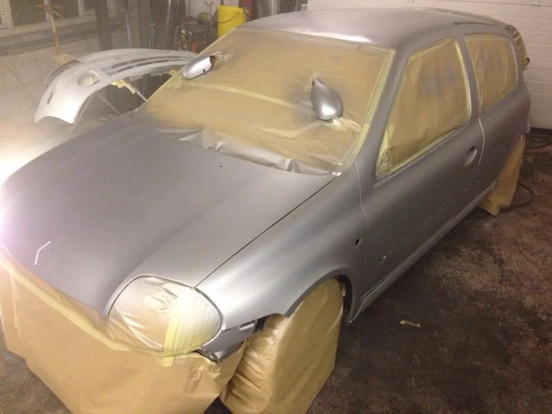

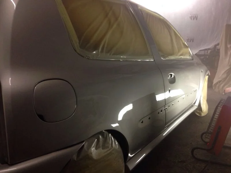

I haven't had it rr'd yet looking forward to seeing numbers! It's still being polished as we speak I have to pick it up at 8.30 tonight! Just received this picture paint looks lovely!
