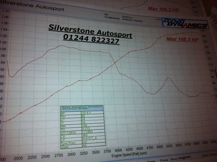

Stephen16vGSi Car RB 182 Cup Aug 4, 2011 #1 said its running mega lean.. all it has is a ghey&N indxction kit.. with 10 years abse its lost 6bhp.. what can i do to sort the lean issue out?
F Fred@BTM Car Lionel Richie Aug 4, 2011 #2 they never had 172bhp fella what are you doing at Silverstone when you live in liverpool? where's the AFR graph?
Stephen16vGSi Car RB 182 Cup Aug 4, 2011 #4 its a scooby specialist in north wales.. but see were the fuel line dips real bad, then it makes my power curve die.. how do i fix this?
R Russ_16v Car 53 Clio's & counting Aug 4, 2011 #5 Remap, or find out if anything is causing a fueling issue (lambda probe, cts etc) About right power for a standard ish car

RSTuning ClioSport Club Member Car R35 GTR Aug 5, 2011 #11 Thats not lean, it's normal in closed loop as there's a delay till OL
Silent_Scone Car Evo 5 RS Aug 5, 2011 #12 166hp isn't bad at all. I had all my pops and bangs mapped out, got on my tits after awhile
mike1pow Car 182 cup Aug 5, 2011 #13 I made 169 Silverstone, with K&N cone and Group N map so not a bad result
