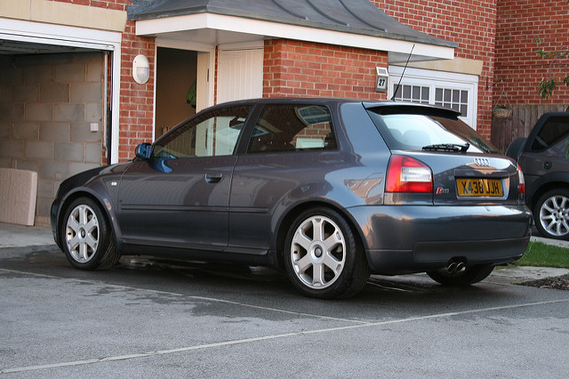

My S3

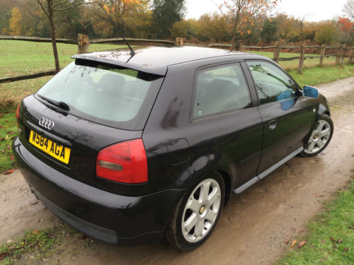

Ive wanted one of these for a while, ever since having my first A3 1.8T around 2 years ago, With winter here and snow inevitable it made perfect sense to get something 4wd, so what better excuse did i need ?

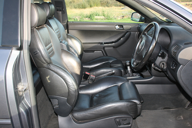

Its a pre face lift with the APY engine, 210bhp, just a couple pics atm, and unfortunately no interior pic (i will get one tomorrow)
its a great car with a brilliant interior, however atm it doesnt drive very nice, a previous owner has fitted coilovers and not had it set up correctly or the tracking done and it wonders all over the place, i also believe the bottom arm bushed have had it (very common on Audis and VW's)
Tomorrow i will have a look at the suspension as i have a sneaky suspicion its on cheap ebay crap, If it is i will buy some new stuff, along with new bushes if i need them
Mrs also wants me to get the face lift rear lights but i quite like the ones on it tbh!

Not getting on with mine, scanned with vagcom and came up with maf sensor and temp sensor, so both changed for genuine items and now no engine faults, however the 4wd isnt working, today i got under it to check the rear haldex plug as this can get corroded but its fine, the earth strap is fine to, so its probably the controller or pump both are expensive.
Along with that it doesnt drive very nice, the suspension needs a proper set up, its on FK coilovers and the tracking is out, it drags around on bumps/pot holes, i dont think im going to keep this car long, going to change the haldex controller and or pump then sell it i think.

It's a heavy car on cheap coil overs that are not set-up. I think that's your problem. I would have my car too if it droves like a bag of s**t.
Raise, track rod ends, bushes and FRSU.

How didnt you notice Haldex not working? Or has it just broken? Cheap to sort with second hand parts.
Sounds like a bit of a lemon tbh.
Sorry Midge, but have to agree - thing sounds like a lemon. But surprised you bought it without doing all the above checks first?!
I love my S3! Its only got 48k on it though, so literally like new! FK coil overs are known to be pretty horrendous for comfort purposes.
Mines around 270bhp, and feels great. PS snow time is the best time!
Get yourself a haldex blue controller and then tell me its boring…..
Try a quick haldex oil and filter service midge, might sort it out.
Tricky to do without the proper filter tool though.
If it feels like the back end is skipping whilst cornering slowly, then chances are the clutch packs are shafted. Can't even remember how many haldex issues I had, it had always been serviced on time too.

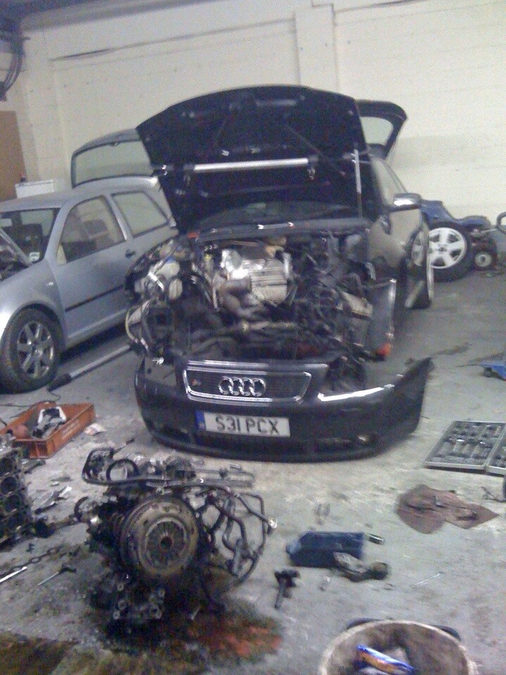

An engine, a gear box/transfer box.. s**t load of electrical issues and again all mostly common faults ..
Oil L piece killed the first engine and bottom end - common 20v problem worst designed pick up pipe I've ever seen..!!

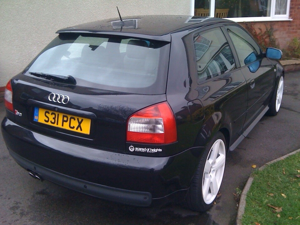

In the end it was practically a new car with a built engine.. JE pistons, scat rods, arp kit, aftermarket HG, hybrid turbo flowed head etc was running 280-290.. But by that time it had bled me dry and I lost the love for it..
