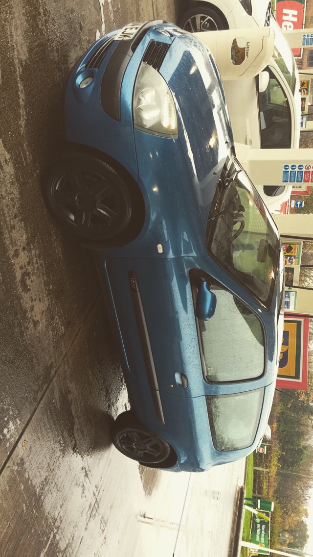

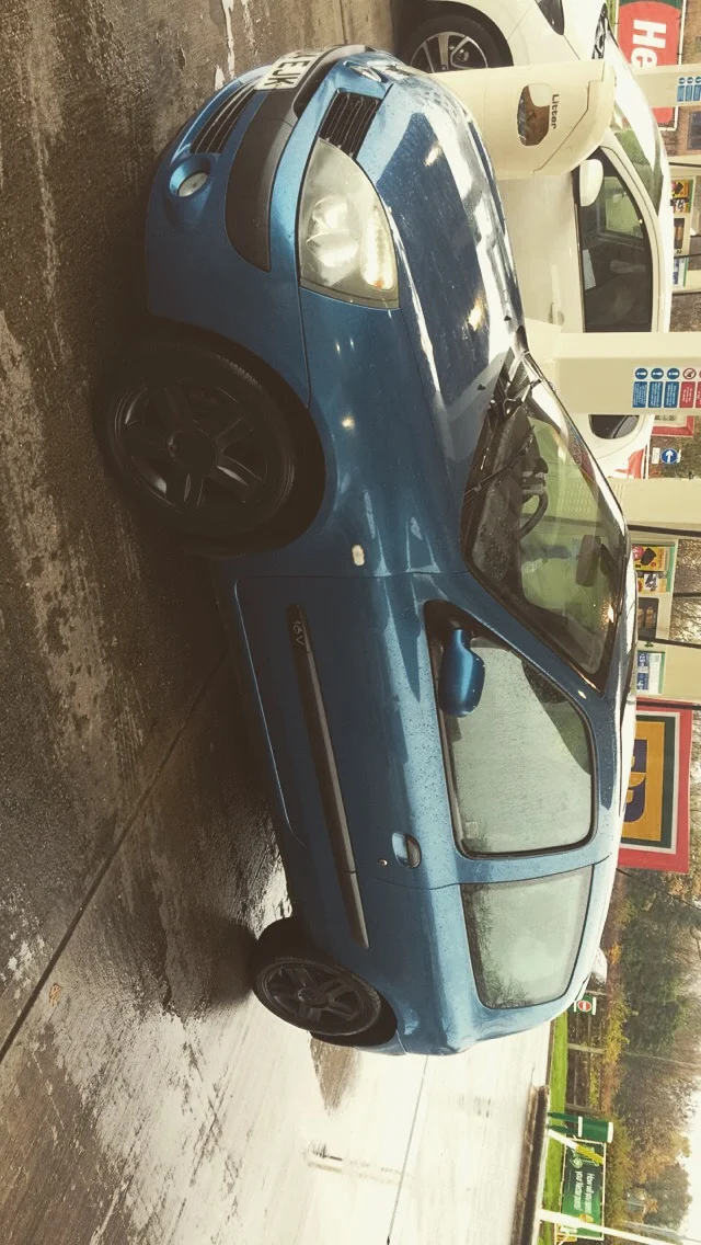

Hi all I'm new to this and would like some advice.

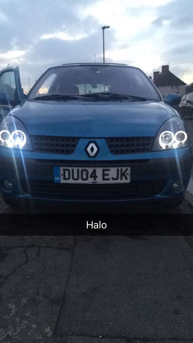

Not too long ago I got myself a 1.2 Clio mk2 in blue and because it's my first car I wanna change bits and bobs. Obviously because my insurance companie is a turd, I carnt change anything drastic like exhaust etc... So far I got myself the sport steering wheel, full sound system (no sub yet), halo headlights, and got the 5 spoke alloys re done satin black...
My next plans are;
Wind deflectors
Getting the Renault badges black ( can I buy new badges or do I have to spray them)
A 172/182 grill (still carnt find one after searching for a while)
So just wondering if any you guys had some advice for what I could do. Thanks image.jpeg

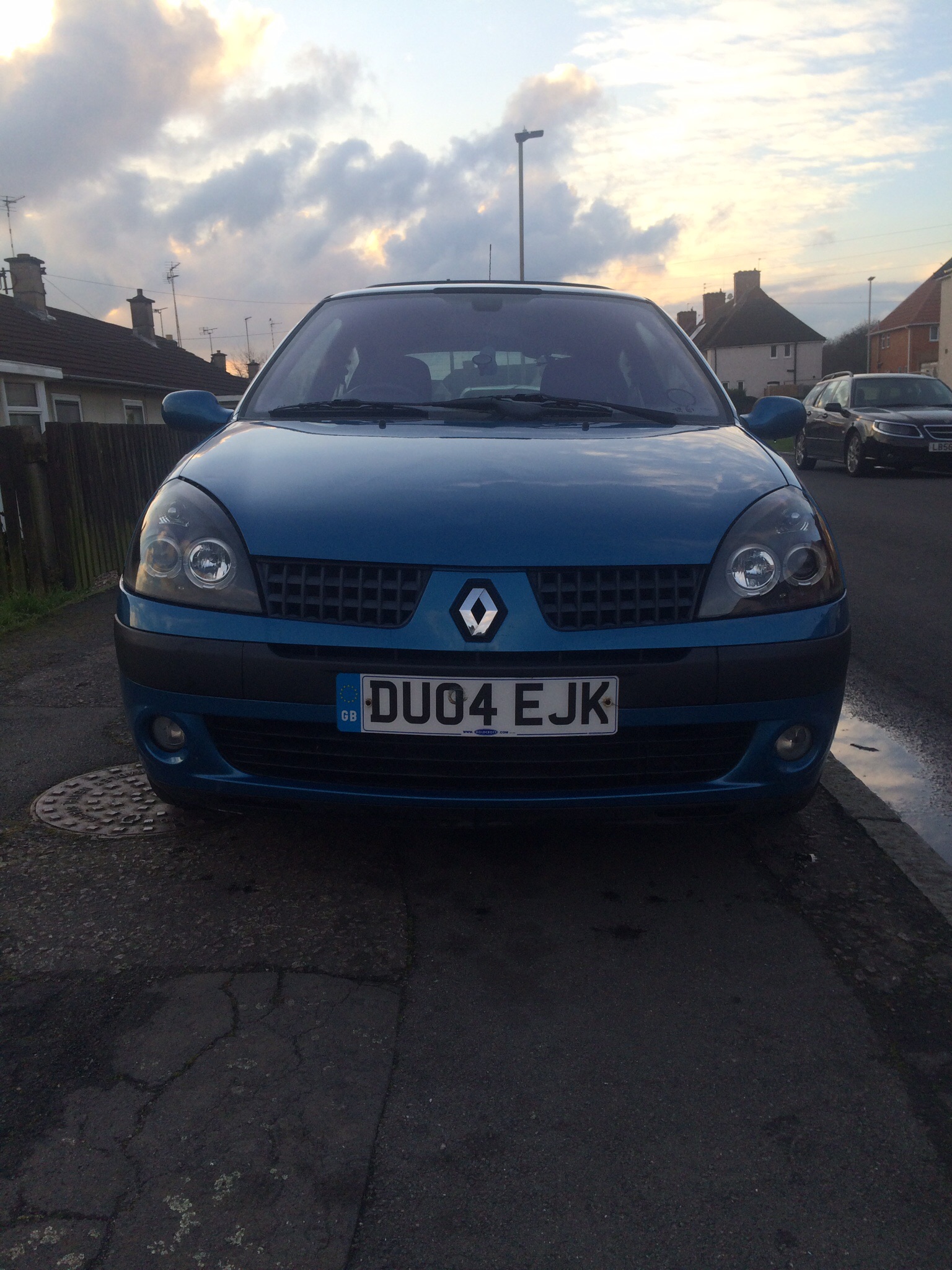

*Update
After dealing with a nice rusty snapped bolt under the bumper I finally got it off. Headlights look so much better now they ain't covered in tape.
Shame the grills a bit grey but come summer I'll do that satin black.
Also took it for a wash and straight after my whole interior light started leaking through with water and I've been having problems with the roof passenger side being wet. Gonna have to get new roof lining trim soon before it gets outta hand....
Also any advice on how to get the Renault diamond black??
Sunroof problems are common, firstly check the drains are clear in the sunroof, they are holes I'm the front corners of the sunroof - you will need to pop the glass out to check properly.
If they are clear, then you will probably need a new seal kit fitting. Think they are just over £200 but it will be dry as a bone then.
Then get some nice new number plates and screws to make that look fresh too.
