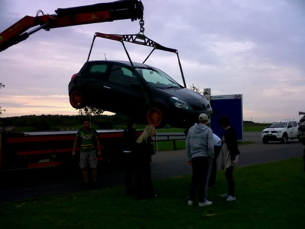

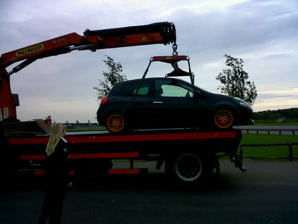

Being lifted out of silverstone

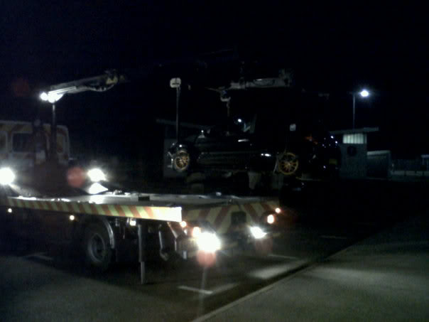

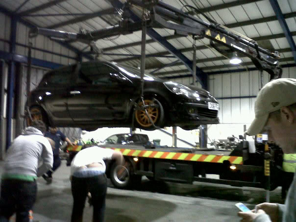

on the back of a recovery truck 3 hours later :(

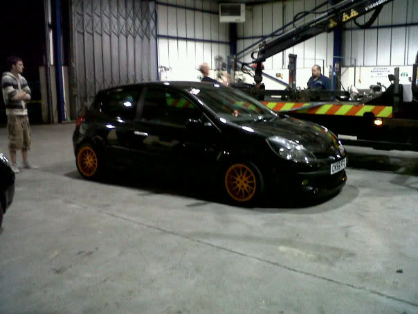

On the way in to the recovery depot

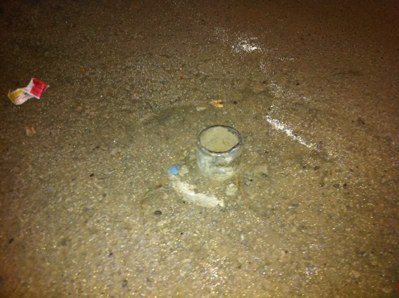

and one of the many things that caused the damage

Its got to be down to them, if people where not so bloody lazy they should have cut the post off flush

* photos of the tunnel- taken at an angle to show how much those hand rails stick up

Is the pic deceiving? As that piece of metal looks about an inch off the ground. How low is your car?

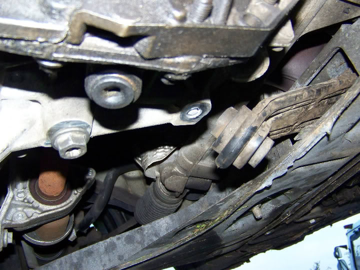

I was sat with Seb through all this. I will put some pics up of the gearbox mount later and the odd thing is asoon as Seb came out of the tunnel exit they closed it instantly. Didn't get back till 3am lol but hope u get it sorted dude, will pop round tomoro

Oh ok, i thought it may have torn off the mount itself, so thats not too bad.

no but it is bent to buggery, and in the second pic just behind it theres a tear in the subframe and i dont even wanna know what damage has been done to the exhaust, will see when i get it back.
Edit: also in the second picture theres a bolt just sitting there thats half out, lord knows whats meant to be there but theres nothing at the moment.

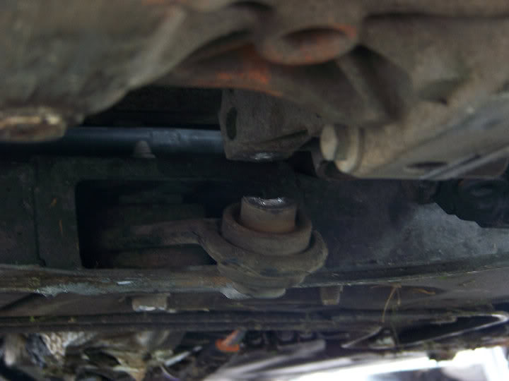

The gearbox mount may be useable.... maybe not, not too sure yet it is pretty damn bent, the bolts sheered off inside the box, but hopefully it will come out, then theres a nice crease in part of the chassis and the subframe has a bit of a tear.

You're only problems "sofaboy" is going to be getting that old thread out, but a bolt extractor should do the job.
Have you actually f**ked anything? Or is it just a case of replacing that mount?
EDIT: Just seen the above, I'd get a new dogbone mount mate, won't be expensive, new bolt, and a stud extractor kit or whatever it's called. Should be an easy driveway job really :)

Well to me it sounds like......
GB dropped, hit exhaust and subframe, I woulndn't worry too much about the damage to the subframe, it could only be cosmetic, something you can find out and change later if REALLY necessary.
Exhaust would sound like crap because the GB has pushed it down so it's knocking it's tit's off on everything it can.
Lambda sensors, you can either add a bit of wire in, or buy new ones.
Me personally, get it on the drive, get it up in the air and the engine on a jack.
Remove all of the dogbone mount, get a stud extractor and remove that bit of bolt stuck in there.
Get a new dogbone mount and bolt it all up
Check the wires to the exhaust sensors, if they're buggered, add a bit of wire in (just with some spade connectors for now)
Check the exhaust isn't blatantly bent/whacking anything, and check the mounts haven't been ruined.
Lower it all down, start it up, and assess the damage from there.

It'll be reet, new lower gearbox mount and your done, easy DIY job.
