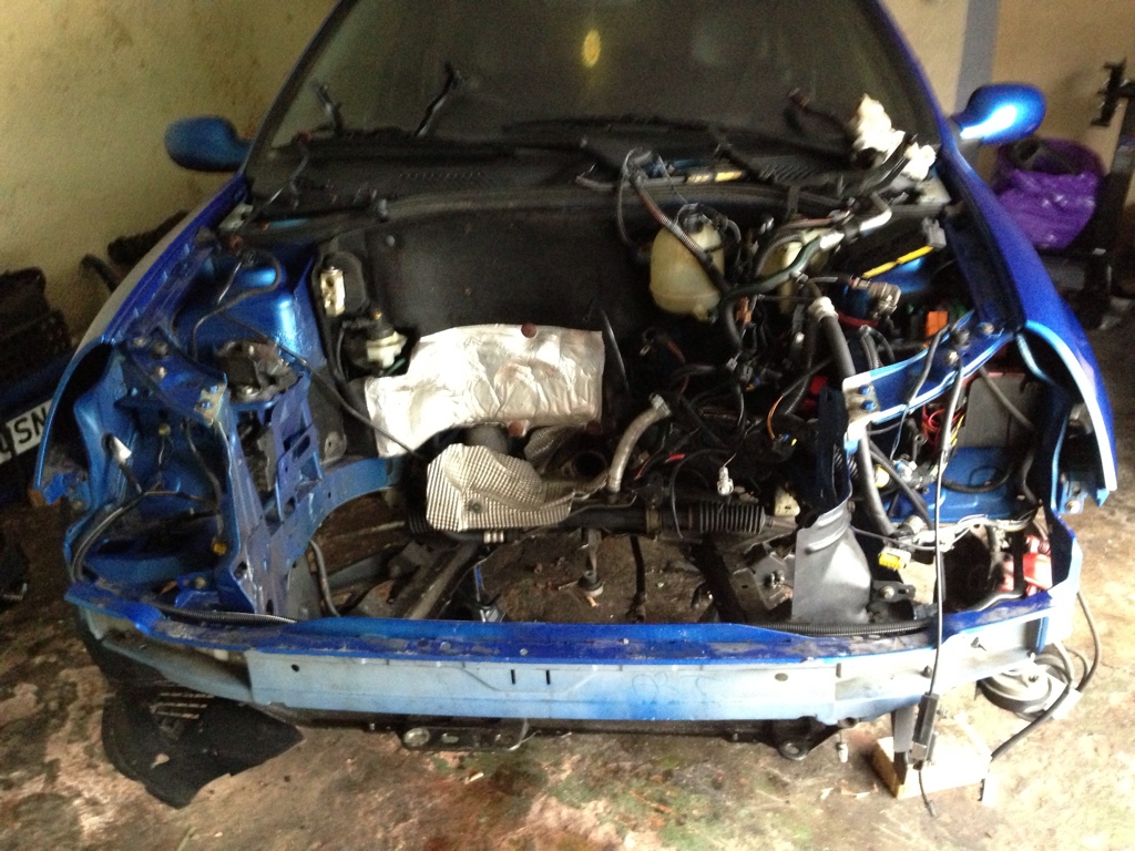

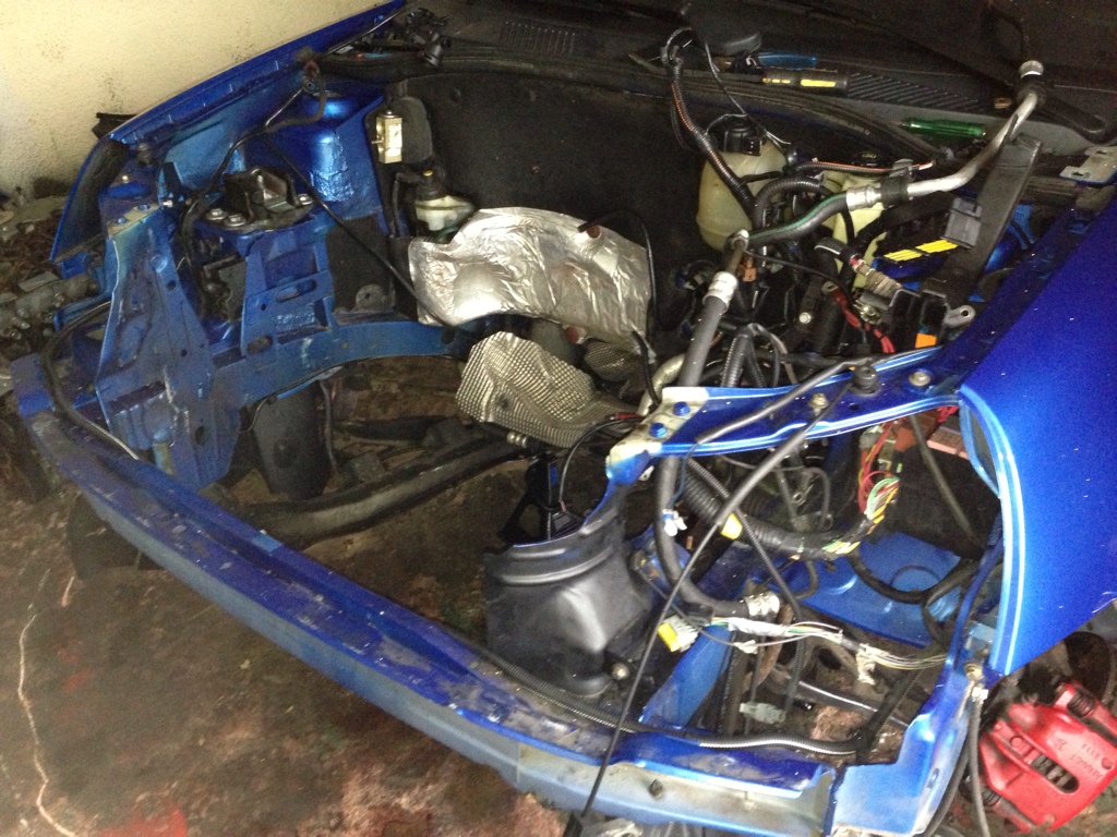

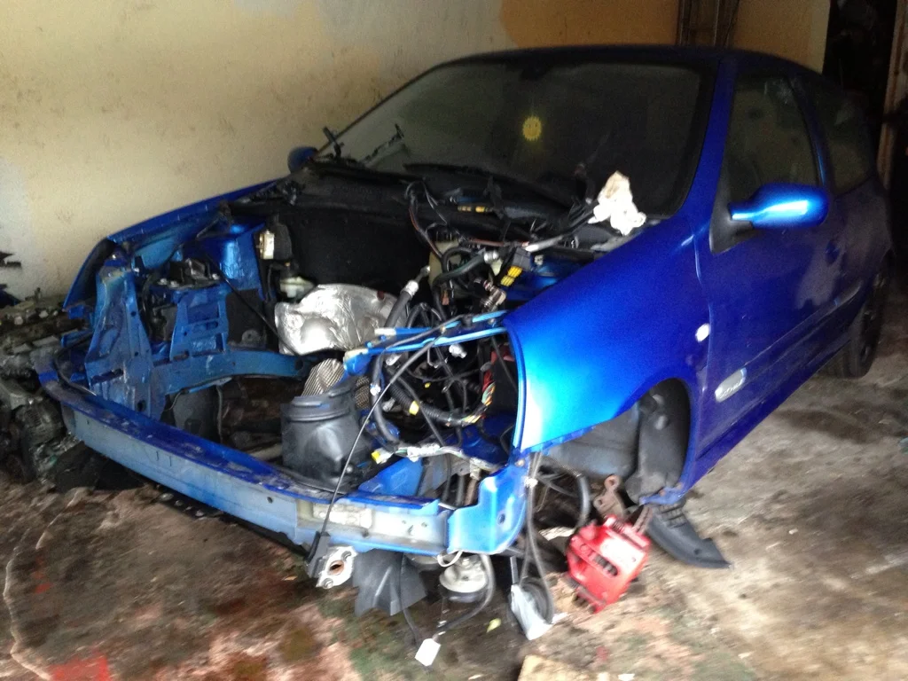

UPDATE: Took engine out today ready to strip and rebuild :)

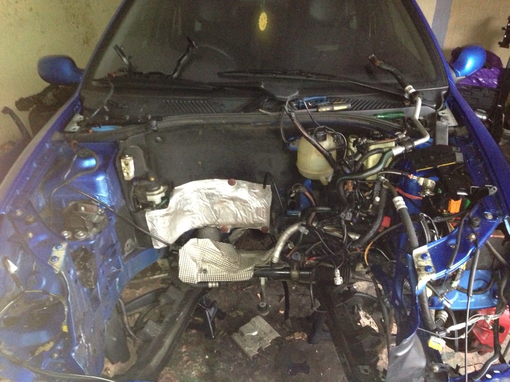

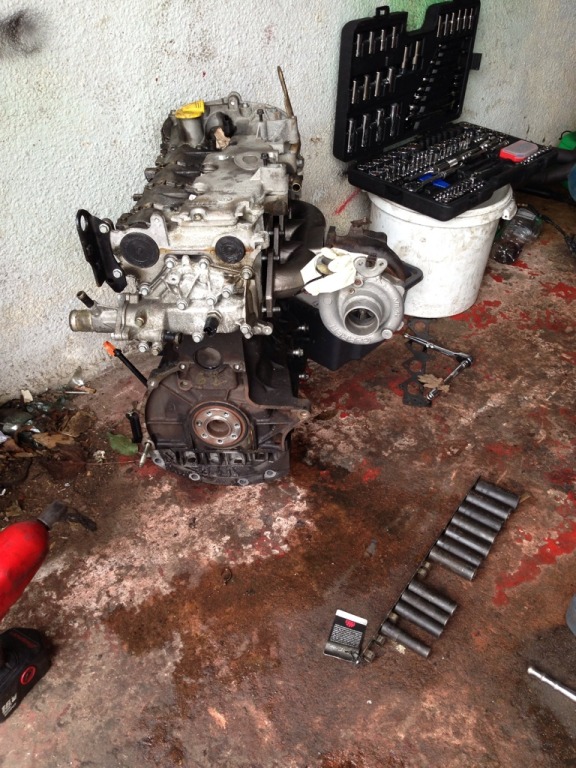

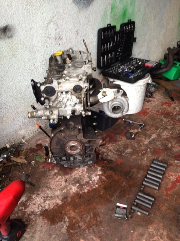

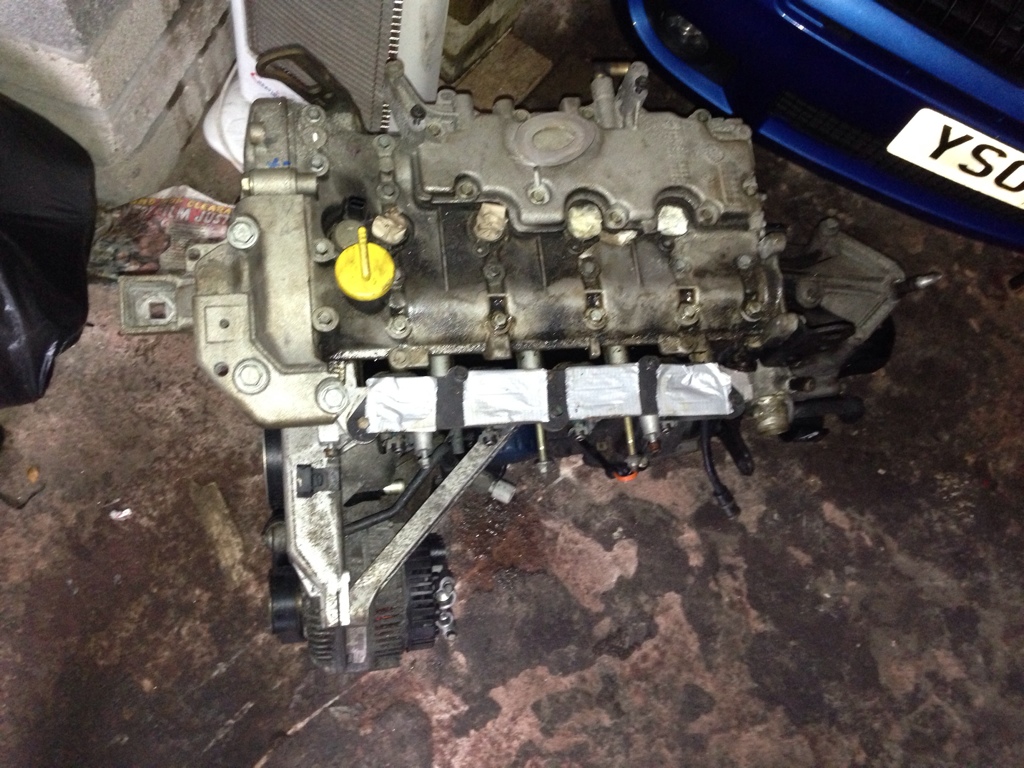

Took the gearbox, alternator, ac pump, steering pump, starter motor etc to a bare block had a little play to put the manifold and turbo on just to see how it will look ;)

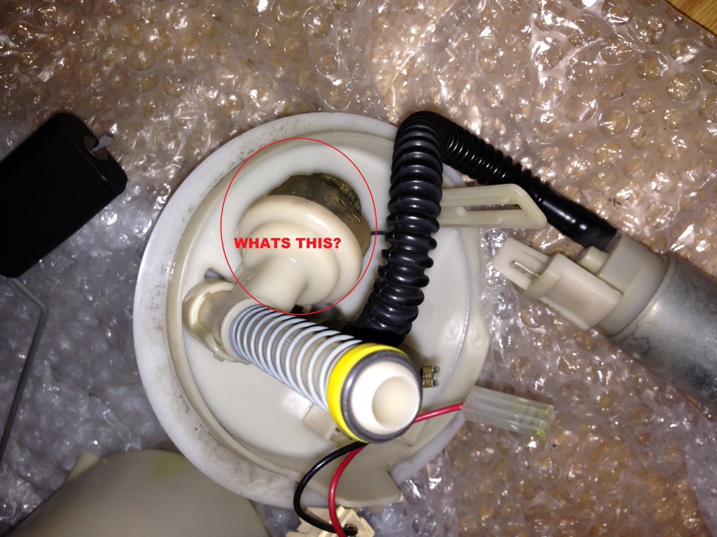

Another question regarding my phase1 fuel sender
received mine this morning but only had chance to look at it today I took it apart to see what's what took the pump out obviously I'm replacing that, what's this on the return line? Pictured below?

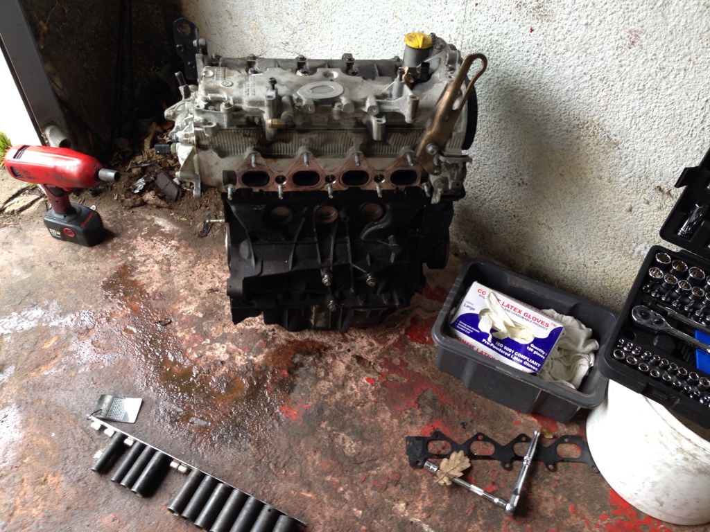

UPDATE :)

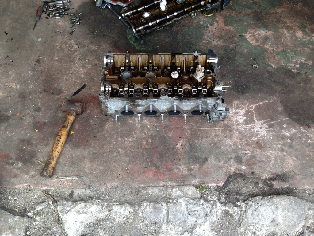

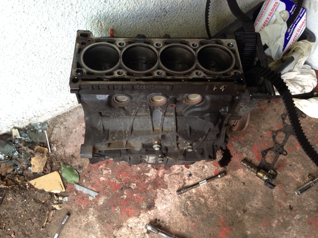

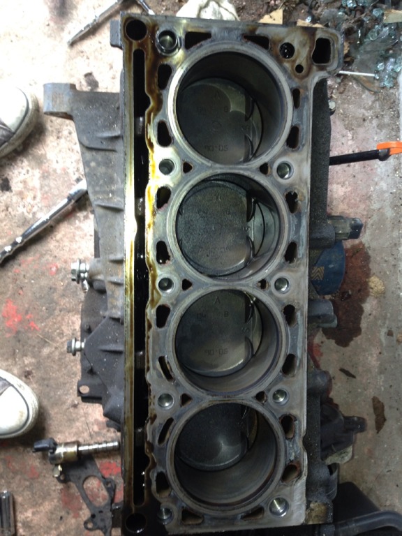

started stripping the engine today, rocker cover was a ba**ard to get off but got there in the end lol took the head off block will be going on the engine stand tomorrow and stripping the bottom end taking pistons out and going to get the block drilled out and tapped for my oil return and get my slots machined out of my megane pistons ready to rebuild over next couple of weeks

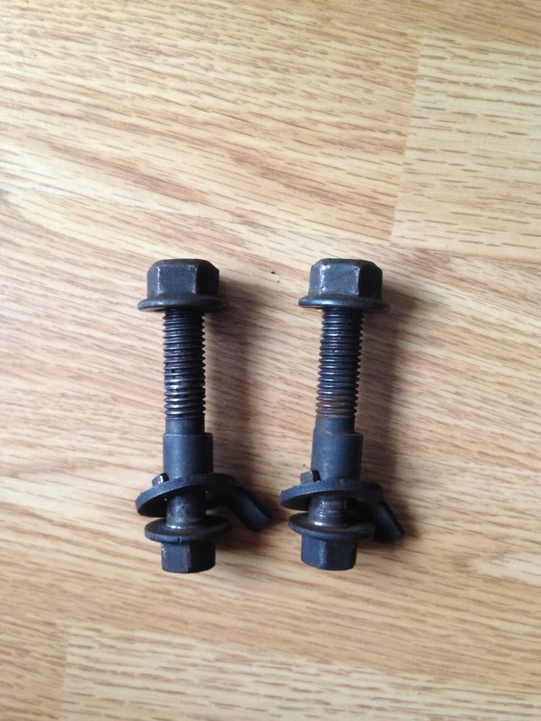

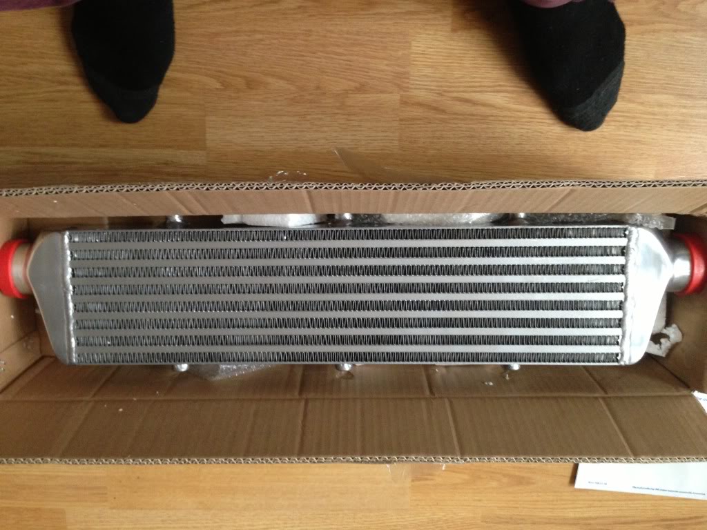

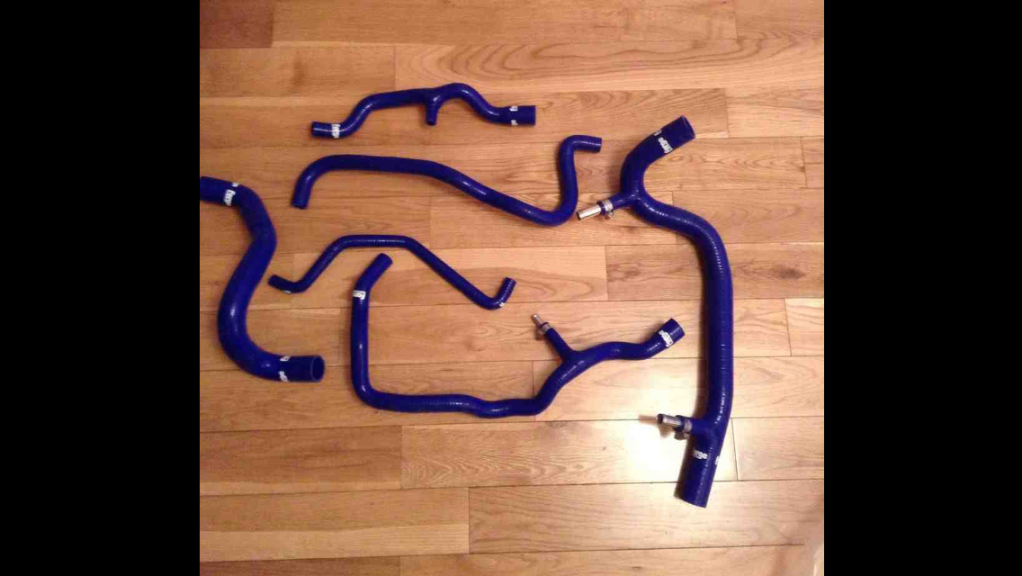

Few more goodies come through the door today new water pump my intercooler and camber bolts :) booked it in to efi parts for the 5th of August for the ecu installation and setup, my pistons and rods are down cardiff @ south wales pistons getting the valve pockets machined out of my megane pistons.. also bought a ph1 fuel sender without realising that they had 2 different types I bought the late ph1 fuel sender the one without a return line to the tank. which is the wrong bloody one so that's now for sale lol
also bought some forge coolant hose set and some 15" oz f1 which I haven't yet picked up

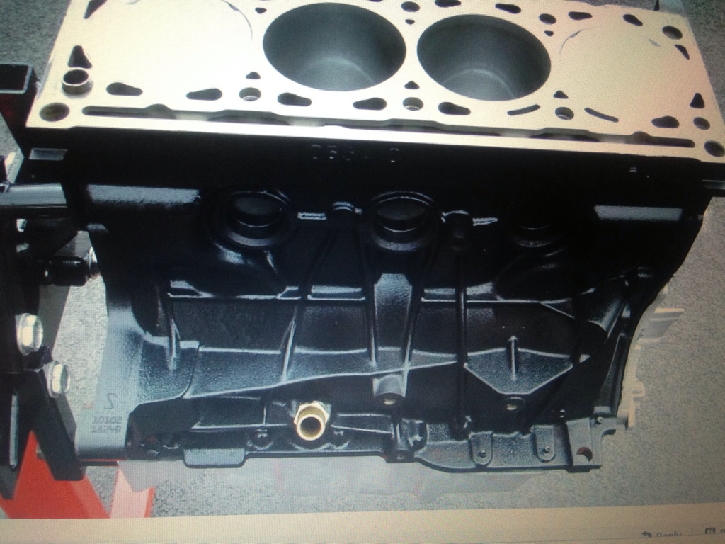

Right then so my oil return I'm doing it to the block was jus wondering what size hole I need to drill what size tap (thread) and what fitting to use any one help with this would be great cheers :)
this is how I'm going to be doing it cheers
  172 cup, Impreza P1
You will need a -10AN (ID 10.5mm) or above.
