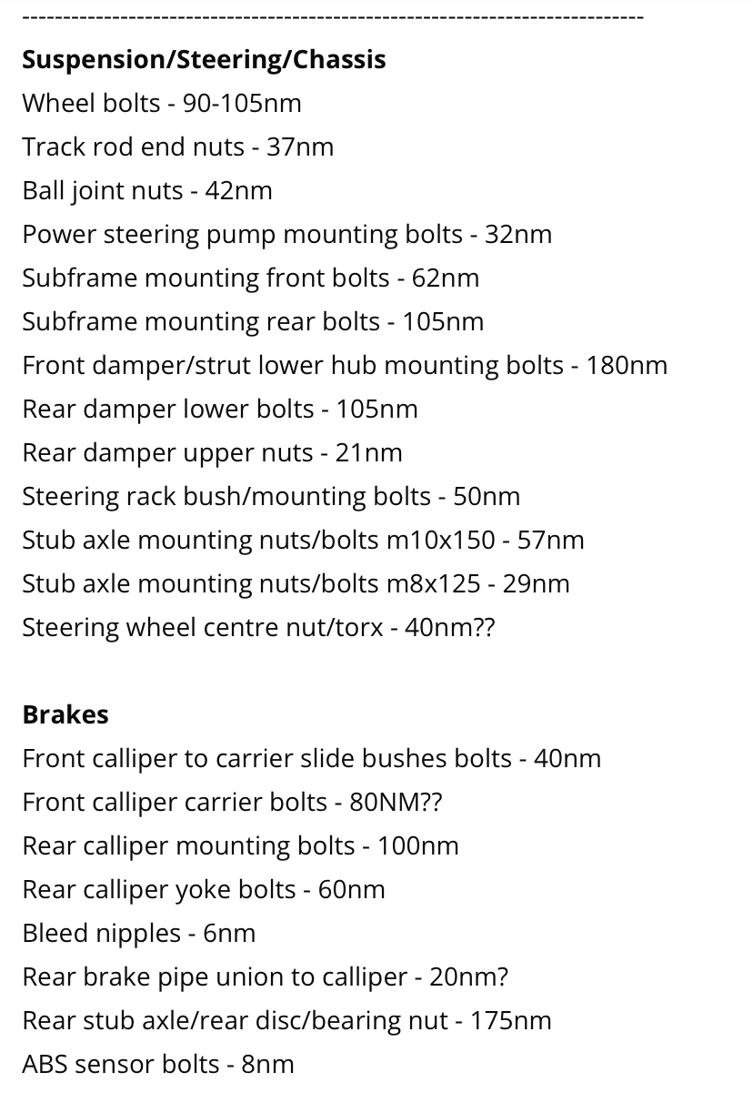

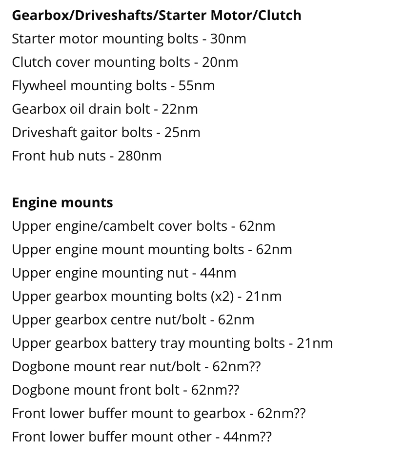

Yes to all the above.
You don’t need any sealant. Hub nuts are 180NM.
Does the replacement shaft already have the gaiter clamp fitted? If not, just be careful when putting it back on the new shaft as it’s easy to distort the rubber gaiter, which will mean a leak.
If you drop me a message I’ll send the manuals over.

Thanks all.
The shaft does have the gait or clamp fitted already, good thought on the ball joint bolts.
I will set to and get it done.
