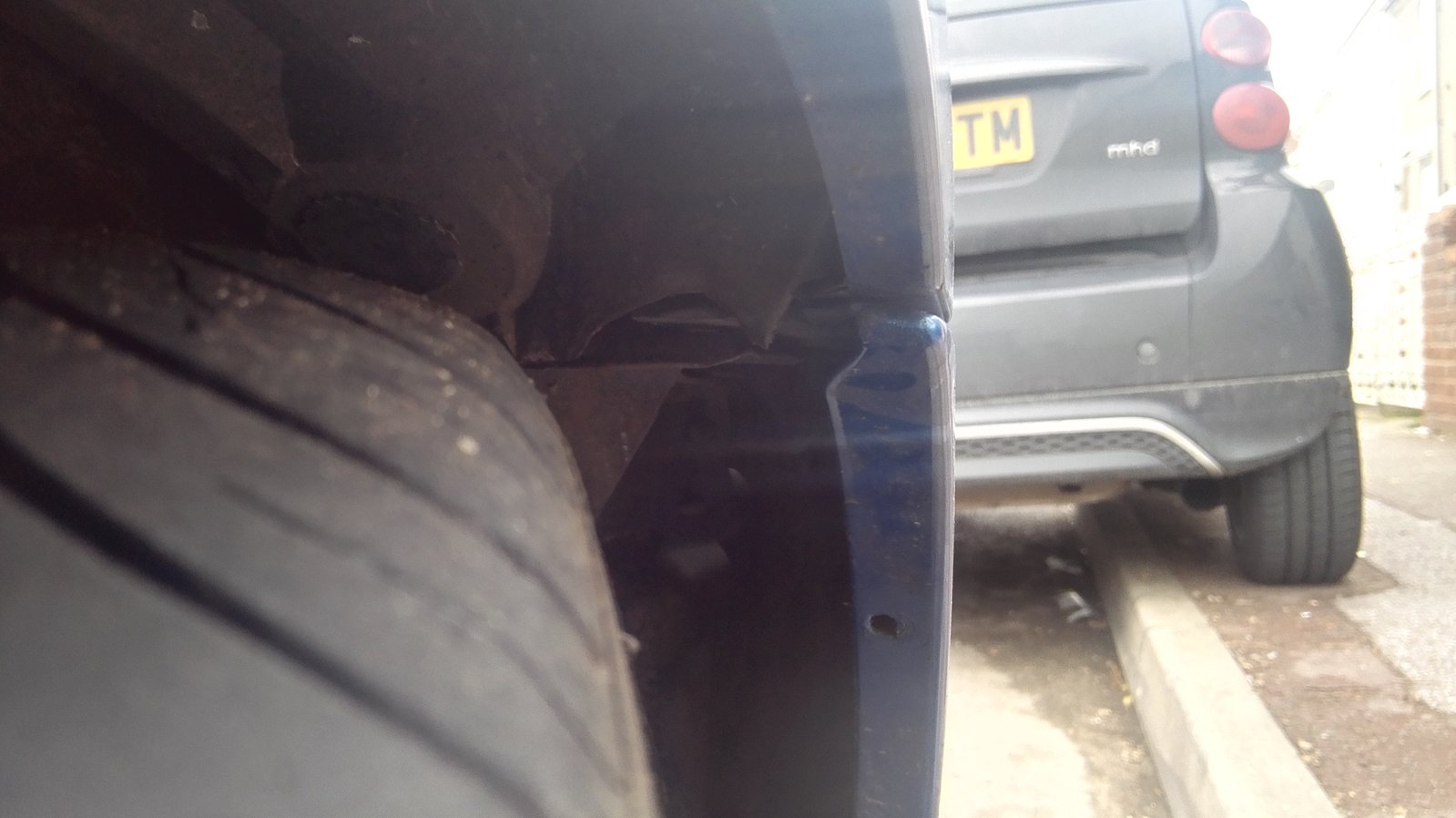

  197was/second 182is
where are those brackets you can bent? thats exactly noise I'm getting! need to sort it out then!
about nankangs... great tyre for money, I had them on 320bhp Evo VI with no problems (treadwear 180) now I was looking for 120 in clio size but everywhere they out of stock so I went to federal 595RSR (68 quid a corner) hopefuly they will be fine.
imprezaworks
  Mk5 Golf GTI :)
Yeah be fine mate. If you look behind the front bumper you will see the metal brackets. Hammer at the ready
  197was/second 182is
Do we talking about them? If anyone can, picture will be much appreciated!

Is the car lowered? Only time I had issues on running was from the front bumper brackets. You can bend them out the way. Video below shows the lovely noise it makes
Nice vid , sounds horrible ... Can't have done your tyres much good .
  PH2 172
/QUOTE]
Space the front upright assembly away from the top mount bearing so that it hits the bump stop before the tyre rubs on the bodywork.
