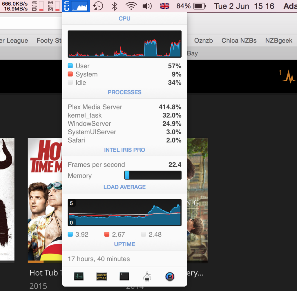

Ok, so after checking my MBP whilst playing a film via Plex through the Chromecast there is a fair bit of CPU processing resource being used...
So yeah, transcoding is very important for my needs :blush:
It seems the App on the Smart TV is able to play back the media file directly as there was little to no CPU usage on my MBP for the PMS.
