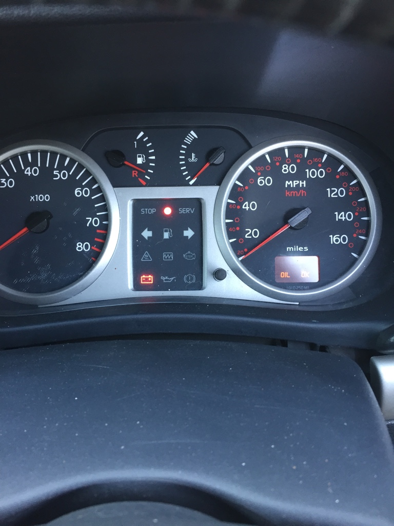

Drove my Clio 182 to work and back today fine after leaving it stand for 45mins the other half jumps in and she said it went to start then stopped now go to start it and no noise what so ever now[emoji20].
Things Iv notice on the dash lights
Green gear stick not showing now.
Stop light on.
Battery light flashes a couple of times.
Just got back from dropping the half at work in the our other car so going to have a look at the Clio now
Going to rock it back in gear to see if starter is stuck. Got a feeling it's wiring tho
Any advice will be much appreciated thanks

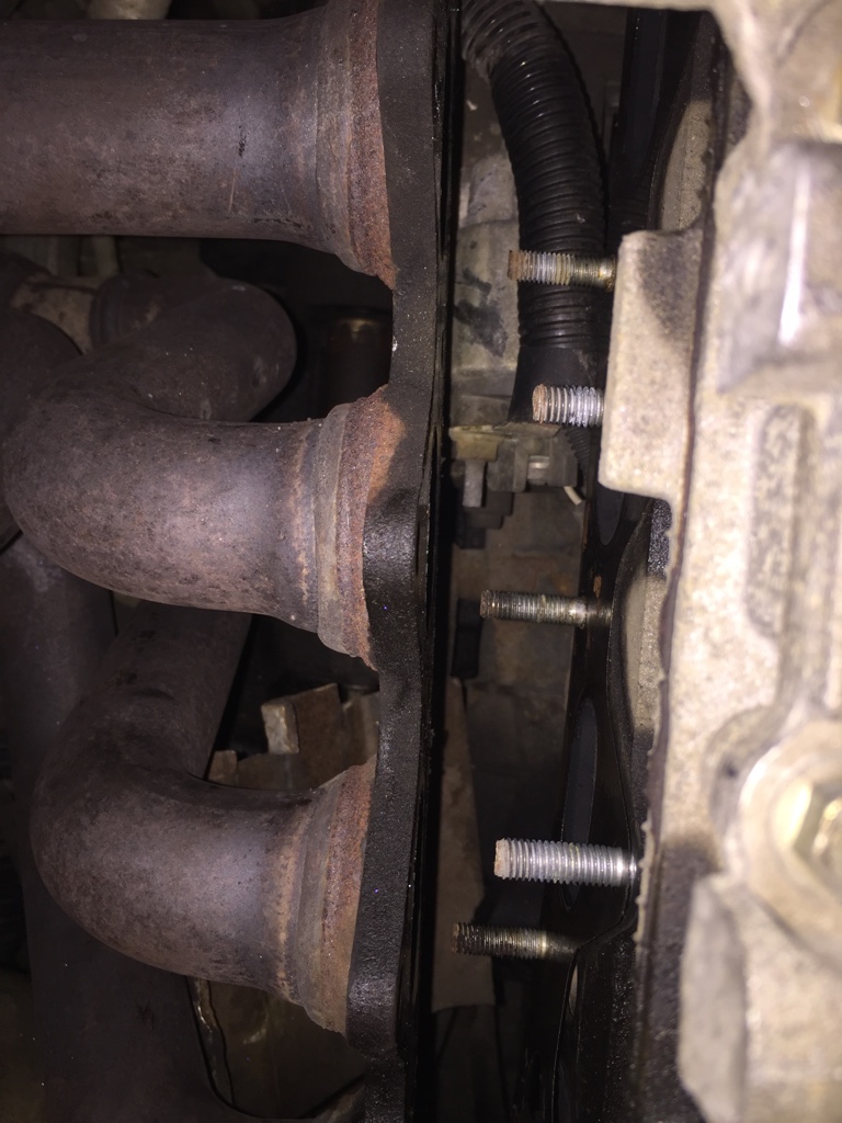

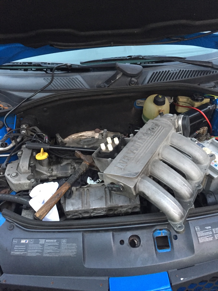

So today I started the mission not yet got it off as run out of light.
Toke inlet off removed the manifold bolts thank god there all came off nicely took the clamp of the middle part of the exhaust so I could slide the manifold back I can now see the starter clearly now.

Lol don't say that now. Well what Iv been ready it makes it easier if the manifold is out the way but could be wrong haha
  R5gtt, 182, volvo...
You could manage from underneath but some of are have been doing this a long time and work out the job process as a glance. I always take off things that could have stayed on, sh1t happens..
Crack on and get it sorted.. Next time you'll be able to do it with your eyes closed....
GCC
  1.2Clio / 182!!
Where abouts are you??
This does look like you've gone the long way around things but that's just my opinion. Whatever works for you is the right way for you!!
Make sure you have the wires disconnected from the starter before you remove it completely. Also make sure the heat shield is back on before you put the manifold back in as you'll wish you had otherwise!!
