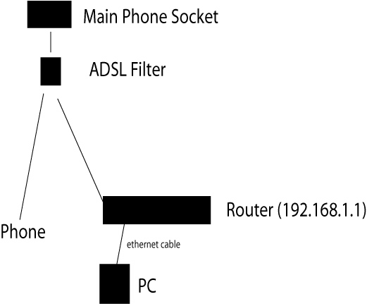

see diagram
Nothing else should be plugged into the ADSL Filter - no usb ADSL Modems etc

Right this is how the wiring is set up atm. I need a ADSL splitter on every socket for phones in the house that are in use so there are a few around the house. Where my pc is the phone point is over the other side of the room so i have a splitter there with an extension lead coming to the pc.
The picture shows three wires. the splitter coming out of the ADSL hub is the one that come with my router, the White wire goes to the router and the black wire goes to the extension lead from the phone point. The single black wire coming out of the hub is the usb lead. Hope this helps

right thats where your going wrong :)
See my diagram (took me ages that!!)
You can't use the Speed touch Modem and the router. The router has the USB modem built in. Best plan is to follow my diagram. that means unplugging your Speed touch modem completely. The ADSL filter can only have a phone plugged in the phone side of the filter and the Router plugged into the data side. log into your router via IP and try to connect
