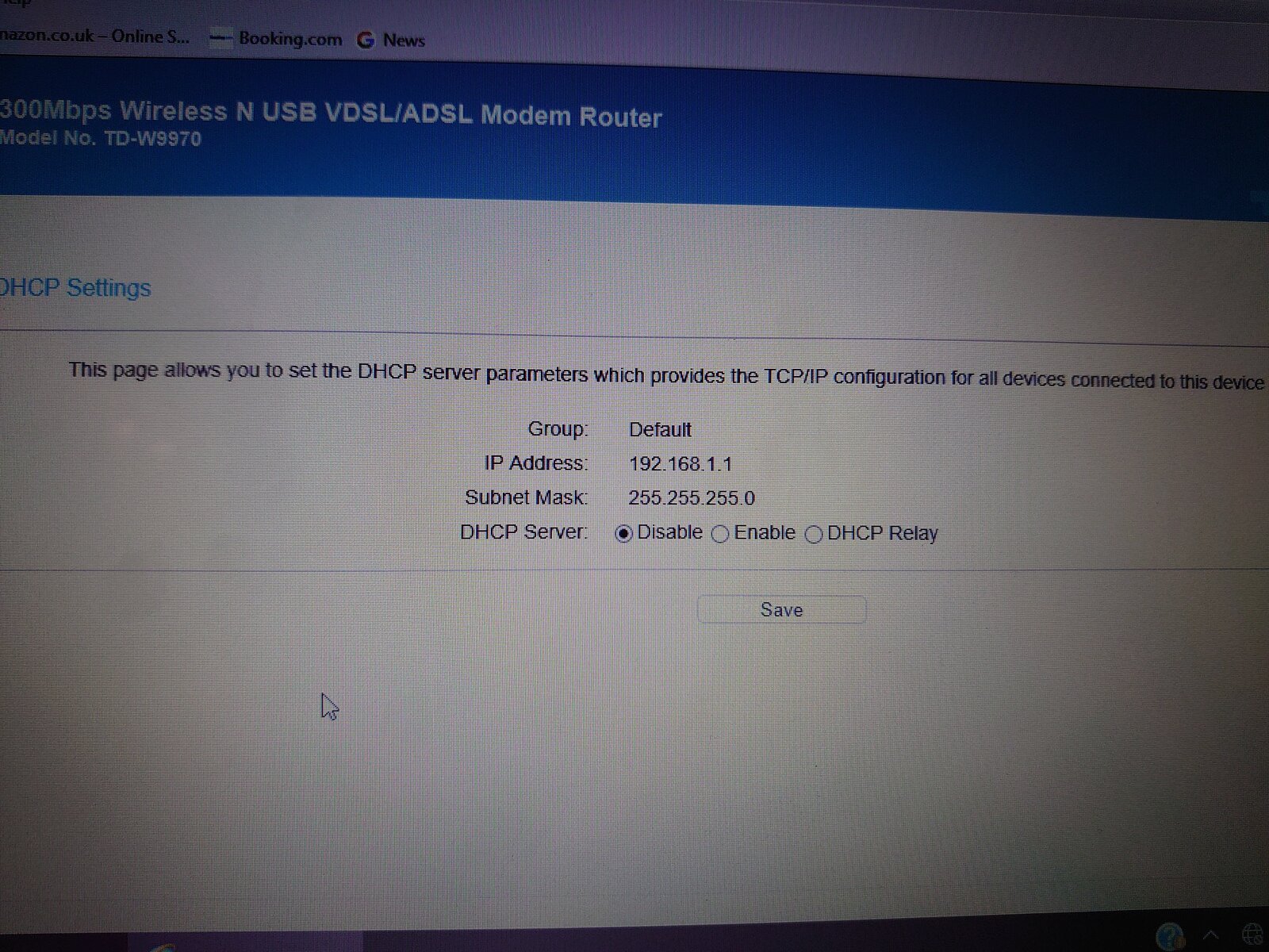

So what am I changing here?
If you have a computer or laptop it would be ideal to connect directly to the router using a cable. If you disconnect it from everything else and just plug your computer into it then you should be able to access that routers page and change the settings you want to change.
Im assuming it is happening because the new asus router you have is using the same ip address as your old tp link one was. You will need to change the ip address that your tp link one uses in order to stop this happening.
Im assuming your system runs like this ...
Asus router connected to your main internet feed into the house
Tp link router connected to the asus router via cable
It should work by switching dhcp server off
Then changing the default gateway to something other than one being used already. I would change it to something like 192.168.1.150
Hopefully that should work, i think you can use the dhcp relay function but im not entirely sure how that works. Someone on here must know

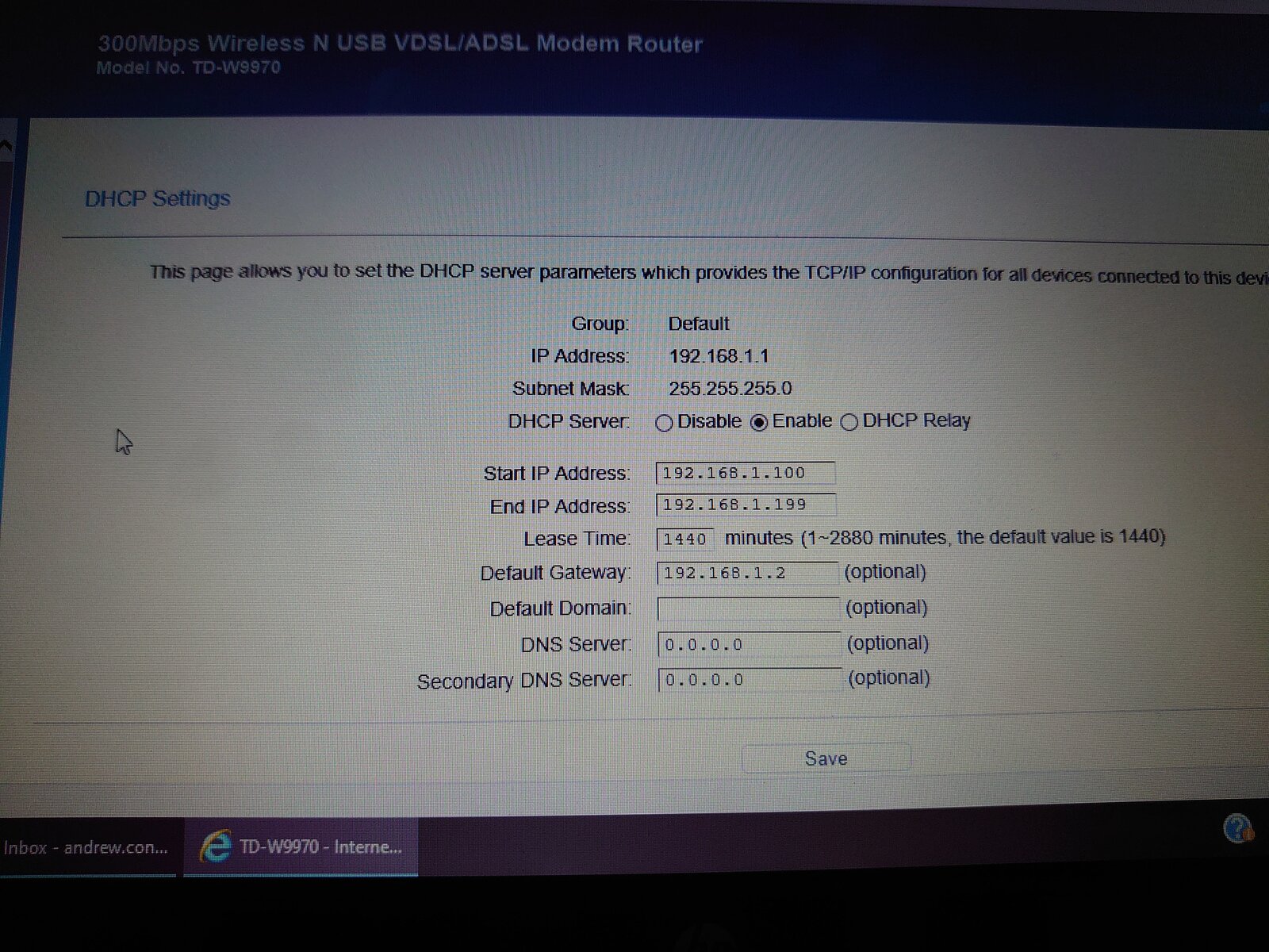

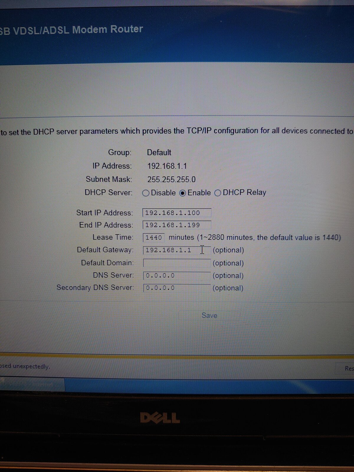

OK changed let me test

Maybe try 192.168.1.2
Just makes it easier to find in future
