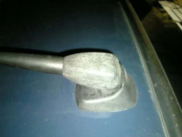

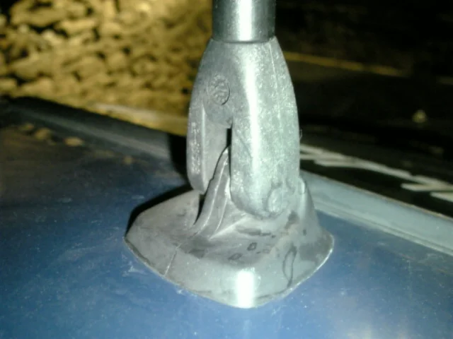

hitharder Car nothing, blown up! Mar 3, 2006 #1 ne way of taking this off???? Attachments 06-03-03_18-41.webp 23 KB · Views: 103 06-03-03_18-40.webp 16.2 KB · Views: 105
1 172 Dave Mar 3, 2006 #2 think.......you drop down the interior light panel and the asembly unscrews from there..
M mk2badboy Car Renault mk2 phase 1 Mar 3, 2006 #3 yea in side the car where the interior light is just pull that out an there is a nut just unscrew that nut m8 job done

hitharder Car nothing, blown up! Mar 3, 2006 #4 oo thanks plus is there any way of removing it when oging into a car wash??
1 172 Dave Mar 3, 2006 #5 yep in ur pic the round section is screwed to the base simple unscrew anticlockwise m8
V1NNY Car Mégane RS Mar 3, 2006 #6 yeah it unbolts from underneath iirc, why do you need to take it off anyways?
