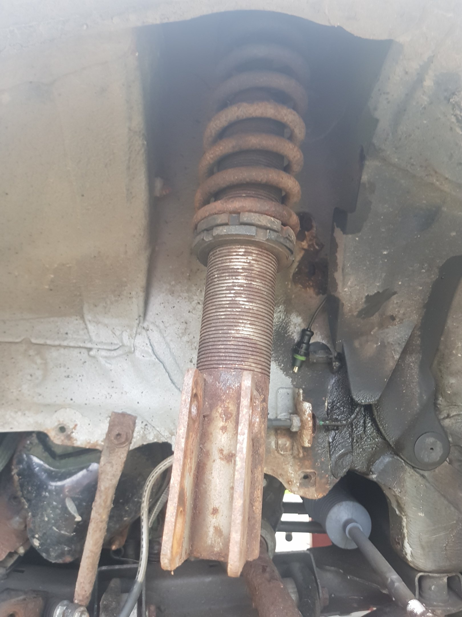

I've got a £1000 budget, currently got Gaz GHA full coilovers which are working but rusty as hell.
