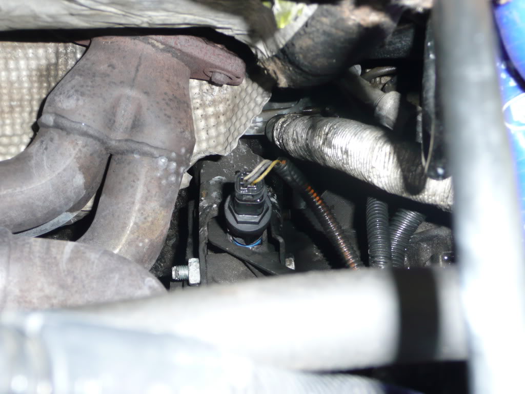

just recieved my 7700418919 sensor, i understand its on the top of the gearbox, can one one eplain exactly where it is and how easy it is to fit (will i need to jack car up or not etc)? Pic would be even more helpful if anyone has any...

no need to jack the car up buddy, its down the back of the engine by where the manifold an cat join is. 2 min job, unplug it, an yank the sensor out
  Pug 205 gti
now ya tell me, mine was a b'tard to get out, was stuck solid lol!, came out after 10mins of serious yanking, new one sloted in like a knife through butter though, so much so im worried its not in proper, soon find out though eh, cheers again bud... mine also has a small metal heat/splash shield round it too that just pulls off
