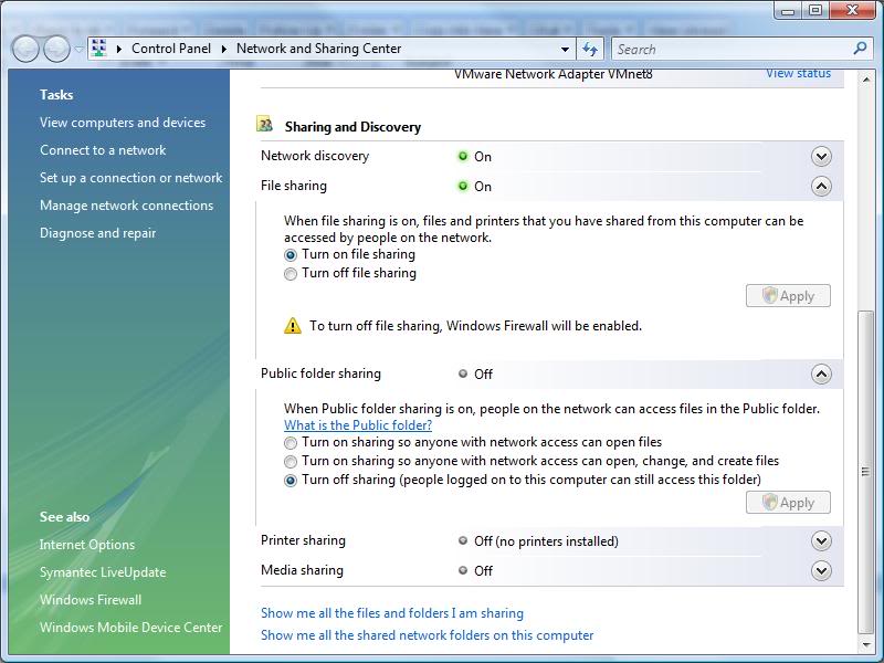

I have a Vista machine which needs to connect to a XP machine for a database share. The Vista machine will not connect to the xp machine using the share name \\eproserver but will connect via \\192.168.254.20 (all xp machines connect to this share no problem, other vista machines have the same problem now and again. If I reboot the vista machine I can access the \\eproserver for a little time after it boots up (sometimes not) but if left I can't log in.
Permissions are ok as I can log in via IP (see screenshot), I've cleared all caches for name resolution.
sometimes I can connect via \\eproserver most of the time I can't.
any ideas?

Likely to be an issue with the File Sharing settings in Vista's Networking stuff...
  Fiesta ST
yeah its defo a vista thing but god knows where to start.
odd it works sometimes (usually a fresh reboot and have to connect straight away)

Yeah I've been playing with them , funny thing is the Vista machine can connect to other XP machines no problem - seems to be just the XP machine running the database software.
