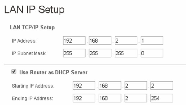

Right ok, so I've set my home network to 192.168.2.x, but it still doesn't show the PCs/folders when on the VPN.

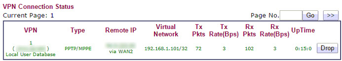

Looking at the router, my VPN connection inbound is showing as "192.168.1.101/32" The 192.168.1.101 is the static IP I assigned to the user, but what's the /32? Is that effecting it?
HOME:

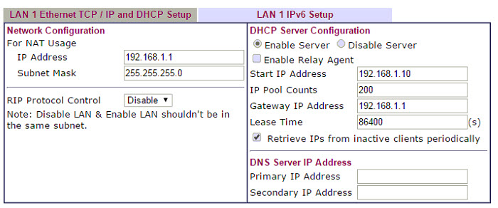

WORK:

No, don't worry about the '/32', a '/32' is a total mask, but to simplify, it's used to represent a single IP address, e.g. the IP address of your client on the VPN.

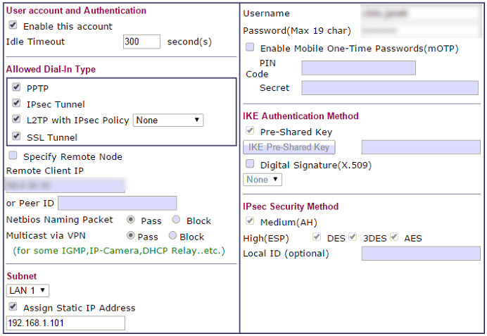

I assume, 192.168.1.101 is your IP address on the remote network? How have you set this?
Yes that's the remote network IP for this user (me), setup in the user creation on the router.
